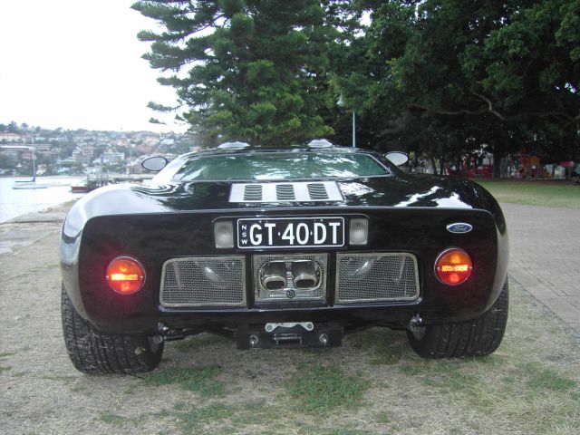

I run 255 x 17 on the front and 335 x 17 on the rear with no problems.
The rear has the wide Gulf flares and the front is standard.
No rubbing problems.

...i remember seeing pics from the rear of Dimi's car, looks awesome. Show us again Dimi:2thumbsup:

If you think my wheels are big check out the car next to mine at the all Ford day at eastern creek just recently.
Dimi
