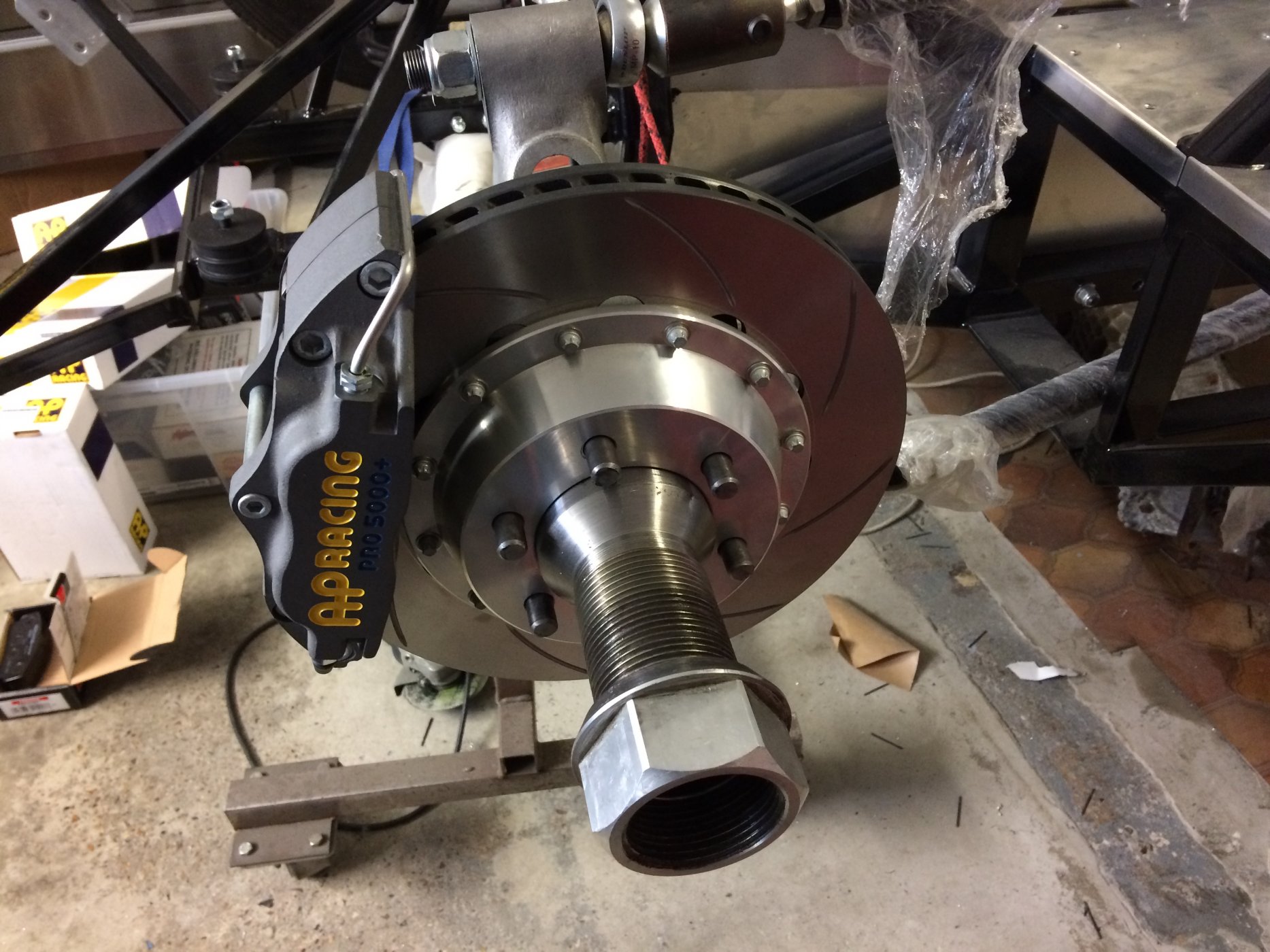

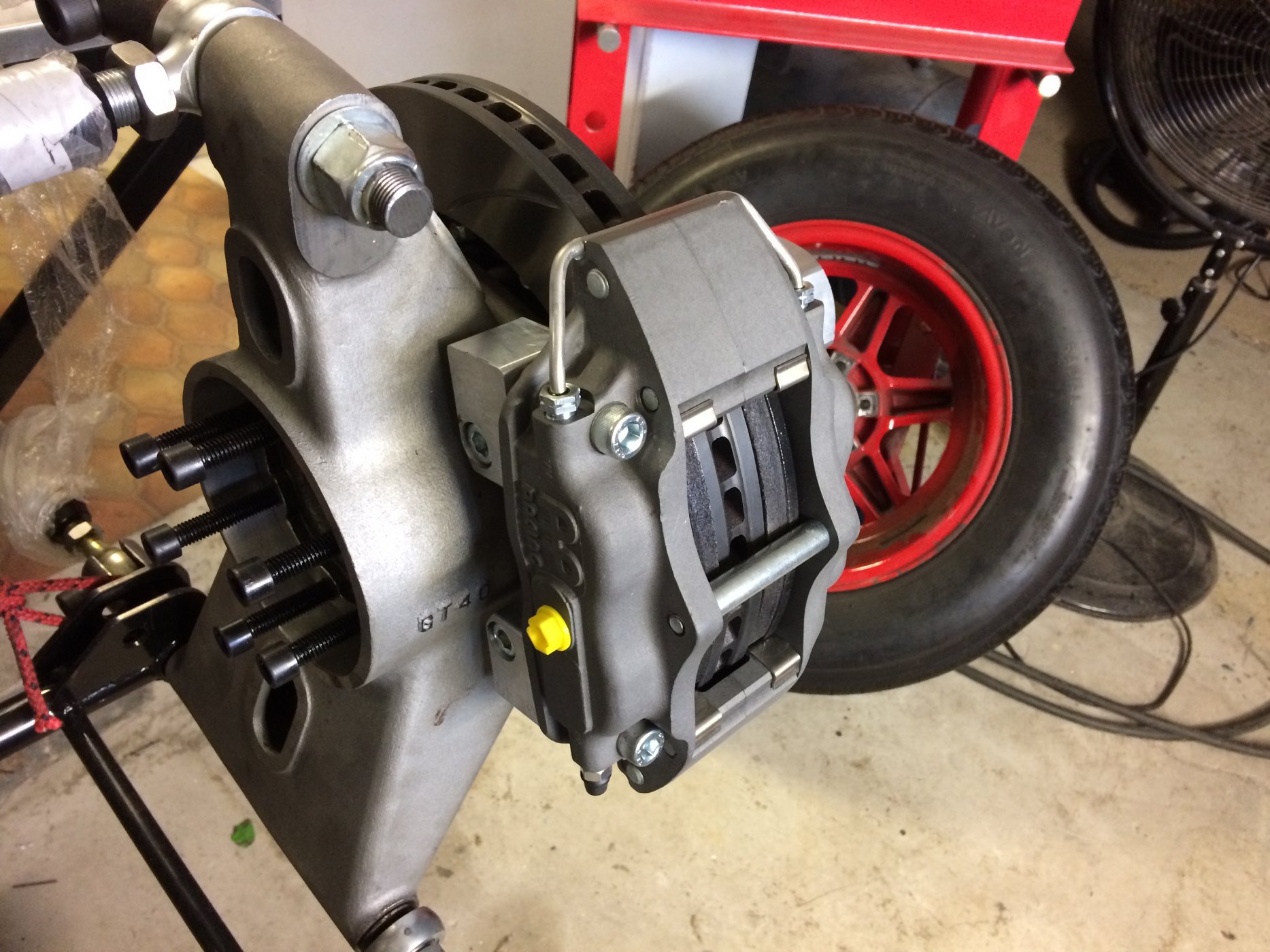

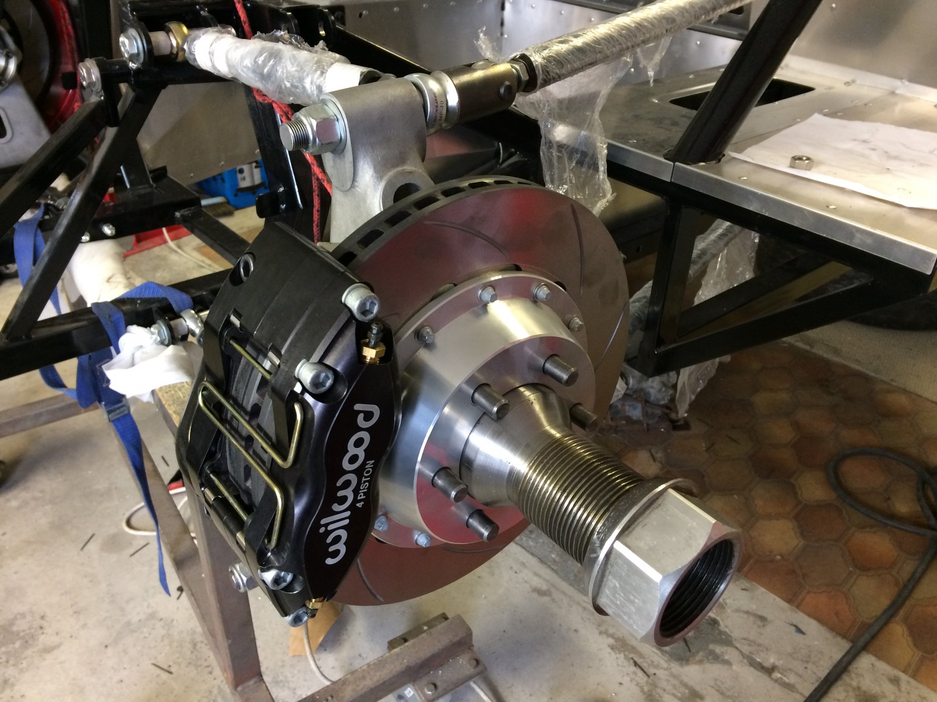

What’s got you stumped in regards to the rear?
SGT rear ally uprights are very close to the originals externally.
you cannot fit a 6peg adapter onto a 5 bolt granada hub due to the bolt spacing, but an SGT 6 peg rear hub/stub axle into their steel rear upright.
Few old pics of AP and Wilwood’s onto rear SGT upright. Hubs/stub axles are as per original, all machined from billet.
It is just a case of finding something that will work for my requirements, which I am still working out what they are. So there is the personal desires for what I want the car to be in the end (which does change over time) as well as the local regulatory requirements, which I am still working my way though. I have not gone through all the paperwork just yet to sort it out. There certainly is a lot of value in buying from a local kit producer that has done all the homework and engineering to work out what is required to meet your local requirements.
I like the look of the Southern GT (AP) uprights with the AP Racing Calipers. Its going to be a nice build Morten.

Ryan, I’ve got one ongoing build with AP 4 pots & Brembo handbrake caliper, and one with Wilwoods 6 & 4 pots with Wilwood handbrake caliper. All setups with AP discs and 6 peg hubs, and varius other builds with HiSpec calipers.
Many options for you
