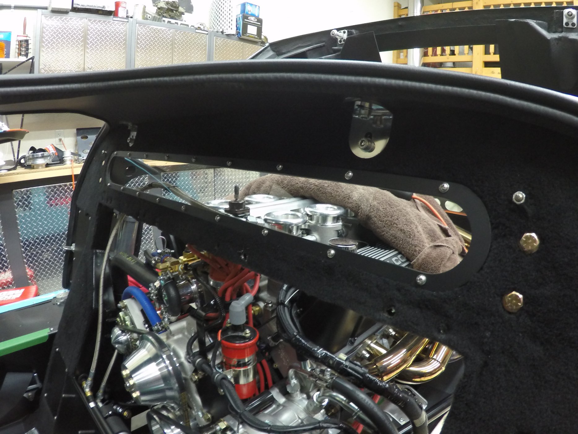

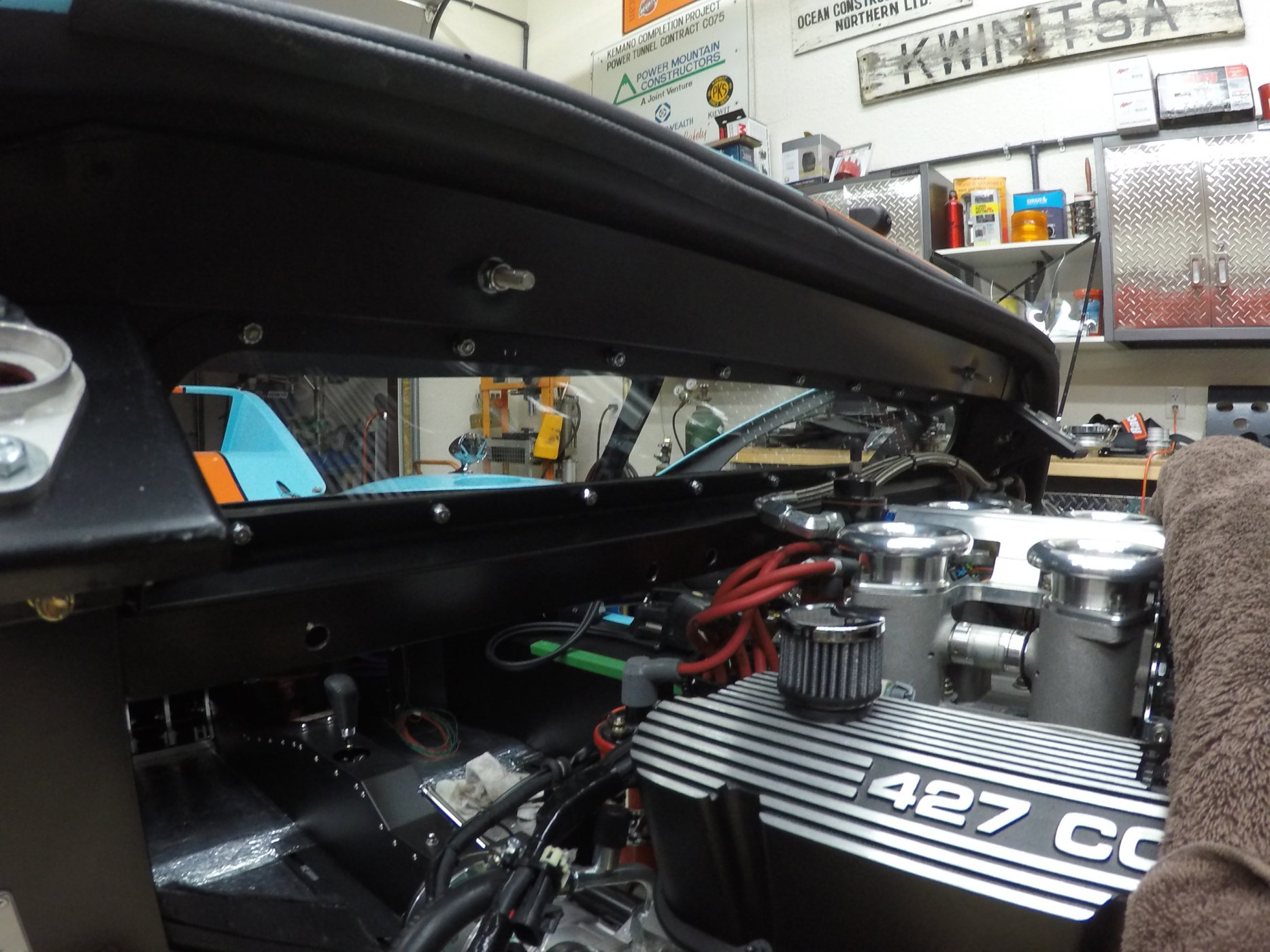

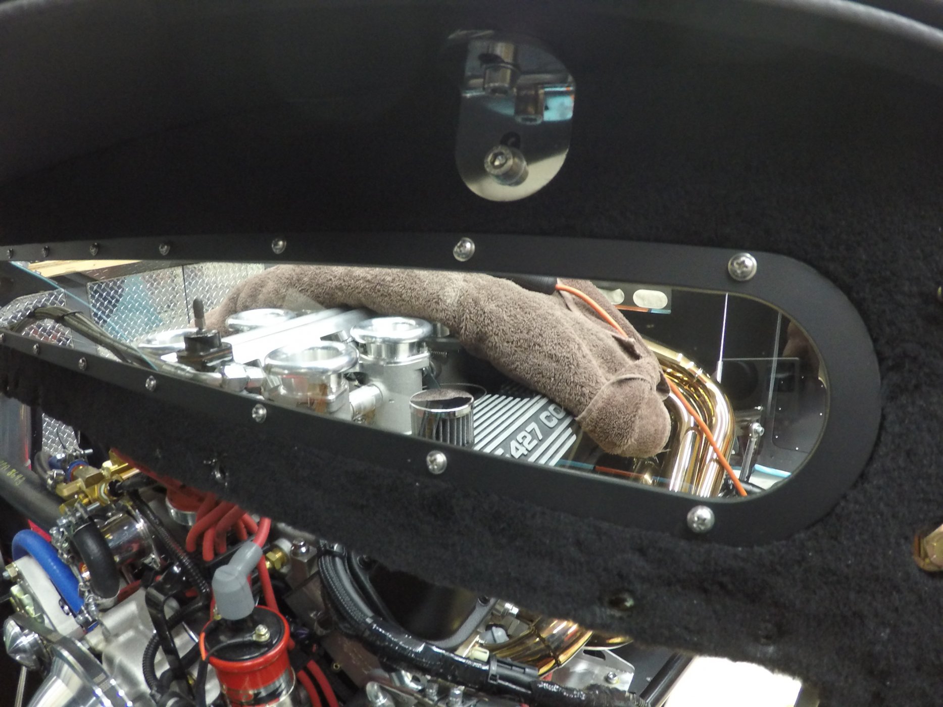

I made my own out of 1/8 ally. A frame with weather strip and bolted to the back wall. Kind of like a glass sandwich.
