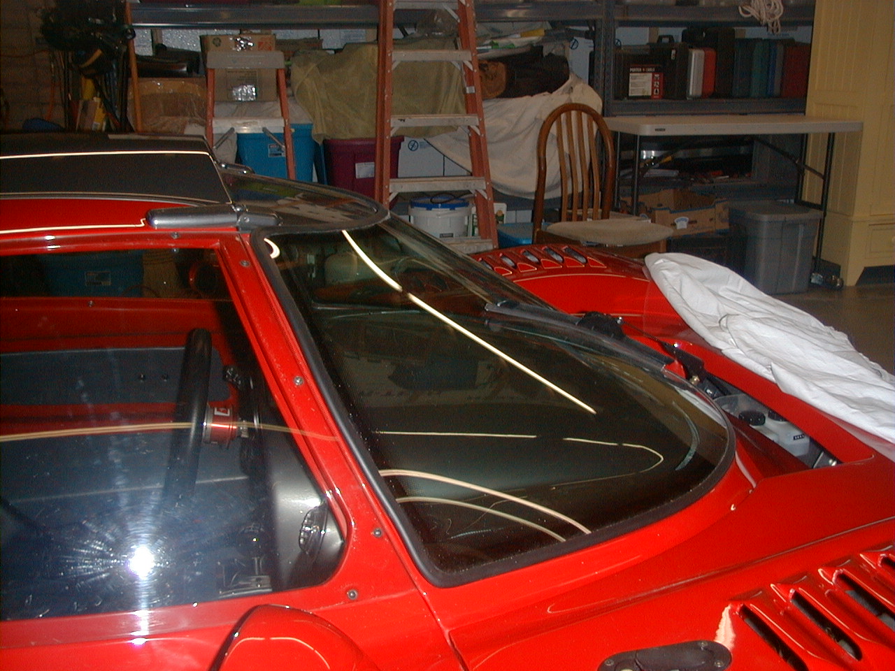

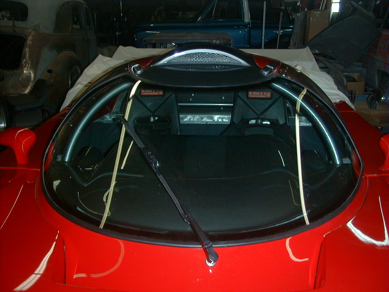

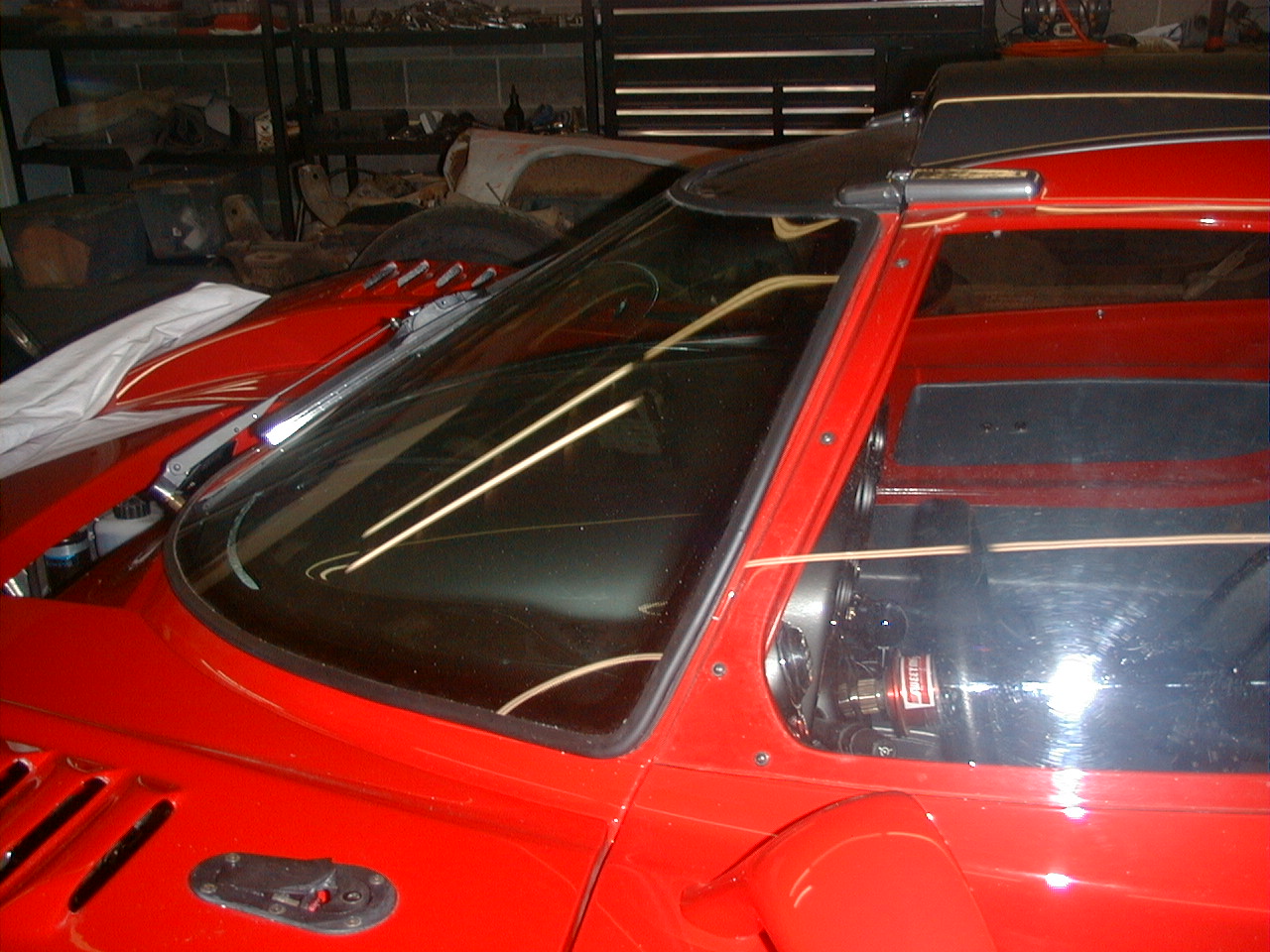

Bill, I was going to install my windshield, I dry fitted it and was a little baffled as to what I should do. The sides did not fit. I considered shimming the body but that messed up the door fit. I found a good professional auto glass guy. He used a black windshield adhesive and it just looks like the rubber is a little thicker in those areas. Nobody has ever taken notice of it and I think it looks great. Good luck with yours.

Pete, thank you for the referral post. I have read that several times and used the information to set my windshield. However, I still don't feel that the fit is good enough. With pictures from other builders I can establish whether my current result is as good as its going to get, or that my expectations are to high and I need to stop where I am.
Al, thank you for the pictures as it starts to make me think that my expectations are to high. Your windshield looks like a factory installation. I am totally unfamiliar with the process of the final install from the professional installer. Your pictures gave me some confidence in that I'm going in the correct direction.
