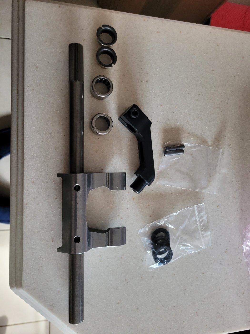

QKE62G001 Clutch lever assembly for QBE62G gearbox from Quaife.
This is the complete kit though.
From what I understand, they do not sell the parts separately, and doubled in cost since I purchased.
