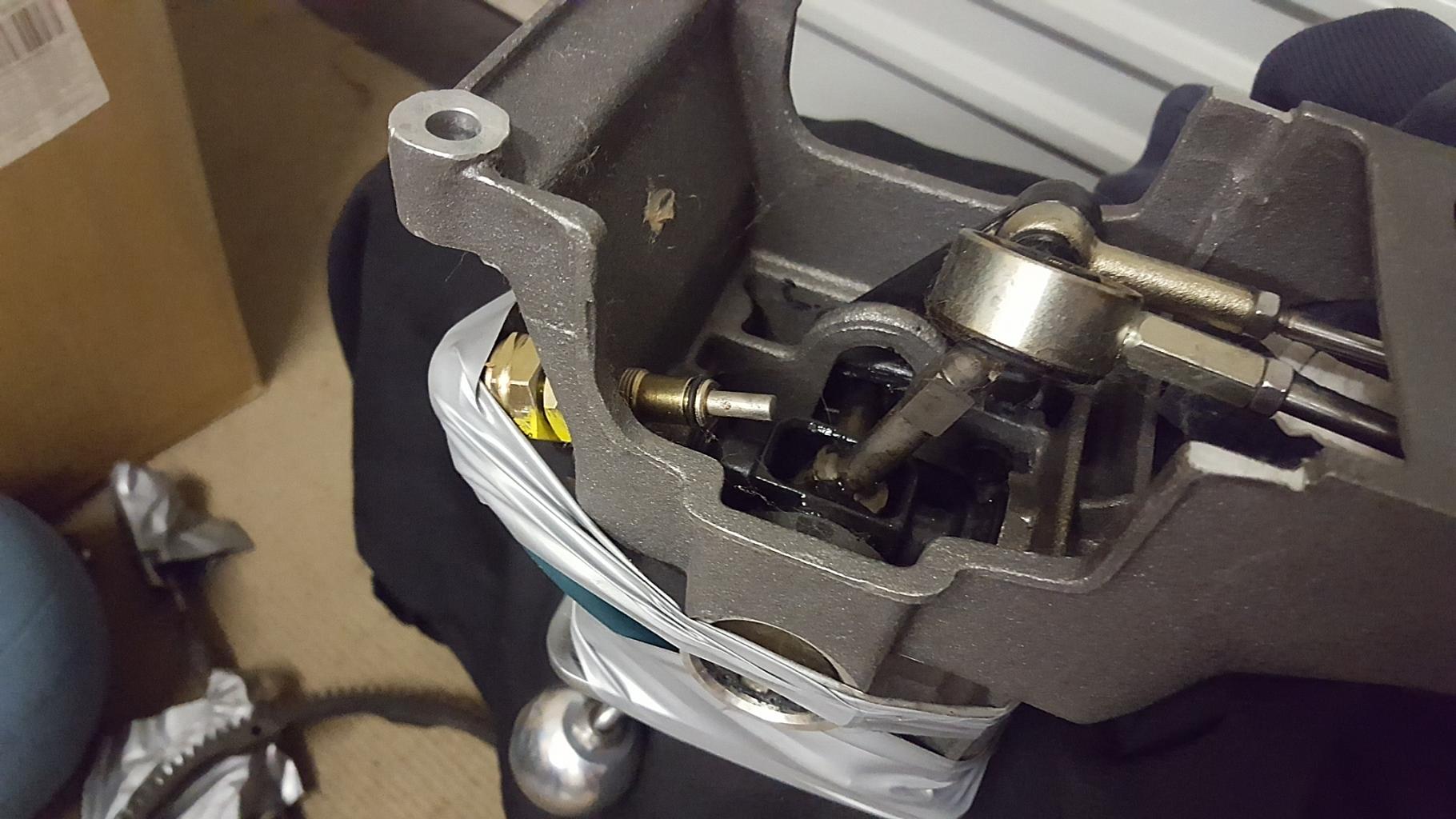

I’ll look at installing a microswitch at the gearstick shift to pick up reverse.

This is the underside of the Ferrari 360 gated shifter. Could transfer the concept to most applications, I think.
