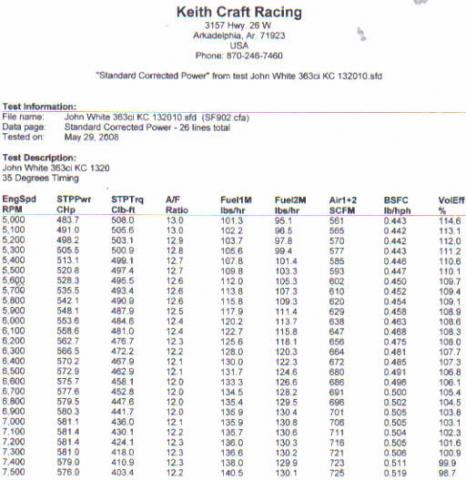

Race Engine: Keith Craft 302w stroked to 363.5, dart 4 bolt block, solid roller cam, AFR 205(ported) heads, zero balanced. Engine has been test dyno'd with 581.4HP@7100rpm, 508 lb/ft. Will be fitted with TWM Throttle Bodies & Autronic SM4 ecu and will be producing over 600HP after tuning.

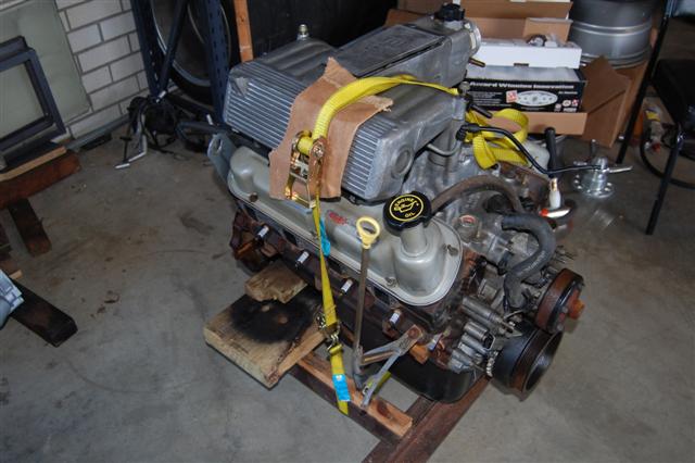

1st photo: Engine after it was stripped accessories, loom etc. The block and heads were never painted by the factory.

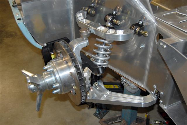

2nd photo: Some of the RCR bling. CNC billet arms, uprights, QA1 Springs & Double Adjustable Shocks, brakes. Check out the welds on the chassis, beautiful stuff.

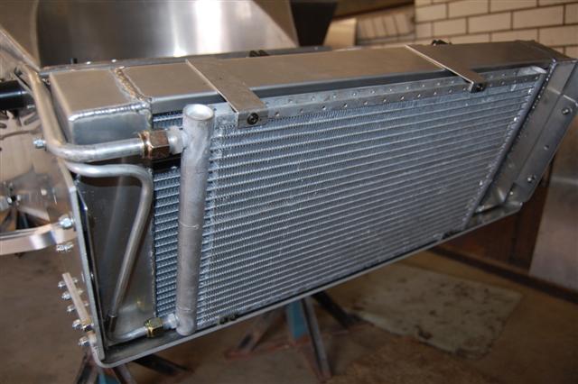

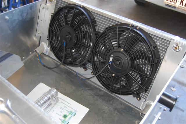

3rd photo: RCR supplied alloy Radiator & Thermo fans mounted and installed. Used rubber washers to insulate from chassis. Very quick & easy to install.

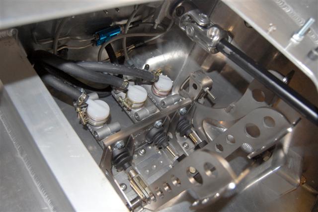

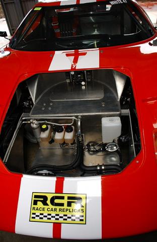

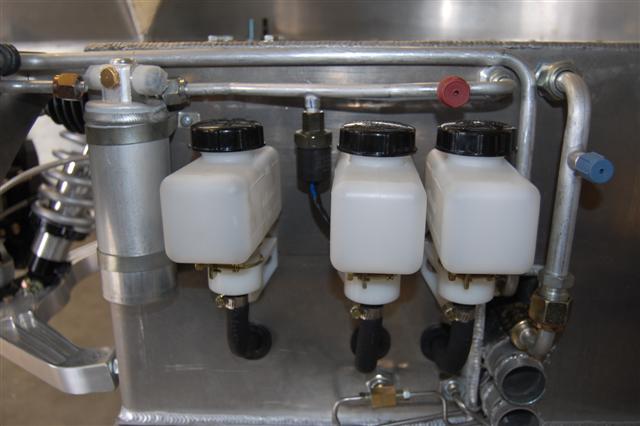

5th/6th photos: RCR supplied brake assembly installed - pedal box, remote reservoirs, mounted brakes lines(not much to do there).
7th photo: Started installing RCR air con - condenser, hard lines, soft lines, air dryer/receiver etc. Also photo 6.

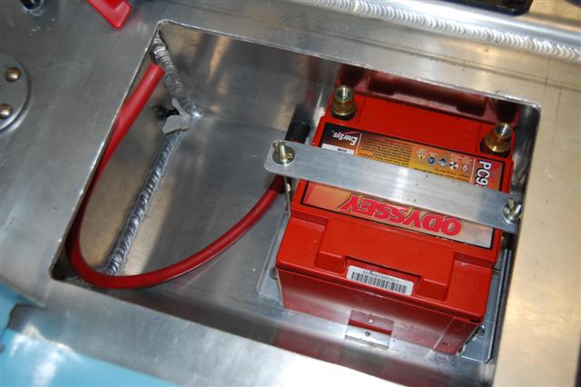

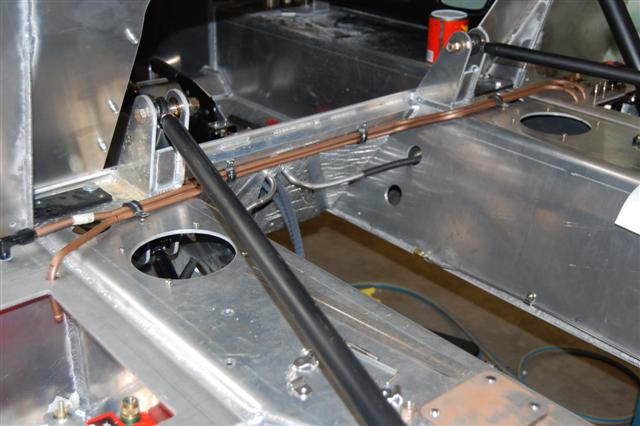

8th photo: Battery installed in the left-hand side of the chassis. Also ran the battery cable through the chassis to the rear.

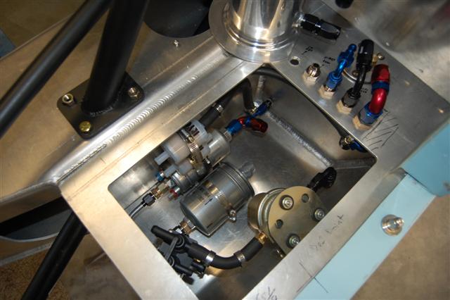

9th/10th photo: Fuel system install. Not finished yet as this is a major project. Installed in the chassis on the right-hand side. Low pressure filters, lift pump, high pressure filter, efi pump, fuel changeover switch. Also ran hard line from the opposite fuel tank for feed & return line.

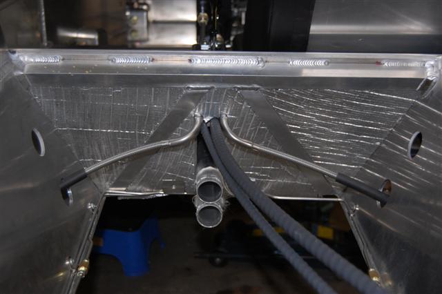

11th photo: Insulation. 1" aluminiumised foam for lower bulk head. Aluminiumised cloth for bulk head inspection cover. Also covered the coolant tubes in aluminised cloth to stop them conducting heat into chassis, should stop a few rattles as well. They are now a snug fit.

Good progress, looks great. Impressive datas on your race engine, should have some piston speed with that stroke and rpm .

I'm pleased with how the engine has come up. Its torque curve seems pretty broad. The dyno results were with 750 carb and victor intake, so with the multi-throttle body injection, it should go a bit harder.

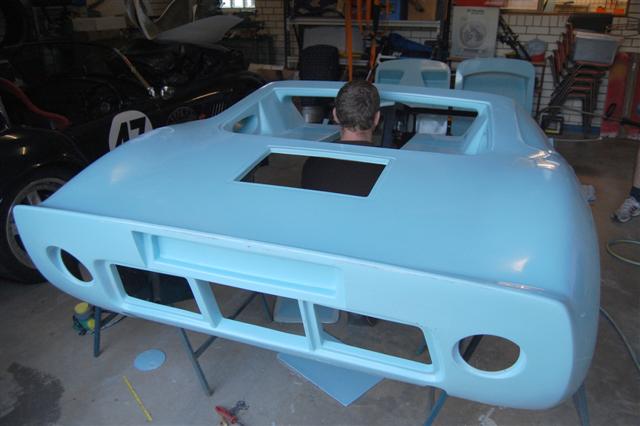

Gel coat ?? What happened to the blue body ?
