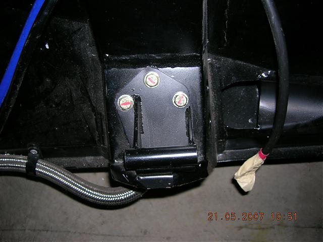

RJ
The SPF comes with engine mount "points" that are bolted to the tub but it does not come with the rubber or urethane "mounts" that bolt to the engine and fasten to the "points". See photo below. You should have one of these on each side of the tub when you got the car. You need to get your own mounts to fit your application. Your "install kit" would not include them unless you paid extra to get them.

Best if you do not use rubber mounts...With the transaxle so ridgidly mounted poly mounts will offer the least movement and be best compliant with the crossmember transaxle bushing mounting scheme.
