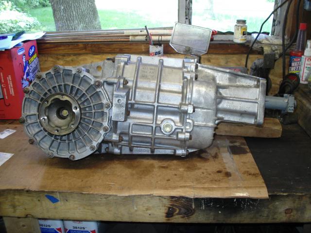

The 944 cars are about 2200 lbs.
You're about 800-1000 lbs short. Try 3000-3200 lbs. I will have mine down to about 2700 lbs but I have fiberglass front fenders, hood, front bumper/spoiler, rear bumper, sunroof delete and non-pop up headlights. To get below this you need to gut the interior, remove the A/C, power windows, use a plexiglass rear hatch, fiberglass doors. The GTR and GTP race cars were about 2000lbs. and the D-Production cars were about 2200 lbs.
We have a guy with a supercharged LS1 in his and he drag races it often. He dyno'ed at about 600 HP and over 450 Ft. lbs. at the rear wheels. Another has a GSN turbo V6 also running about 600 HP at the rear wheels. Both cars have a 951 (944 turbo) transaxle. The guy with the LS1 also had the internals cryo treated.
The 951 transaxle is a pretty stout piece but not unbreakable. With a little machining you could put the internals into an AUDI case.
Although I am using a G31 in mine. It is much stronger than the 951. Unfortunately not really usable in a mid-engine car.
