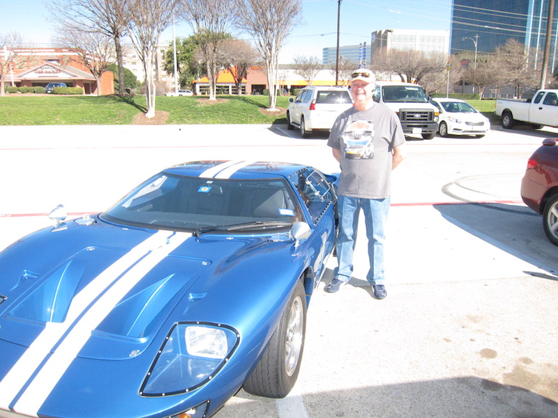

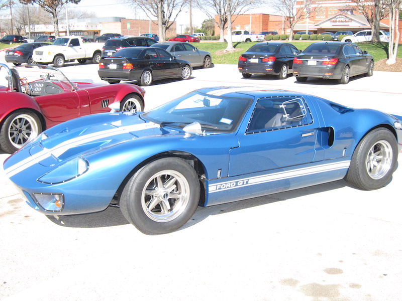

Good seeing you today. The car looks and sounds amazing. Really, really nice.
Thanks, good to see the group and show off a little! Weather hit the 70's (F) in Dallas today, so the Cobra's needed some adult supervision :D Note the correct way to park a GT40 in a crowded lot is being observed here ...
