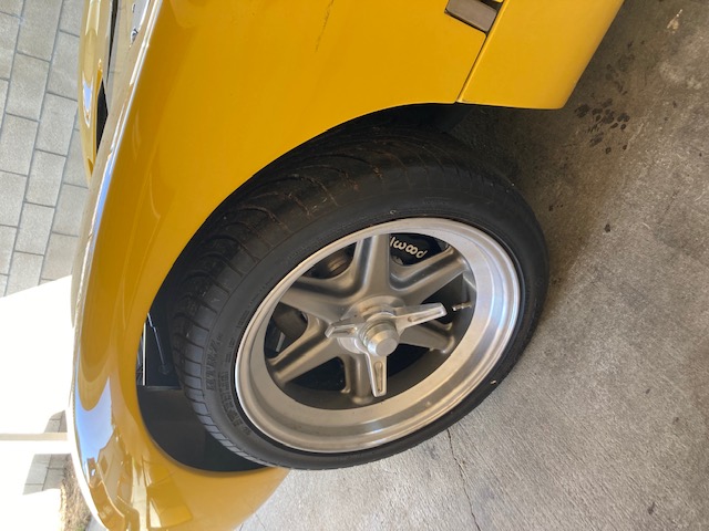

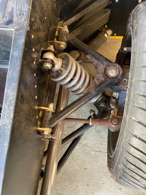

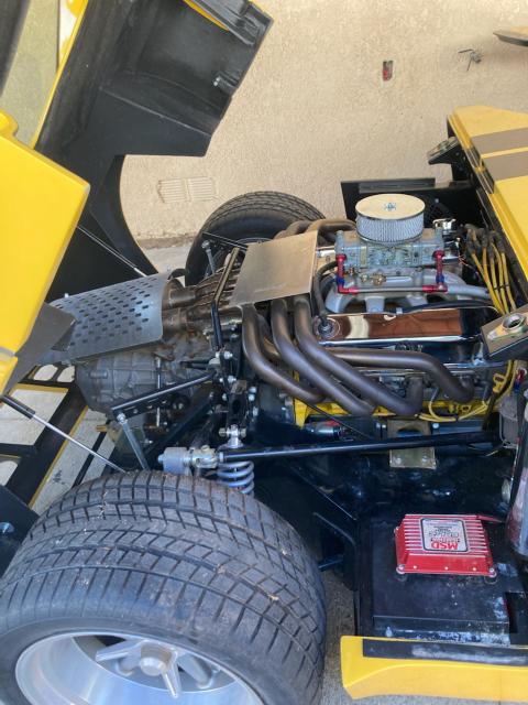

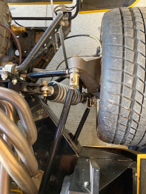

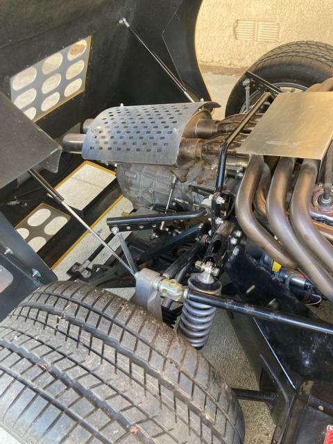

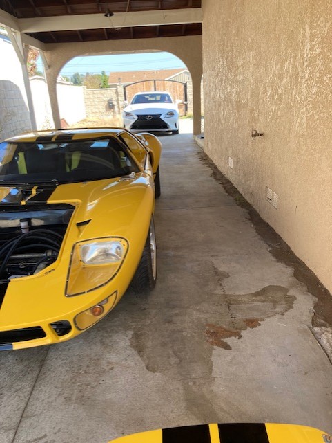

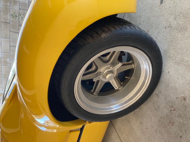

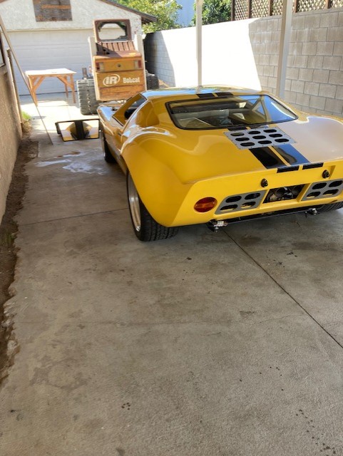

Just arrived in Southern California from Albuquerque. Still need some work but the car is mostly there. ZFQ transmission with supposedly small block 427. Have a couple questions hopefully I could update in the future once the car is running and registered. Currently car is running 17x8 and 10 vintage wheels. Tires doesn't run out close to the lips. Wheels backspacing does not look correct. Is this wheels for narrow body? Is there wheels available for wide body? What wheels and tires option do I have to make it look better? Front A-arms look like older style. Are they ok or should I upgrade to newer style if they are available.

Hi Dean,
Be prepared to be the center of attention where ever you go the that car, looks fabulous!
The front uprights are third generation and began appearing in the post s/n100 CAVs. The upper control arms also changed with the uprights. The front lower a-arms also changed, however the track width remained the same. The final four corner alignment will fix the wheelbase and stance, not to worry about it. Wheel offsets and fender clearance also work themselves out at the same time.
