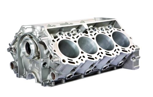

FR9 has pushrods alright, none of them new fangled 4 valve head things!

If you go Aluminator, you'll want the "new" one that is Coyote based. You'll want or at least I'd want the one for forced induction. Hellion has pumped 1200hp through these as from Ford. If you get an older "Aluminator" (equally as strong, but give up the weight and head flow of the Coyote for a mod/aluminator. Why Ford kept the same name is probably marketing but makes little sense to me) it'll be the 4V mod motor but only old stock or second hand as Ford has stop carrying them.
