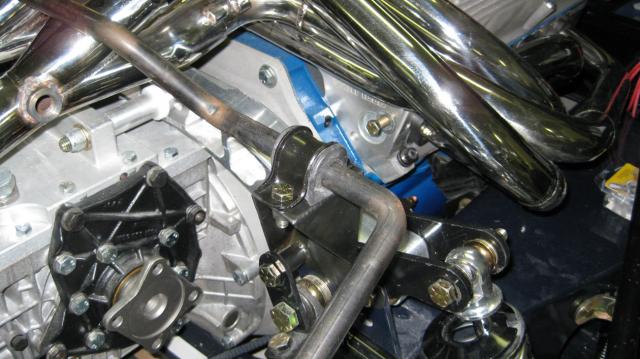

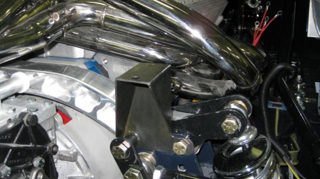

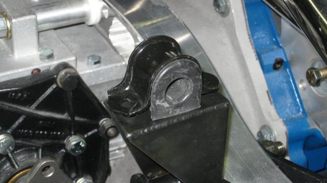

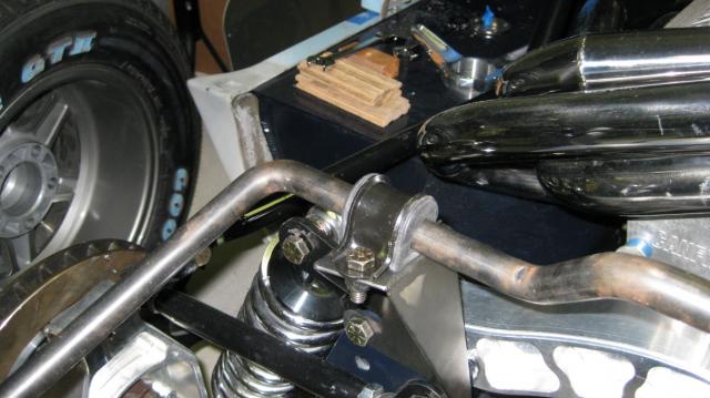

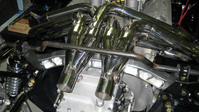

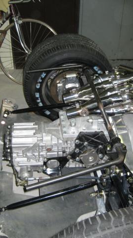

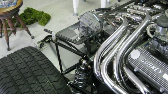

Continuing from a previous post, buddy Bill Tuttle has pulled together more of the rear stabilizer set up. In the pictures you will see the latest rendition of the mounting brackets, bushings and brackets from the local Nissan dealer for a 280Z. Pictures of the bar set in place without the down rods, which are yet to be measured and manufactured. Maybe this weekend, we'll see what happens.

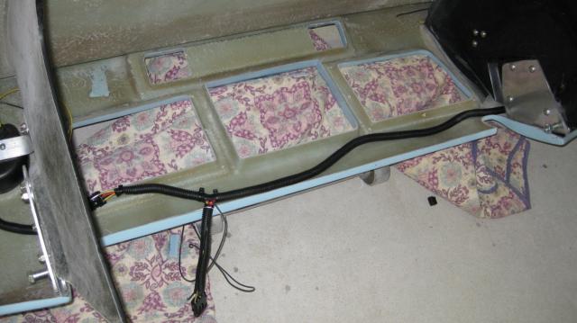

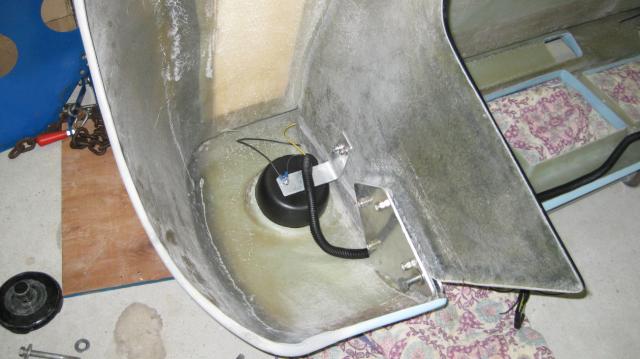

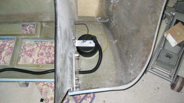

Wiring the back...
Finely spent time wiring the rear clip...lights, lights, lights... I used a Genesis weatherpack kit worked quite well. It is quite easy to use.

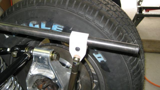

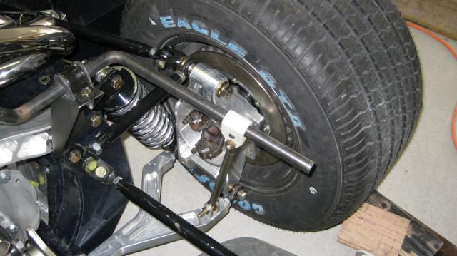

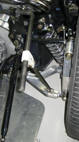

The first of the two rear stabilizer down rods is here. Bill Tuttle brought it by for a fitting. We put it on, it looks to be a perfect fit. One side down, one to go.

A question for my GT40 brethren out there in GT40 land
Any suggestions on the best exhaust manifold gaskets to go with SBF Canfield aluminum heads?
I think Canfield has gone out of business or I would call their tech line.
Thanks for your input!
Howard
Howard,
You are really moving along. Great work. I would think that any of the aluminized gaskets like Felpro or others would do the bit. I took mine and cut the gasket for each cylinder. Just looks neater that way. I had to trim down the studs on two cylinders after the 12 point nuts torqued the gaskets down. The transition from square to roound made it difficult to get the wrench off the nuts. I will be updating mine soon.
Bill,
I pictured buying something for this car with out cutting or hacking on it to make it work out of the box/carton. Maybe I am sadly mistakened! :laugh:
Thanks for the info though. I was hoping someone with those heads had made a discovery and could point me in the right direction.
I can cut though!
Cheers,
Howard

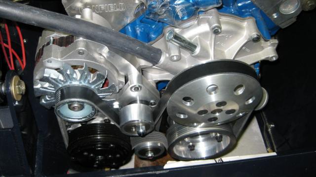

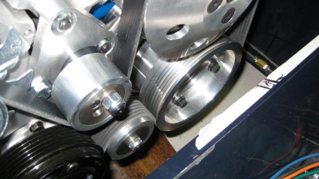

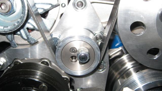

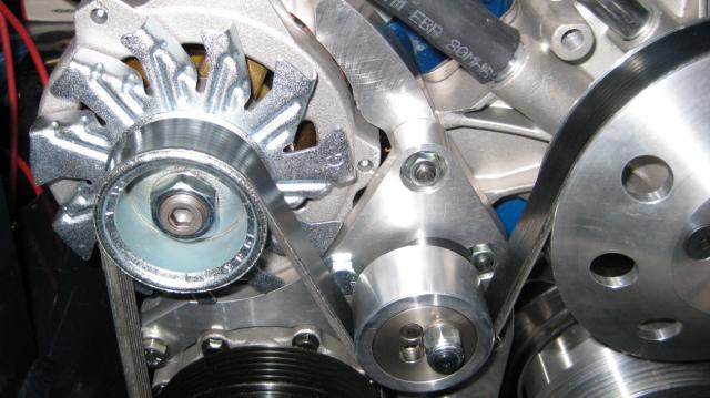

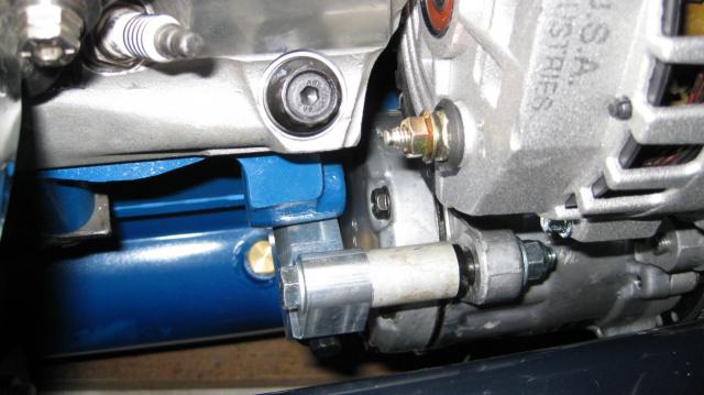

Here's some of the latest progress pictures of my car. John from the previous post made up some parts for me in his shop. They are a set of serpentine pulleys, a mounting bracket for the A/C compressor and alternator. A separate bracket for the back of the A/C compressor to the block, a free wheel and a tension wheel. The work is outstanding.
The system is designed for ease of use. The parts are all custom made and fit nicely between the engine bay walls and the trailing rod mount for the rear suspension. The entire set-up works without a fire-wall bump out. The timing mark is accessible and nothing is bumping against the block, the alternator clears without any problem.
The engine was moved back about 1 inch.
Thanks Brian and John at Design Enterprises. :thumbsup::thumbsup::thumbsup:
Howard
Pat Buckley
Howard -
No I didn't - I just made sure they matched the ports - and I did use some of the aforementioned RTV with them.
REMEMBER to tighten the primary pipes to the heads first BEFORE you try to put the collector on!

very nice pulley system. The waterpump pulley seems to be quite big in diameter. Usually the are app 2/3rd of the dia of the crank pulley. So i wonder if it will run fast enough.
TOM

Really enjoyed your build thread. That new belt sysyem is very cool.
My 2 cents worth on your headers. After many years of dynoing engines and changing headers a dozen times a day and using every type of gasket avalible believe me the very best is none at all !
Hi temp RTV wins every time, it doesnt leak and will last the distance.
BTW: Engines that turn high RPM need bigger water pump pulleys to slow them down and prevent cavitation,
