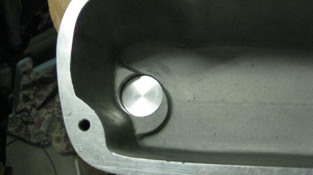

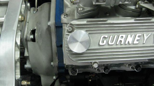

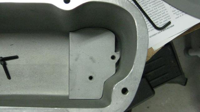

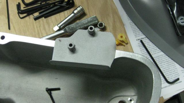

John Schriver machined my valve covers for breather holes and a screw-in oil filler cap. There are custom oil splash baffles for the inside of the breather holes. The oil filler plug seals with an "O" ring. A couple of lines and I will have them attached to the oil puke tank. See pictures attached.

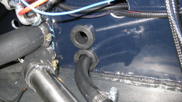

I have the front of the car pretty much ready to go. The heater hoses pass through the front bulk head and are insulated from chafing with standard oil filler grommets purchased at the local auto parts store. The 5/8th inch hoses are a snug fit but a little liquid hand soap did the trick. (Nothing like a little lubrication to make things work.) The Isis Power Cell supply is mounted on the upper right hand side of the bulk head.

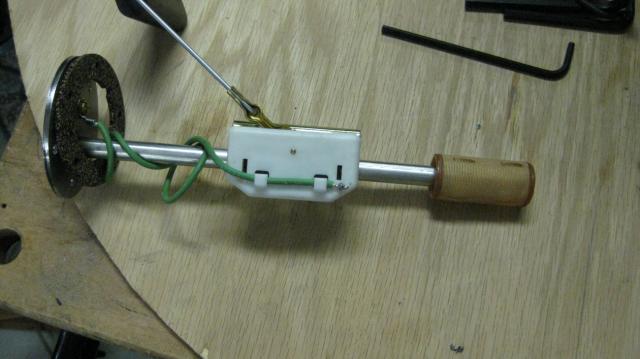

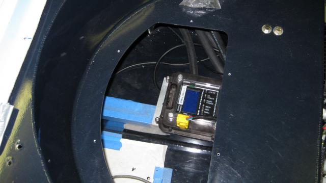

A couple more details... the Isis master cell is mounted forward in the passenger foot-well well forward of where any feet will reach if and where the access panel can be removed and the computer can easily be read from the passenger side from outside of the car.

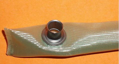

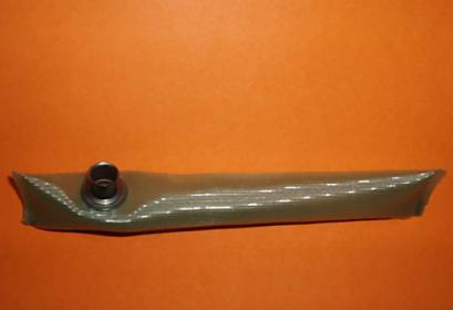

Another little add on is a Ford fuel strainer for the end of the fuel pick-ups which will feed my swirl pot. This was an idea from my friend Big John as opposed to my friend (little) John. :laugh:

Just a quick thing to consider RE your filter on the pickup.
Personally I would not put a filter on the pickup in the tank for a number of reasons.
1. When the filter blocks up with all the dirty fuel from the servo's you won't know until the car starts to experience starvation.
2. To check or service the filter means you have to dismantle the pickup and your fuel sender each time.
3. All the debris gets left in the tank to build up over a period of time.
A much better way is to leave the pickup pipe open and put a good quality filter separator outside the tank before the fuel pump which will keep all the debris from entering the pump but with the added advantage of syphoning all the crap out of the tank which then remains clean and allows visual inspection of the filter bowl to check for dirt and / or water that can be easily emptied, cleaned and refitted with a minimum of tools and fuss.
Just my two cents worth but works for me.
Dimi

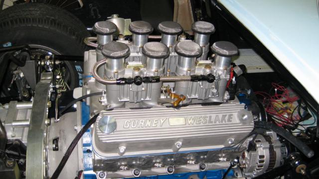

We had that debate up front for the strainers. I agree with everything you have said and I am even considering not even using the tubes at all in the long run. I am using the Dynatek Classic fuel injection (seen in the last valve cover photo). I note from your posts you always seem to have good answers. The reason I am starting with this is the tanks are aluminum, new and clean. I am just moving the gas to the swirl pot then to a two filter high pressure pump system for the EFI. I am currently studying the use of internal fuel pumps in the main tanks to the swirl pot. They are not moving gas directly to the engine. The root problem is hanging three pumps and all their filters and fittings in the engine bay. It starts to look ugly! The two strainers and the other filters come into play before fuel hits the injectors. Thanks for joining the discussion. If you have some more ideas please let me know, I am into studying every thing.

The main reason I said anything is that, the same as you, when I built my 40 I had brand new clean stainless tanks and the amount of debris that has accumulated in my filters from dirty petrol from servos has me amazed.
I have done 15000Km's in my 40 the last 2 years and to collect so much crap in the fuel in such a short time is incredible.
If you are going with internal fuel pumps in the tank then you have no choice but to put filters in the tank as well but it means you will have to be very thorough with your maintenance on a regular interval.
In all my cars I have found the most reliable way of handling fuel is to go from the tank straight to a filter and then to other components which means only clean fuel will run through pumps, swirlpots etc and not be allowed to contaminate or build up in these other components

RE: Fuel strainer
It really is a dual purpose device;
1) Obviously to filter out large particles to keep them from compromising your fuel pump
2) Decreases the potential for cavitation on low fuel levels my increasing the surface area of the inlet.. (Ever wonder why oil pump pickups aren't just a tube stuck into the oil?)
I'll be using fuel strainers on my inlets, but they are much larger(Pics below)
I bought a few of these from a seller on eBay;
3/8 gas fuel tank sender side pickup line strainer,carb: eBay Motors (item 180537135344 end time Aug-02-10 18:56:47 PDT)
If you chose to not use strainers, you may want to create a couple of Duck Bills (some people call them Duck Feet). At any rate, I've made my own before and they're really quite simple to make. Picture below has all the info.
Just have enough of the Neoprene tubing so that the duck bill lays on the floor of the tank..
I hope this helps...
