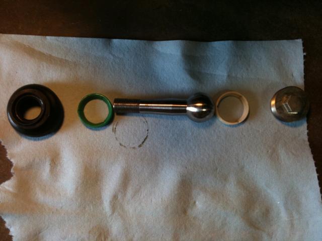

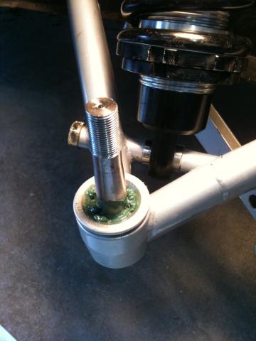

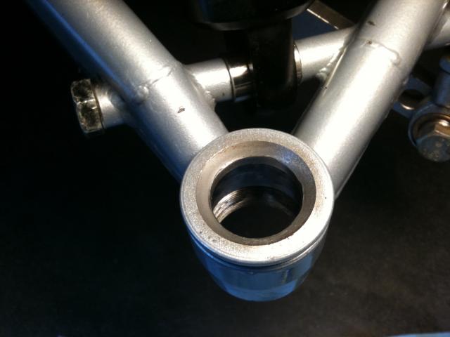

I'm doing some prep for an up coming event & decided to give the front suspension a complete inspection since I haven't had it apart before. I found a few things that may be of issue-

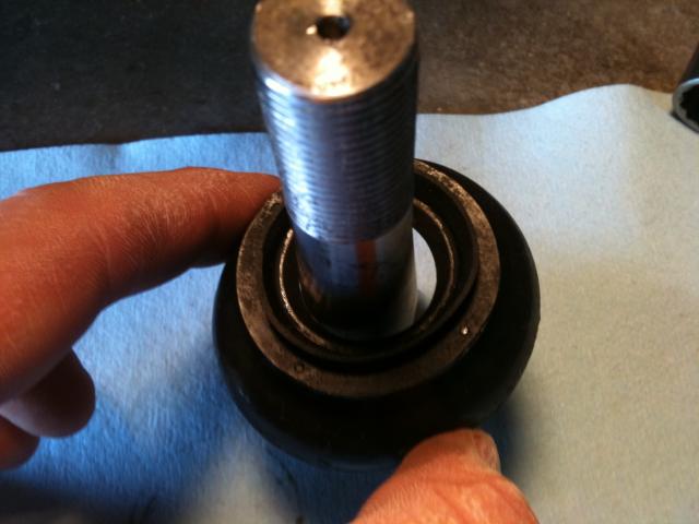

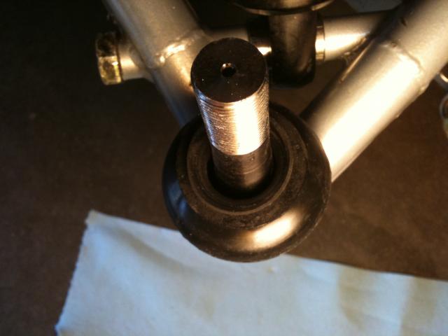

1) The lower ball joint sealing boot is not the correct size, as you can hopefully see in the photos it does not seal around the ball joint shaft. I did not find any major debris in the joint but I'll have a hard time sleeping at night if it's not sealed properly :) Is there an updated boot?
2) Is there a torque or recommended procedure for adjusting the lower ball joint? I'm comfortable doing this by feel alone but if anyone has specific info that would be great to post it here.

Are you talking about the pivot bolt on the upright or the ones on the tub? As to the rubber boot I had mine apart once and I think it fit tighter than yours, but it seems to seal pretty well vertically anyway. Does anyone know what vehicle the plastic races for the lower ball joint come from? I had mine replaced on a warranty claim and the part bag was a South African company, but I couldn't reference the number.

The lower ball joint is pretty simple - there's a threaded "cup" on the bottom of the joint that you must remove, then thread the nut back on the spindle to avoid damage to the threads & gently tap it downwards. In my case the plastic bushing rings came out pretty easily by using a small pick to work them out of the housing. If the spindle takes more than gentle taps to remove I suggest using a brass or plastic hammer.

I did find a set of boots that fit very well, but unfortunately I failed to get the part number for them! I ended up going to a local company that specializes in polyurethane bushings, bump stops, etc. & they gave me a set gratis! I was so happy to get something that worked I walked out without getting more details. However - if you have your car apart & can measure the joint you can find the correct piece Daystar's catalog. From memory the correct boot is the smaller of the two closest sizes.
