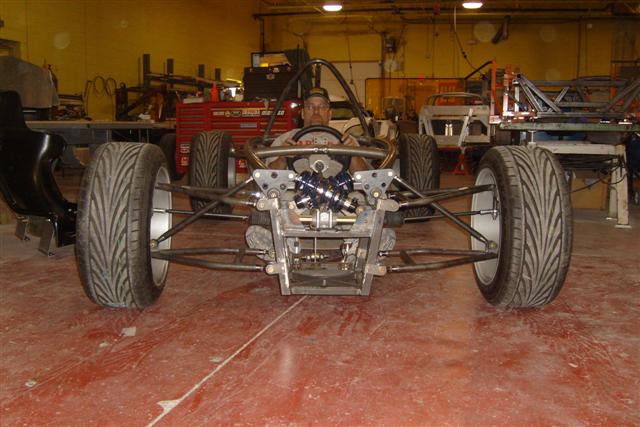

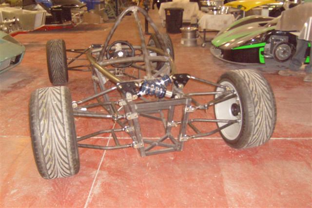

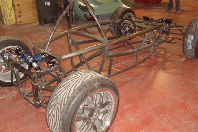

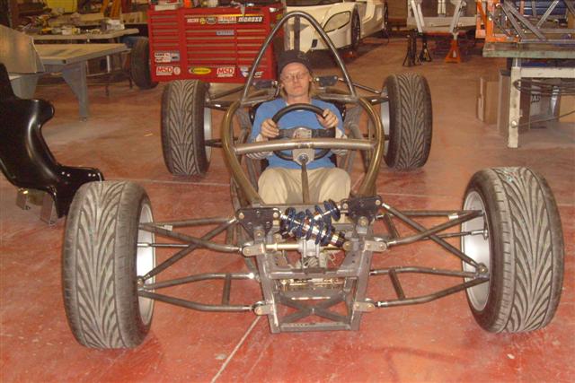

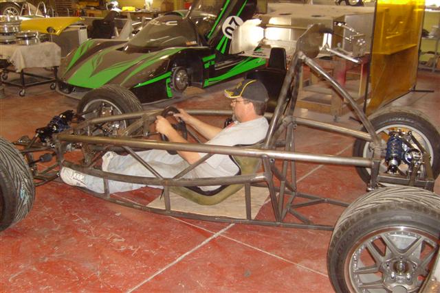

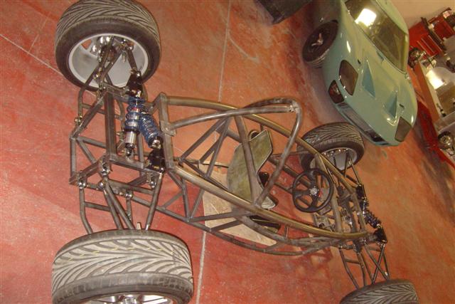

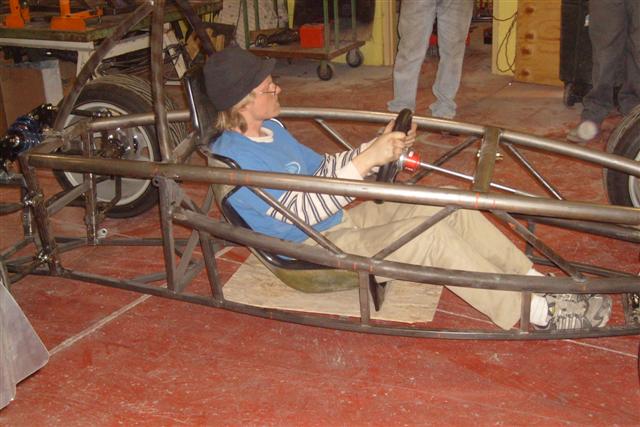

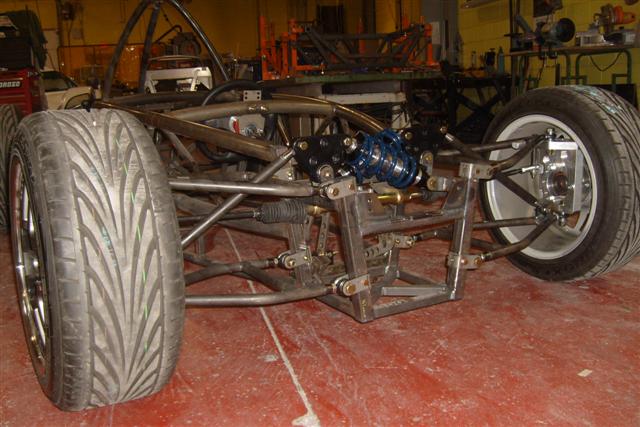

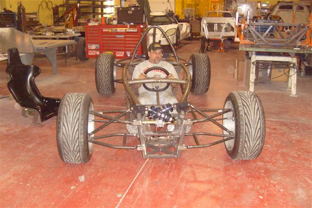

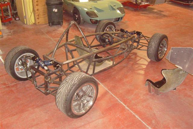

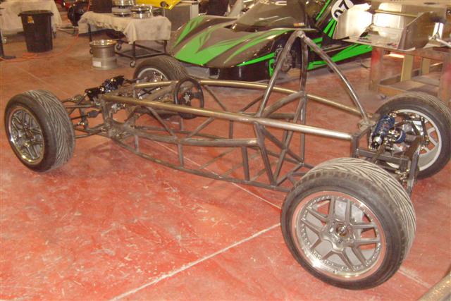

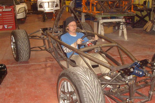

Fran - I love the car, the concept and the progress...

Carry on!!! I'm loving it....
BTW - I hope that your suspension members remain mild steel - that way their replacement will be more affordable! :)
Thanks Randy...
I had a good read through that stuff previously...
There are a couple of little tricks that will keep the Nemesis servicable and on track for longer...
Modular suspension points that are removable and replaceable in the event of taking a corner off the car...
Universal uprights..
Universal control arms
Universal rockers
Quick adjust Camber control function...for F and R upper arms.
Just a few details....
Very good Fran.. I meant to type MOLY steel - but my fingers betrayed me!!!
Do you want to buy one of the first ten???....if so contact me directly....five spots already gone...
The first ten guys will be have the opportunity to acquire a Nemesis at production spec but for a much reduced cost...
