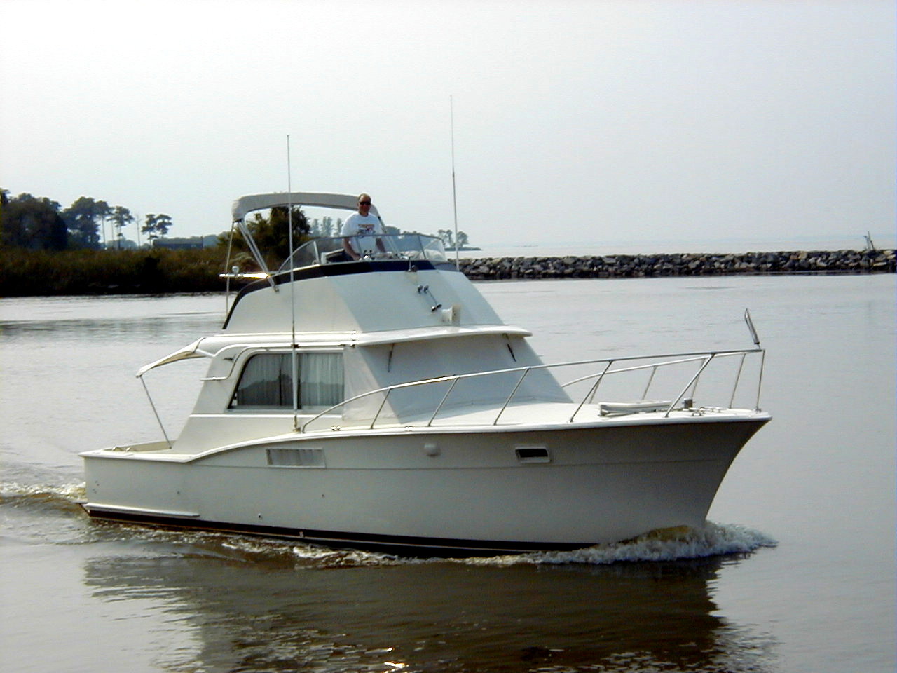

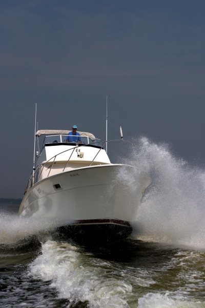

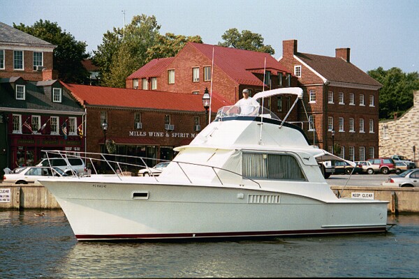

Mine, a few years ago, after a paint job. Still runs just as well, but needs some selective repainting.

Very Nice Jim, is she a Hatteras? I note the wine and spirit store in the background of pic 1. Very apt for all things maritime.
