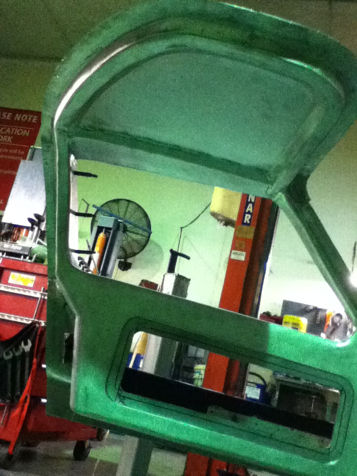

Well the doors a proving to be a real mission.
I will not say how many hours have gone into the L/H door but let’s say it is worth about $10.000.
I will break it down for you it’s about $77 in alloy and the rest is labour.

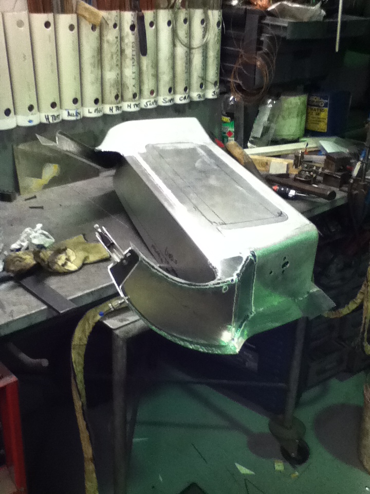

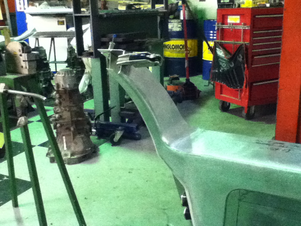

These 2 pics are the pillars being fabed .
This is after a file finish and hit it with the wizzer with 100 grit.

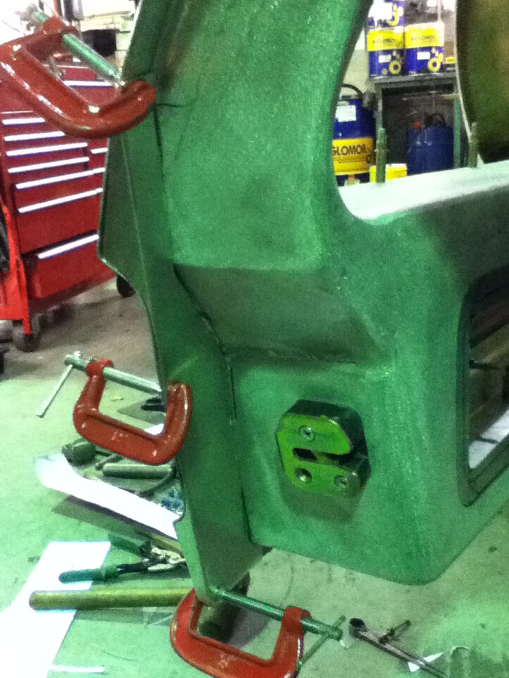

The front section that houses the hinge pin was a pain.
I ended up doing it 3 times, the issue is merging shapes.
You have the lower door, the inner seal area, the gaurd profile to match the front clip.
You have to bring them all together and make them work.
I got it on the 3rd go at 4.30am sunday morning,yip I couldn't let it go.

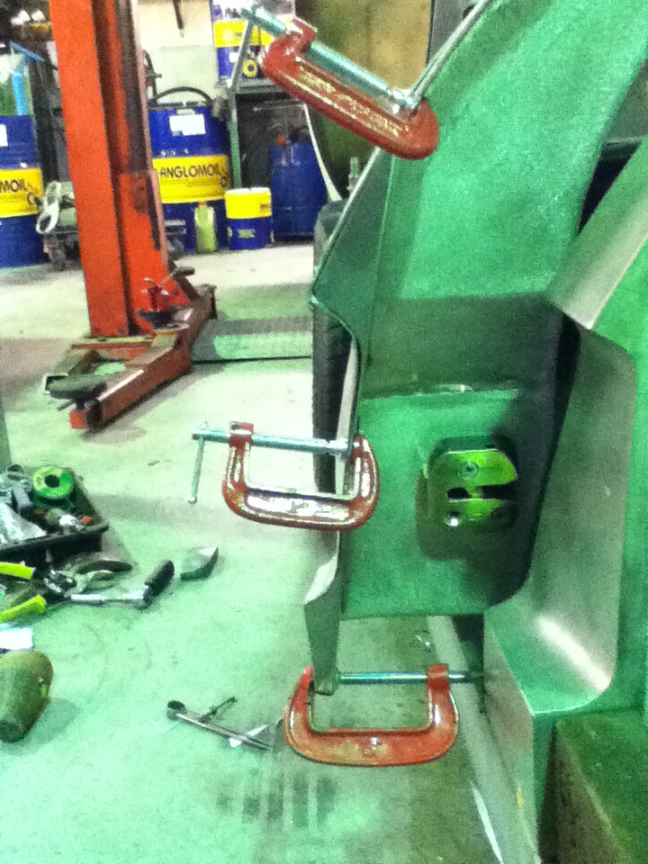

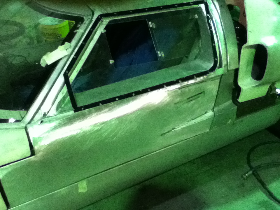

At the rear of the door the seal runs down the B pillar and never sealed in the side vent area of the door.
What I did was make a panel that is bonded in to delete the vent shape in the rear of the door.

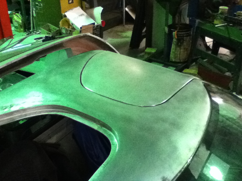

The inner roof skin I looked at for some time to decide on how to go about it.
I wanted to keep some similarity in look but I needed to keep some simplicity in the manufacture side of things.
I am happy with the outcome and it fits pretty good.
I built a flat beam section out near the upper window edge to add rigidity.
The roof section will get foam filled after the outer skin is fitted

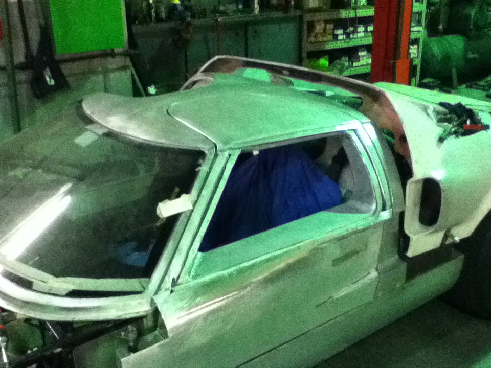

All the flanges for the side window have been bonded in and that has allowed me to make the outer skin.
This is the ruff out stage, the wheeling is done and is datumed onto the frame.
I have cut the side vents in the doors and the lower flange has been turned on the jenny wheel.
I have about 2 hrs work then I should be able to do a fit up.
I will use urathane on the skins as the 8115 will not allow me to remove it if it is damaged in the future.
Petrol inside the door will eat the urathane and allow me to save the frame.
The light bouncing off the panel makes it look average but its pretty good in real life.
Thats it for the moment.

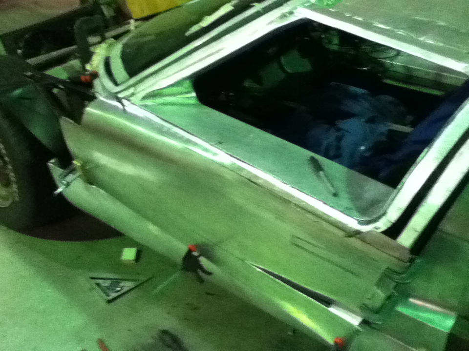

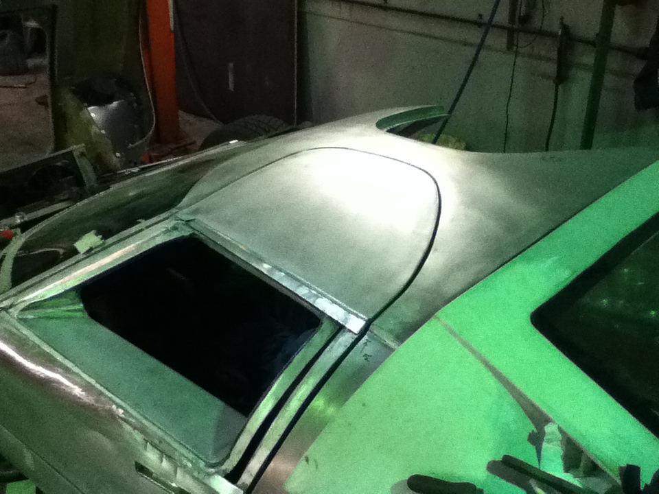

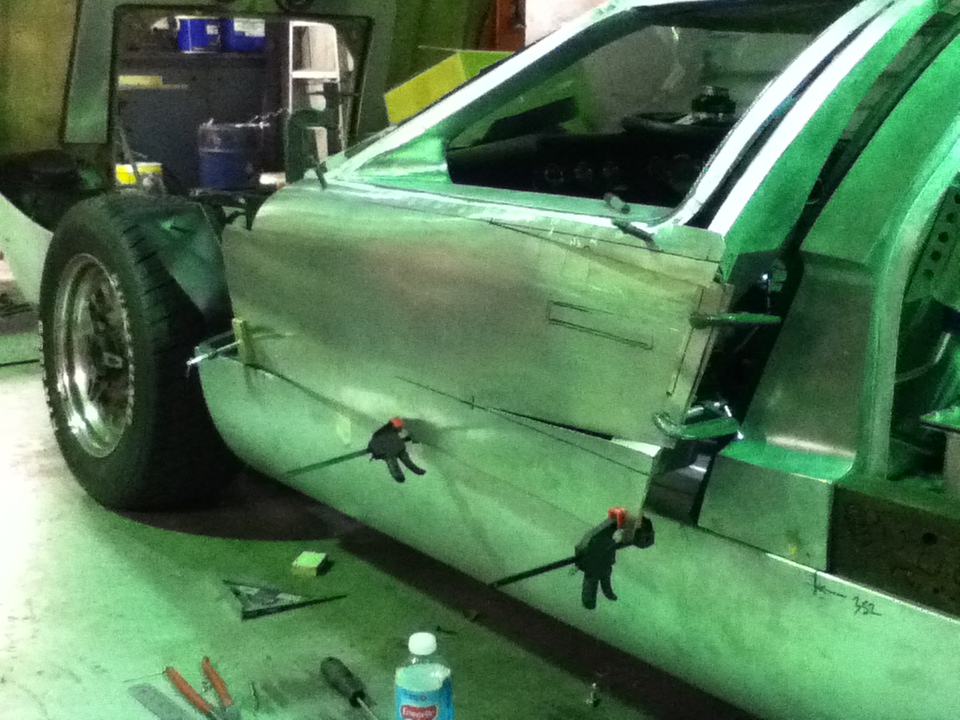

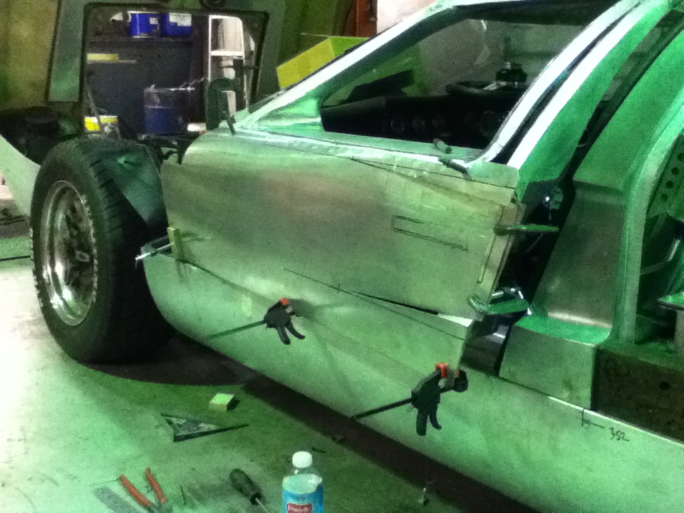

Door skin is fitted.
Glued in the side scope sections in the doors to avoid heat distortion from welding.
Made the roof skin for the door.
I am very happy with this the fit and gaps are excellent.
I have done the pillar skins and the door pocket but have no photo.
I guess I wont be posting for a while as I have to start on the other door and I don’t see any point in repeating the post.
The rear clip will be the next on the list.

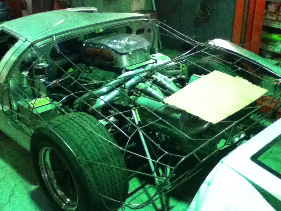

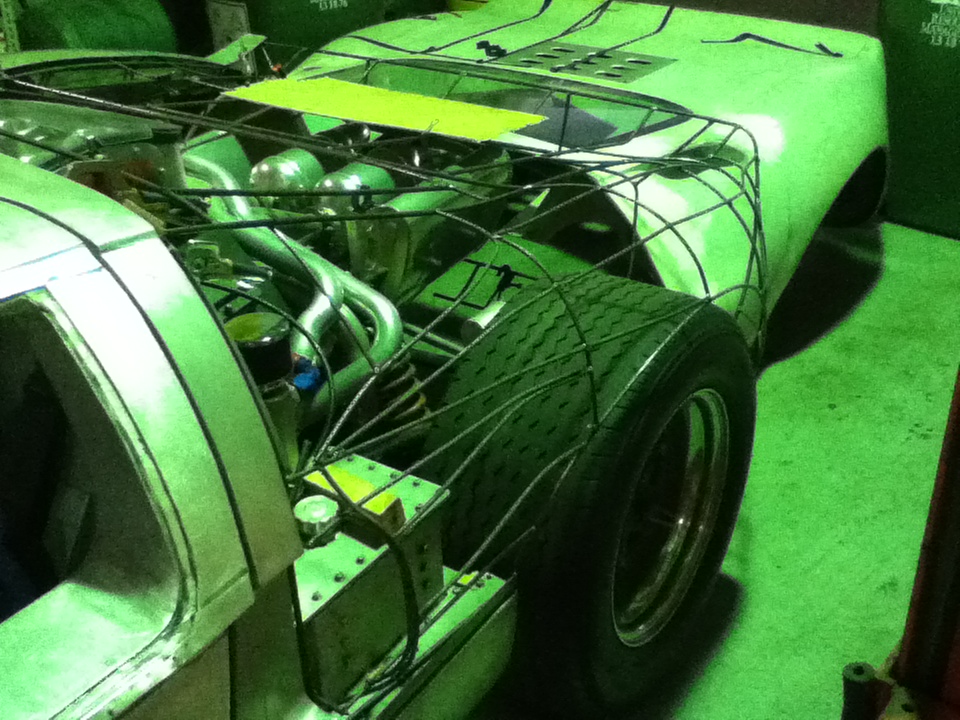

hello jim we must be just about due for an update on 105 alluminium
body sections i doubt you have been sitting still allways good to see
your handy work
chris

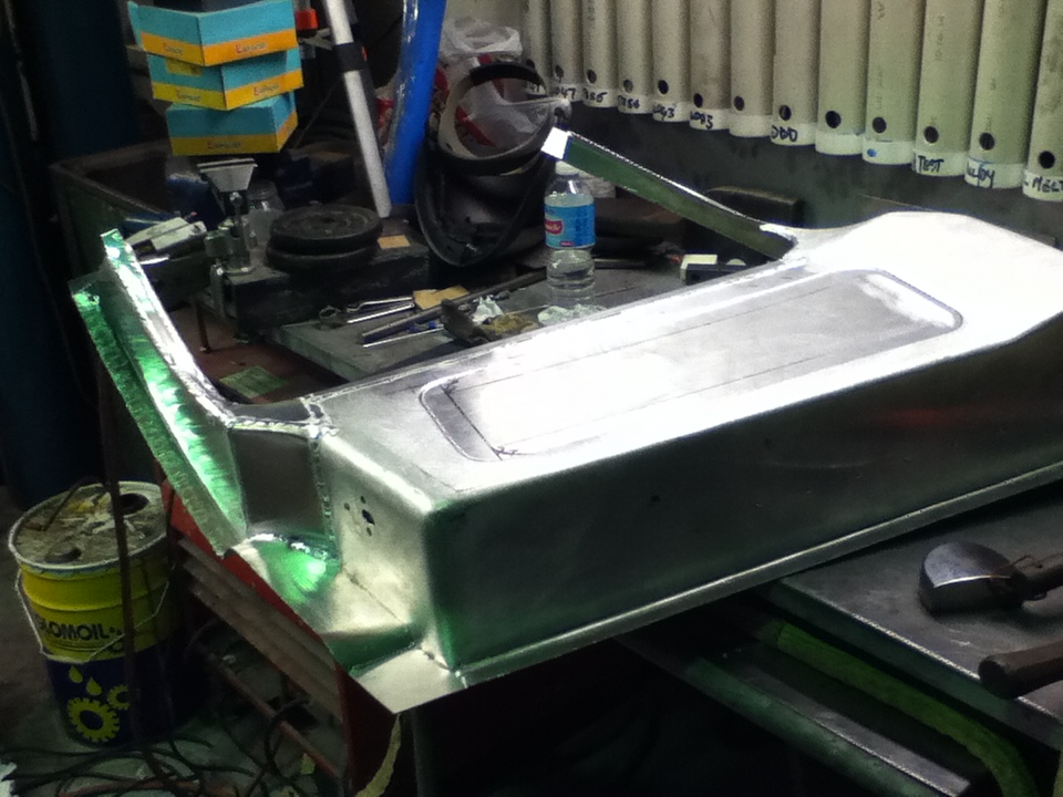

Hi Chris

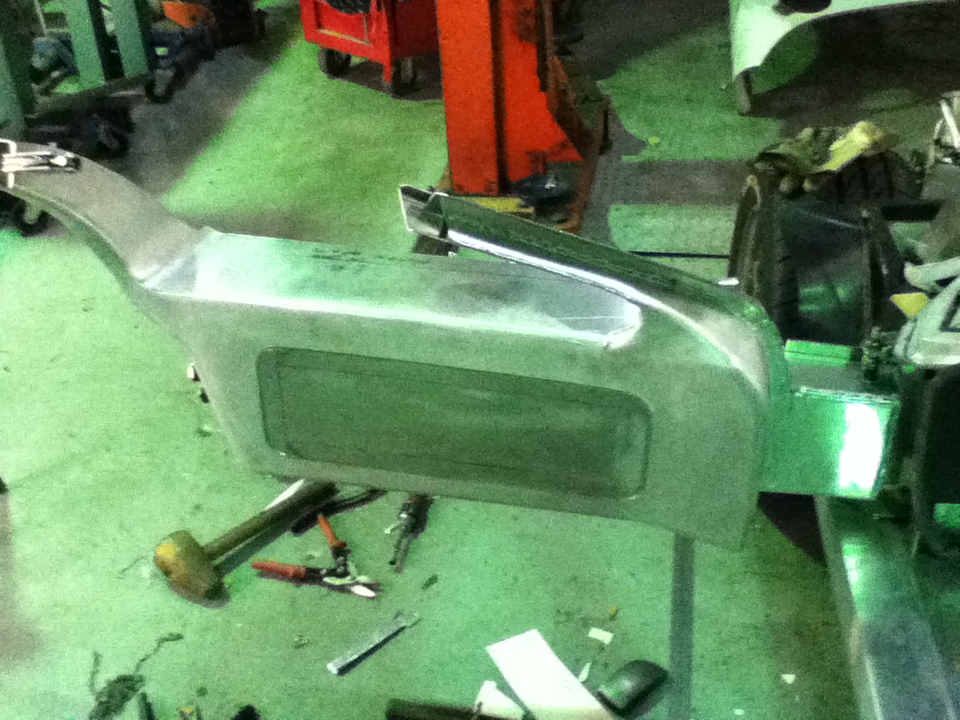

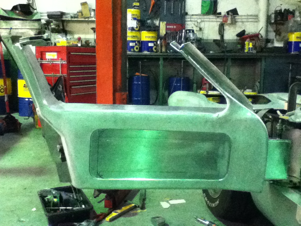

Frame for pattern has been made.
Panels around the window, centre of rear clip and top half of gaurds have been made.
Started welding today.
