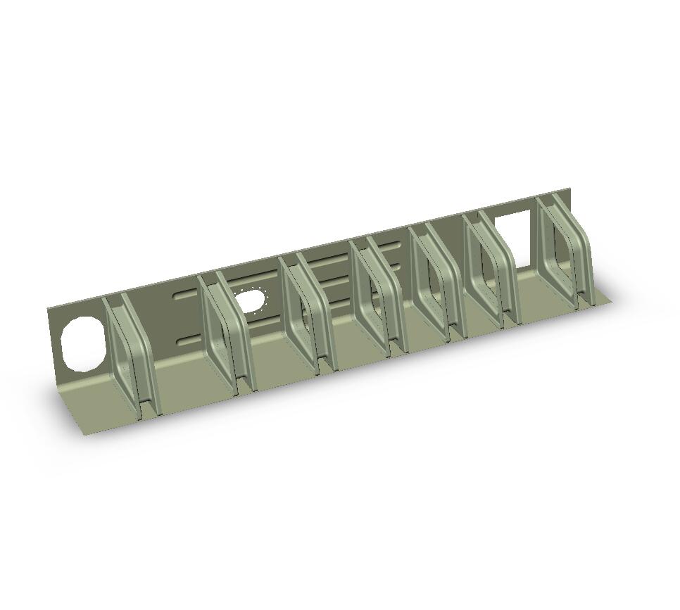

Hi Folks
I am a total newbie at this business of posting - this is the 5th time this damn page has accused me of being invalid. If this works - here is my story. I have for a long long time nursed the idea of having a GT40 in original form - almost 40 years.
Now I have the time and resources to create a complete car in Solidworks CAD - and make many of the sheet metal pressings required. I do not want to make all - too old and impatient for that sort of time. What I can do is set up a site where the drawings are done and can be downloaded by those who want them - obviously I also need people to contribute dimensions.
Anyone with the resources could make some components - and enough doing that should enable access by all to a complete set of monocoque parts at reasonable prices. Here I can handle some of the larger parts and build also an assembly fixture accessible by anyone close to Sweden. My own need is three sets of parts - I have two partners similarly smitten.
Anyone interested please contact me - I have attached (I hope) a drawing in jpeg format from a quick test of solidworks sheet metal tools. It is not dimensioned or detailed accurately. Just a test that took half a day only for the 3 components and the assembly.

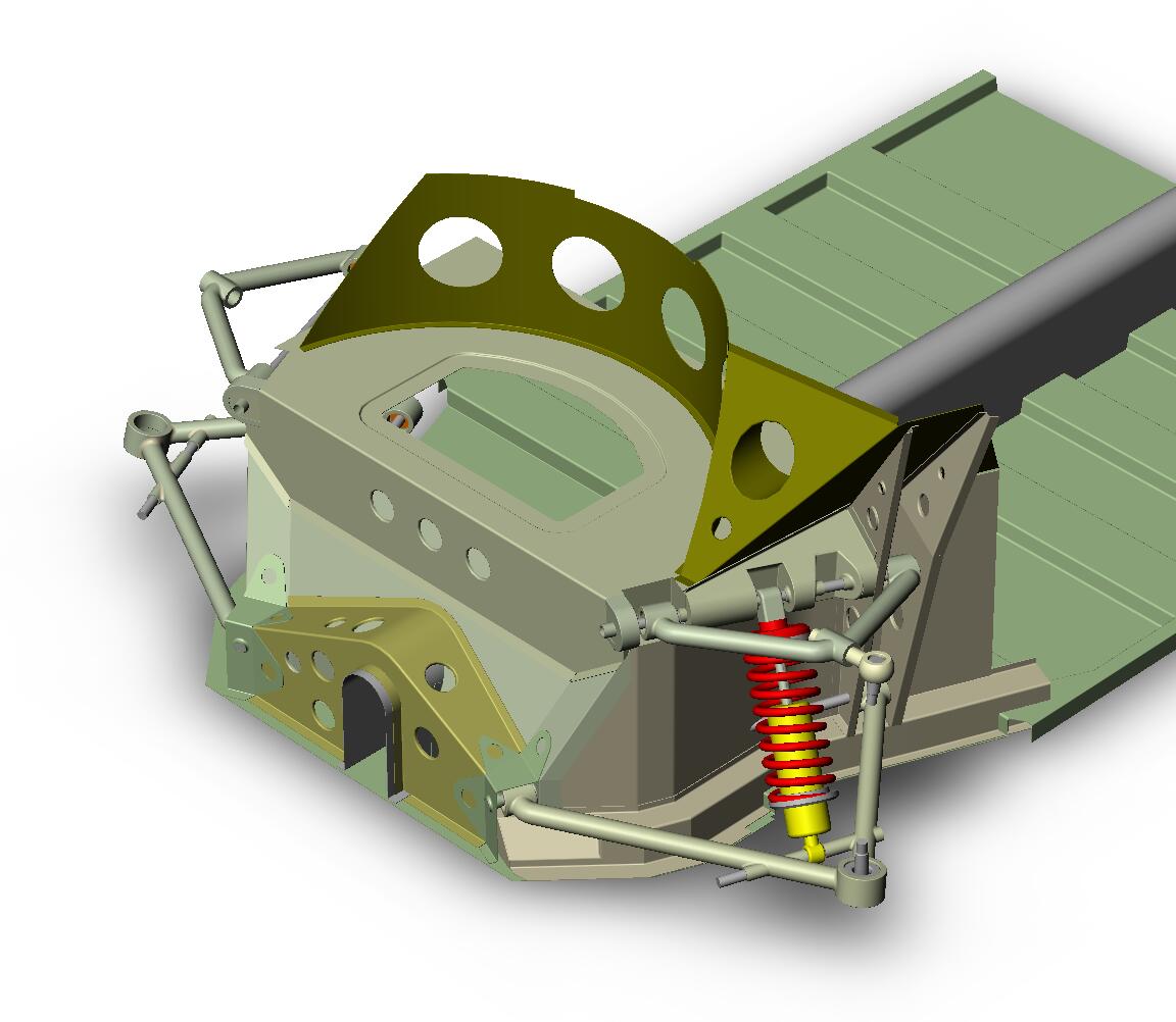

Hi Joe
Had to take a few months to do some unexpected and urgent "proper job" stuff but we are back now into the GT40 drawings. So far back to the front bulkhead with some dimensions to be corrected and the suspension points in the right place and looking good - post maybe attached.
Idea is still to make the component drawings freely available.
Looking forward to some real progress over the next month or so. BTW, both inches, millimetres and the American mil work for me - cm is for European housebuilders - not us old kiwi engineers.
Frank

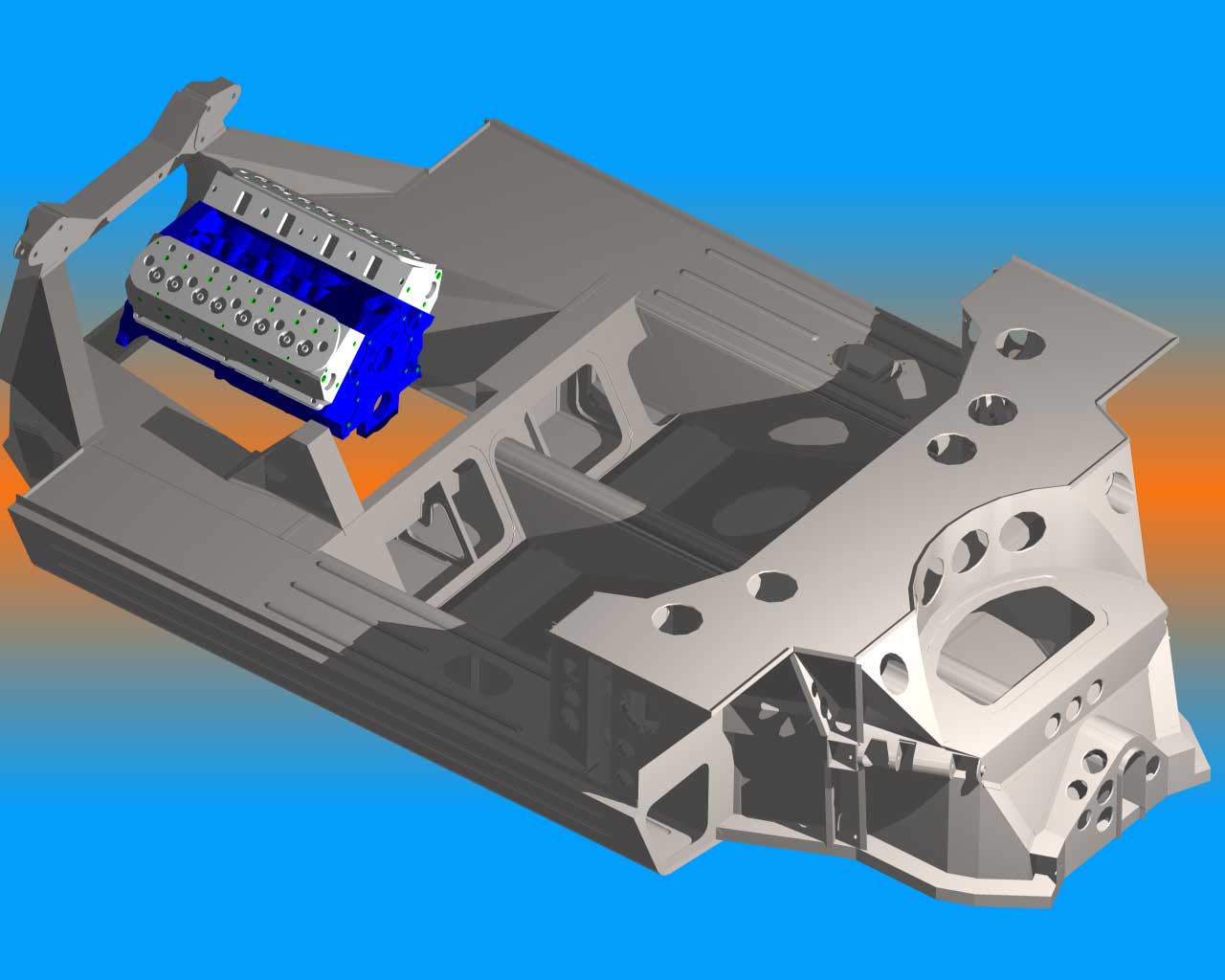

Two can play at this game. I guess it is about time I came out of the closet. Perfect originality is not my goal, but it is still going to be pretty close.
Adam, we have so many stars on this website, it is a veritable galaxy! You guys are just amazing!

Frank and Adam,
Amazing work! This is the stuff that makes our forum shine. I luv it when I see the skills of our members exhibited here. I look forward to the next installment. /ubbthreads/images/graemlins/grin.gif Please stay with it and keep us all up to date.
