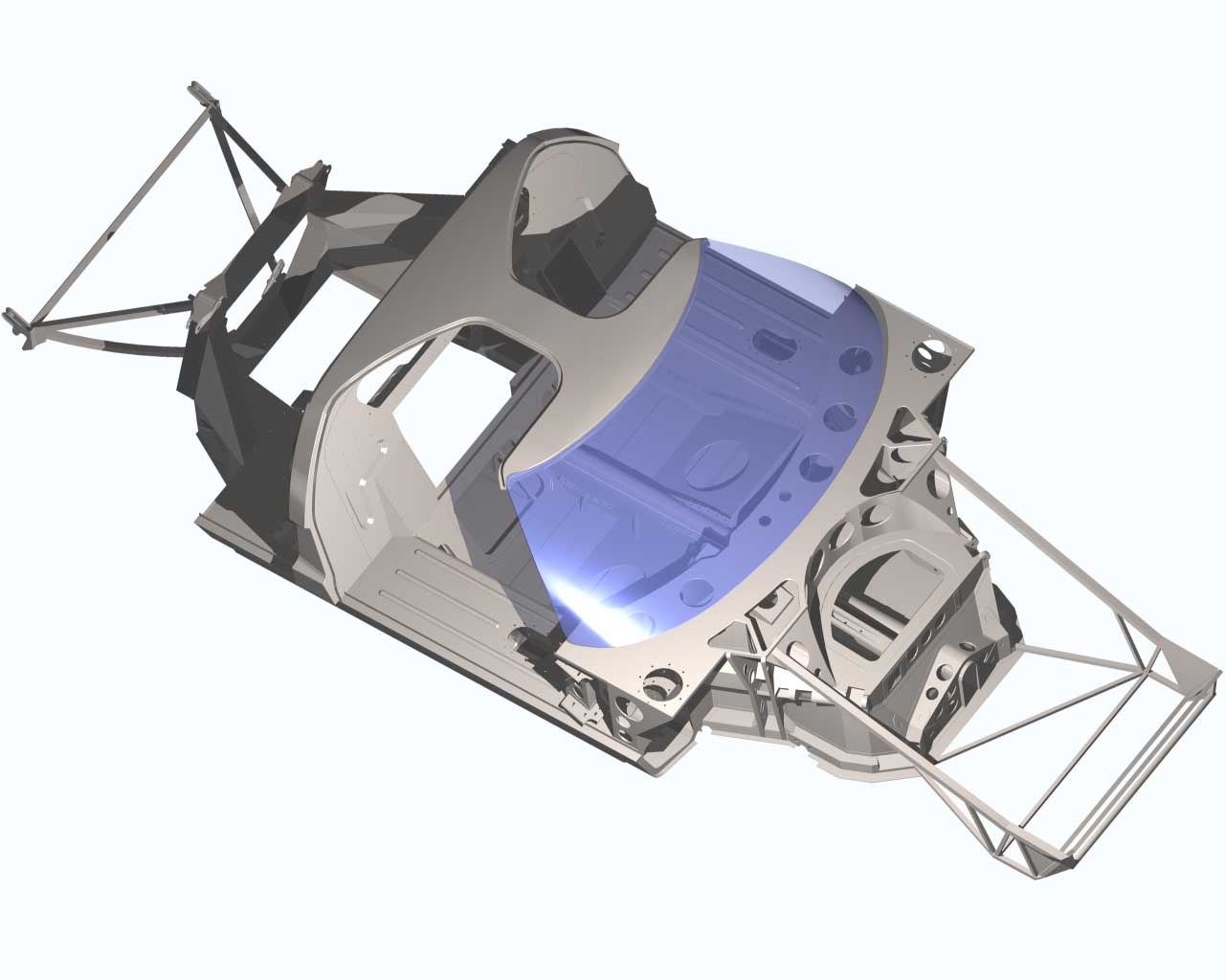

Hey Adam - how did you get the dimensions for modelling the windscreen? Is it pretty accurate? I'm asking because I was hoping we could work something out where we could share solid models (I'm using SolidWorks so they would have to be a neutral format). I am just starting design and although it is not a GT40, we may be able to share other common parts, at least as a starting point.
I am trying to figure out what windscreen to use. I might use an old RX7 piece because it has a nice curve to it, but I figured maybe I should just go ahead and a GT40 one.
I completely understand if you have reservations toward giving out something you took the time to do yourself, I just don't know where to look for accurate dimensions on windscreens.
*EDIT* Oops - just skimmed through some of the older posts (which I did read, but it was a while back) and it looks like you have access to a GT40 and used cardboard templates to measure a windscreen?

My windshield is not 100% correct yet. You can see here how it doesn't match the roof in the upper corners.

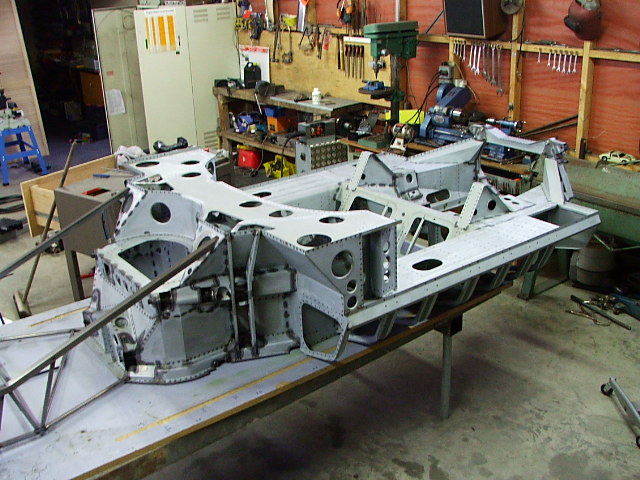

are you making the sheet metal as well or just the cad,
some one asked what tooling is required? I have two on the go to about the stage of your cad model and only used basic tools in a workshop at home will post a pix if I can work out how!
this is now out of date, I made a cnc profile cutter and used dxf files to cut most of the metal, but you can use tin snips as well
