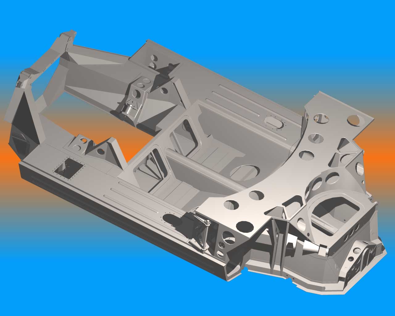

Yet another update. I've been very busy, and so have not been able to work on the design as much. Still, the main chassis is near completion.
Adam - are you going to be forming all that sheet metal yourself or have it done? Just curious how others tackle tough jobs like that without big equipment.
Adam C.
GT40s Sponsor
Chris, Someday I hope to bend up my own. Most of the pannels are just made up of straight breaks and should be easy to do. I will have all of the blanks laser cut, which will make things much easier. For the parts that were stamped I will probably cheat by making them in separate pieces and then welding them up.

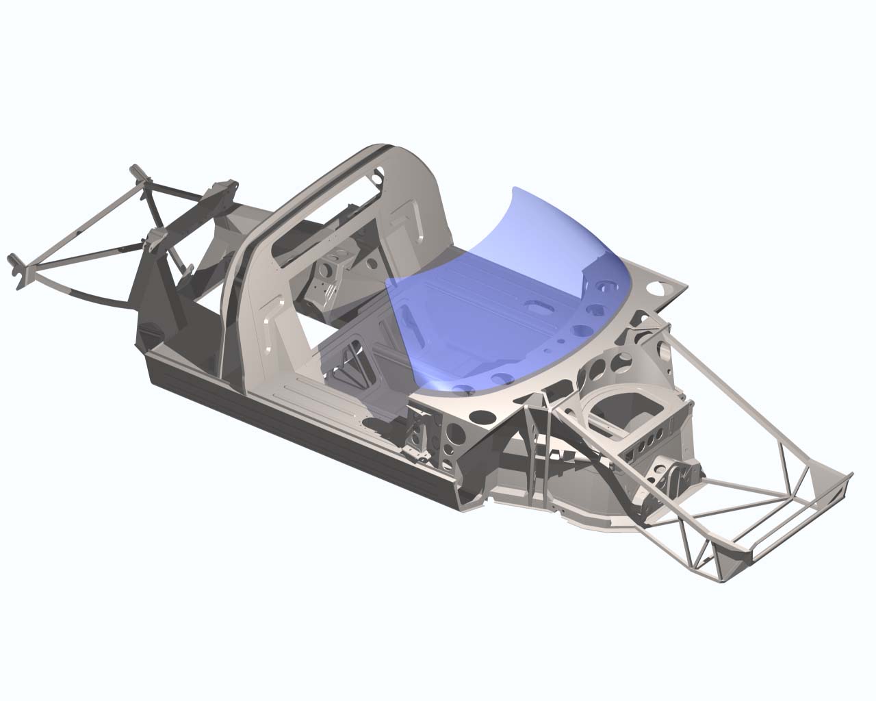

Just need to get a roof on it now. Anyone have a huge CMM or 6-axis measuring arm I can borrow?
Hey Adam, how about a laser scanner for generating a data point cloud?
Just a suggest /ubbthreads/images/graemlins/smile.gif
Looking good!
Rick
Adam C.
GT40s Sponsor
Rick,
A laser scanner would be great. Know anyone that has one? It would be a little more of a pain because there would be multiple scans that would have to be stiched together, but I could probably manage.
The windshield drawing by the way, is copied from the original triplex screen I bought from John Stone.

In talking with some people it sounds like there were measurements taken however, they were probably only of the body outer surface, and they probably didn't remove components to get measurements of the chassis alone. It would save some trouble, but I will most likely have to get these measurements myself.

How about a 3D scan of a scale model instead of a full size car? There are some that I suspect are very accurate.
Adam C.
GT40s Sponsor
Bob, I've been really tempted to do that. I have a couple of 1:18 scale Exotos on my shelf...
I think I am going to give the paper/cardboard template thing a try. It has worked really well for other pieces like the rear bulkhead and windscreen. What we do is trace them on plotting paper and then scan them into my buddies huge document scanner at work. Bring the raster image into CAD, and whola. The roof is more difficult however, because it has coumpound curves. We will have to set up a U-V line grid to trace.
If we can get the roof, the MKI will be pretty much done. Then we can chop it up to make the MKII.
Adam, I'm not sure about your budget but a company in St. Hubert, Quebec is producing (under license from NRC) portable 3d laser scanners for ISS crewmember usage, something to do with quick and dirty scans of parts for maintenance purposes...
It would be nice if one was to find out which true sweeps were used on the original roof in order to create the right curves, I happen to have a table for true sweeps based on the Detroit method.
Just a thought...
