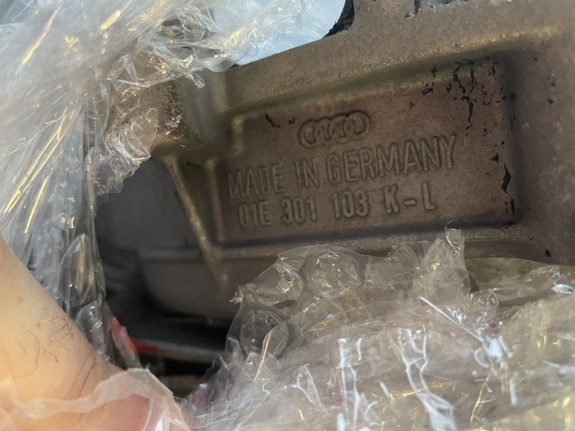

Well the first step has been taken and this little beauty arrived yesterday. Clearly this is the first of many parts but probably one of the most important. I considered lots of options and I know a lot of GTs still run an uprated UN1 but for cost over worry I wanted something that was a little stronger. So here we are my 2wd 01E box DQS six speed gearbox. This will eventually be mated to a 351 block with 400-420bhp.
