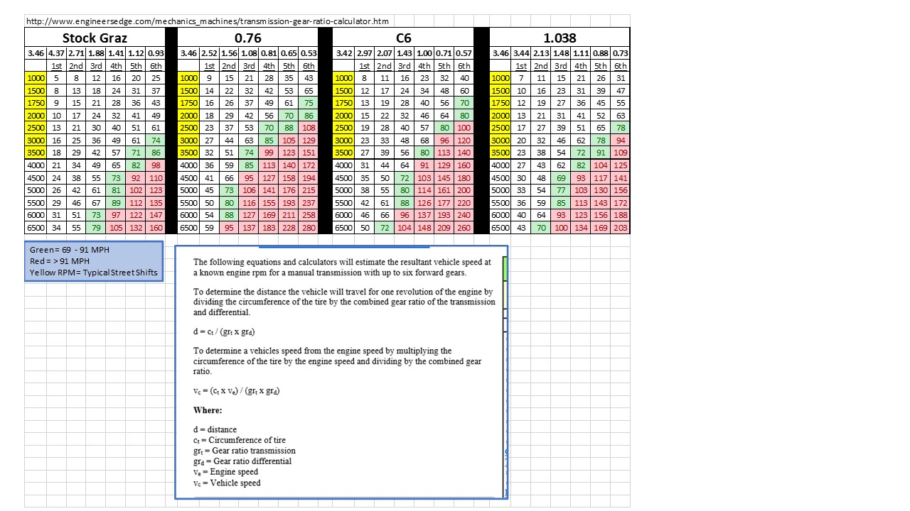

The reason for my post is really wanting to figure out what I have for my own information but also to program the AIM.

Just to update. So I assumed I had the older version of the drop gears based on this chart someone so graciously figured out. I used the ratios for the 1.038 gears and put into the precalc math channels in my AIM MXS Strada and it’s reading all my gears correctly now.
