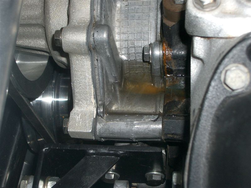

I'm looking for a second opinion. I filled my car with coolant for the first time yesterday. As I was checking for leaks I noticed a small pool of water building on top of the timing chain cover.
The water seems to be seeping from between the block & the timing chain cover.
All my instincts point to the timing chain cover/engine block gasket. Has anyone any experience of this?

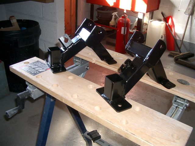

FWIW I fabricated engine mounts for my GTD that allow me to remove the sump without pulling the motor.

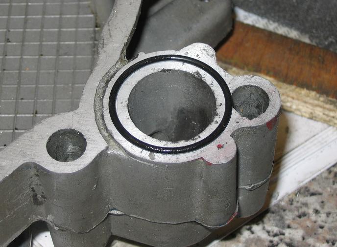

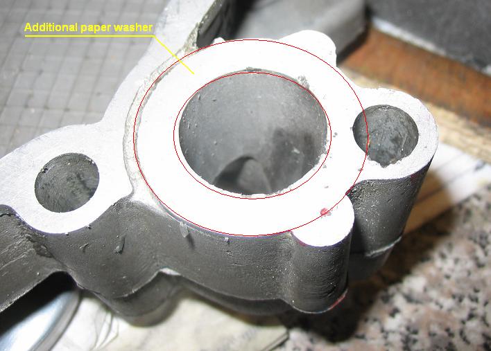

As you say Julian coolant leaks in this area are frequently coming from the distribution cover. Several reasons can be at the origine of this problem:
- poor watertightness due to the aluminum cover sealing surface corrosion (old liquid cooling was without inibitor)
- poor watertightness due to a tired bolt thread(s)
- distribution cover flatness problem due to overheating
To solve the point you have to check the distribution cover sealing surface. If it is not clear and right, bring it to the workshop for honing operation. It could be a good opportunity to check that both cover faces are parallel (that is not always correct) and to machine a groove to install a O ring. If it is not necessary to go to the workshop (may be you are lucky ;) ) you can install an additional washer made of fine paper at each water passage (in front of the gasket) to be sur that the tightness will be more efficient in this area.
