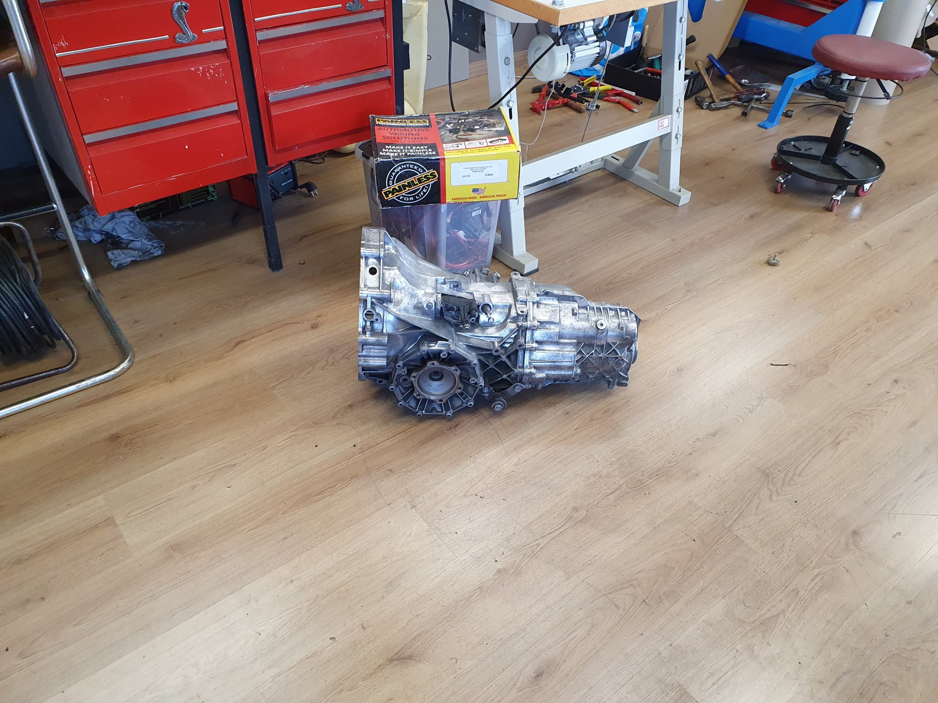

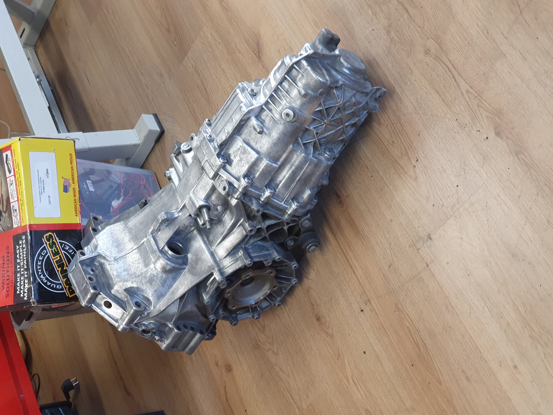

I want to match a 1969 351windsor to an Audi OA2 6 speed transmision.
Does anyone know what i do as for flywheel, clutch, adapterplate, starter.....and so on..
I have some ideas, but thought i would ask here first.
Thanks in advance

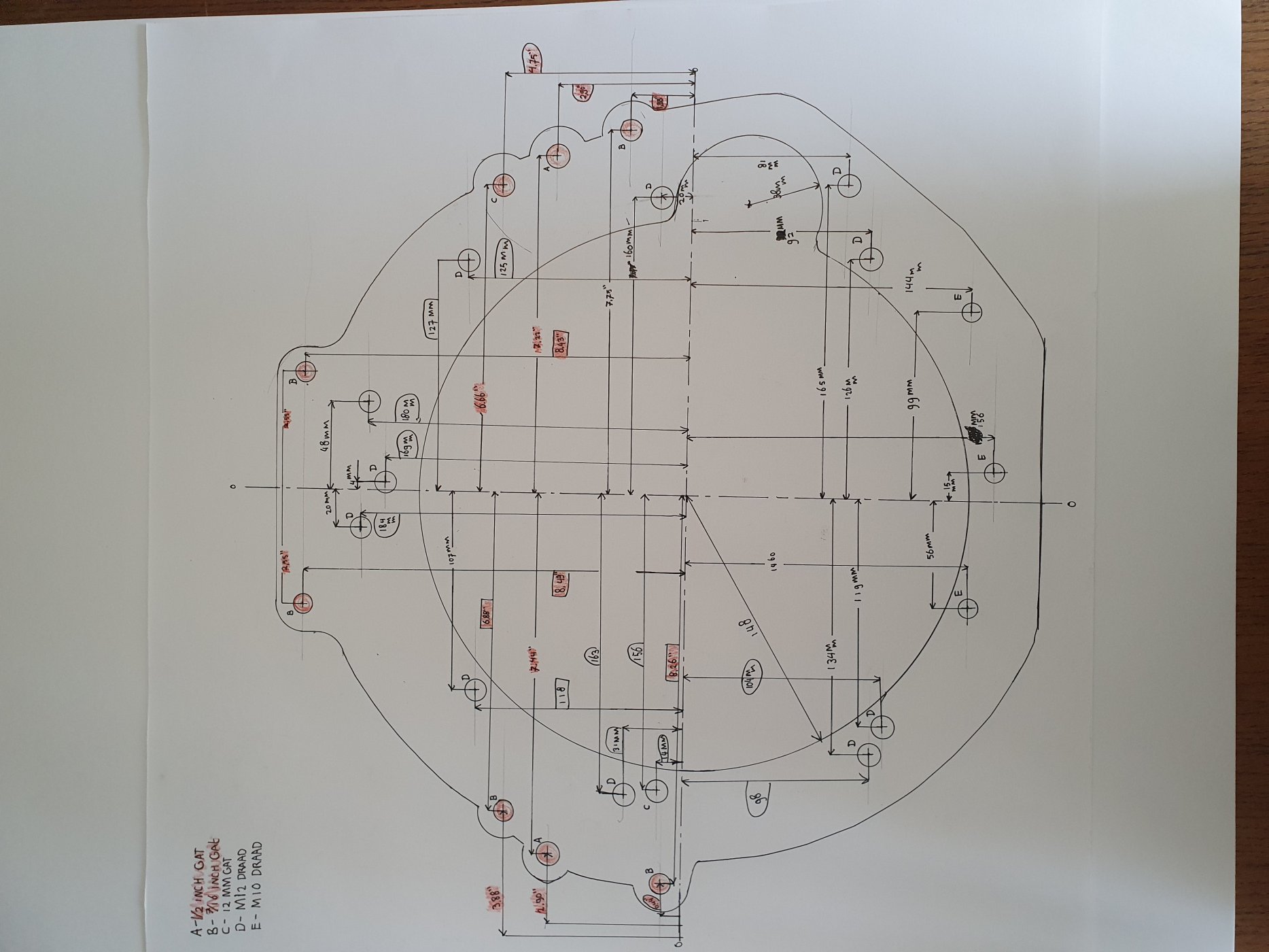

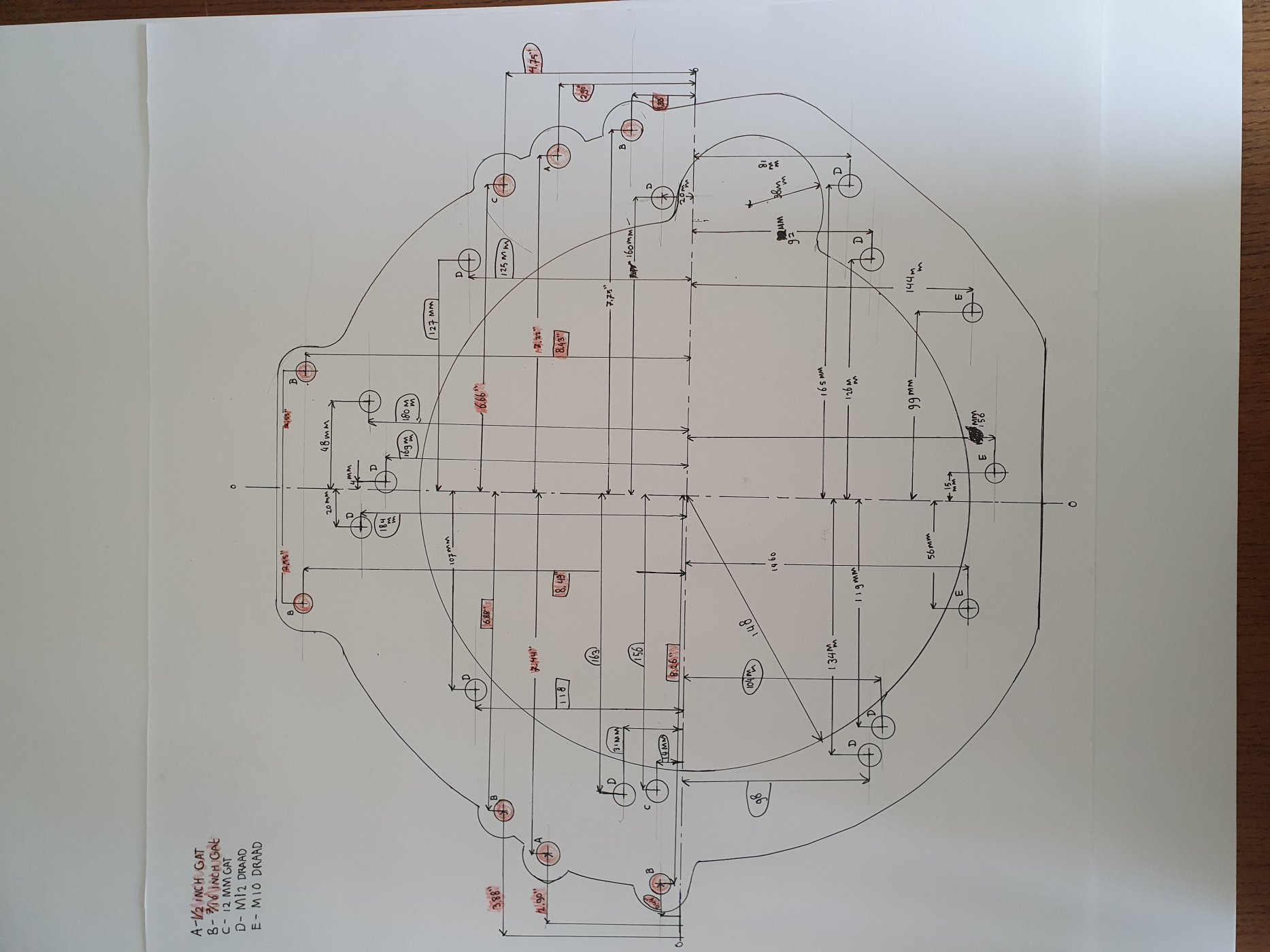

This is what i got so far, as for measurements. I drew this.

You will have to either find an adapter or have one machined. I'd start with Kennedy Engineered Products. The 0A2 shares the bolt pattern with the 01E and to some extent the 016. The clutch choice will follow whatever flywheel the adapter plate requires.
