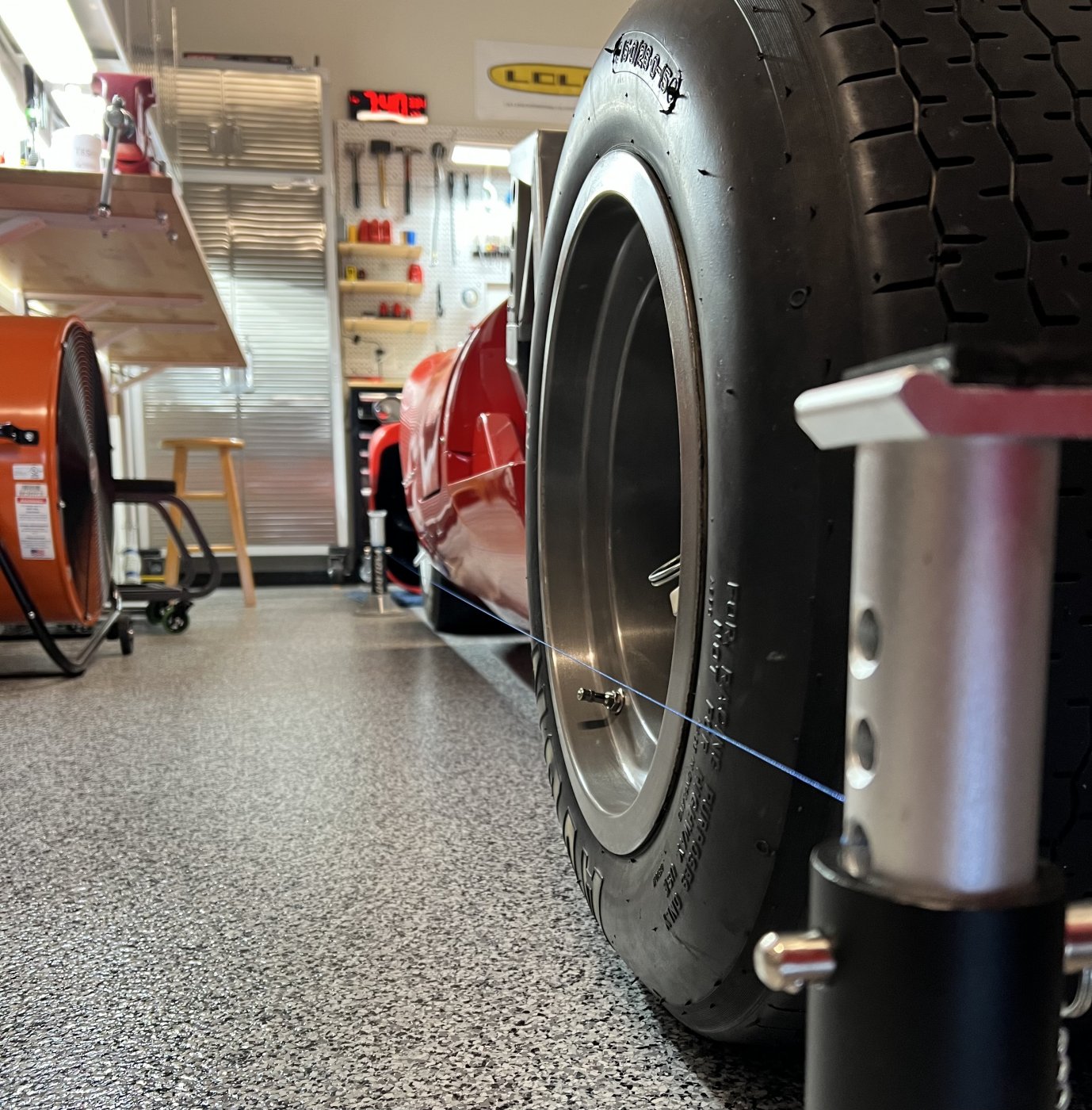

I think I’m going to get a laser alignment to the above specs and see how it goes. Then probably invest in a professional string setup to see how accurately I can reproduce the laser alignment on my less than perfect garage floor. I did do a string setup already, but I doubt my result (even though the car feels fine on the road).
