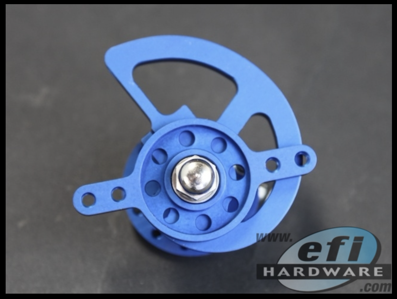

Thanks for the detail photo. That's the same setup I have. I will be interested in your thoughts on drivability. I found mine to be very difficult to finesse at low speeds (in traffic - and I know that's not where these cars love to be, but life can be like that). It felt like the throttle would 'snap' open, rather than be progressive. I ended up adjusting the rods to reduce the amount of force required to open in small increments, that helped a lot, but it's still not as good as I would like. On the track or in more 'sporty' driving situations, it's not an issue. Your car looks great and I love the dry sump setup. Congratulations.

Was talking to someone a few years back who had a similar issue to you Cameron. He solved it by fitting an off-centre crank (as below) that allowed small openings at round town speeds and then WOT when accelerator was floored.

Thanks Brian, I'm familiar with that efi hardware piece. It may be a last resort, as I want to keep a more period correct look. I also believe that if this issue with this setup is unique to me there may be something else going on in my setup. Appreciate the pics and responses.
