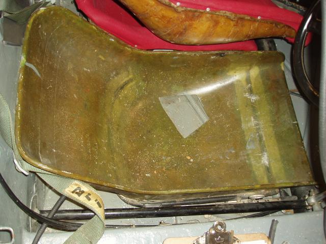

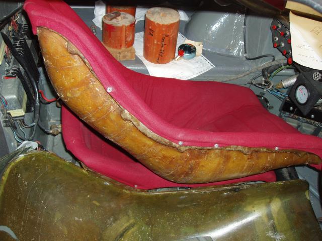

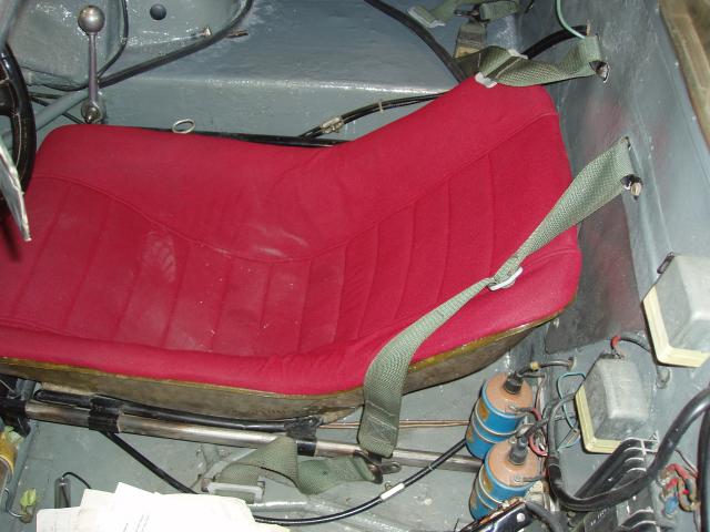

these are real, enjoy

Sid, if you are in Suffolk you can come and see the seats in the flesh and try one for size. The passenger seat is going to be tight though because they are much smaller for weight saving and were only there to comply with the original regulations.I don,t use mine to save weight and give better access. They were not all covered in red suede and came out of the factory as bare fibreglass, and for and aft adjustment was by pulling out a release pin and sliding along two oval sectioned tubes. Simple, light and very comfortable.
