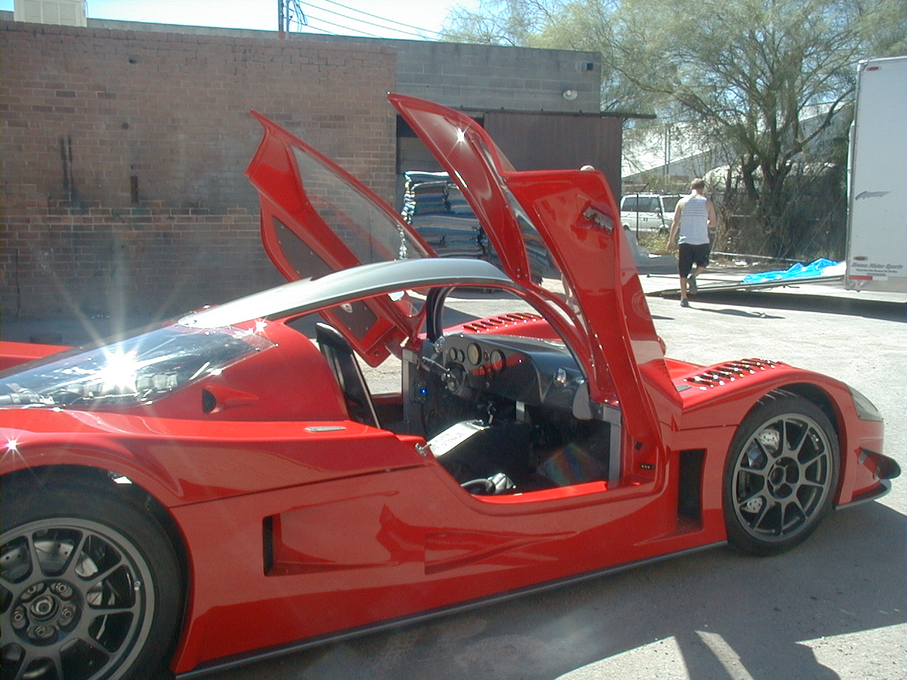

I made naca ducts and installed them under the door ducting into the tunnel and onto my oil coolers. The coolant pipes are on insulated standoffs and are wrapped in header wrap.
