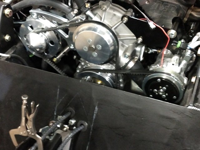

Always a monkey wrench thrown in somewhere on these things. My Sanden came with a double v-belt pulley, but I'm only using one of the grooves. Maybe contact either RCR or Sanden directly to swap out? I did use the RCR bracket which initially did not come with my kit. It mounts the compressor low on the engine opposite the alternator.
Rod Dittmar
Picture of my CVF v-belt system with RCR bracket mounted A/C compressor.
Thanks for the picture! Did you use a spreader bar attached to the back of the AC compressor instead of the lower mounting holes or just caught the rear mounting hole?
Also I called Vintage Air and they told me to ship it back and they can exchange it for one with a v-pulley. Hopefully o can get that turned around quickly.

Pat, I fabricated an adjustment arm out of some steel stock, bolted it to the block and to the lower compressor mount. Sorry I don't have a picture of that adjuster. There's a lot going on in that area and not much room to get at things. Shim/shave where you have to, but making sure you have ALL your pulleys perfectly aligned will make for a much happier v-belt system.
I understand and appreciate your time and help. I’m trying to get the front accessories mocked up and straight before even thinking of putting the engine in. I see how tight everything is and still won’t realize until i start putting it in there. Praying I can get lucky by looking at everyone’s photos to maybe get it right the first time but that never happens! I need to make a separate post to see if there’s someone close to lower NY/tri state with an RCR so I can look at it up close done or near done.

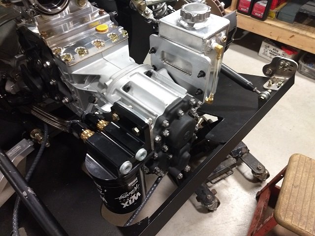

Pat,
You're definitely going to have to do something with that Oil Filter sticking out the side of the engine block on your RCR40. I tried everything I could think of to keep it there, shorter filter, 90 degree adapter, etc., but nothing fit in there along with everything else. I also didn't want to cut a big hole in the chassis, so I finally went remote.
Pat
Pat,
Thanks, I didn’t even think about the filter hitting. I’ll work on a remote setup and figure out where to locate the filter once the engine is in. Trying to lock it up like p1075 but with modern upgrades so I’ve been thinking about locations for catch cans and swirl pot, have to add oil filter to the list.
