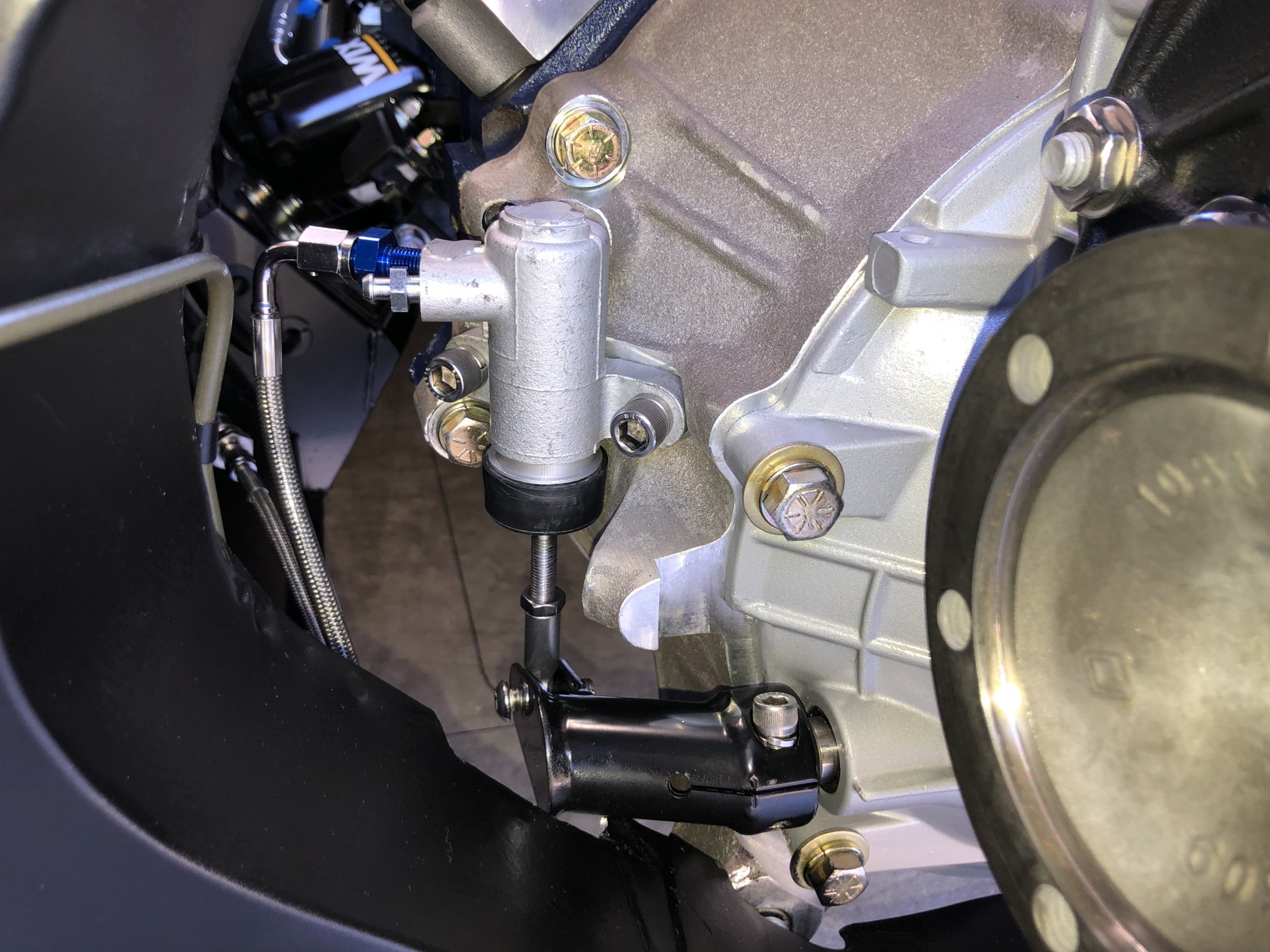

2- Anyone with the Safir clutch package. What is the fitting on the slave cylinder? I think it’s inverted flare but I cant get a good look at it to confirm. Would like to find a flexible hose to go from the end of the hard line on the RCR kit to the slave cylinder. The end of the rCR hard line looks like a female -3 fitting.

2. Safir slave fitting is a 3AN female - bleed screw is same - then can be swapped side to side. Problem is the hole is very deep and normal 3AN fitting never bottoms out. Used a bulkhead fitting which is longer. You can look around for others but my guy had this so I went with it. Earls 983203ERL.
3. Flex lines are abundant. Used RedHorse Performance stainless coated 13” line with 90 degree end for the slave. Use RHP 3390-03-13. You can use any quality 3AN to 3AN line.
4. I have a SPF car. Hard line on chassis is 10mm - 1.0 bubble fitting. Remove the adapter and bleed screw and toss them. Use Earls 989534ERL adapter to 3AN.

Yeah the RCR hard line by the clutch slave has a female fitting that I guessed looked like a -3AN fitting. Hopefully someone else will chime in with an RCR.
