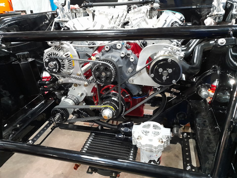

Hi Pat. I may have a vendor for you. I’ll get you some contact information next week. I am working with them for a custom setup for my Lola.
I’ll let you know early in the week. They aren’t afraid of custom builds and the customer service is great.
Regards Brian
Brian Kissel
Pat, reach out to:
[email protected]
He is a very good contact and have worked with presige before. Their products are top of the line, and they aren’t afraid of working outside of the box. I am getting a drive from them for my RCR Lola build. I am going with a HTD tooth drive, which will eliminate the need for tensioner’s giving me more room.
Drop Chris a line, I think you will like their products.
Regards Brian
Pat, reach out to:
[email protected]
Regards Brian

Brian Kissel
I would say no. Measure the confines of the tub and work with those dimensions. Ask some others to post pictures of their drives. I am doing a custom unit for my Lola because there just isn’t a lot of room in there. Ask Prestige for some pictures of the drive from CVF that they know doesn’t fit and work from there.
Just my opinion !!
Regards Brian
