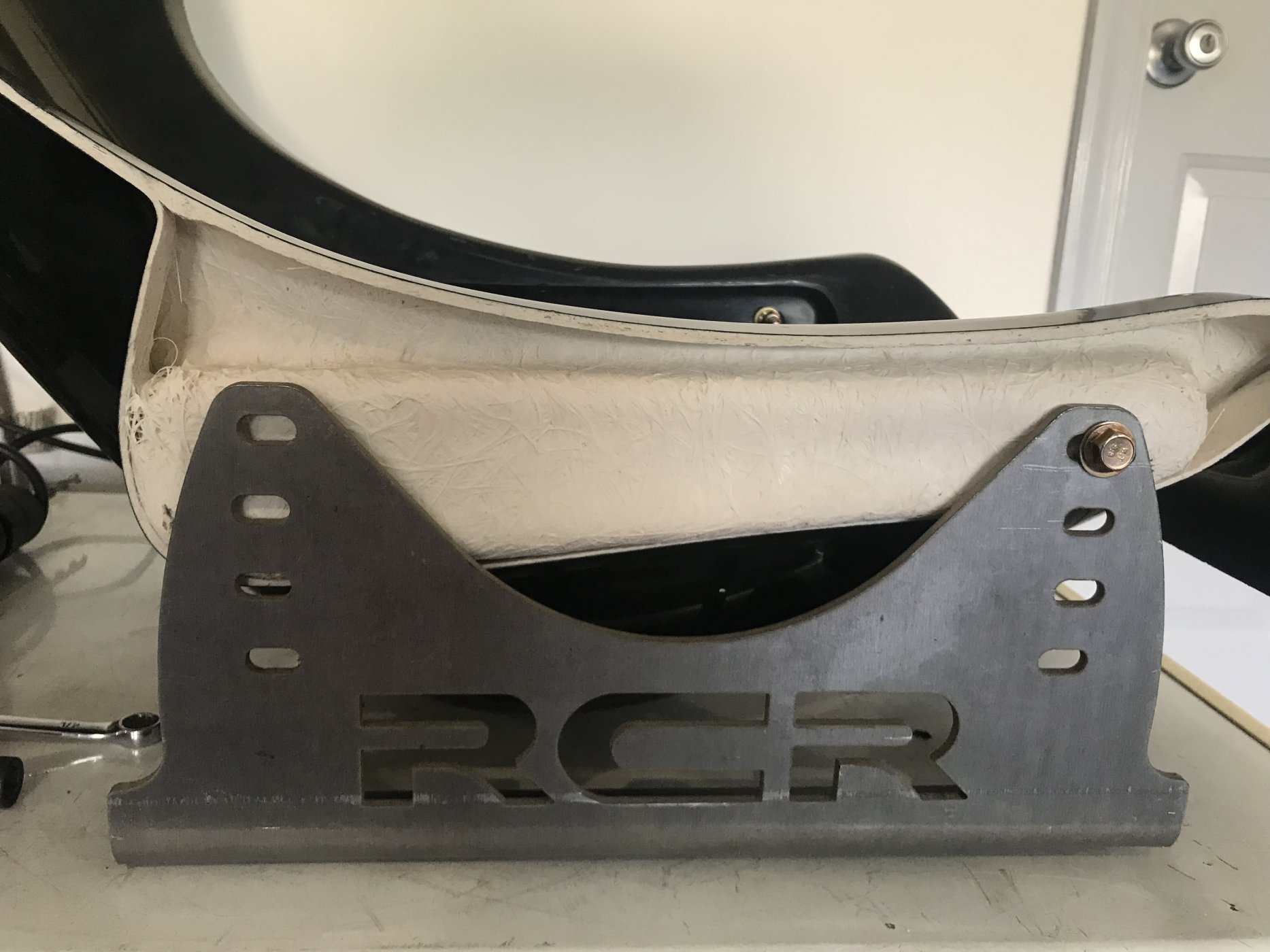

Kurt, I forgot the whole purpose of the seat brackets was to get them more in-board. Those steel brackets you made came out great.
Alex, if you want to get the seat more in board than the stock RCR brackets take a look at Kurt’s build page.
If you still want to use the RCR brackets but need one or two more with the lettering in the right direction I think I still have them. Just pay for shipping and I’ll send them to you.
do you have RCR bracket laser cut reversed?
I don't see how I can use these brackets without reversing them, it put the seat way too far from the center

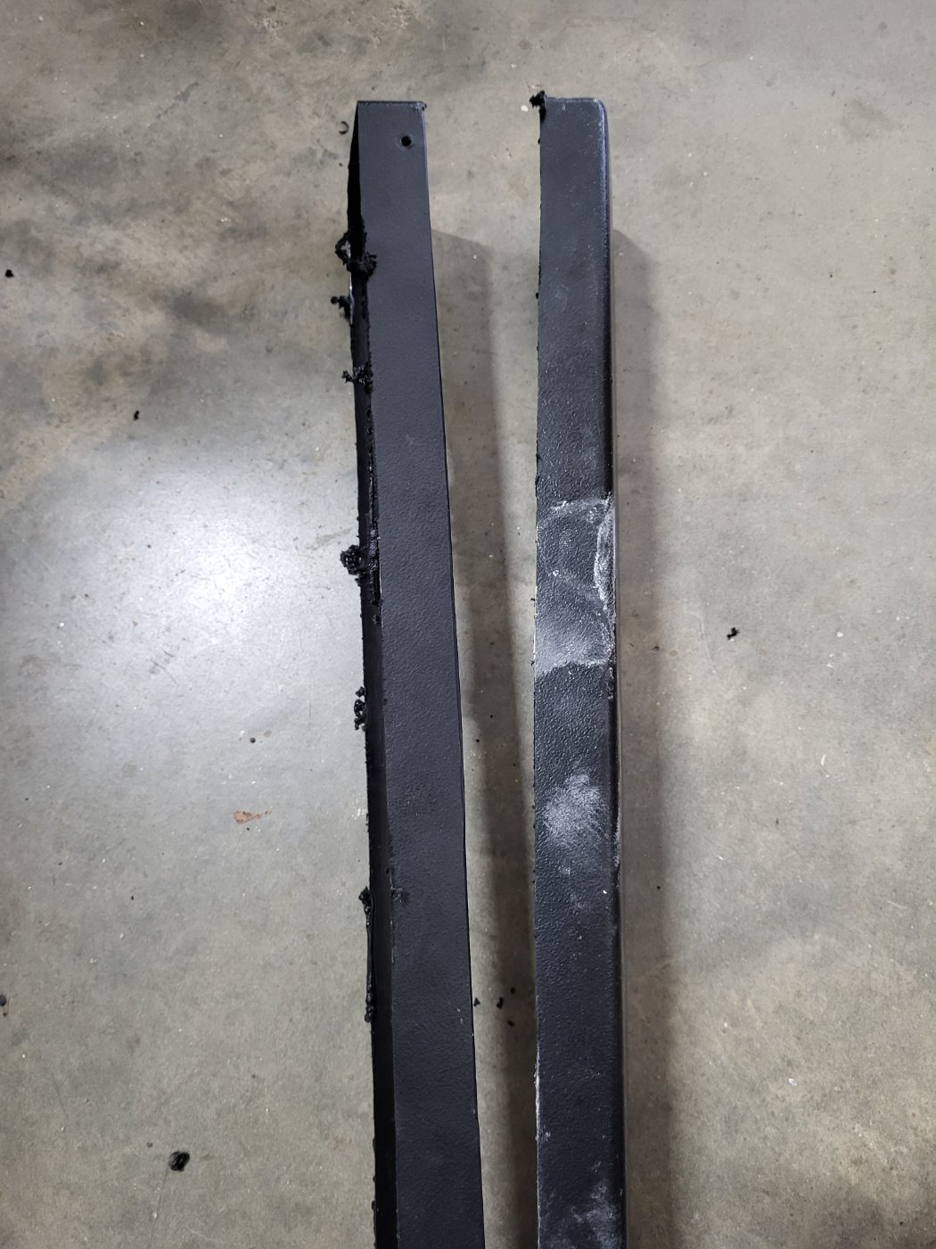

Here is a pic, I think three were like this and 1 was the opposite… but to my earlier point, they still may mount the seat too far from center…

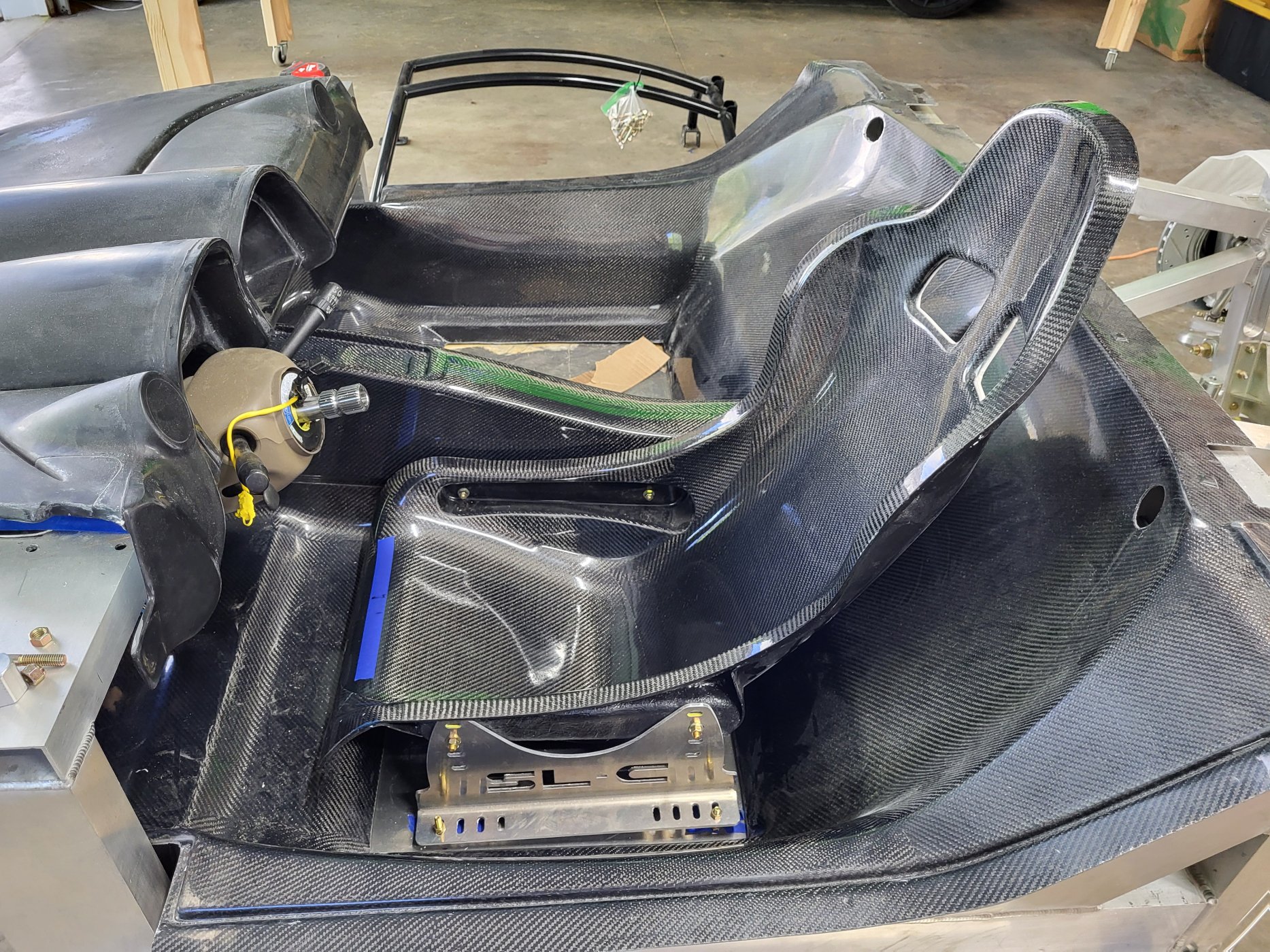

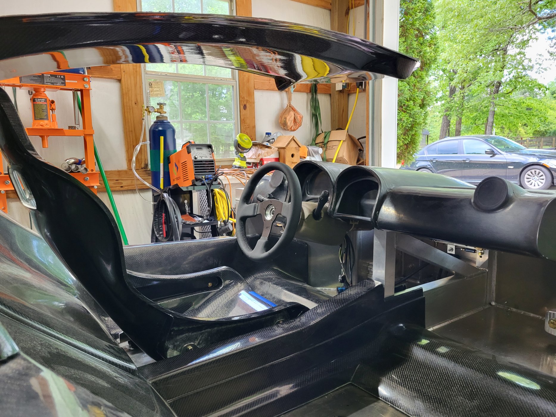

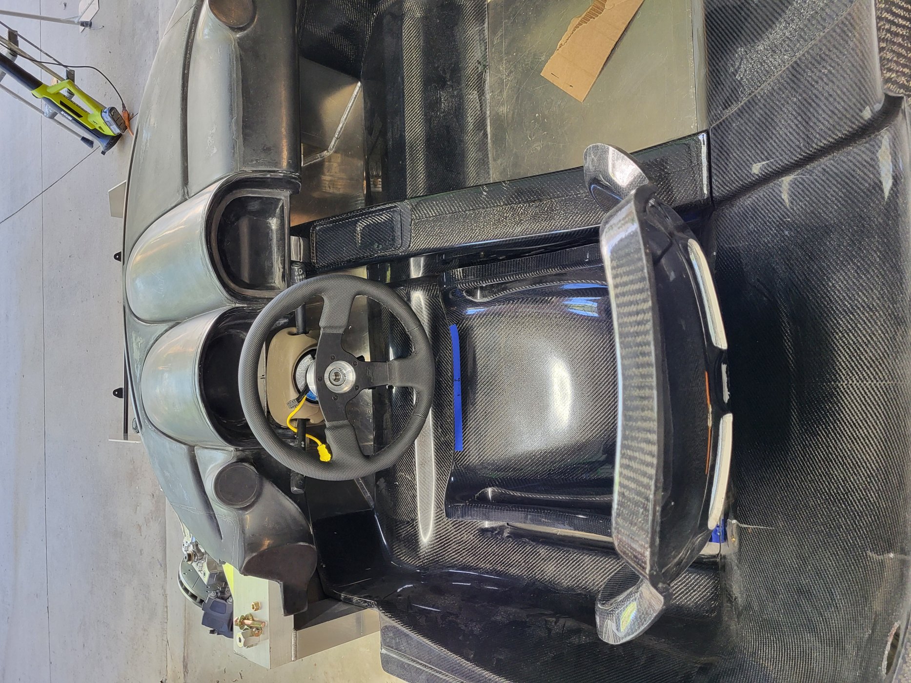

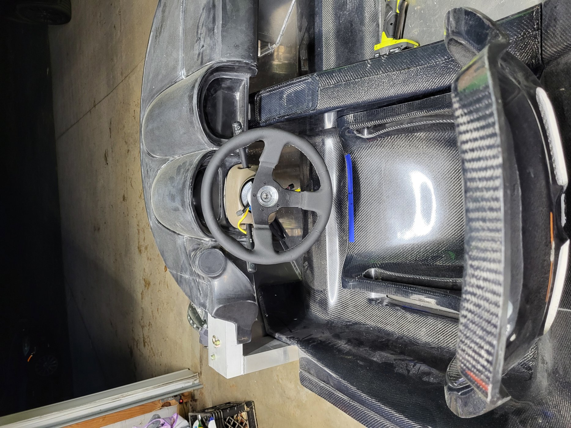

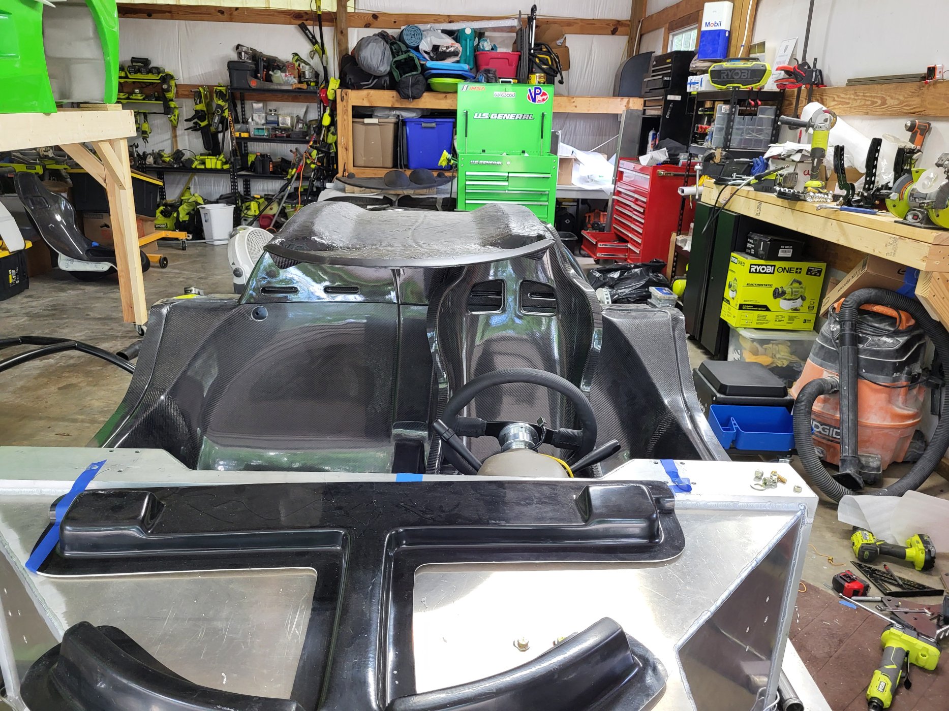

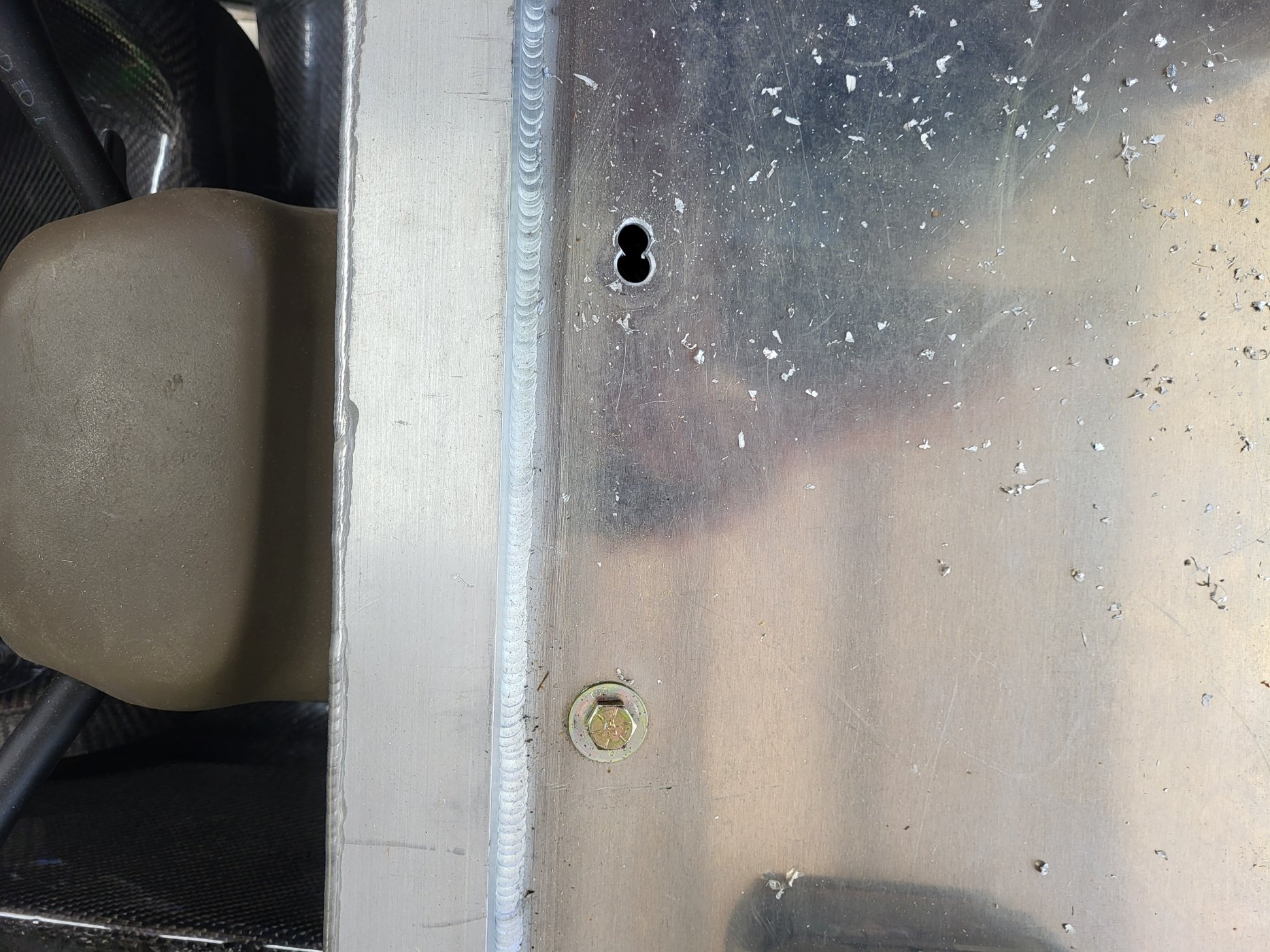

I think I can deal with a small offset, but as it was, it is over 1.25" offset and it doesn't look or feel good.
First thing I did was to move the steering 5/16" on the left. if I do more, it will not be centered with the dash board. (I also center the dash).

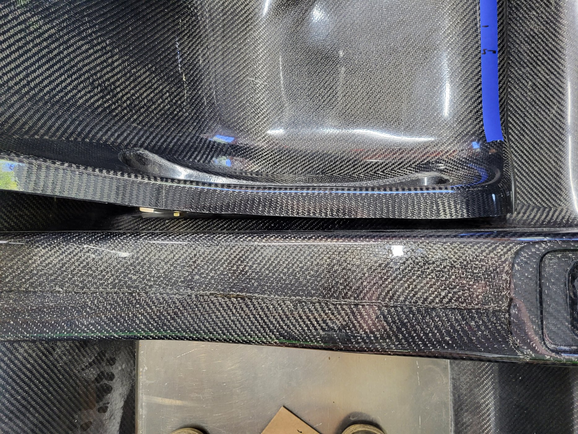

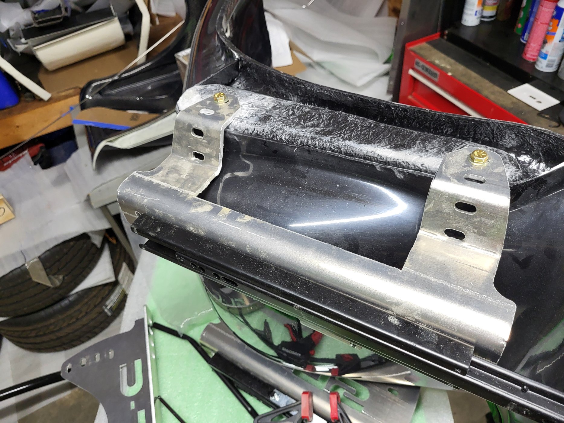

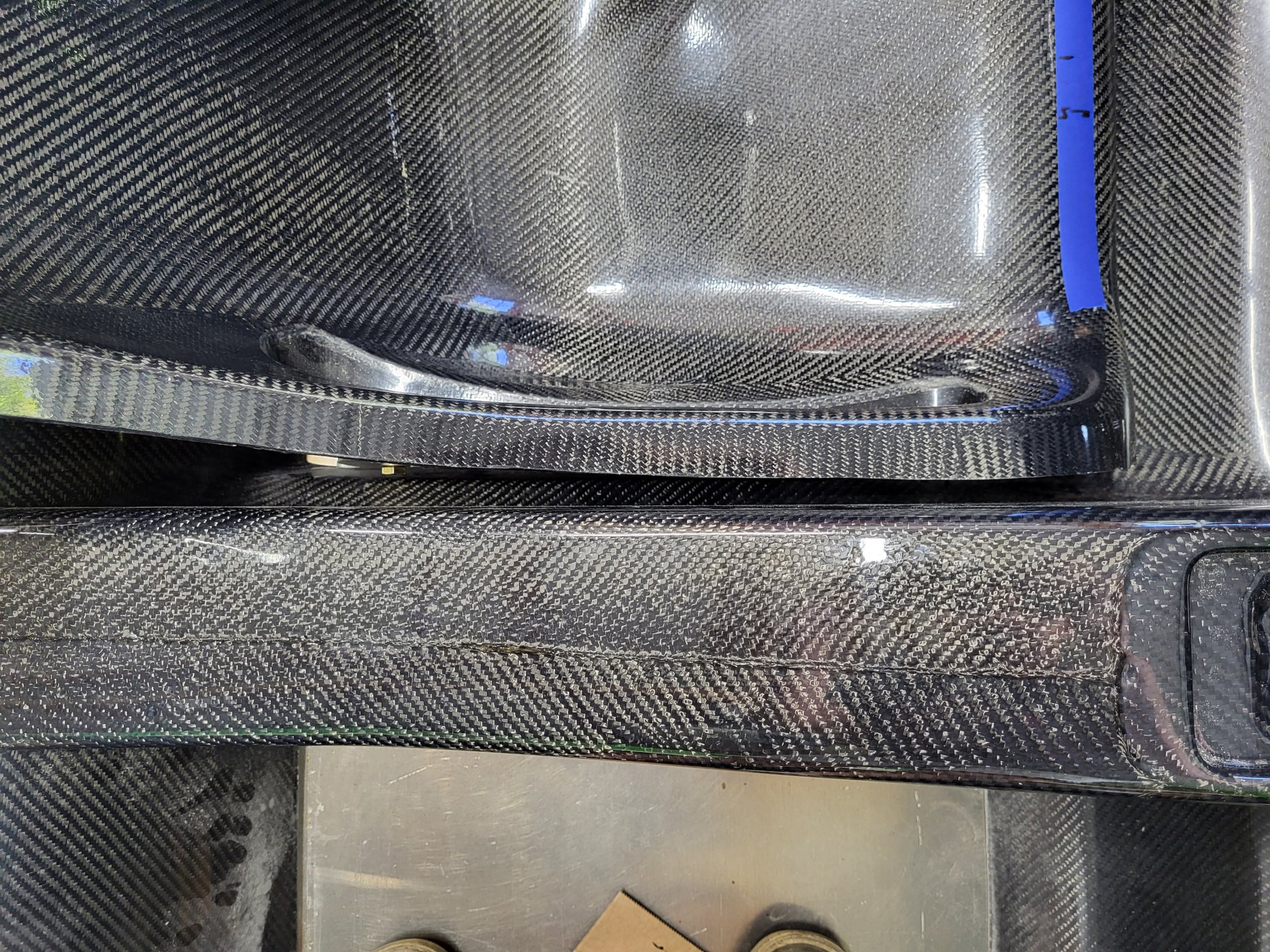

Next step was mounting the interior seat bracket reversed, what bring the seat closer to the center console, but not enough to be center. I still have over 1/2" gap between the seat and the console.
Now my next step is to modify the interior bracket to be able to get as close as possible to the center console, for that I need to bend it. I used the second hole of the seat mount so I should be able to bent the RCR mount and use the top hole.
Of course to be able to do that I had to cut all the fiber of the tube first...

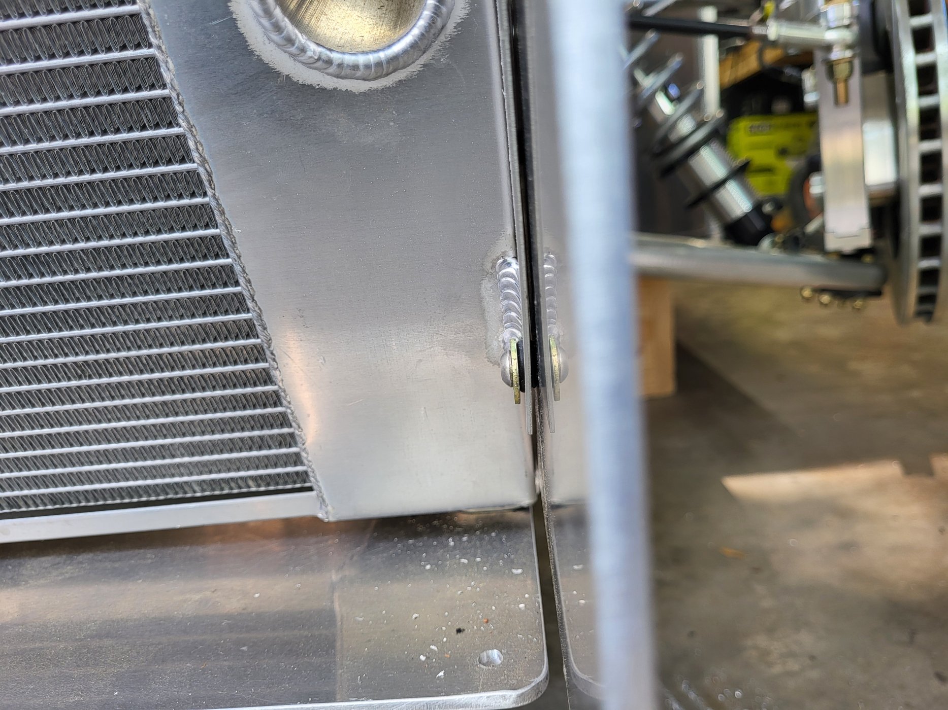

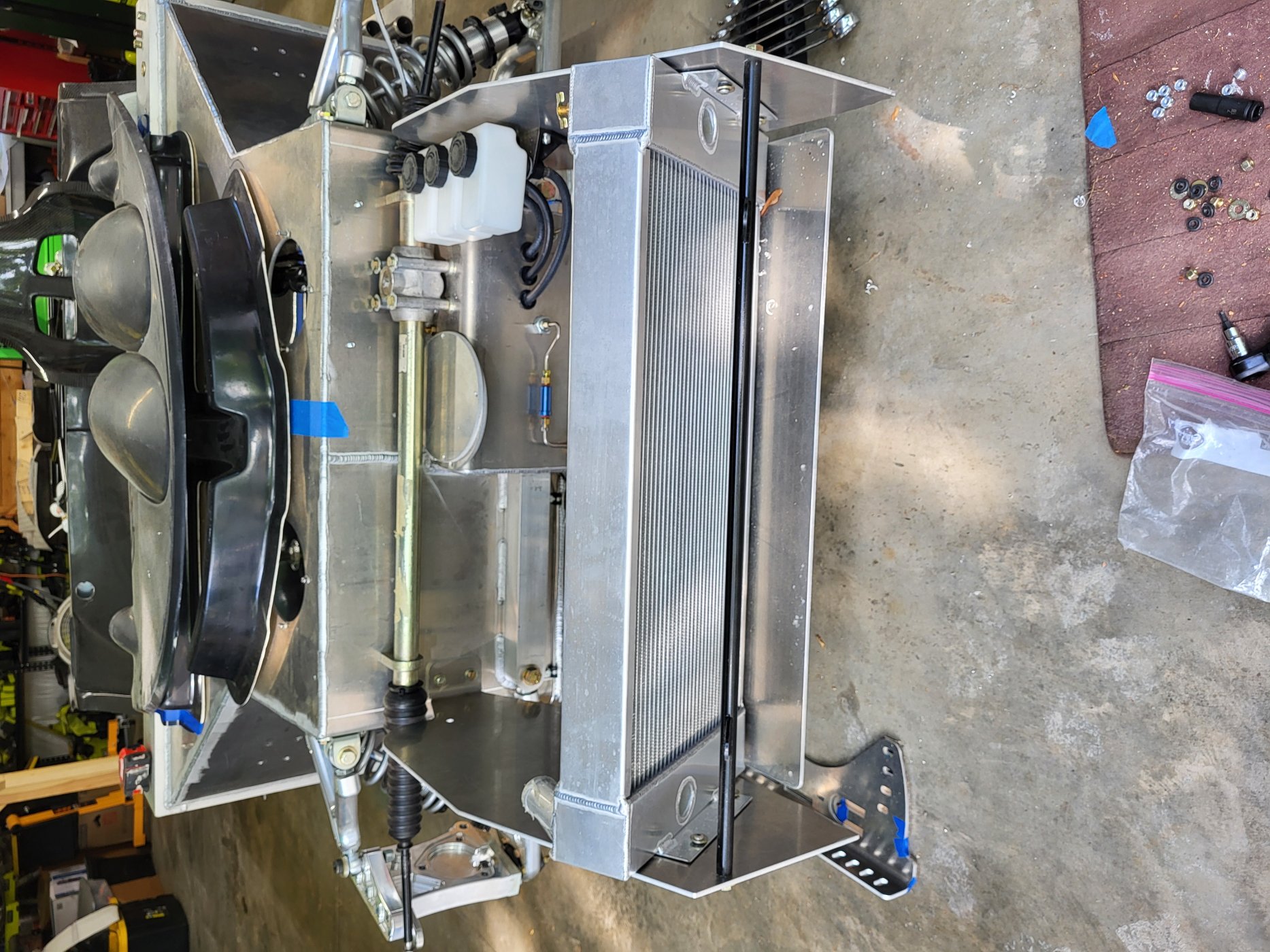

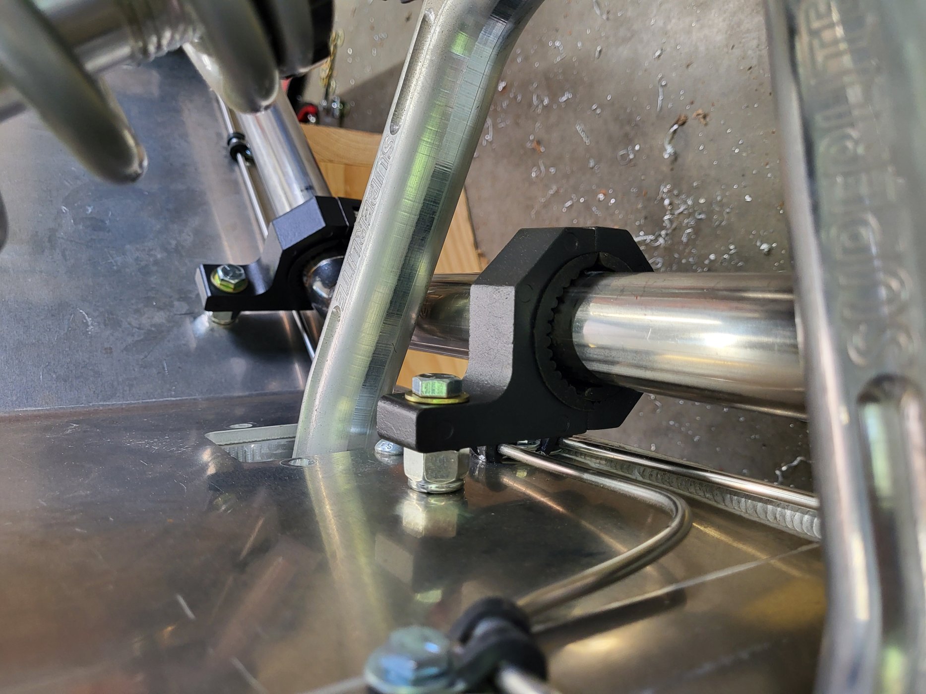

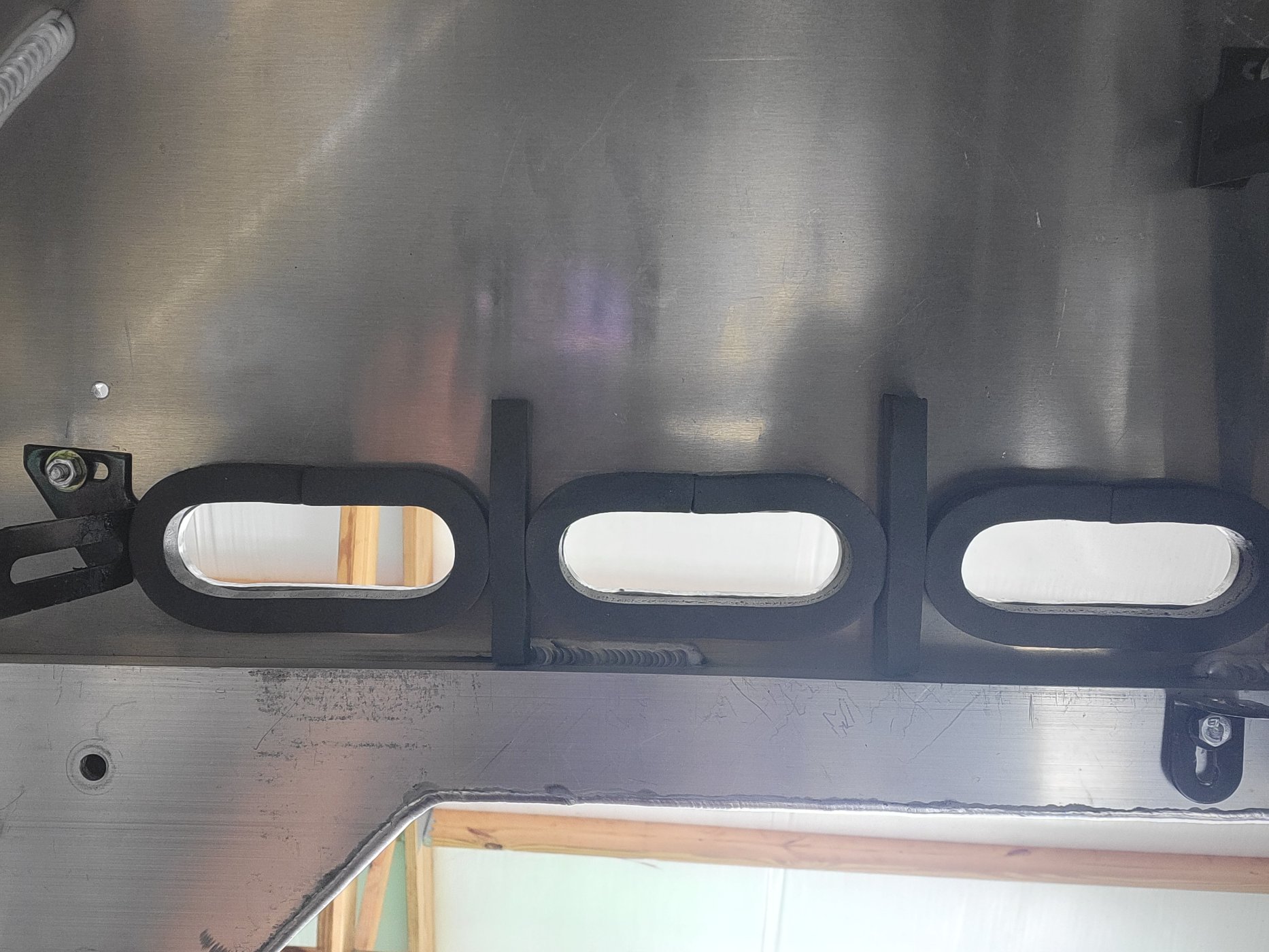

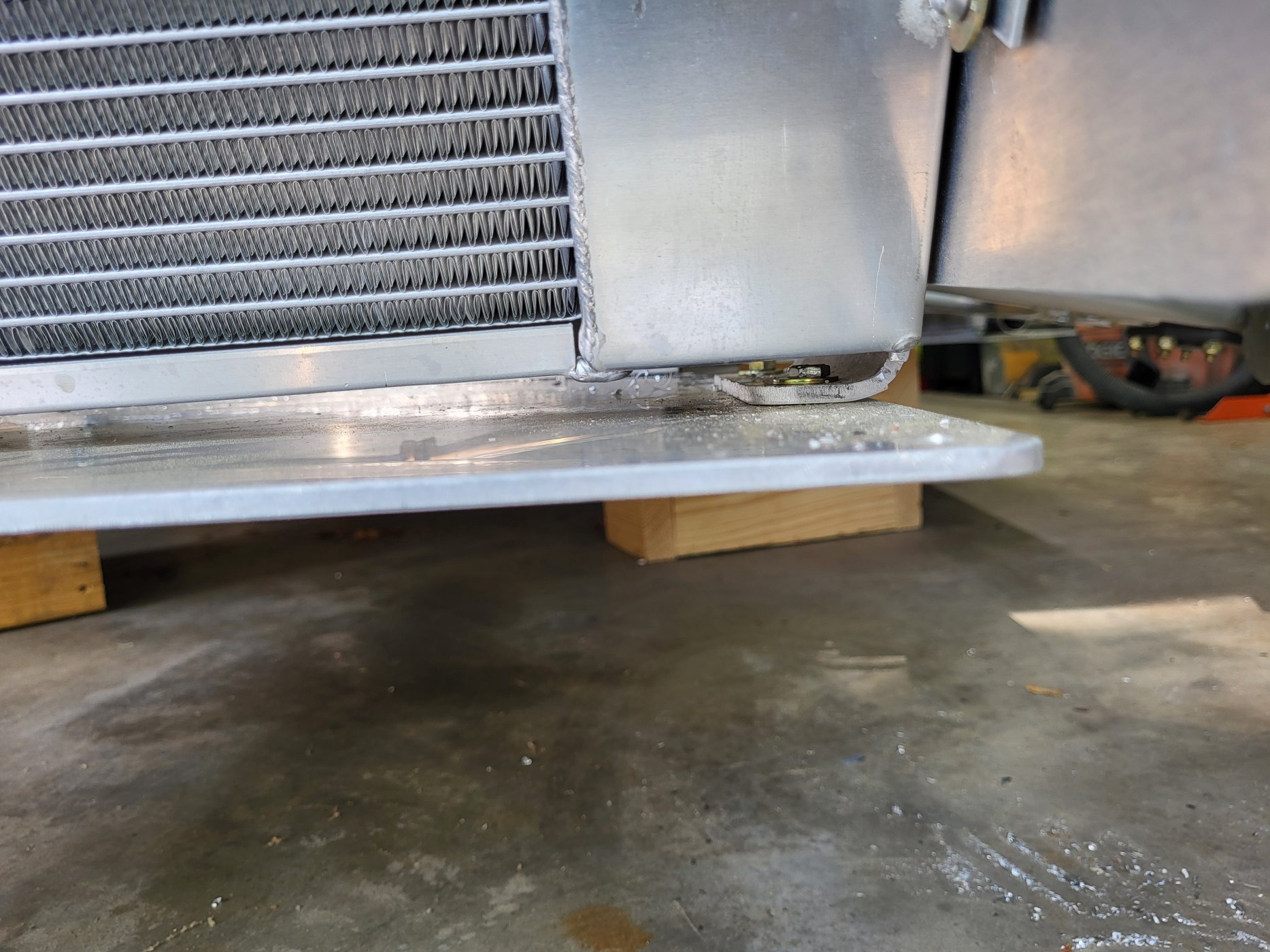

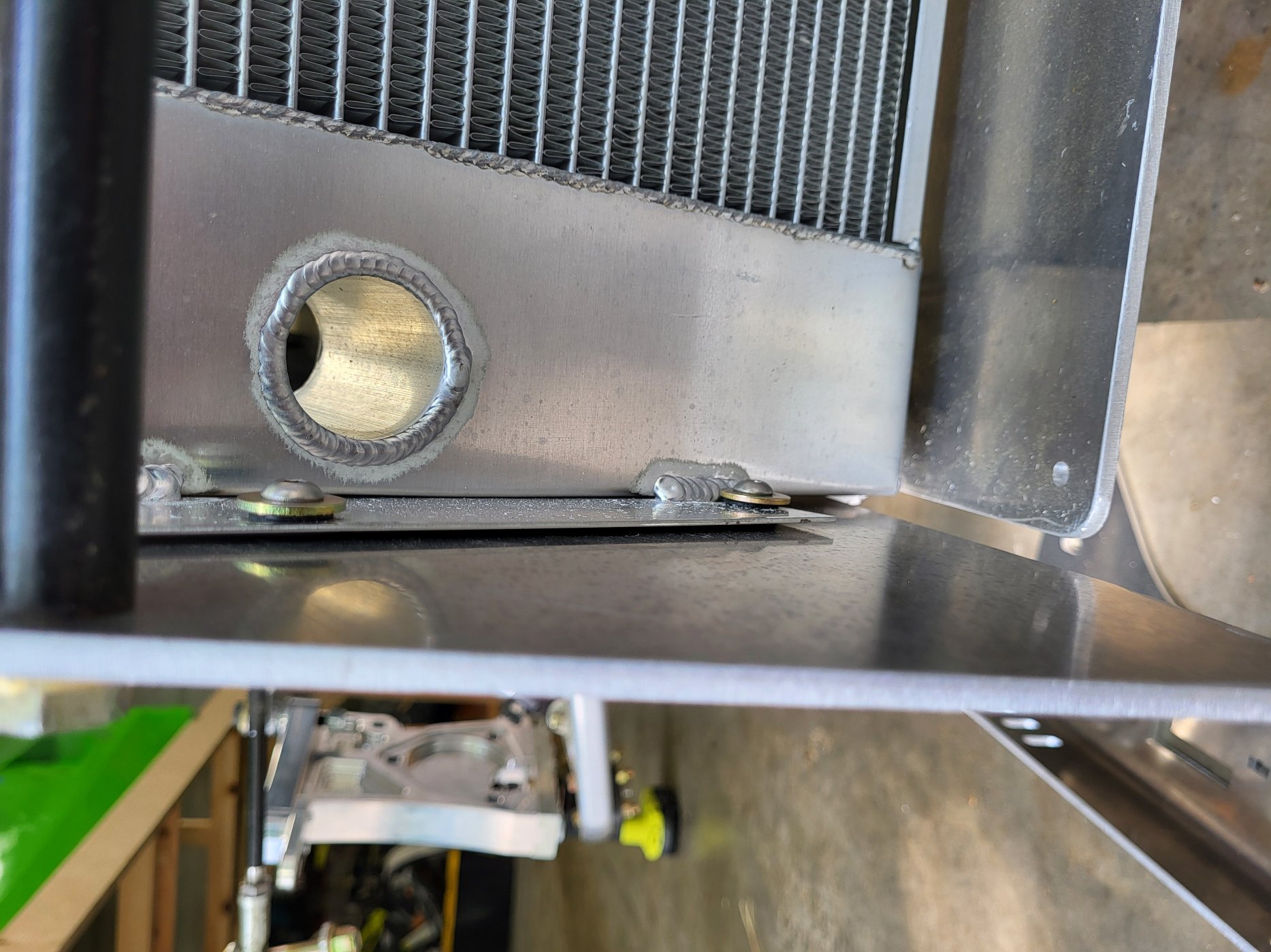

Installation of radiator with grommets. There is a little flex but not too much (hopefully enough). Bolt have nylon nuts and are not torqued.

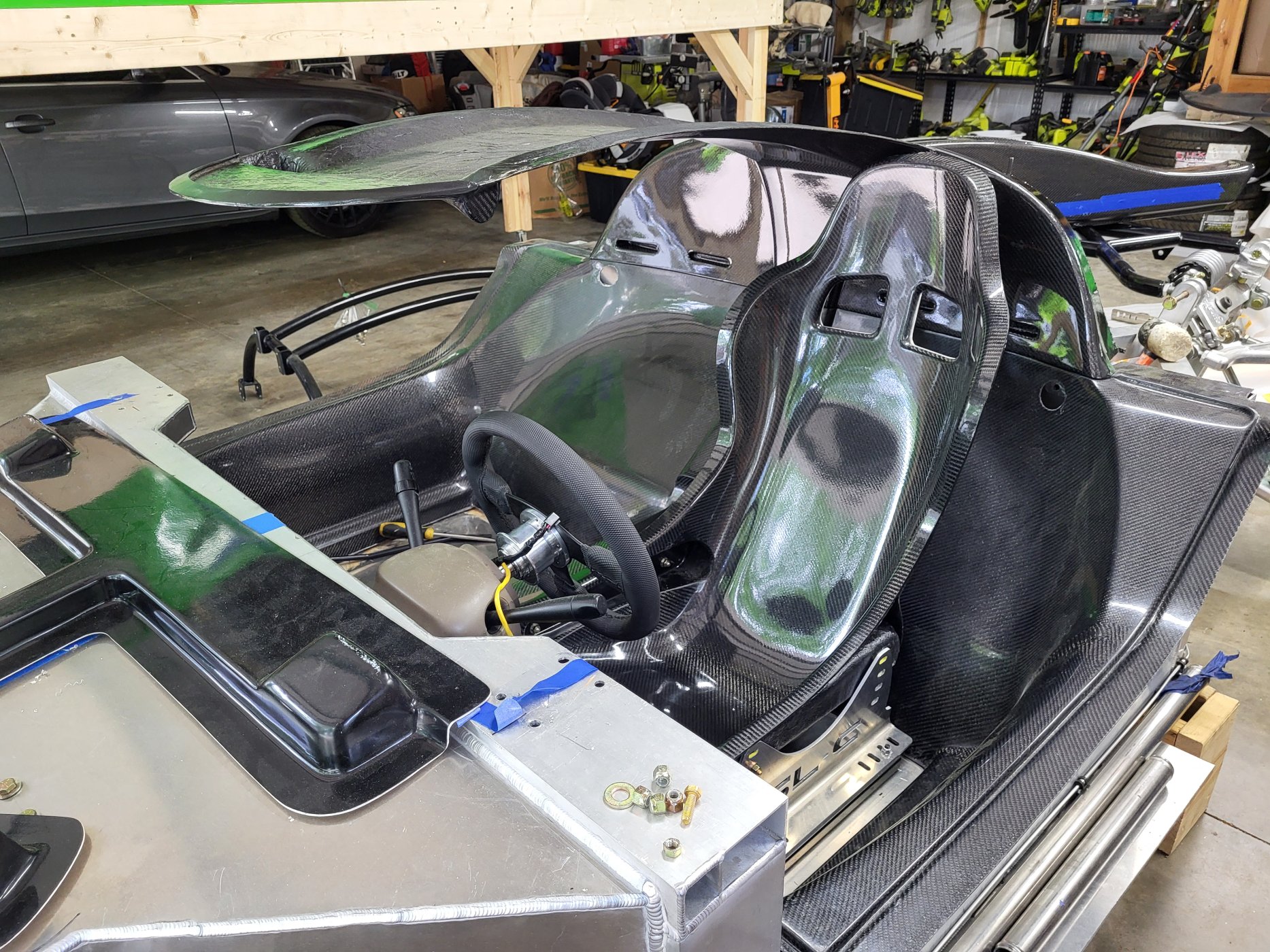

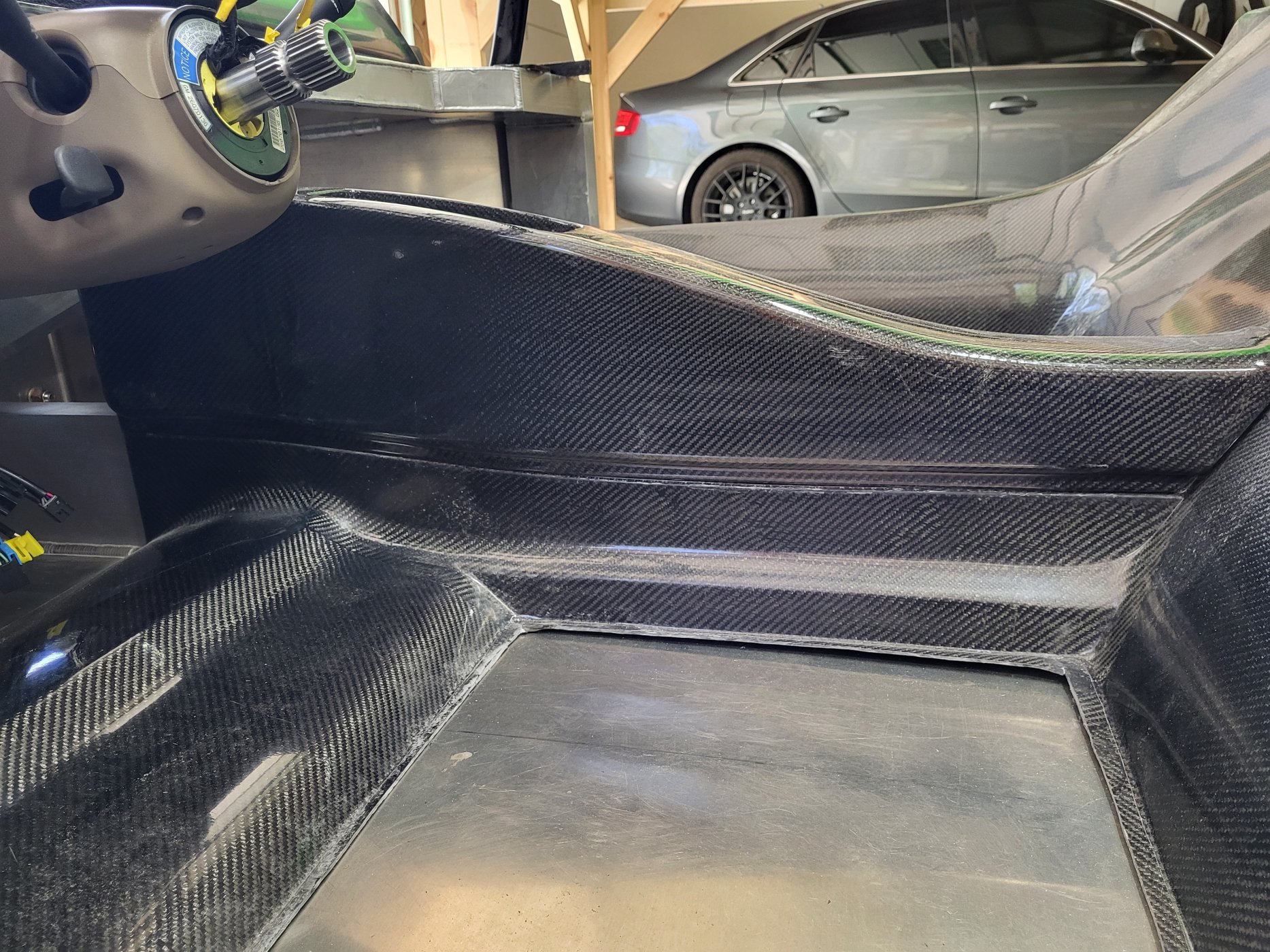

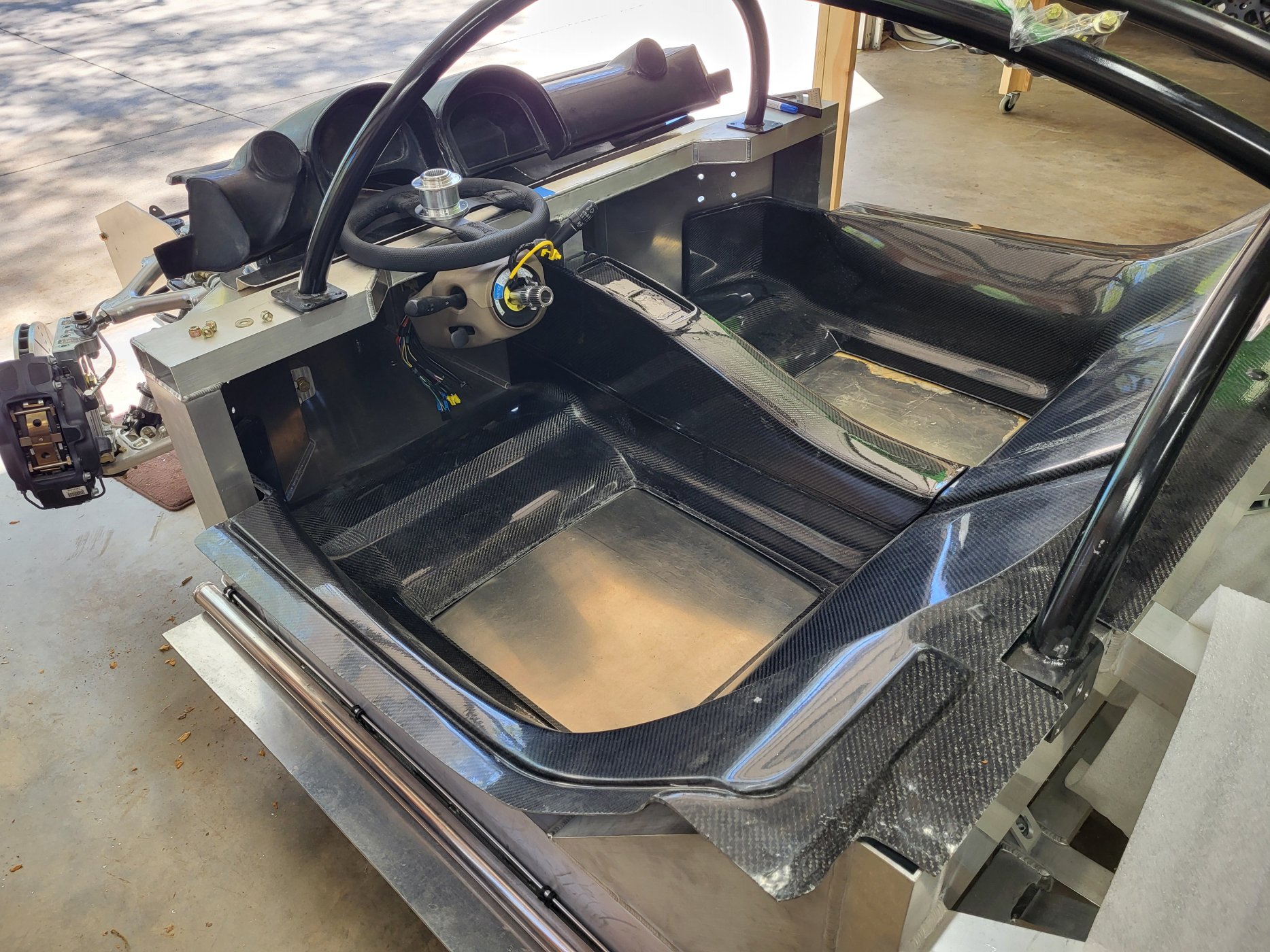

I finally have the driver seat in place. Steering wheel as left as possible without looking off with the dash, interior seat bracket modified (still need to weld some gussets to reinforce) but the seat is 1/8 off the center consol. Seat and steering wheel alignment are 1/2" off, not really obvious and not bothering me anymore ! :)
I also check clearance with the roof panel. The seat is 1/4 inch off the floor due to the sliding rail, it is the lowest possible with the modified bracket because the rail is almost under the bottom of the seat (in the side curve)

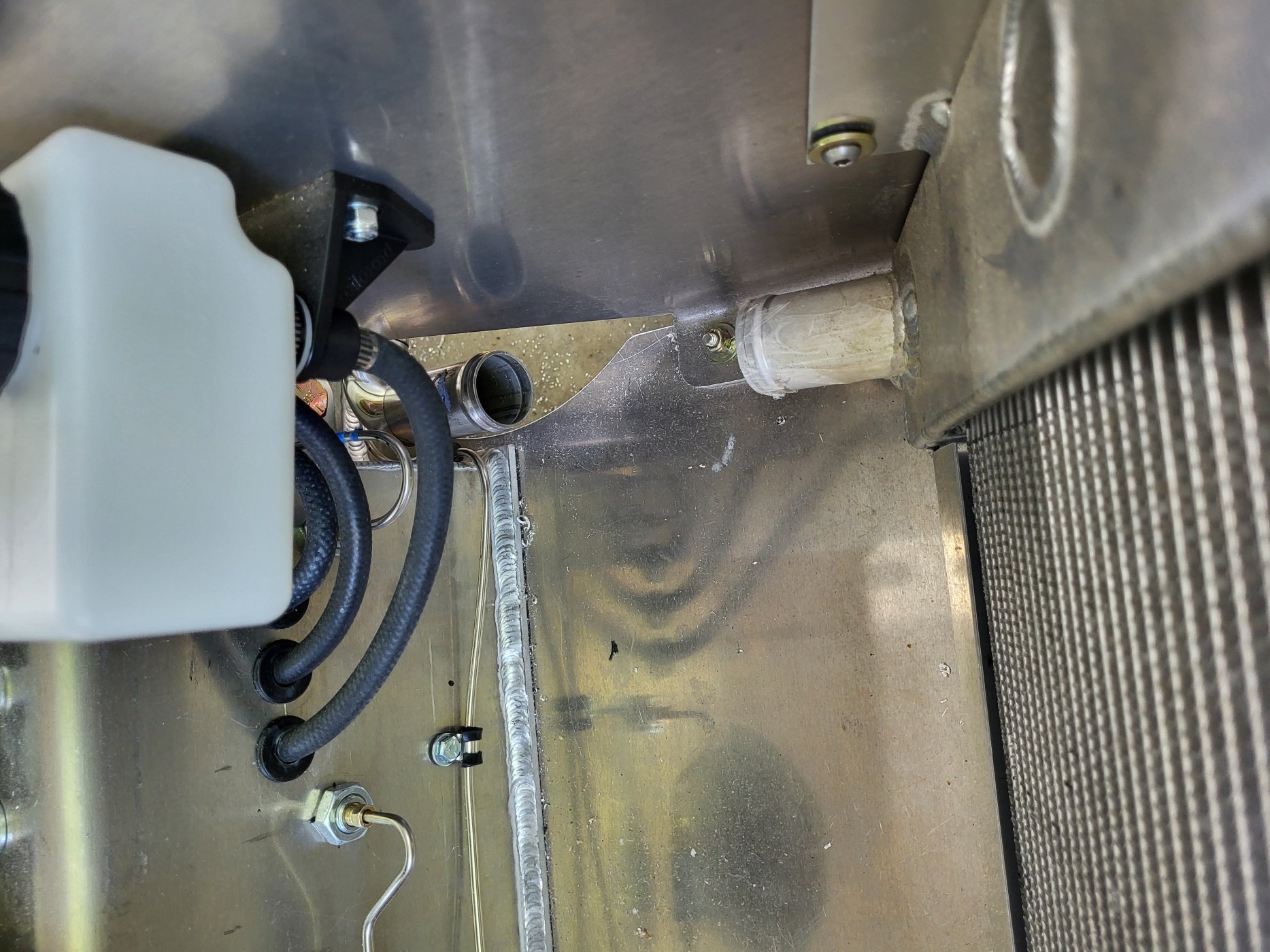

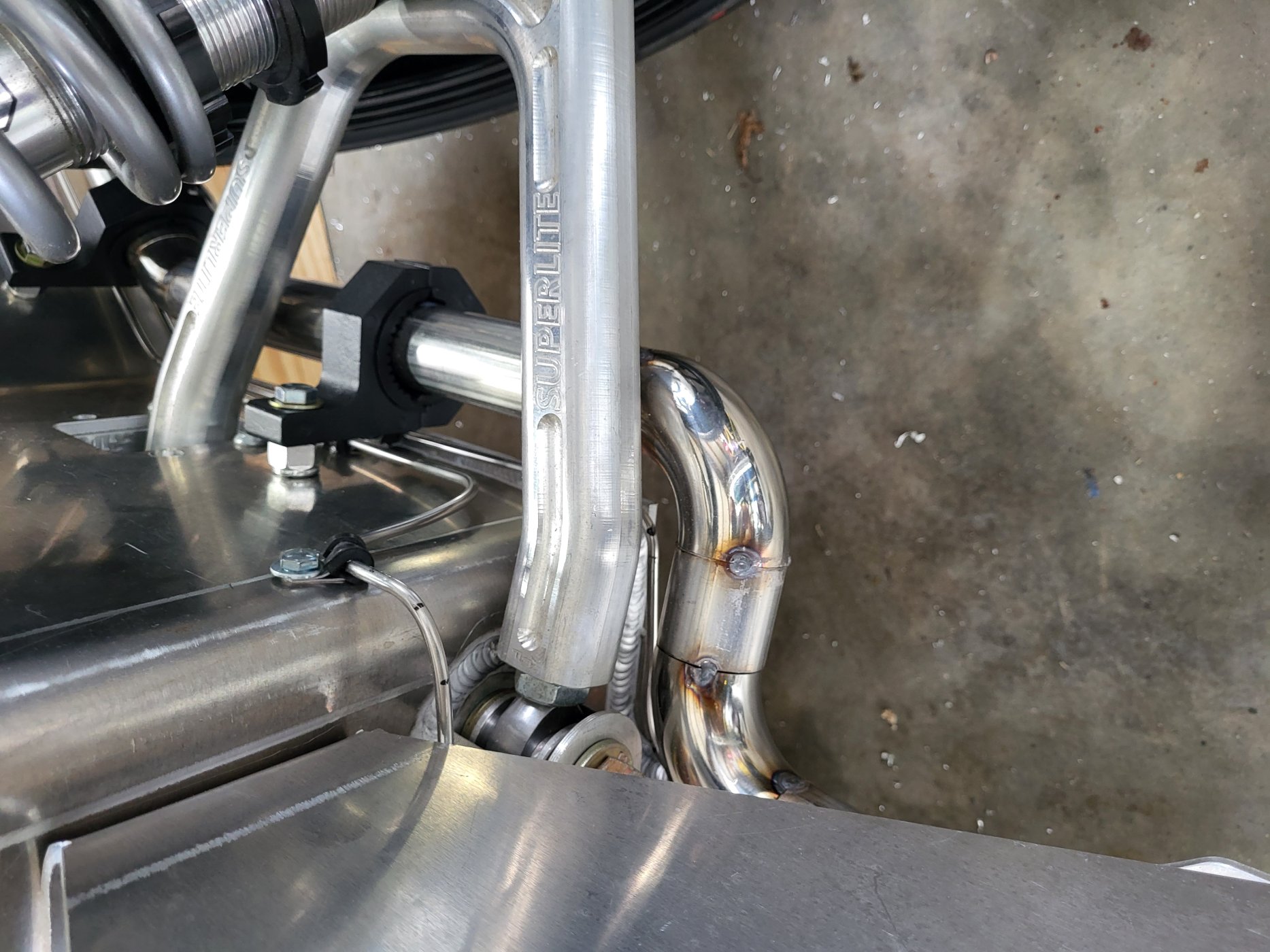

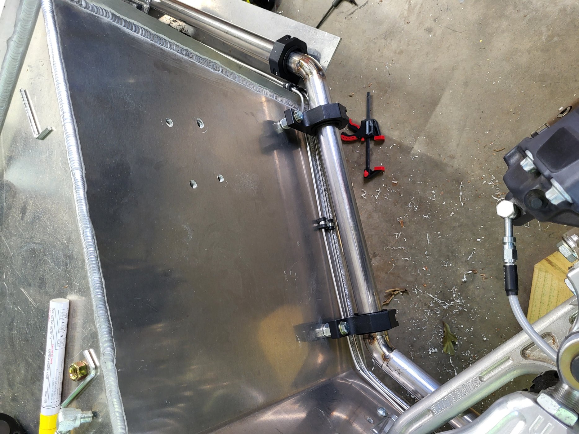

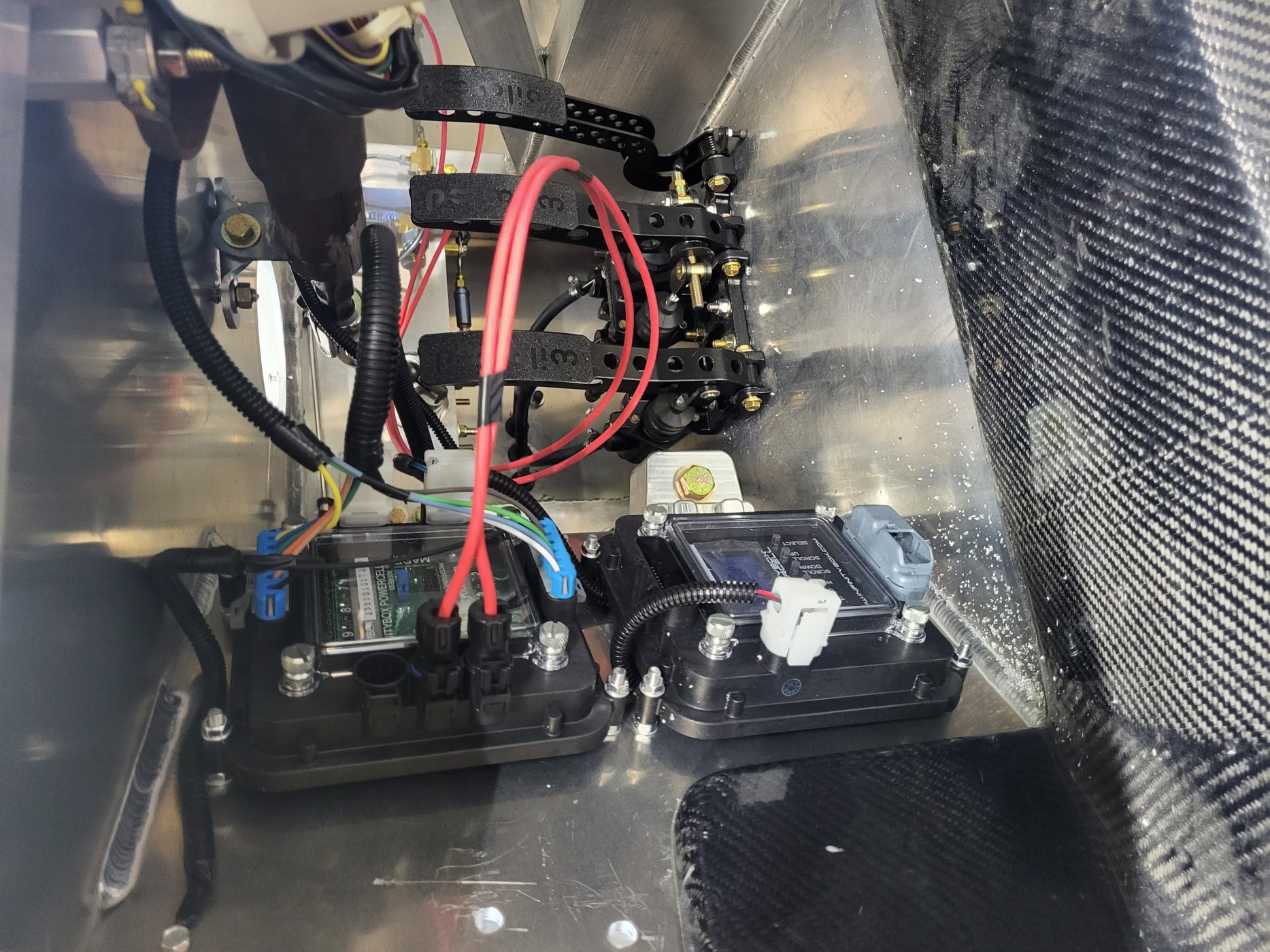

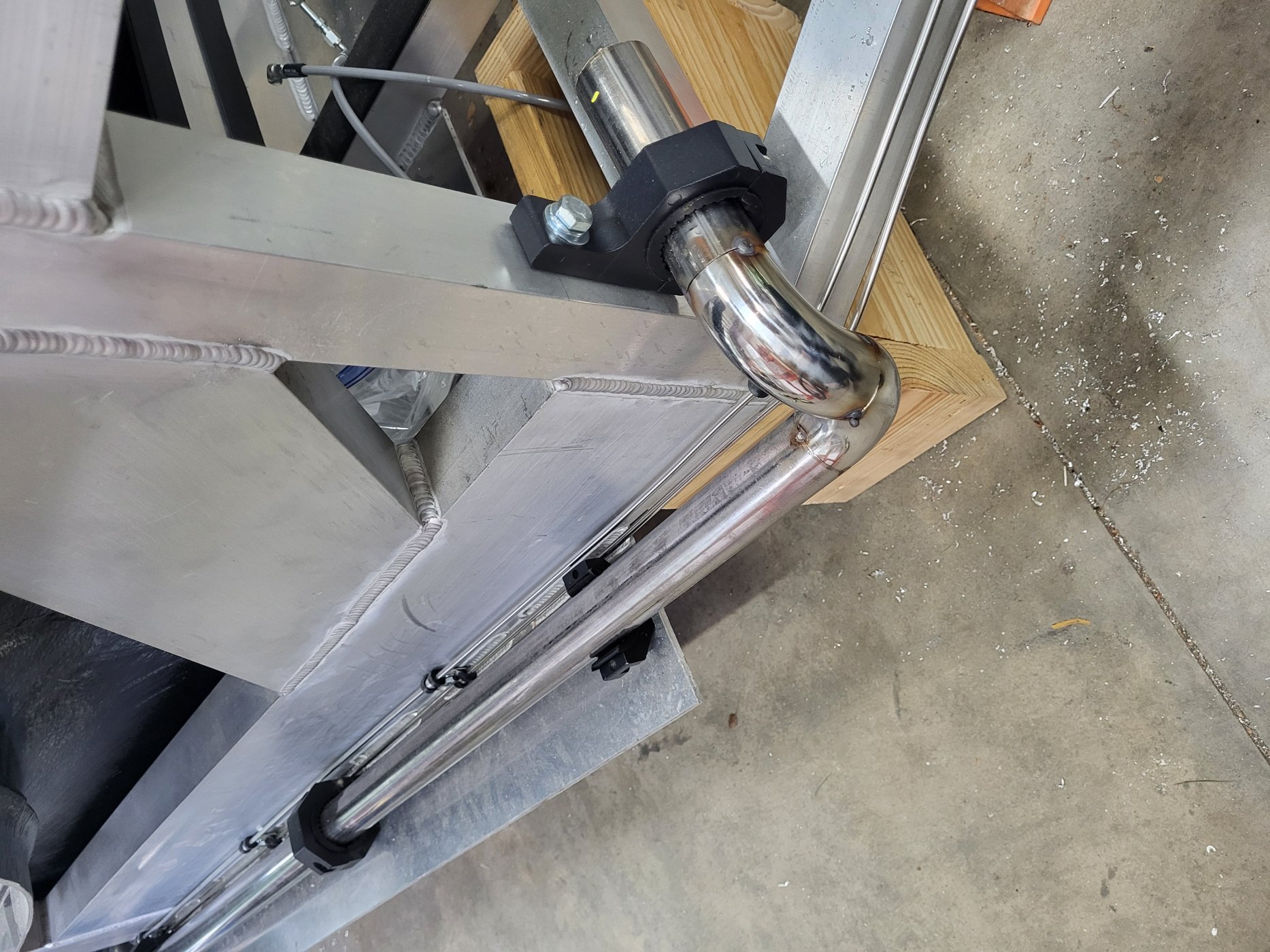

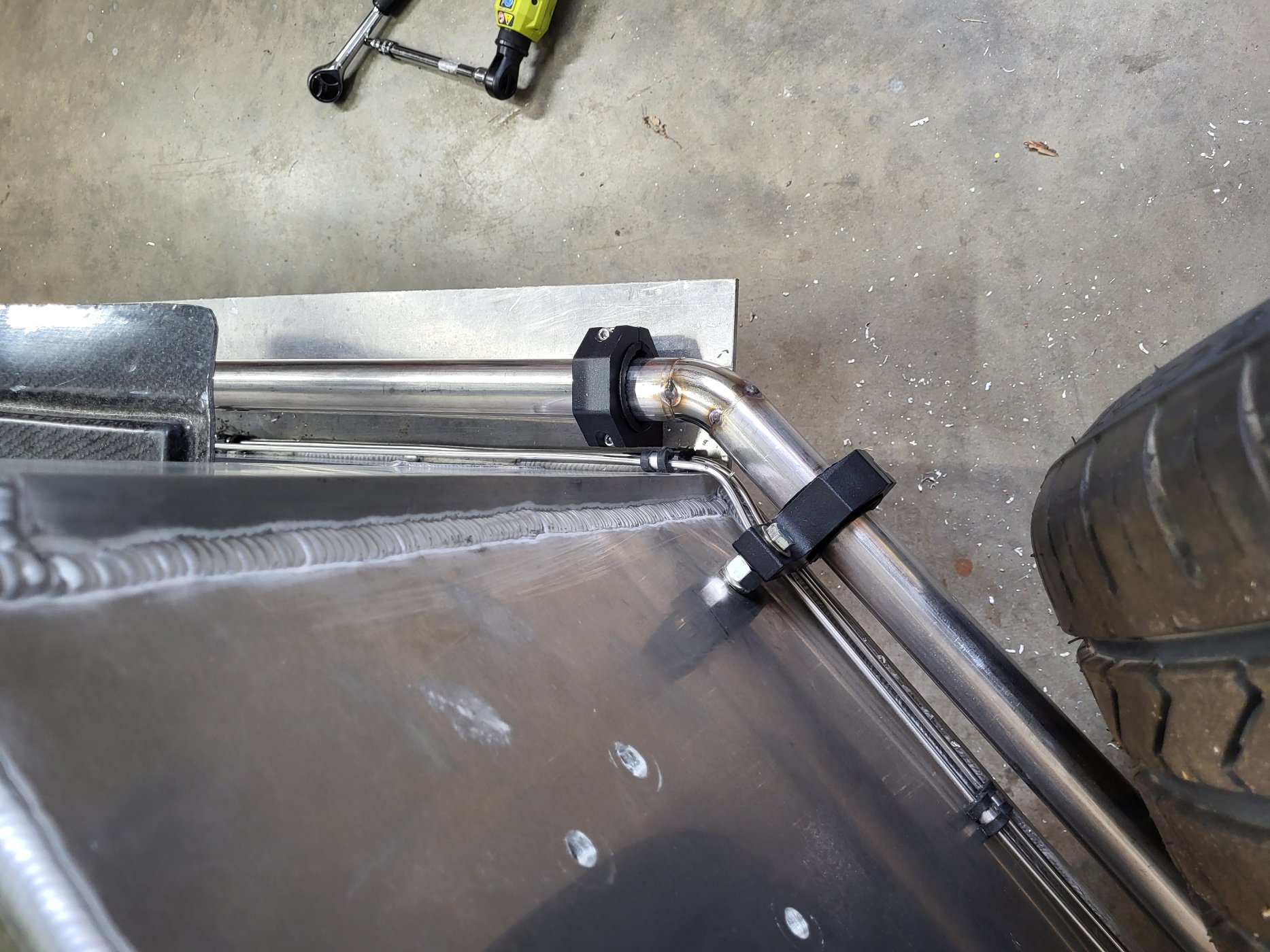

Pedal assembly installed, working on coolant line now.

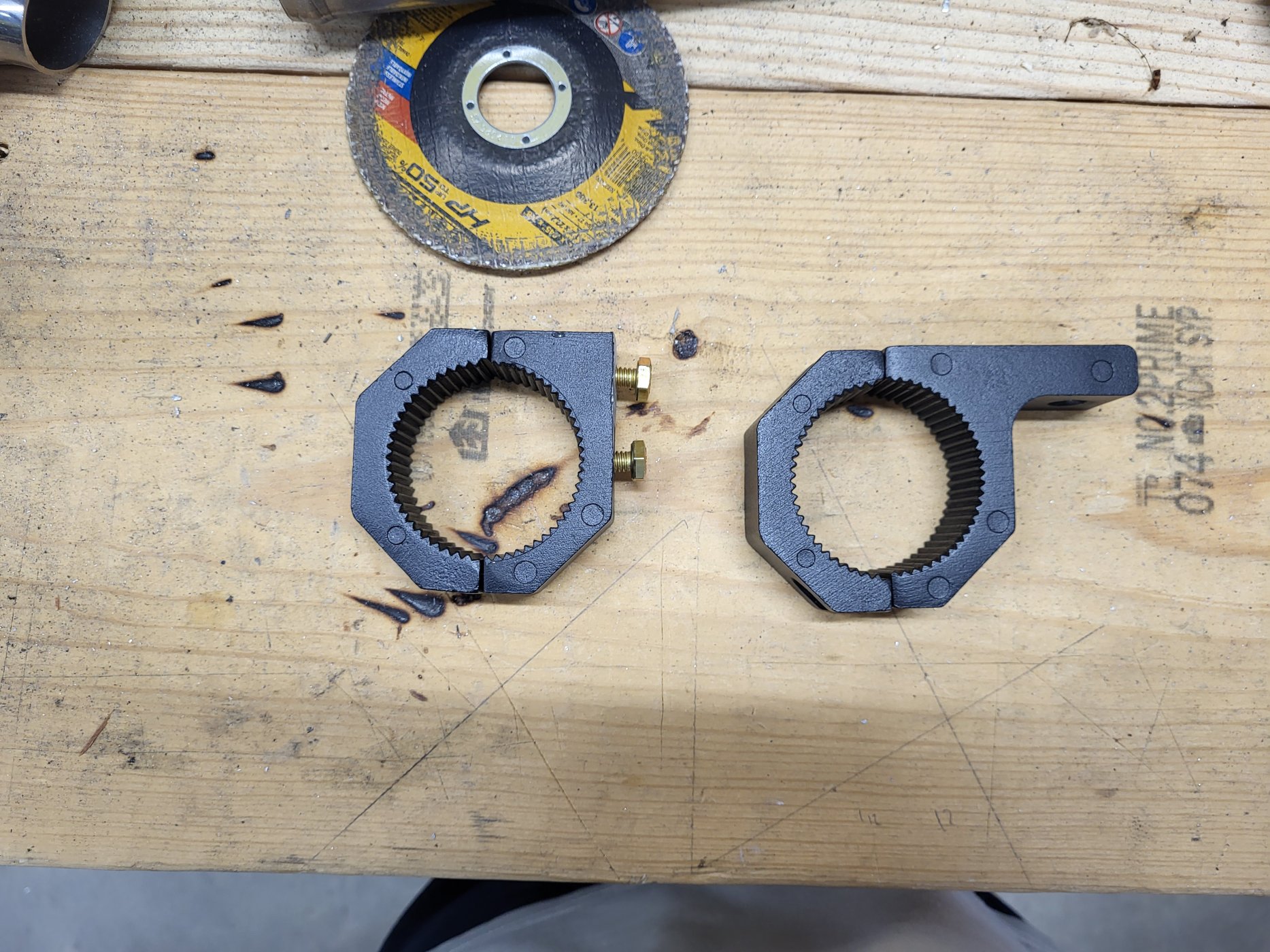

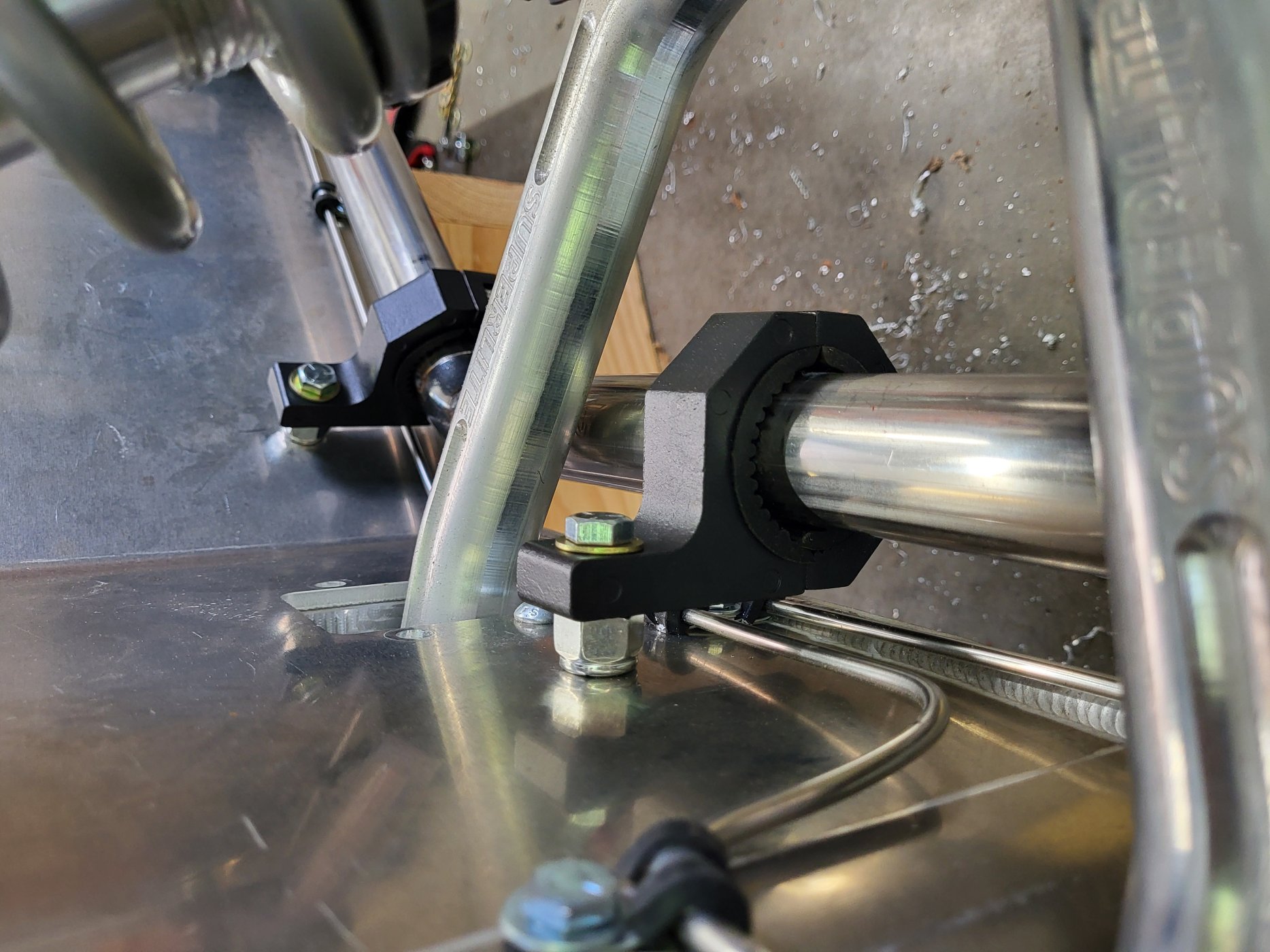

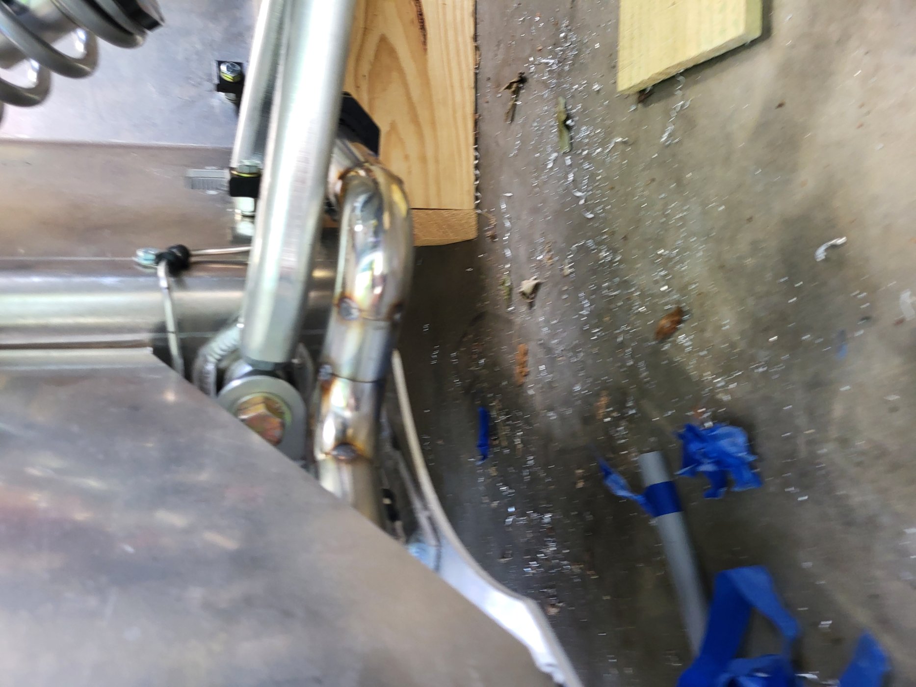

The brackets have different size rubbers in the package. I mounted the pipes with one size bigger so there is a little play to compensate for misalignment and insulation.

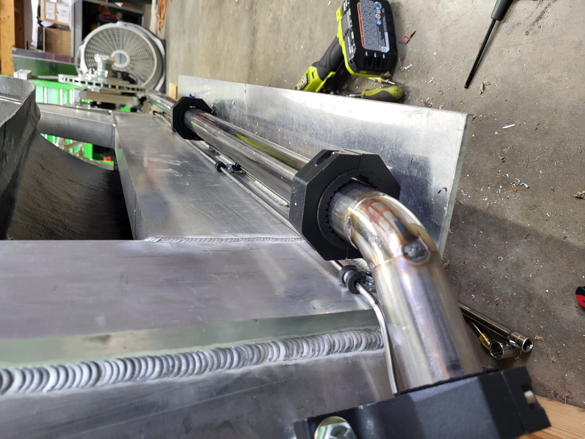

Everything is tacked and I am thinking paying a professional to do the final welds.
Some of the bracket coming on the side have been modified
Next step is motor side, weld and proper spacers for the front brackets. The big nuts are temporary

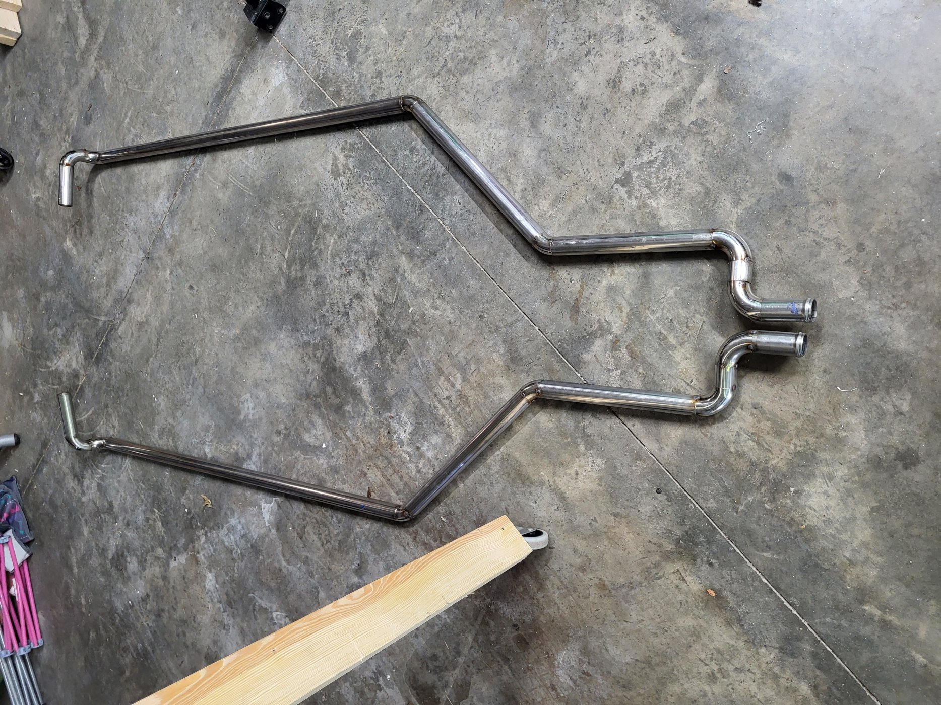

Coolant pipes are finished and will go to the welder next week to be fully welded.1000011828.jpg1000011827.jpg1000011825.jpg1000011832.jpg

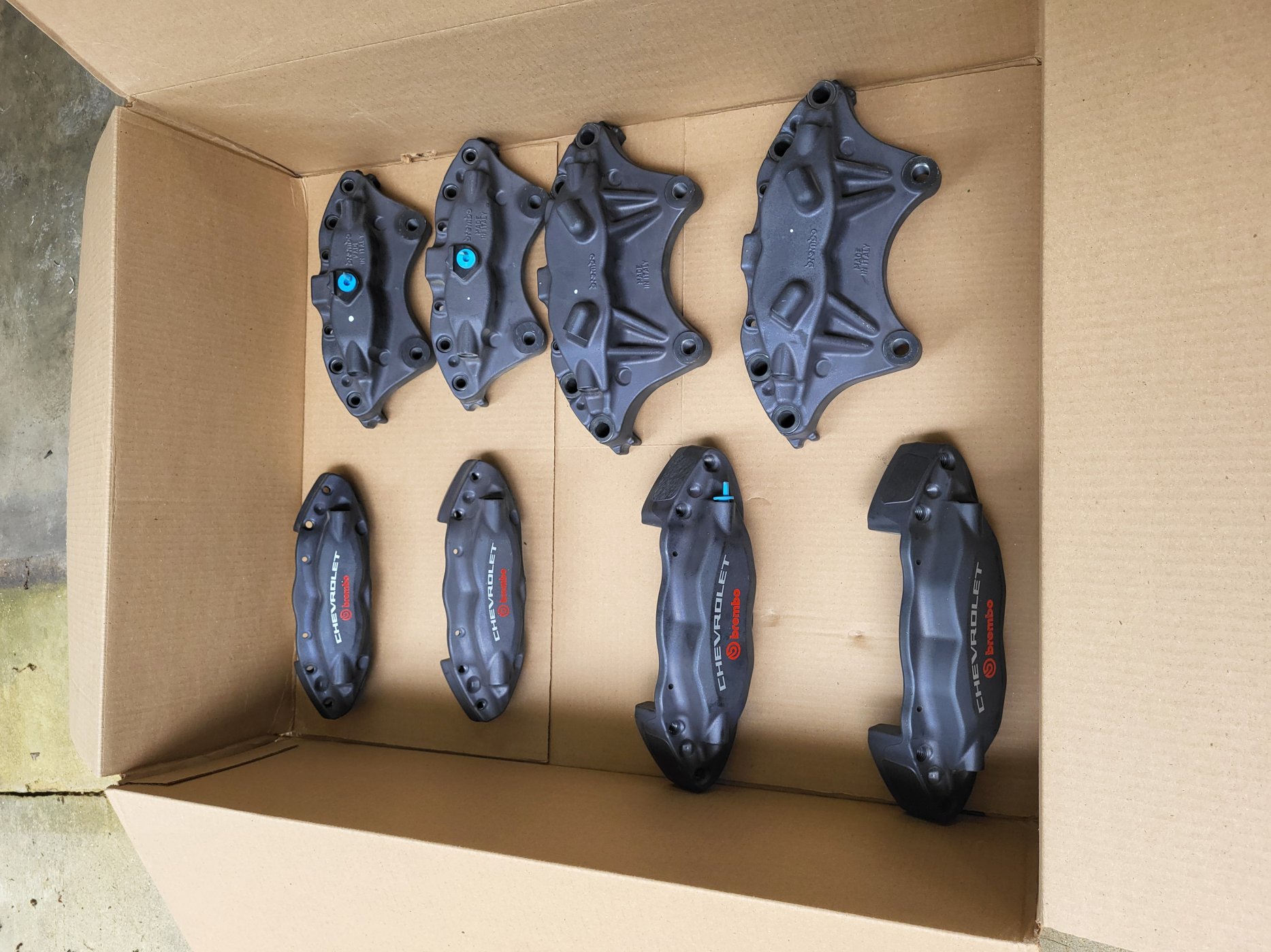

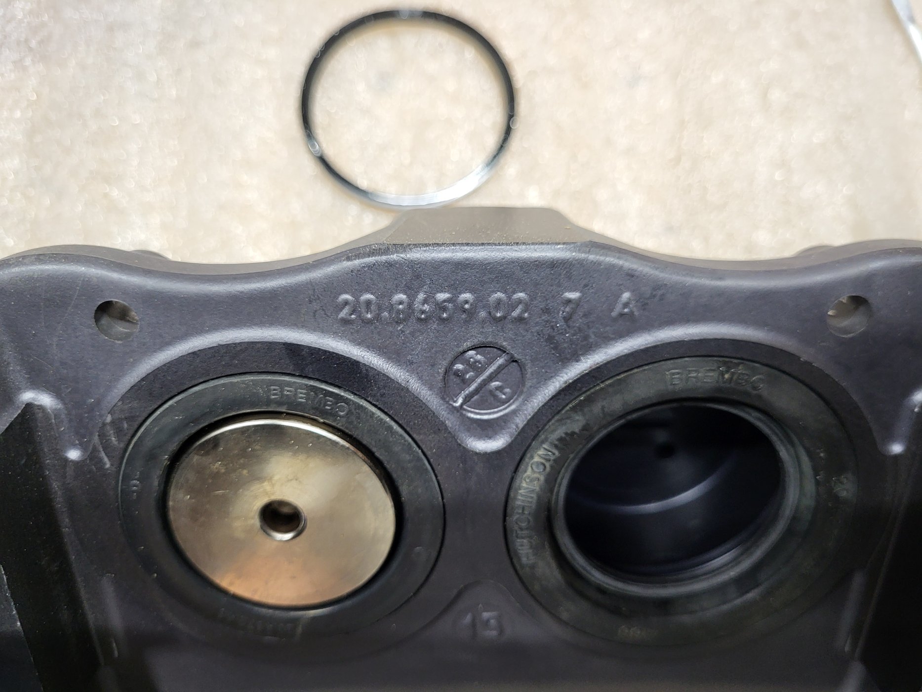

Brake calipers are desasembled and out for powdercoat.

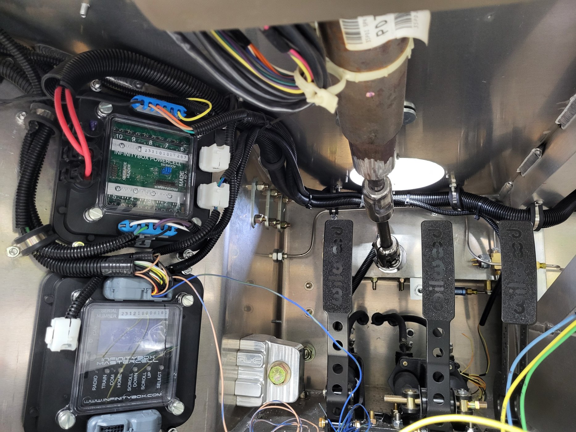

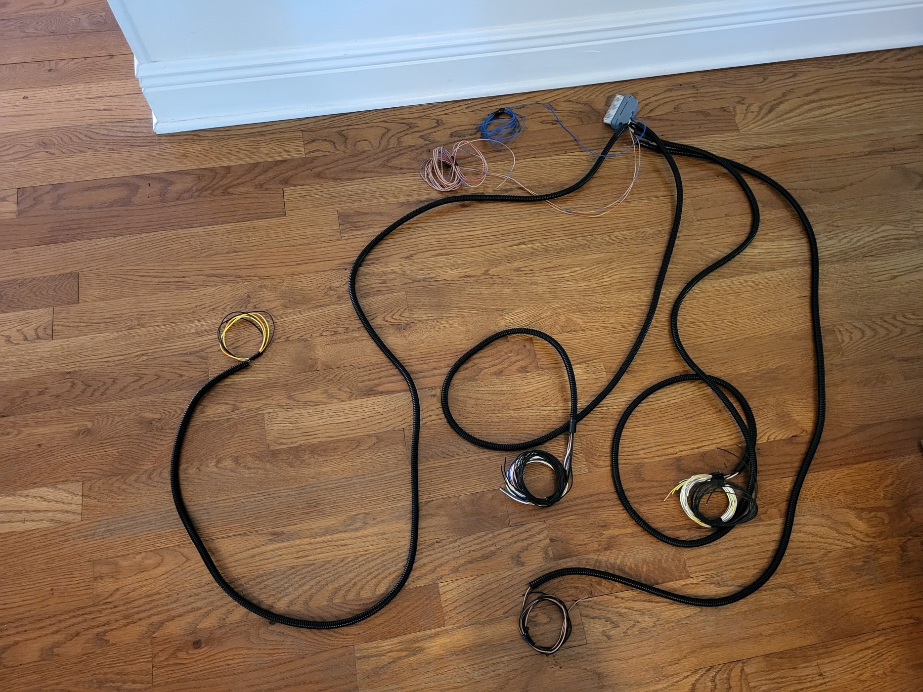

Now starting to look at wire harness.
The manual is really light !
Any good post on the infinity system installation ?

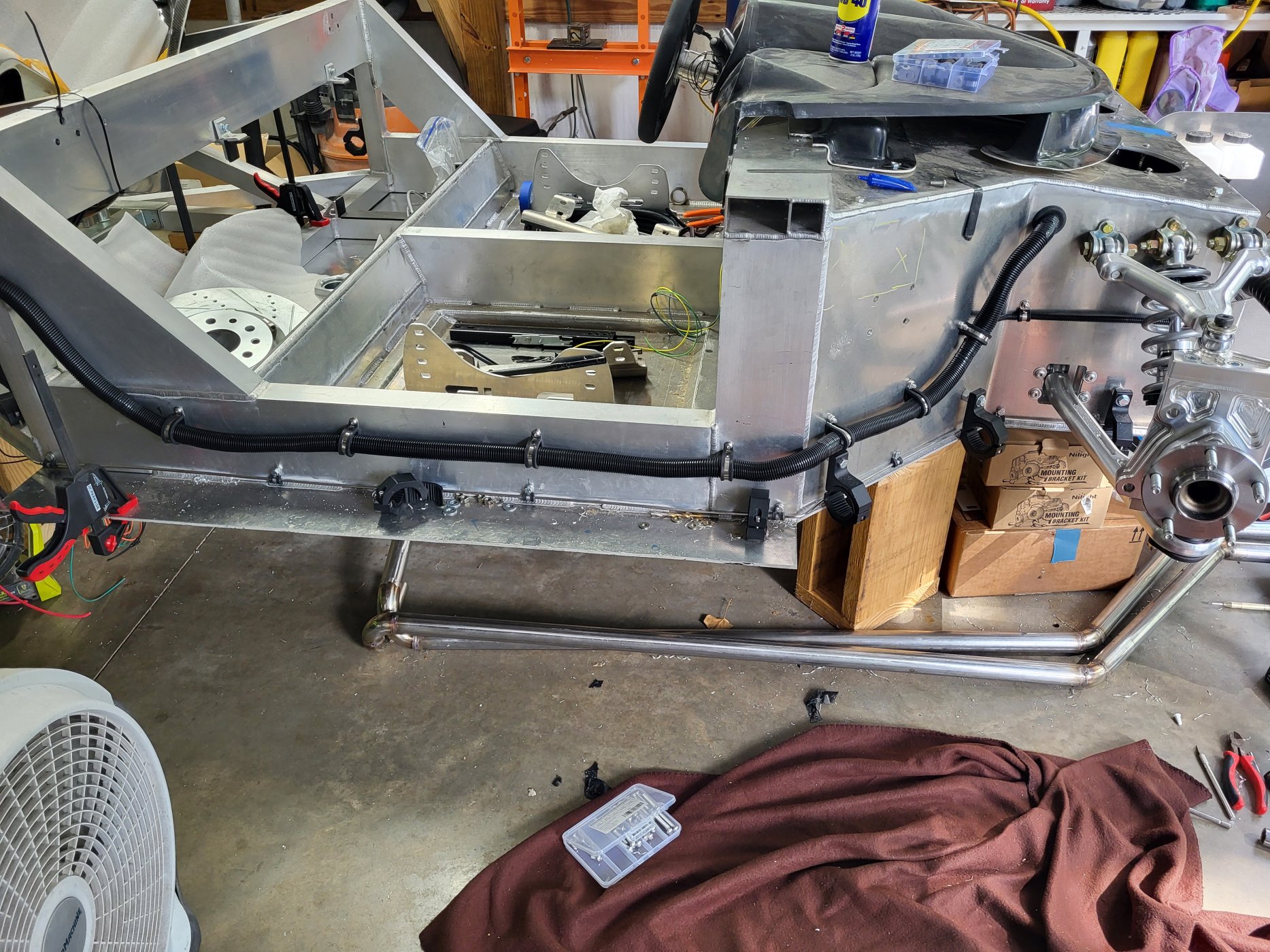

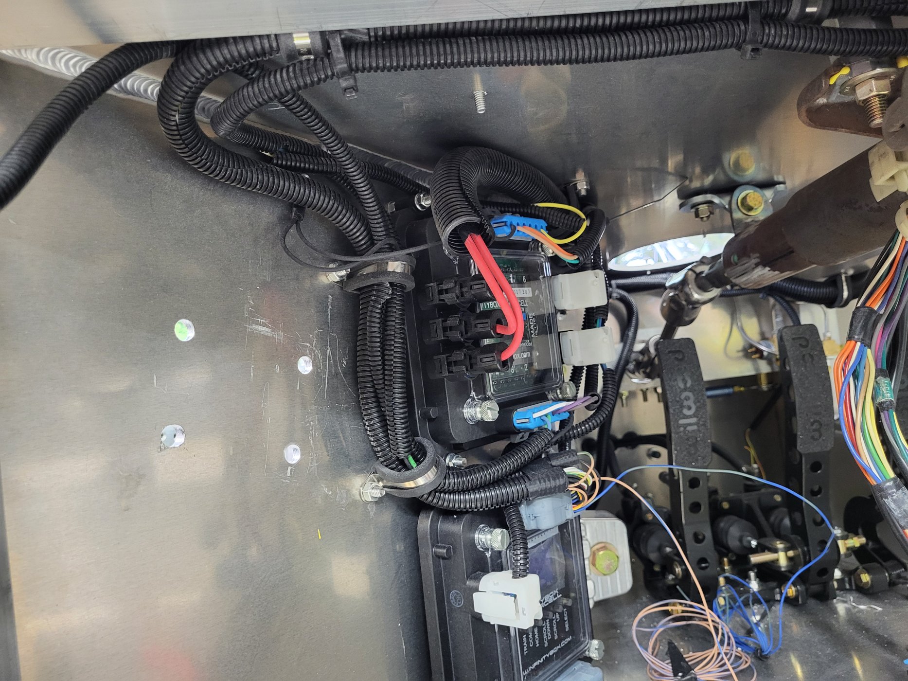

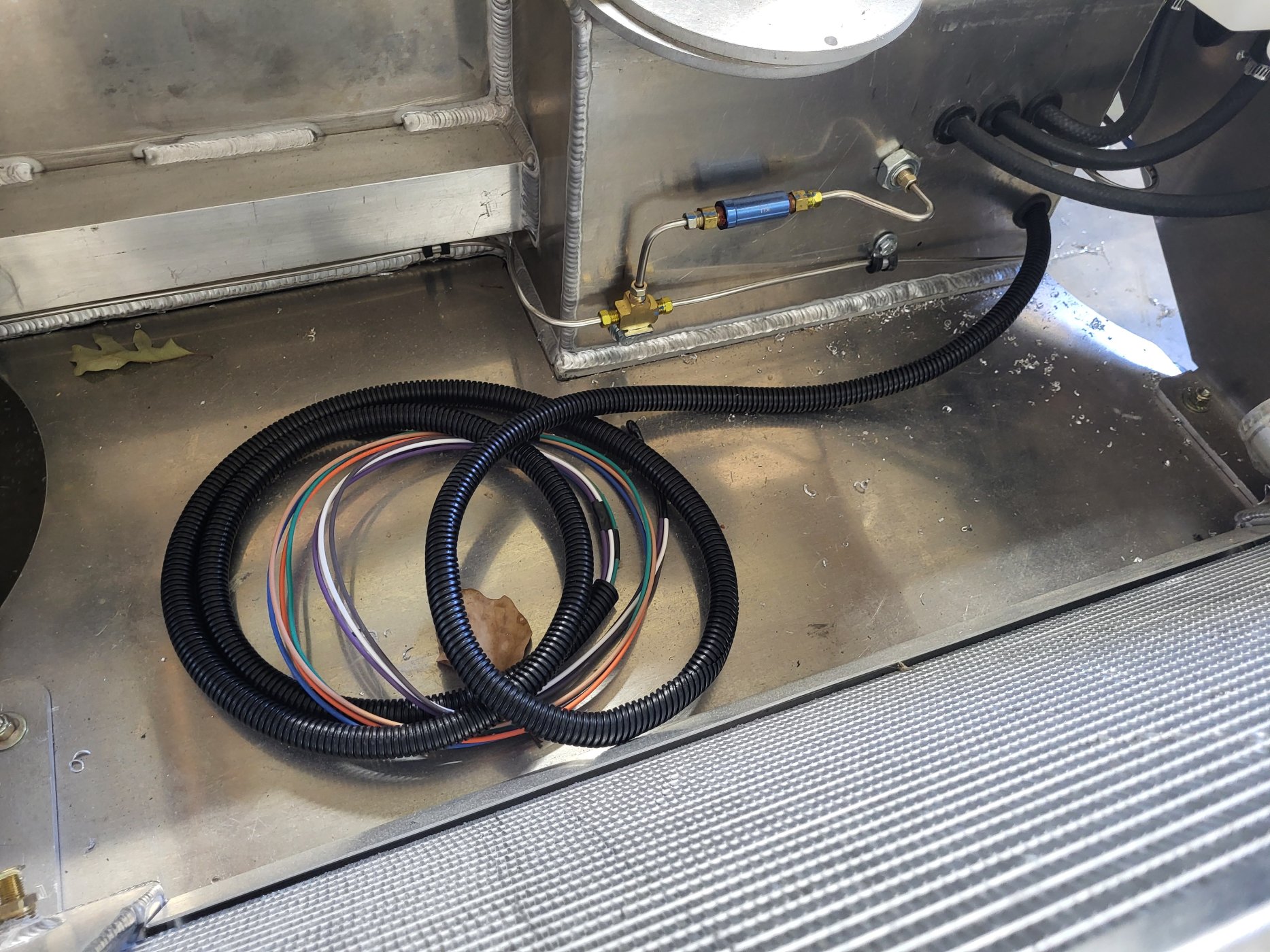

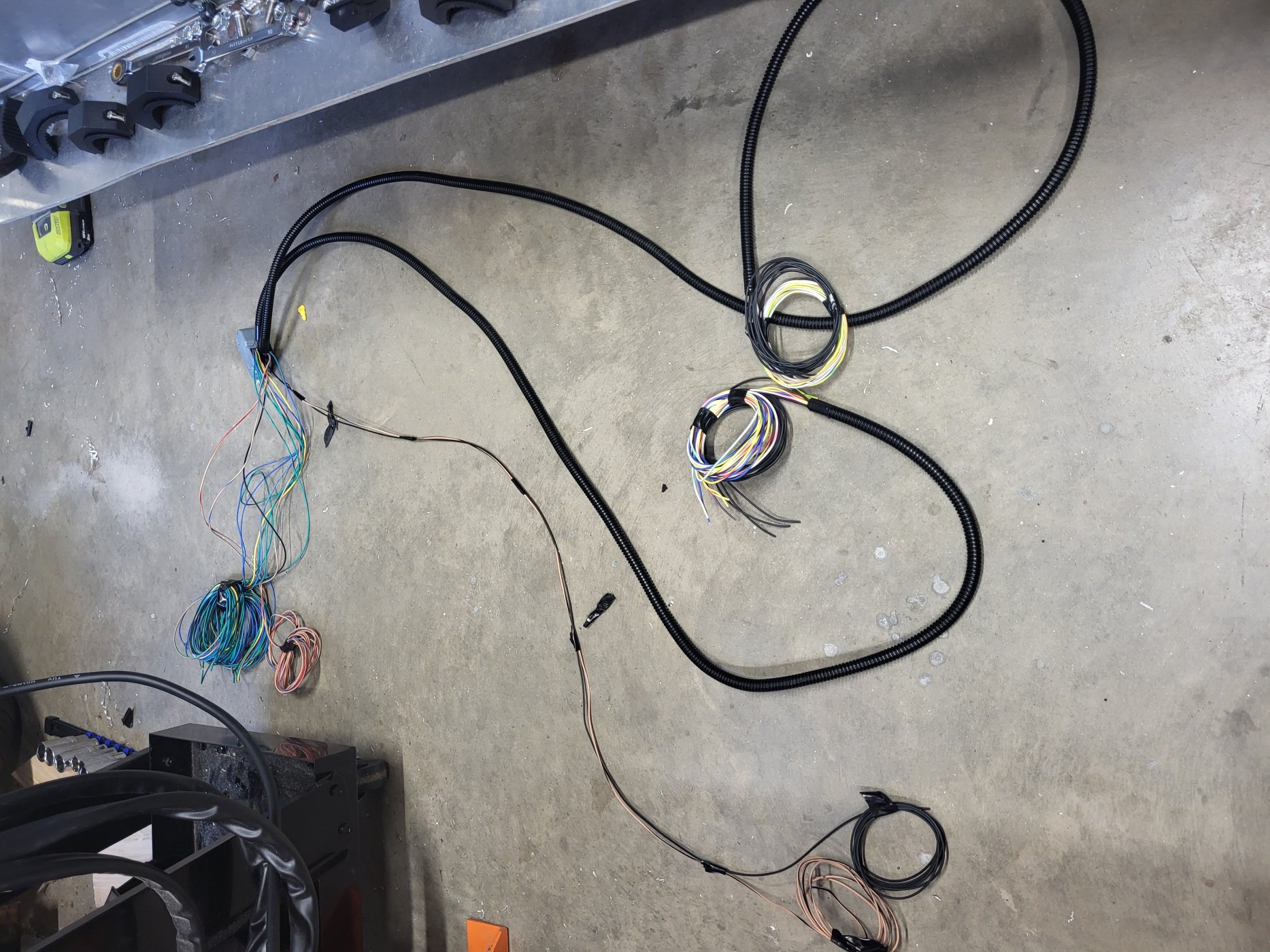

Progress on harness this week end.
Everything is divided by area it is going in.

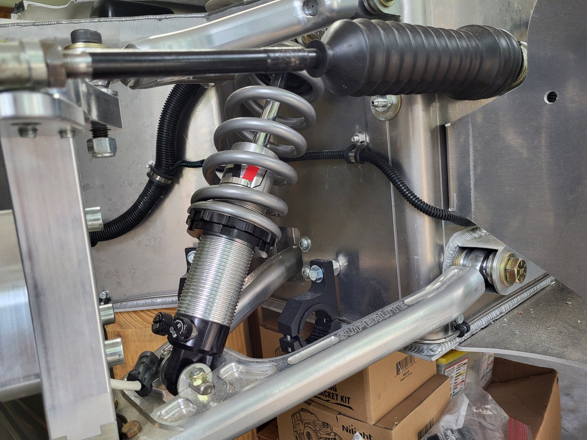

Front power harness is routed, nothing finally attached yet

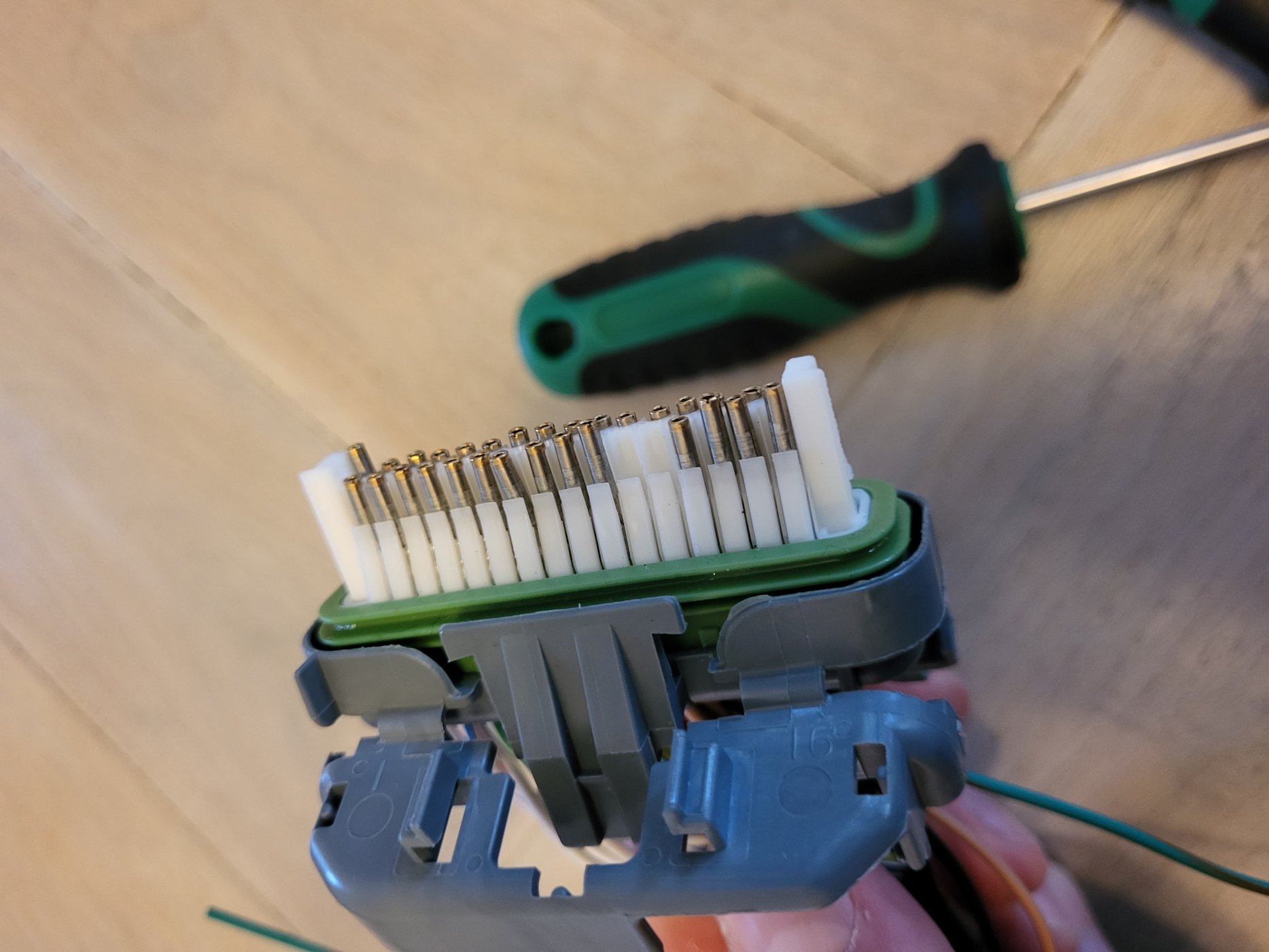

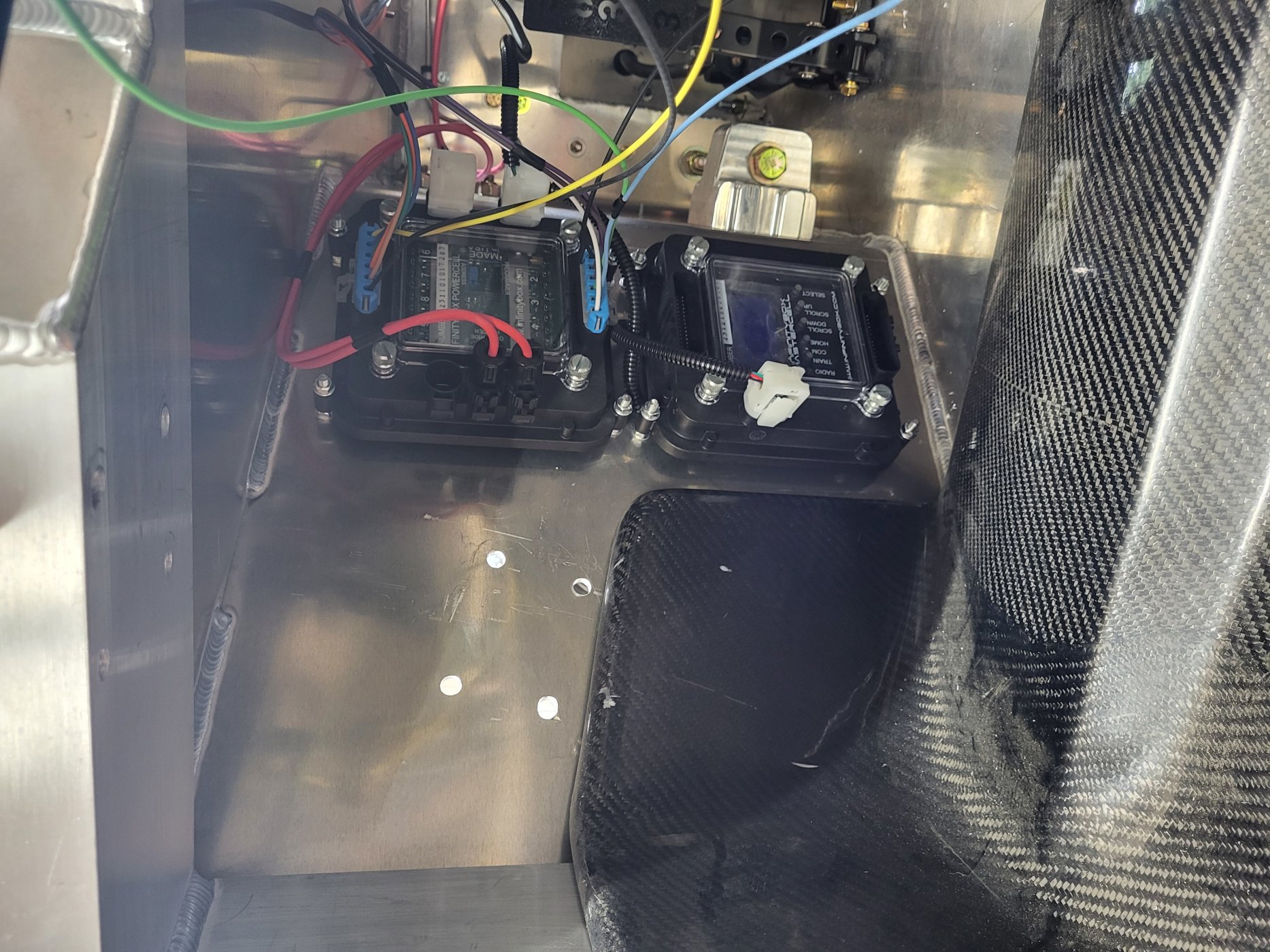

Cells are mounted and almost all connected
Master cell harness is also prepped with one set going to center console, on to the steering wheel, on for brake switch and one for door light switch.

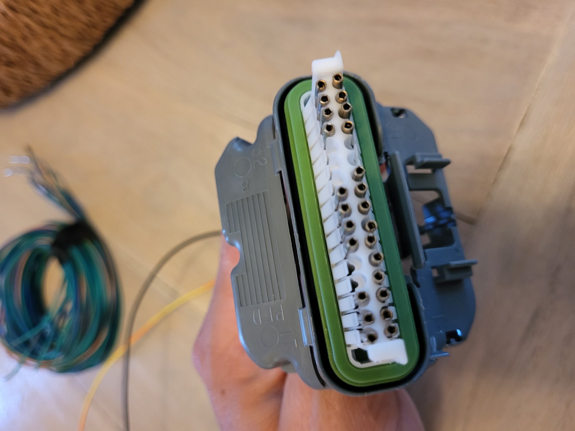

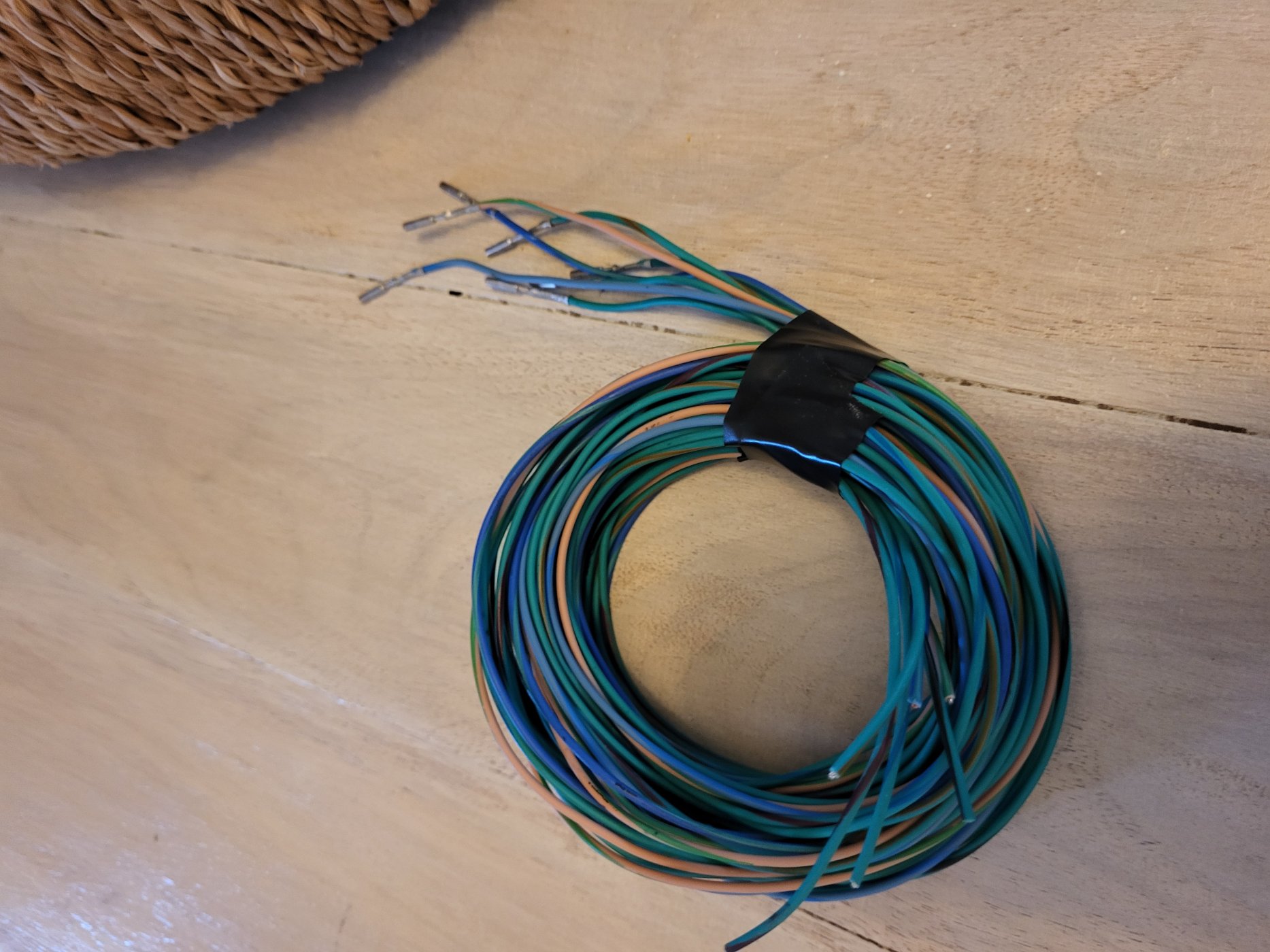

I have used 2 of the 4 open cables, but still have so many .
Green/brown , green/black, blue/green, green/blue, green/yellow, tan/green , lightblue/blue, green/lightbrown.
What do you do with all these cables? Just remove from the plug? They are not mentioned in the manual
More progress on wire harness. The main routing is finalized, with enough room to run all additional wires I will realize I am missing :)

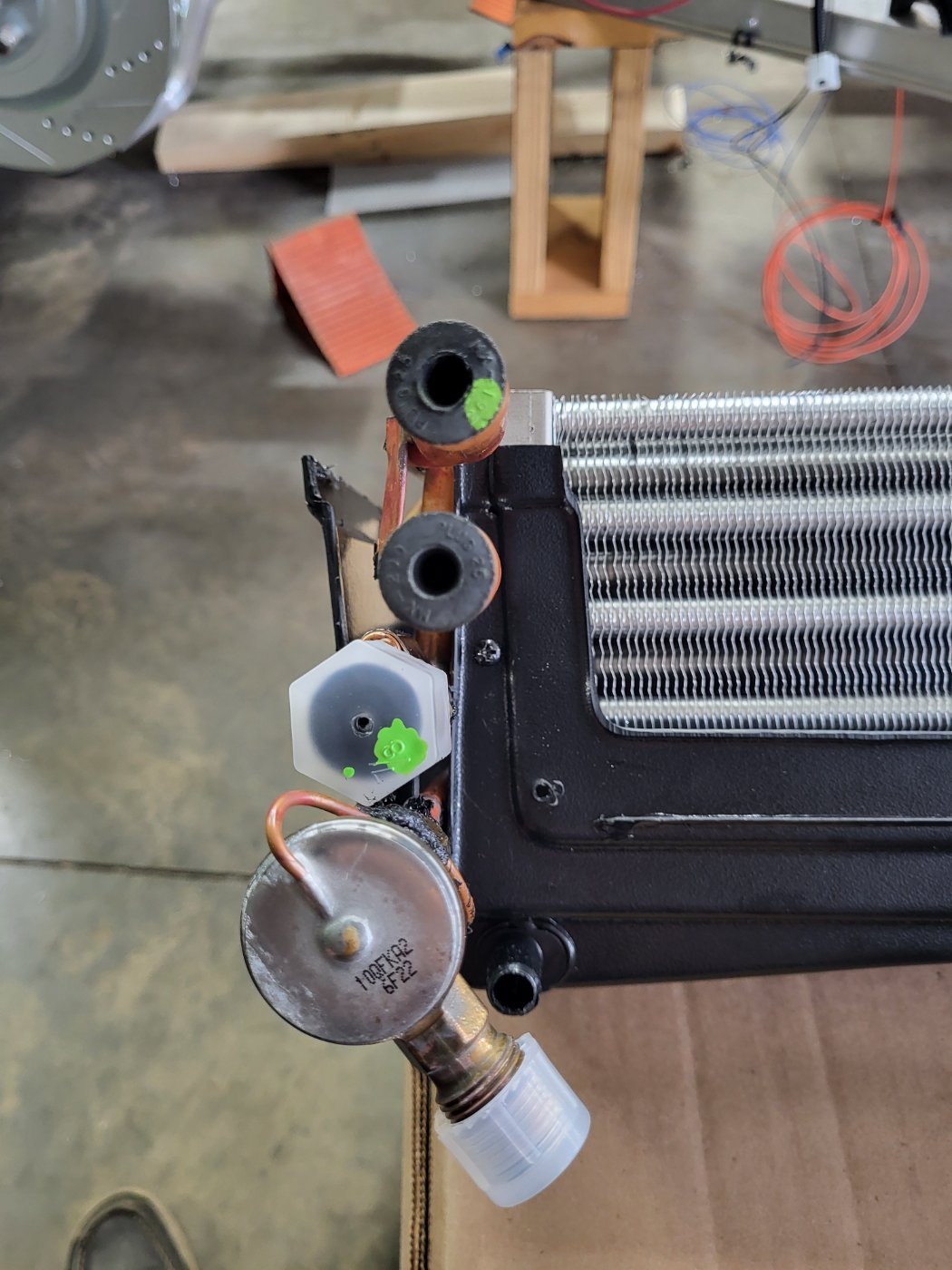

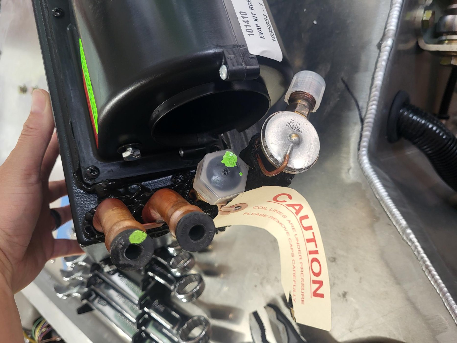

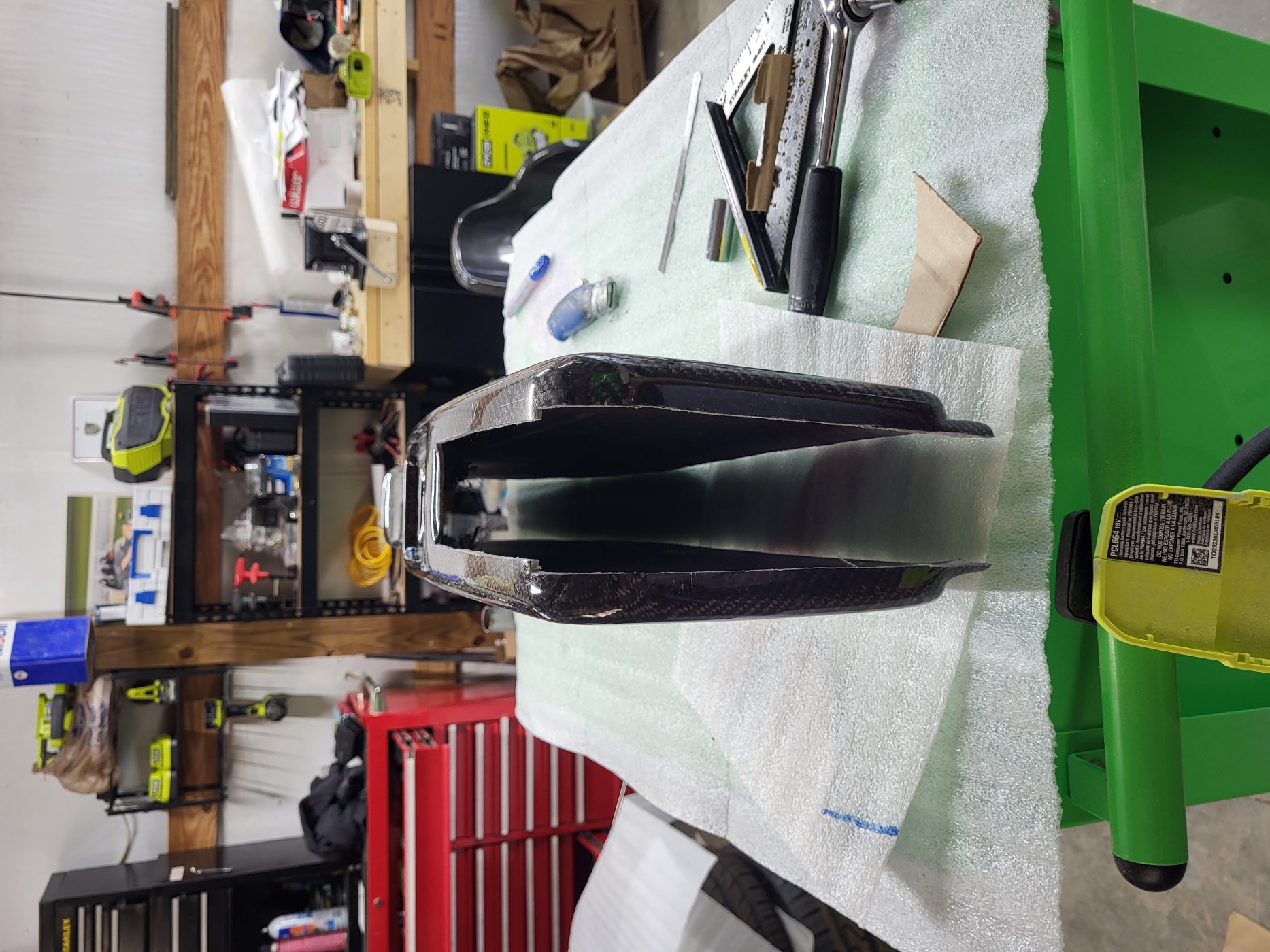

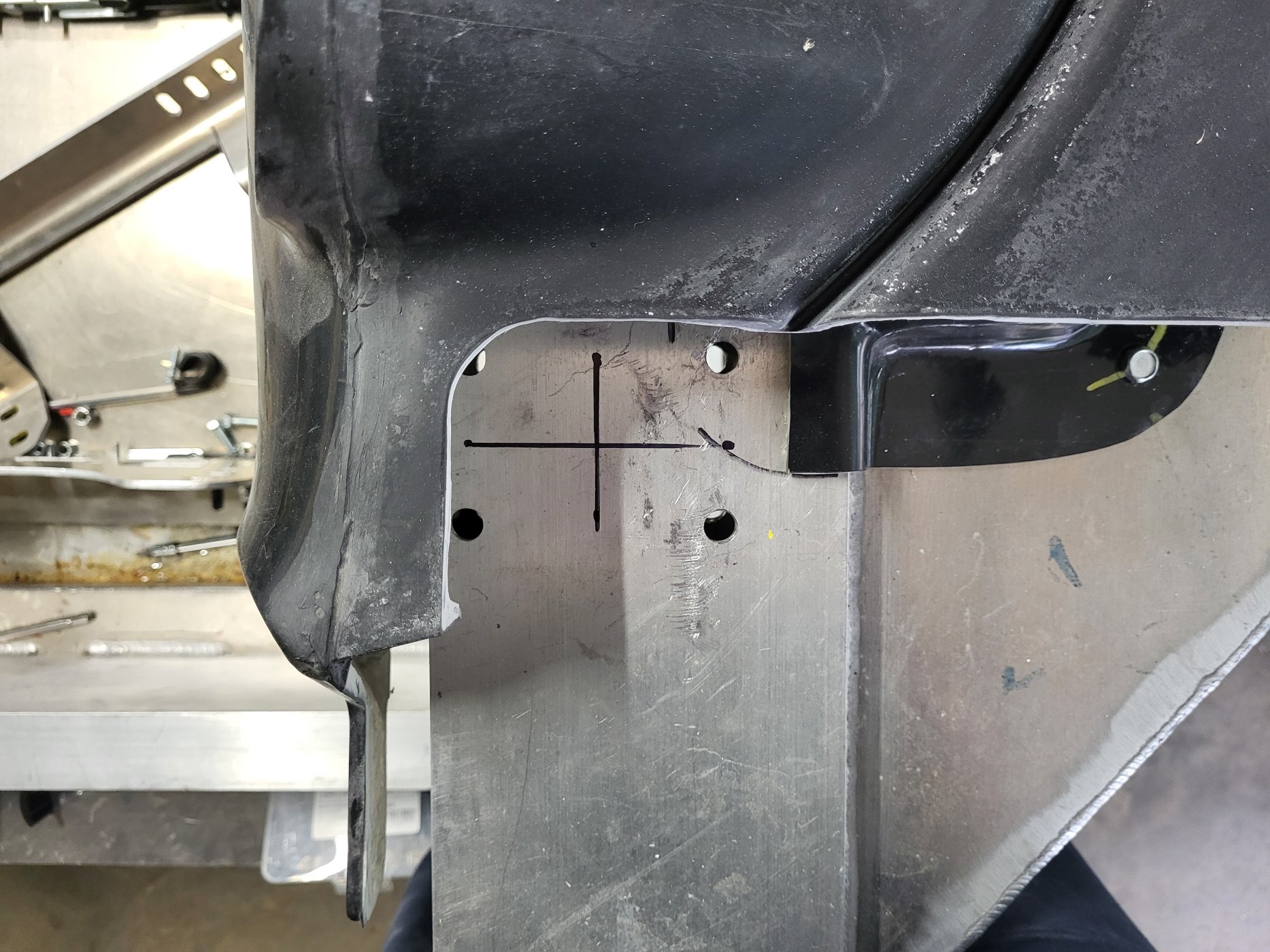

I also started cutting the dash so I can fit the plenum and the evaporator as I received my vintage air kit
the issue with the evaporator is the fitting (i have created a post for that)

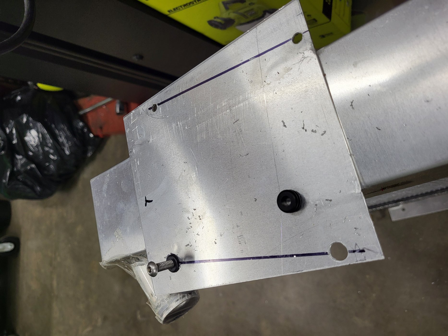

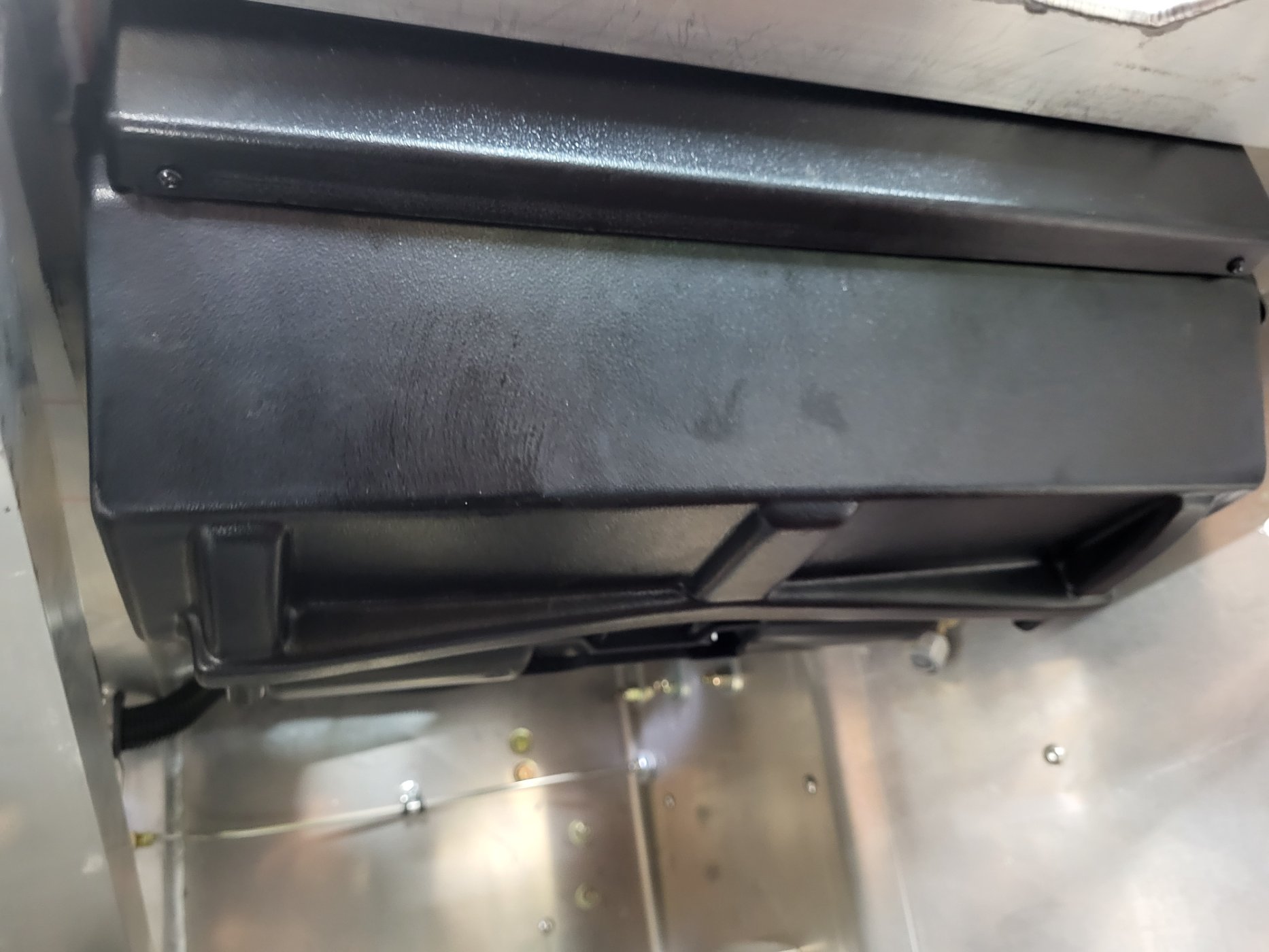

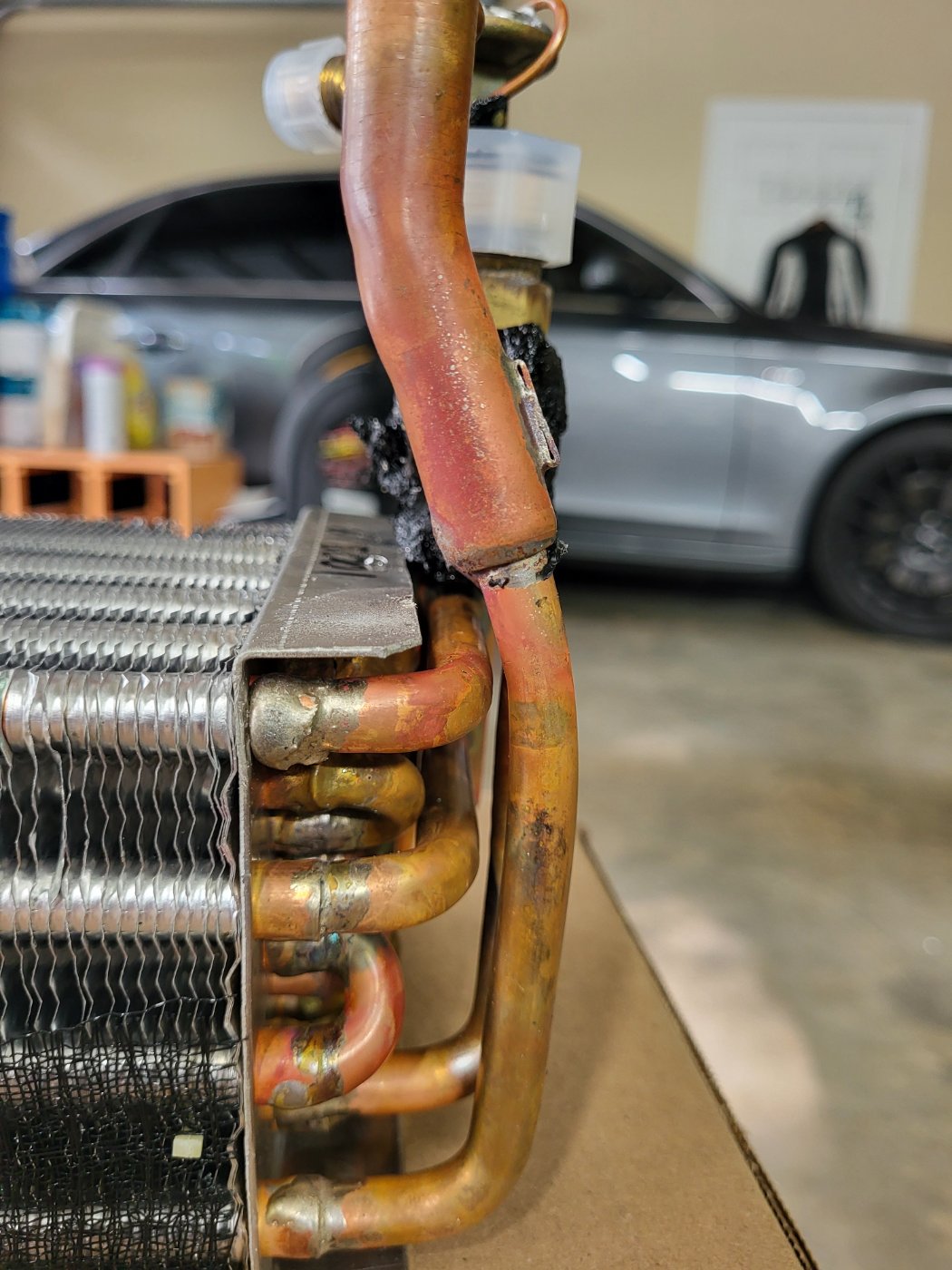

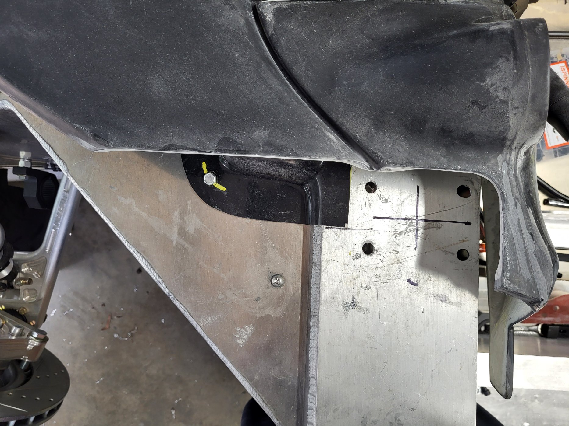

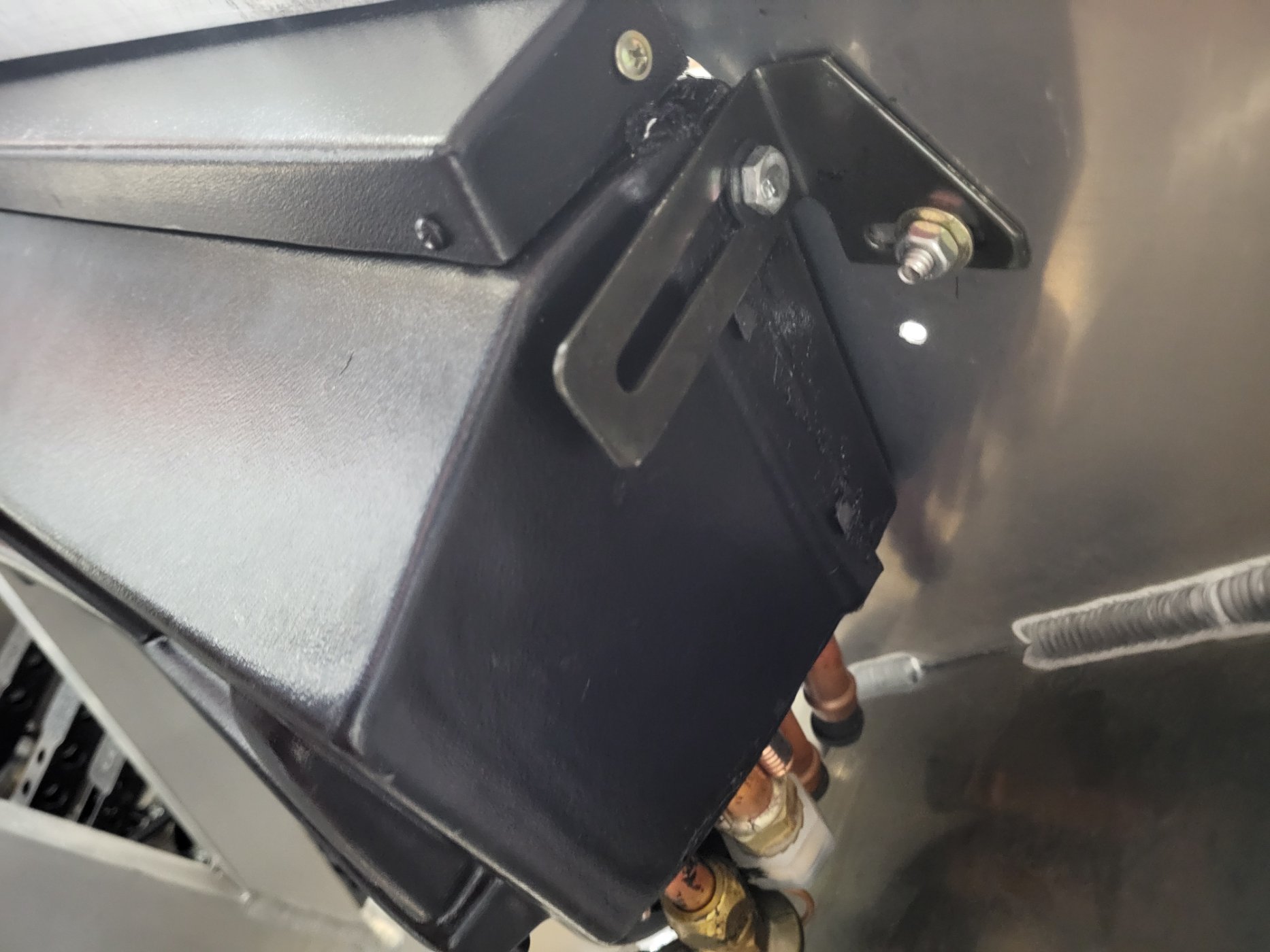

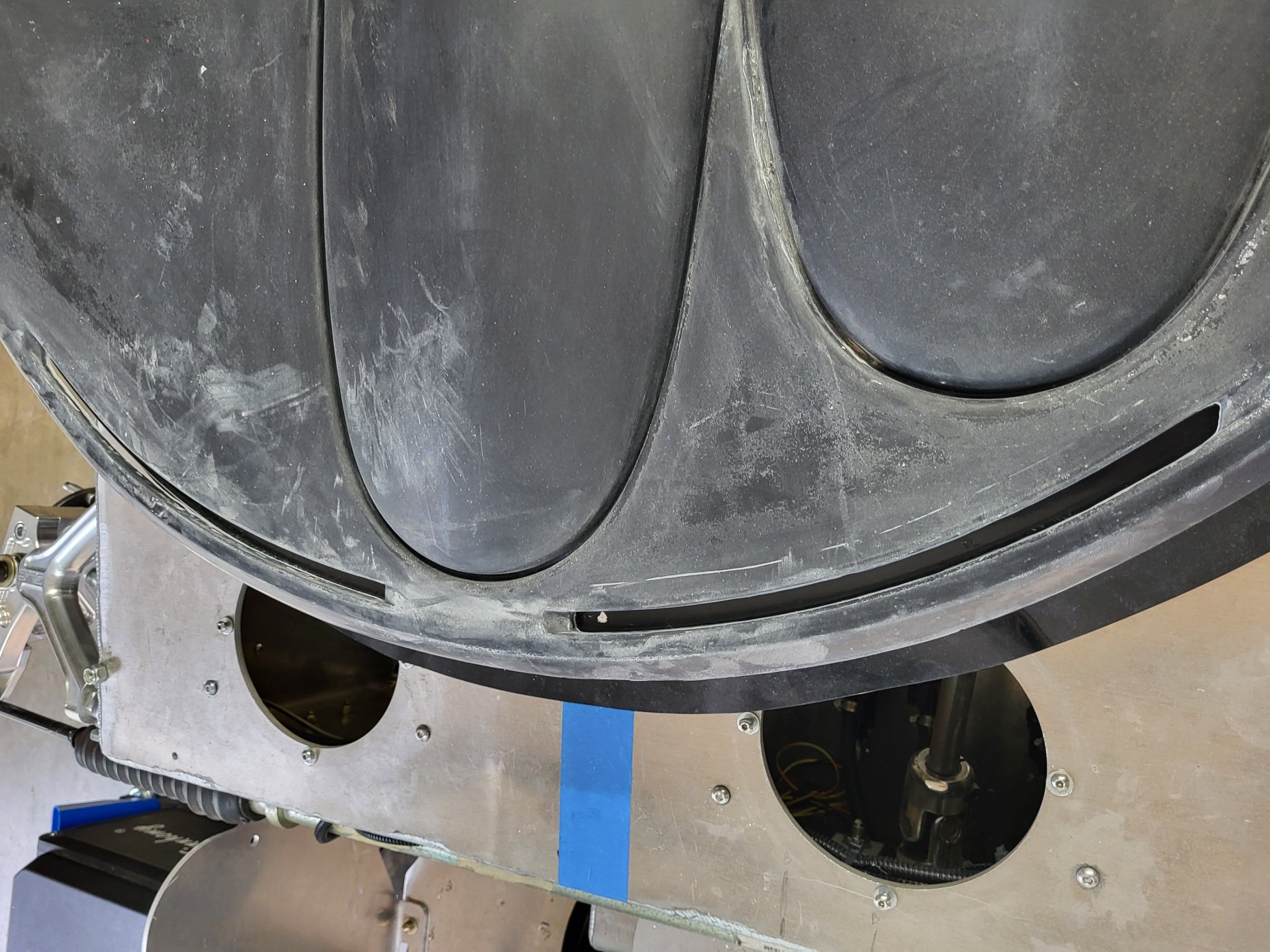

The week end activity was focused on the evaporator.

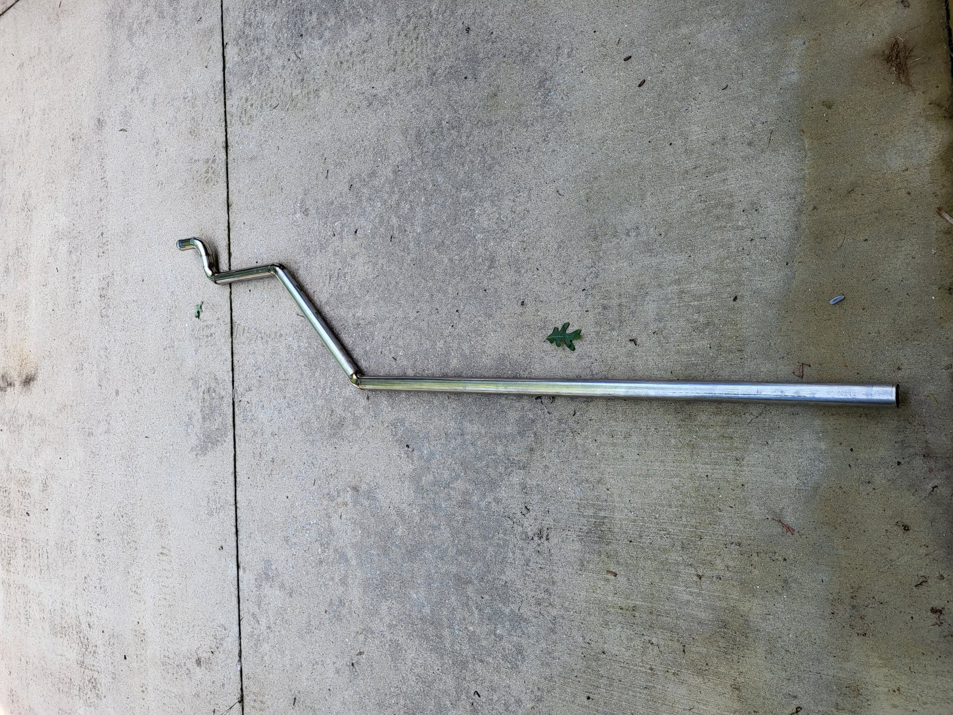

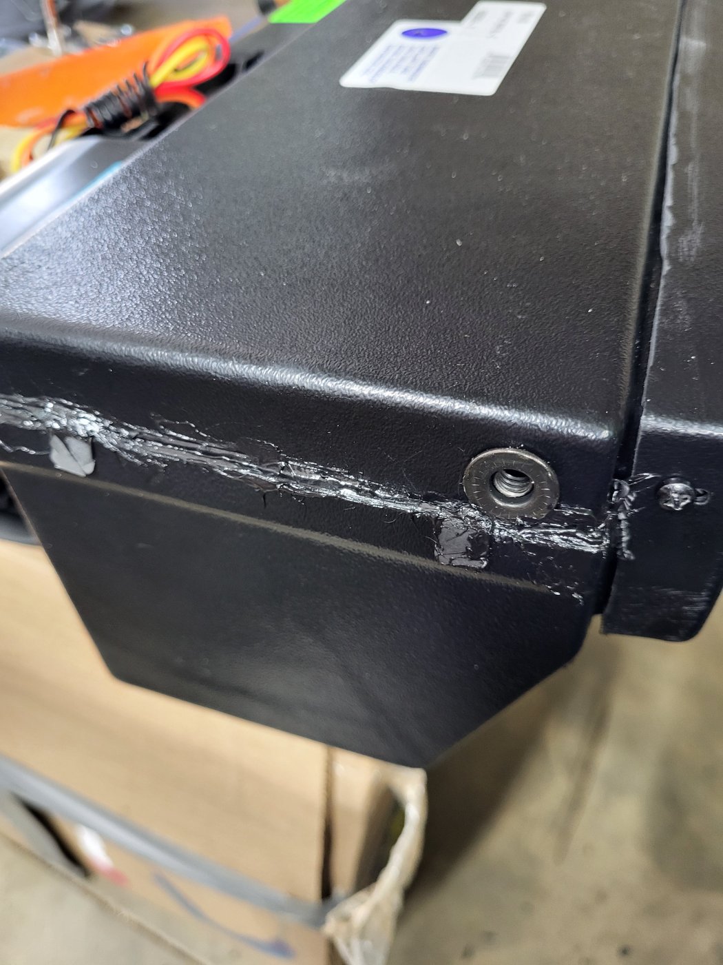

After getting answers from @Jkviper (thank you!) , I decided to go with the bending of the heater pipes. When trying to bend these pipes, they started to show "waves" on the back of the curve. I then decided to open the evaporator and bend the smaller pipe inside.
much better but still not impressed with the clearance, I then cut the front of the box shorter, so gain another inch forward. Pretty happy with the position now.
I cut off the holes and added 1/2 insulation foam in place, maybe 1/2 is too much as it not squashing easily.
