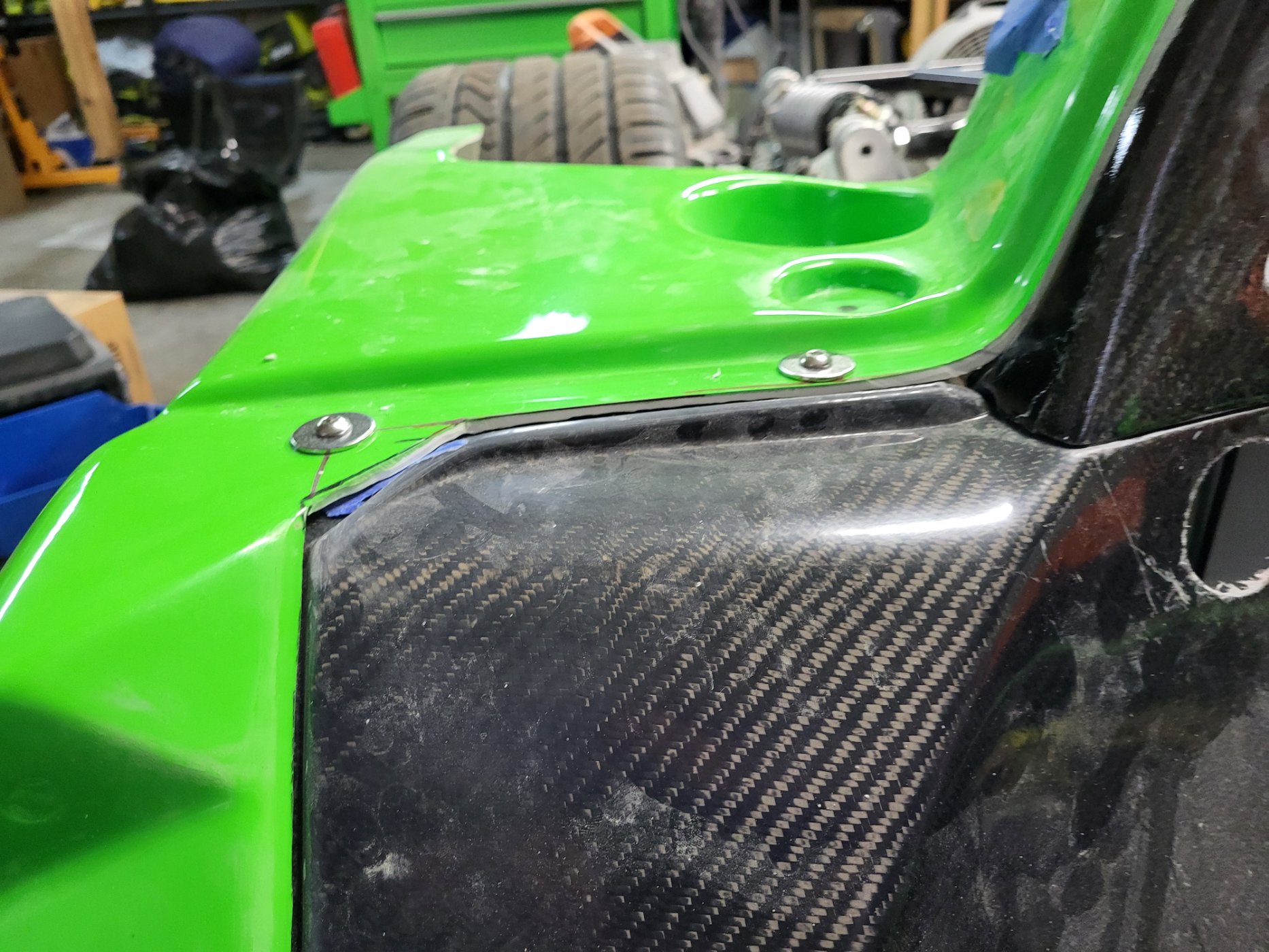

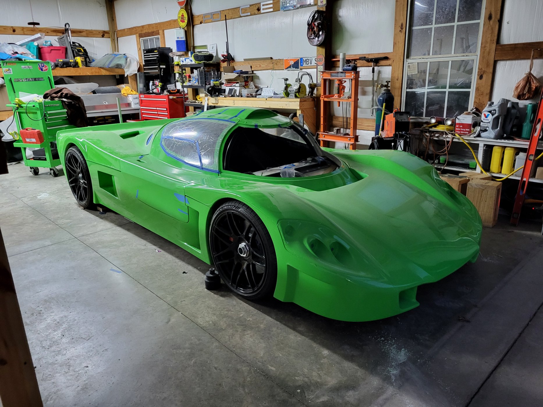

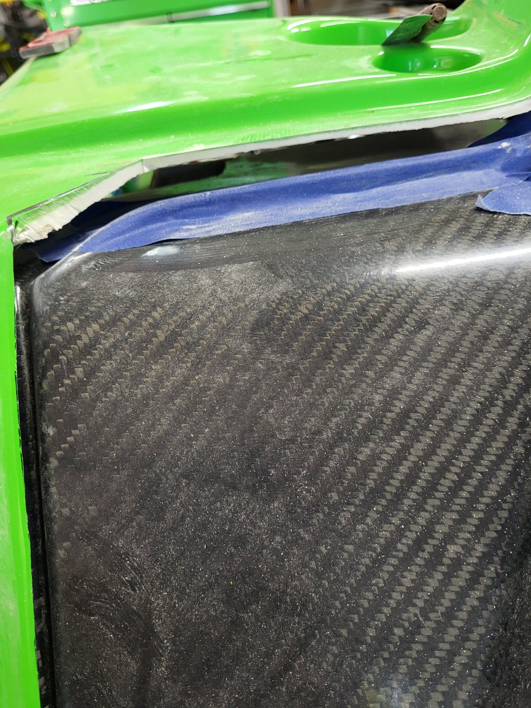

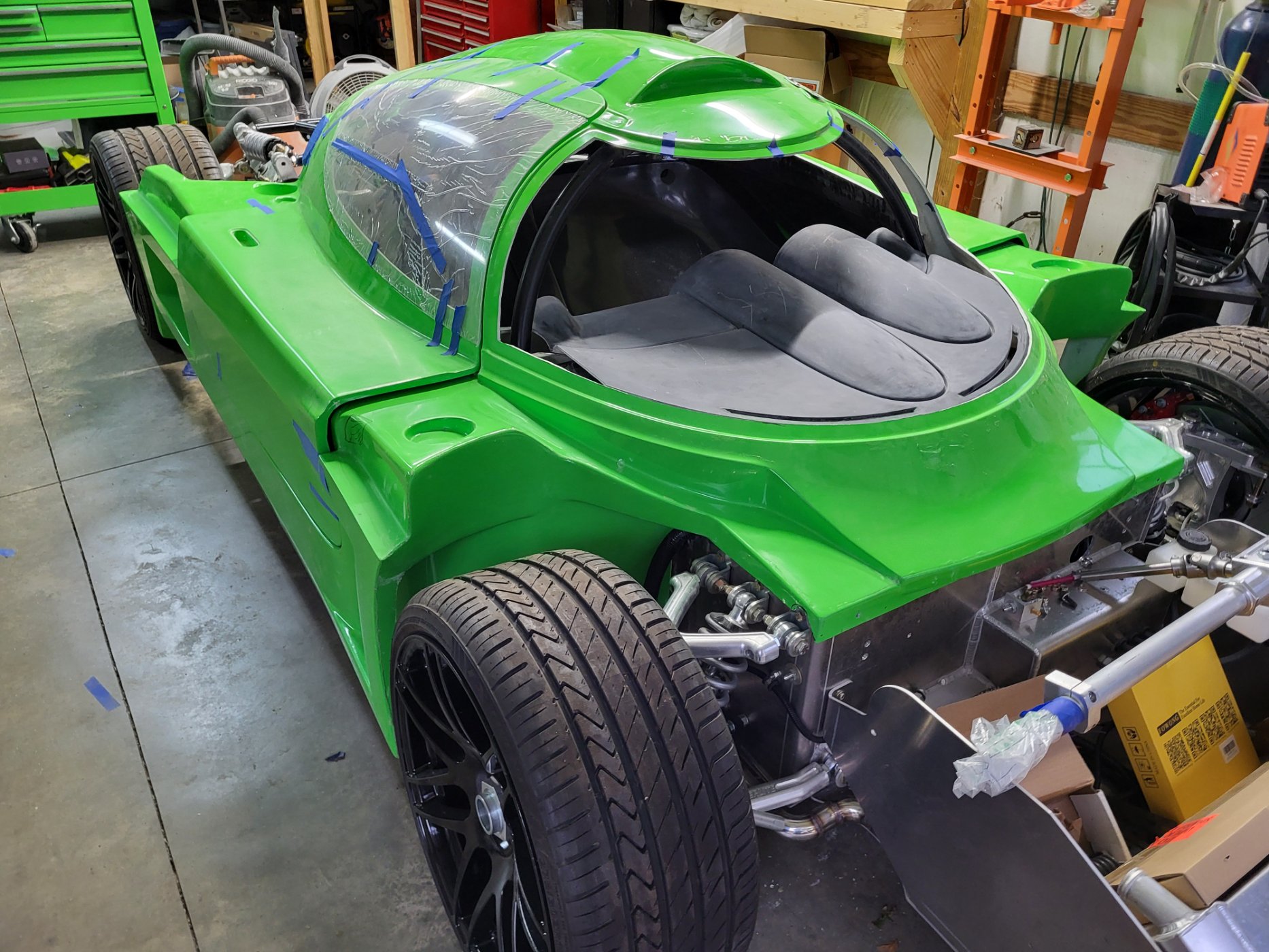

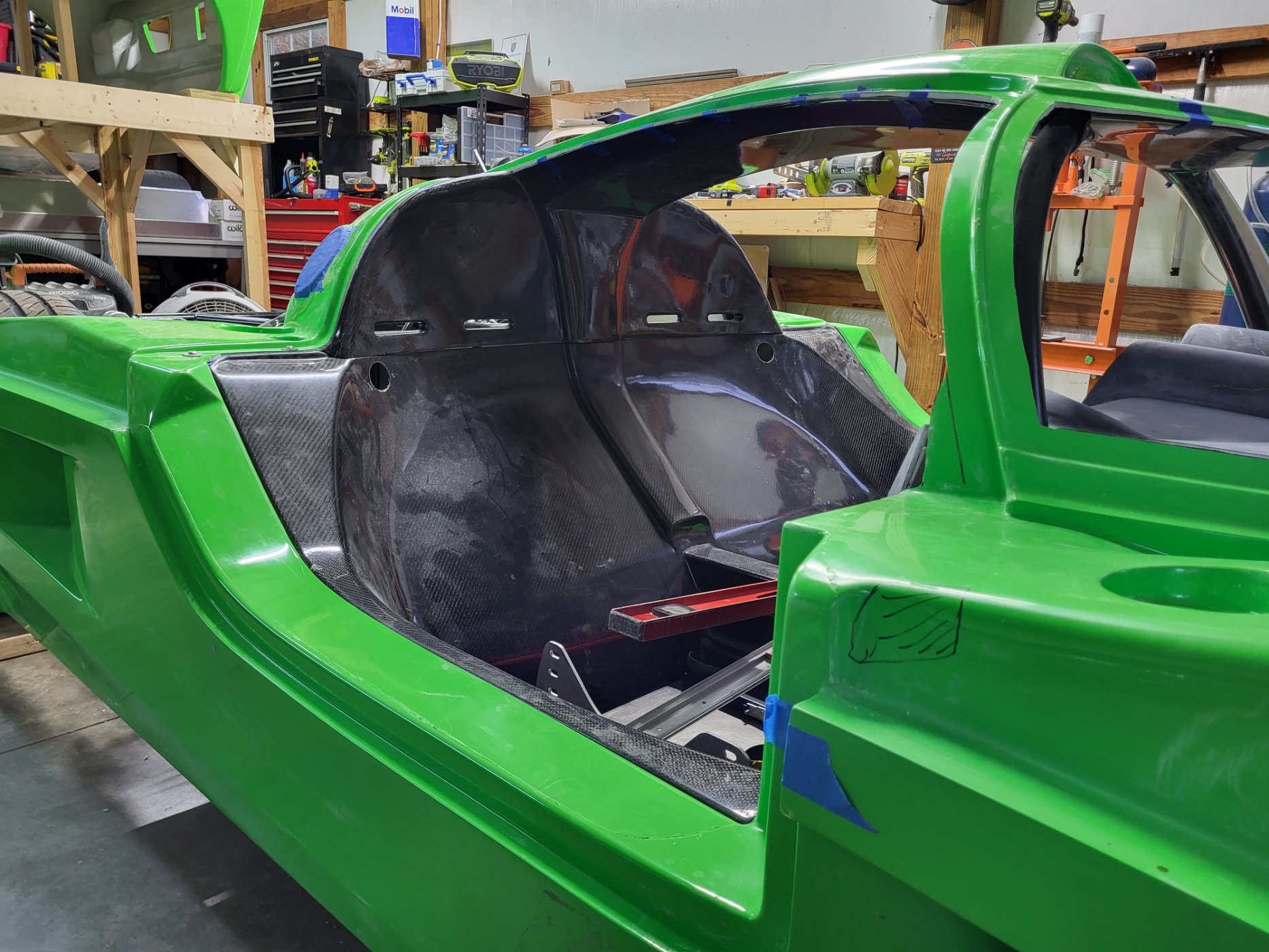

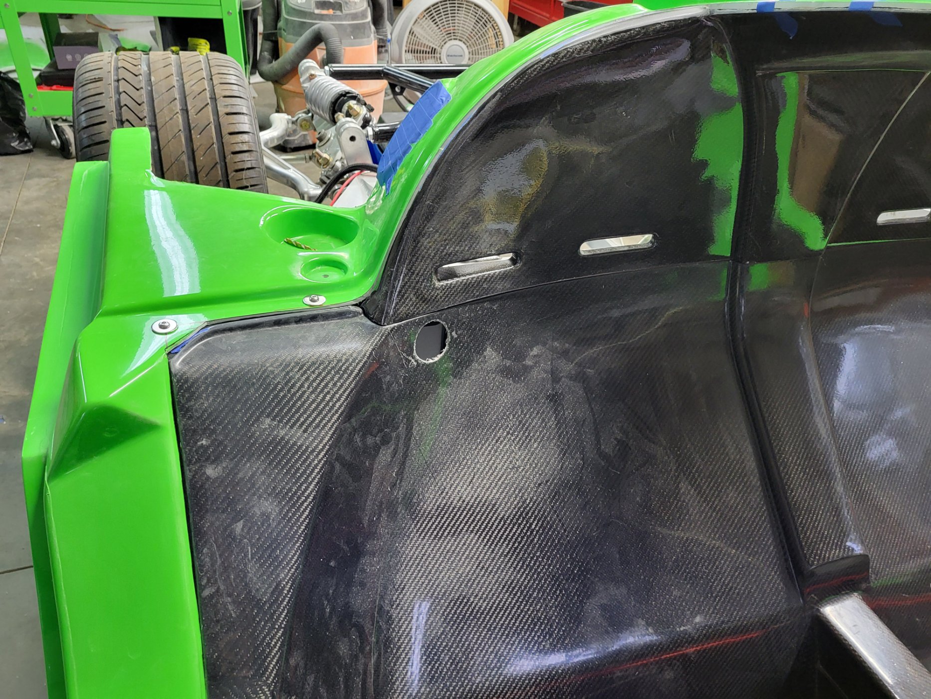

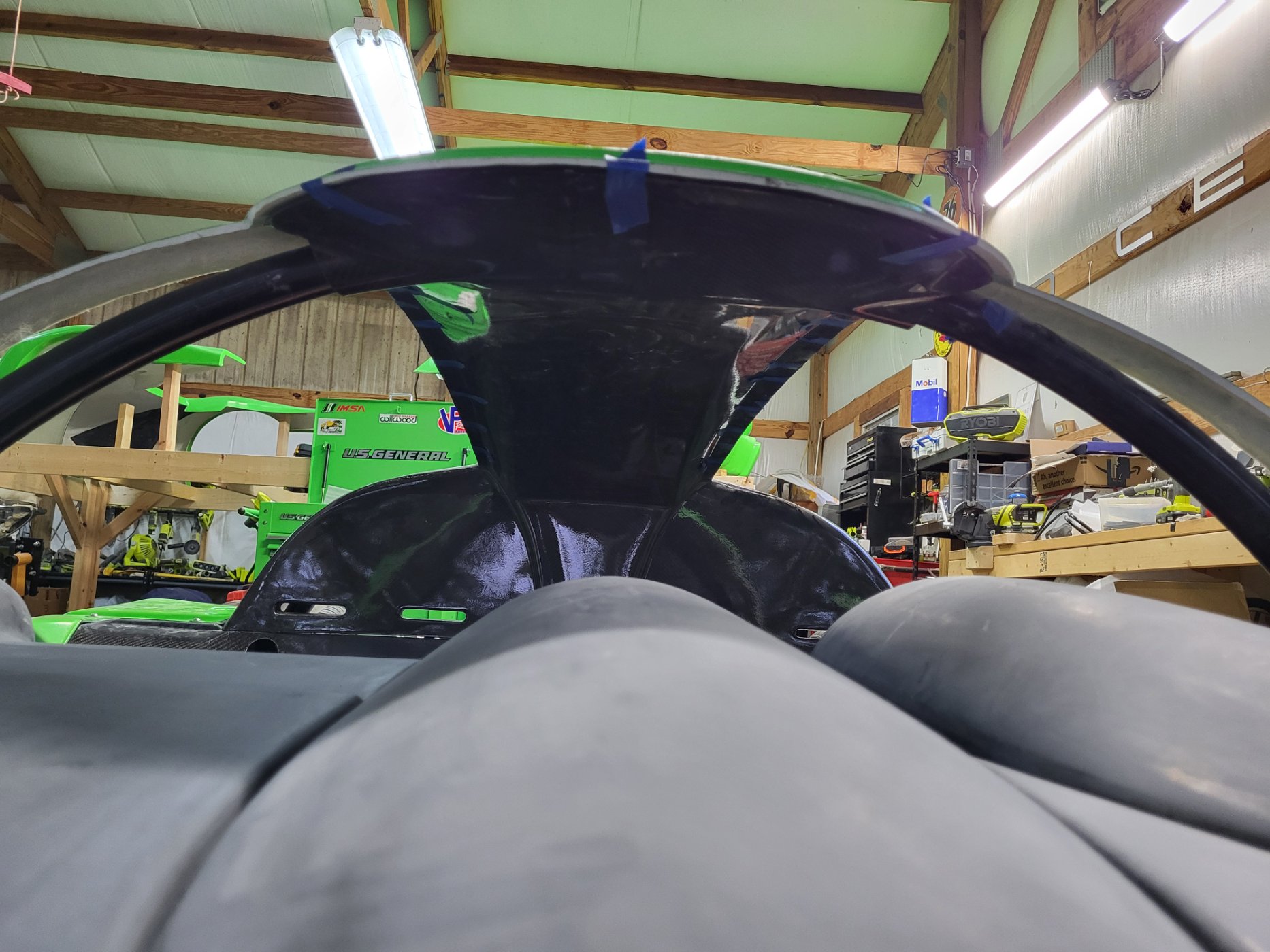

after cutting and cutting the tube at the bottom to lower it, I still had the issue. It looks like the dimension of the tube and the body are not matching. The issue is the dimension of the bulk/roof panel compared to the top portion of the spider, and clearly more in the passenger side than the driver side.
I finally was able to get a descent fit by cutting more on the door opening then "stretch" the spider over the roof panel, also installing screws o keep it in place. I will replace the screw with something more discrete later, but for the moment I need these bog washers!
before:
after:
finally fitting properly:
before:
after:
View attachment 143346View attachment 143347
View attachment 143352View attachment 143351View attachment 143350

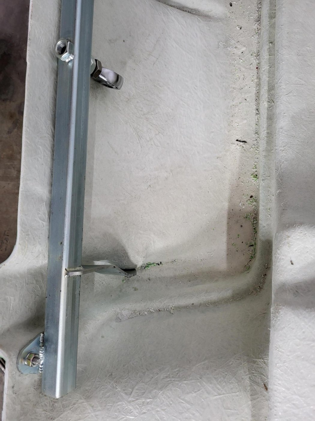

@Alexr59 I didn’t read everything just the last few post so I may be stepping out of line here, but I noticed that you’ve got the tub mounted and the cut outs for your race belts but wanted to say remember to put your race belts in before you get everything mounted because the car I bought did not have them mounted. They didn’t even have the holes cut out!! It was a royal PITA to cut out the holes for the belts and figure out how to snake the belts around the bar leaving the tub intact.
For sure! I will remove the body after again. I was trying to fit the body to see the clearance for piping and harness... still have some electrical work to do and run my AC line after that. But thanks for the heads-up

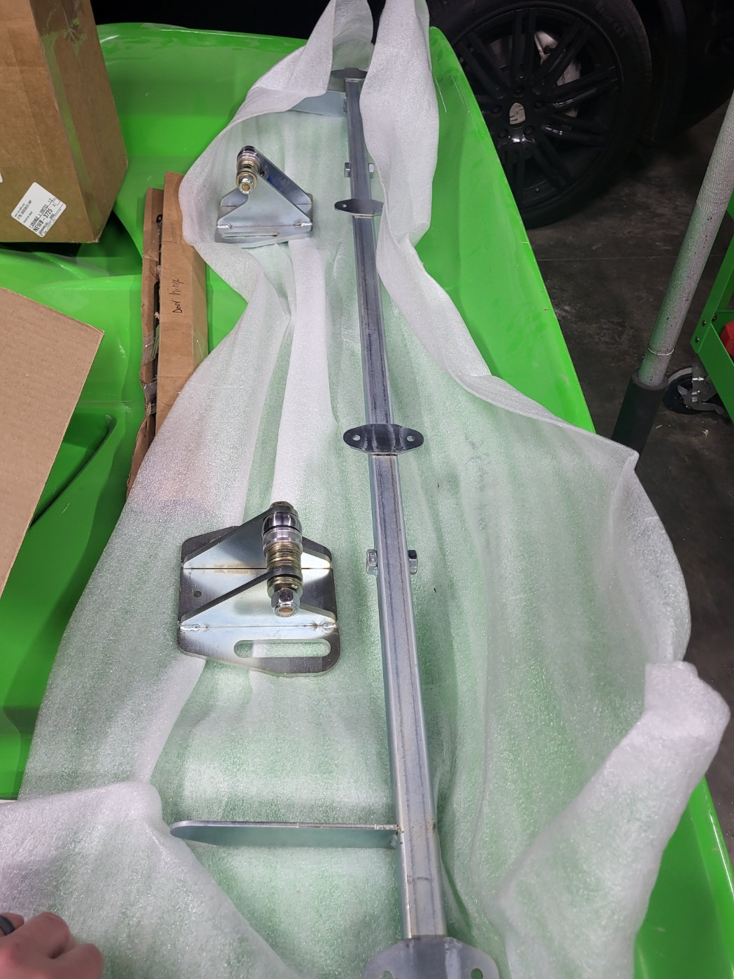

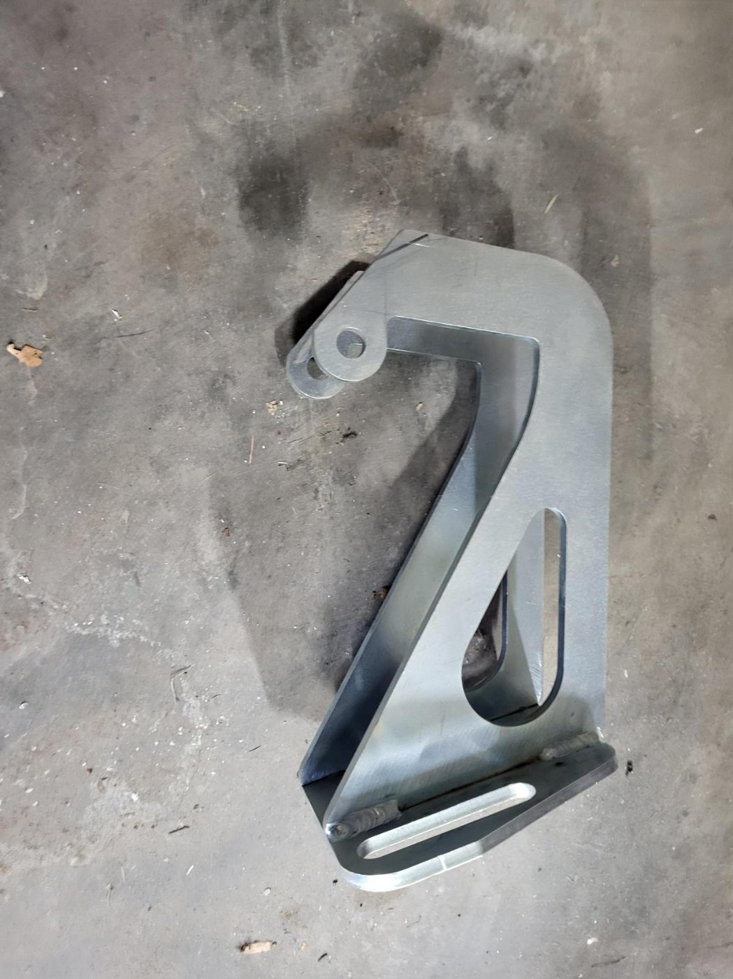

For the rear clips, I have these parts. the brackets look different that what I have seen, I am assuming it is an update? or I am missing something?
Other question: where can I find the template to cut the front door hinges?
Ken Roberts
Those rear hinge brackets haven't been used in years. The rear hood couldn't be opened very far. Surprised they even had them in stock.

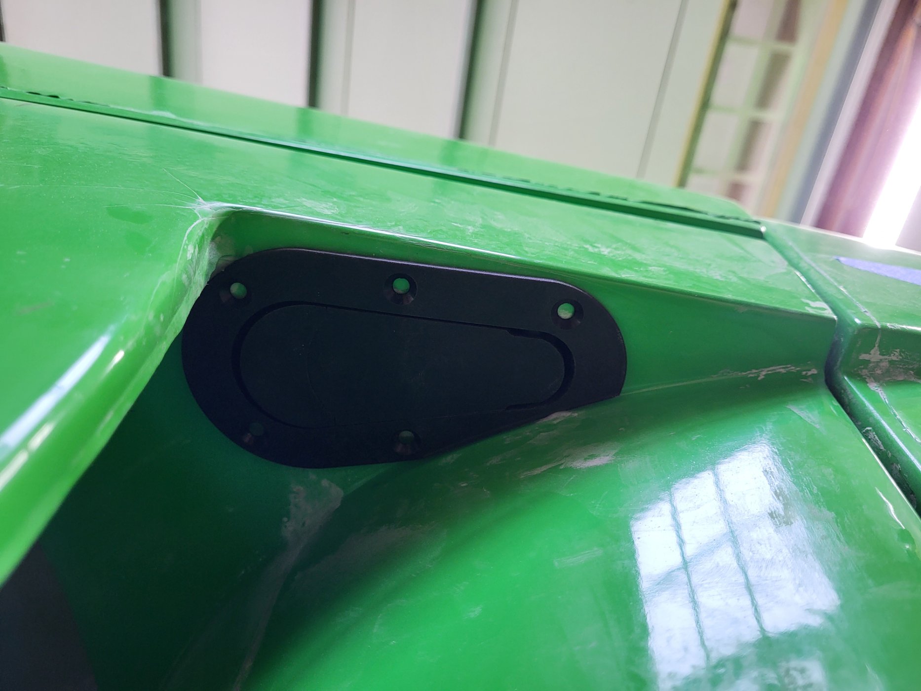

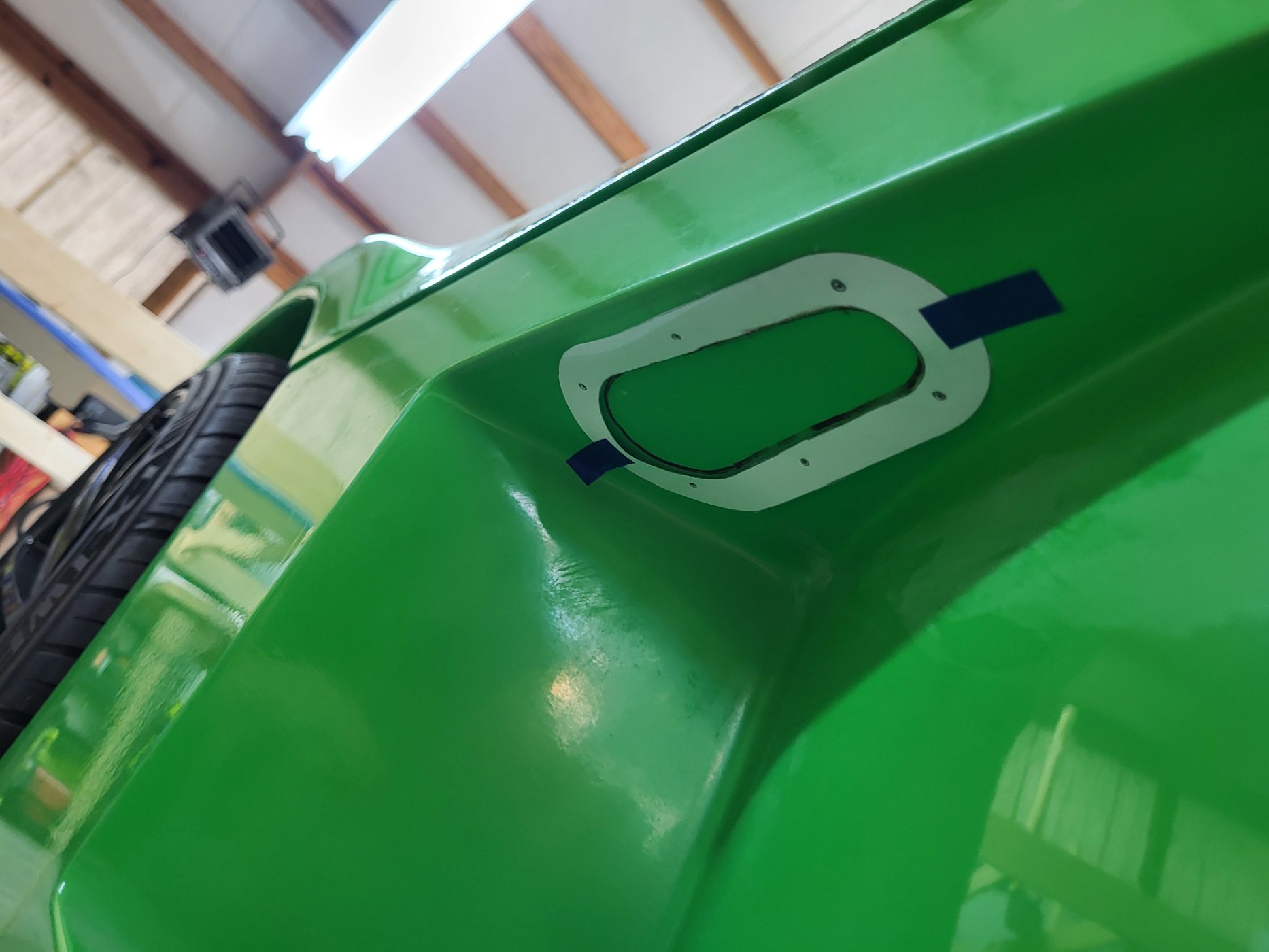

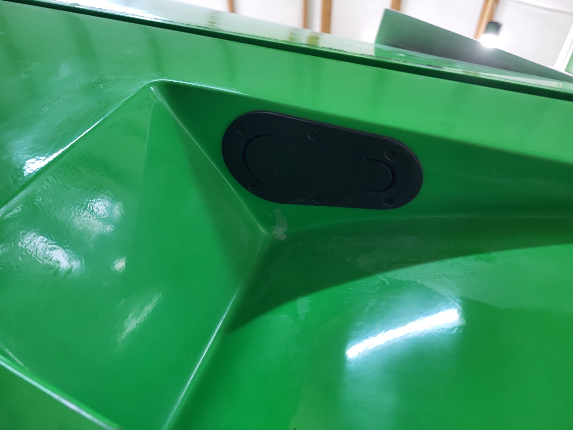

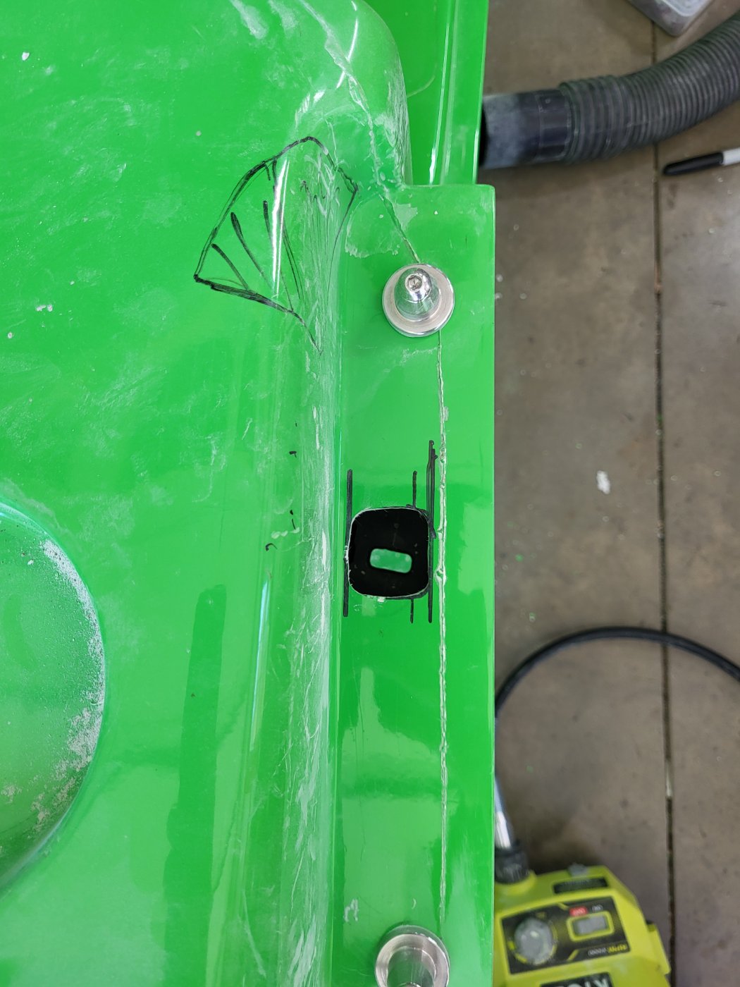

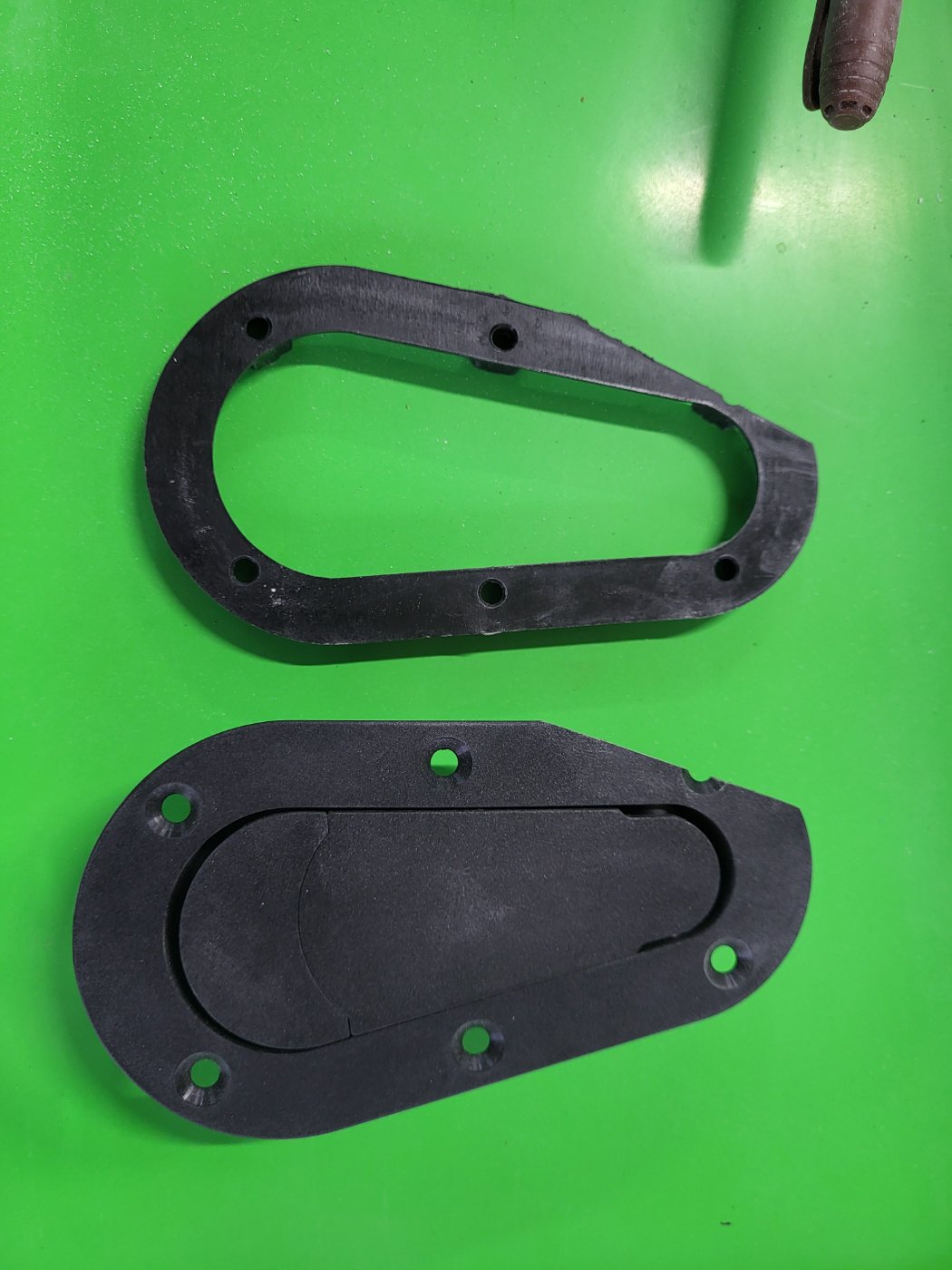

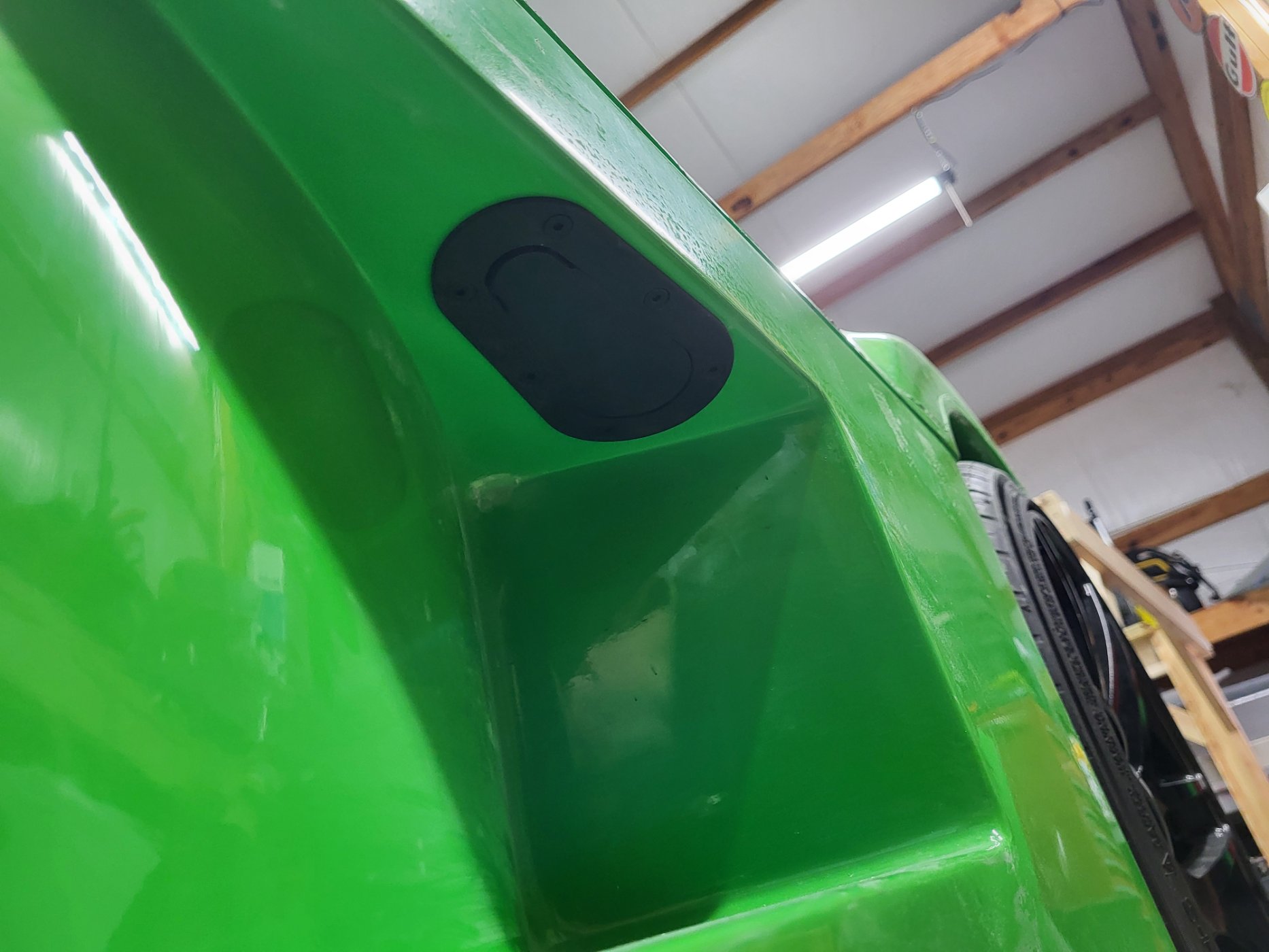

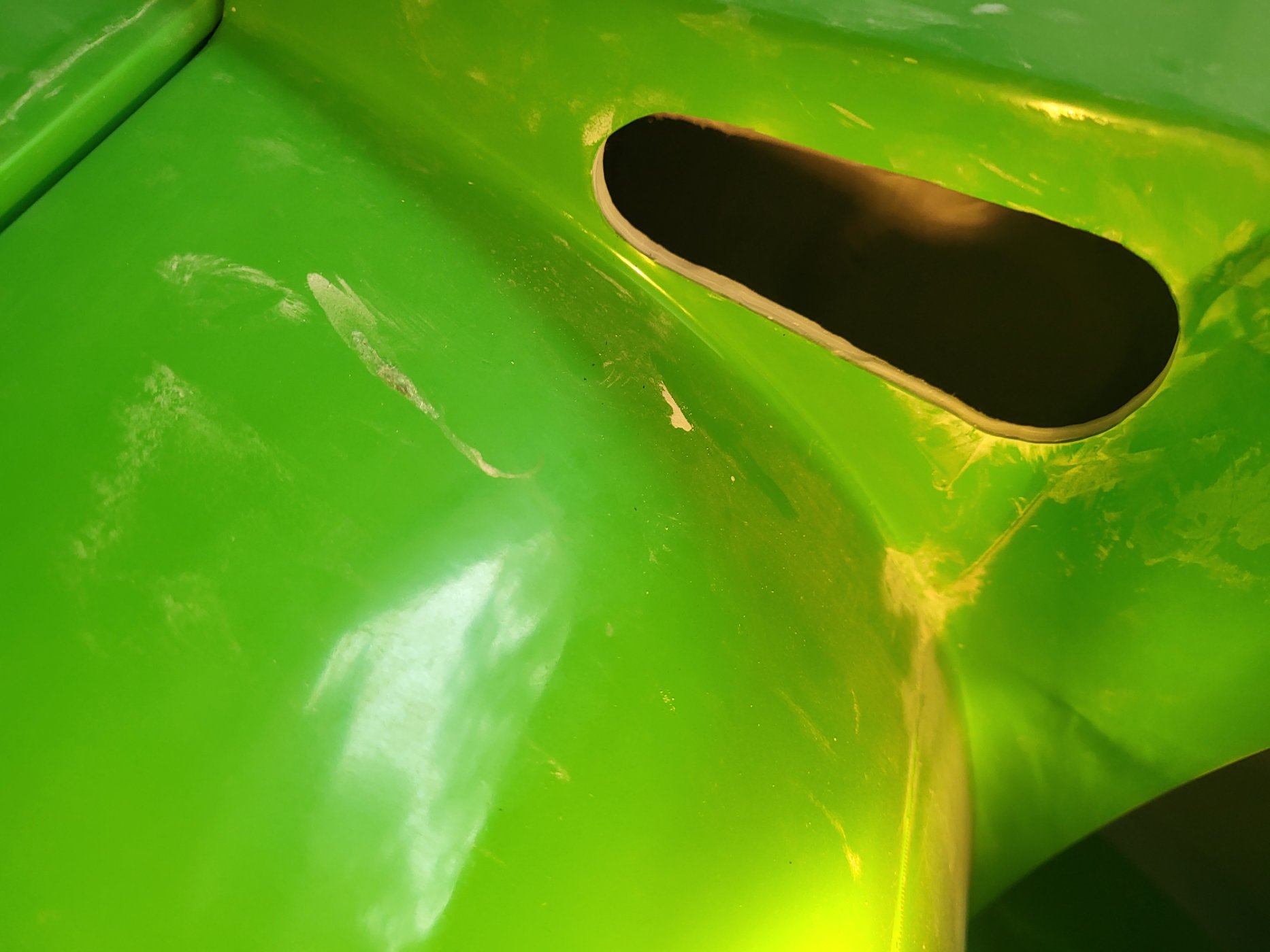

This week end I worked on the front and rear clips locks.

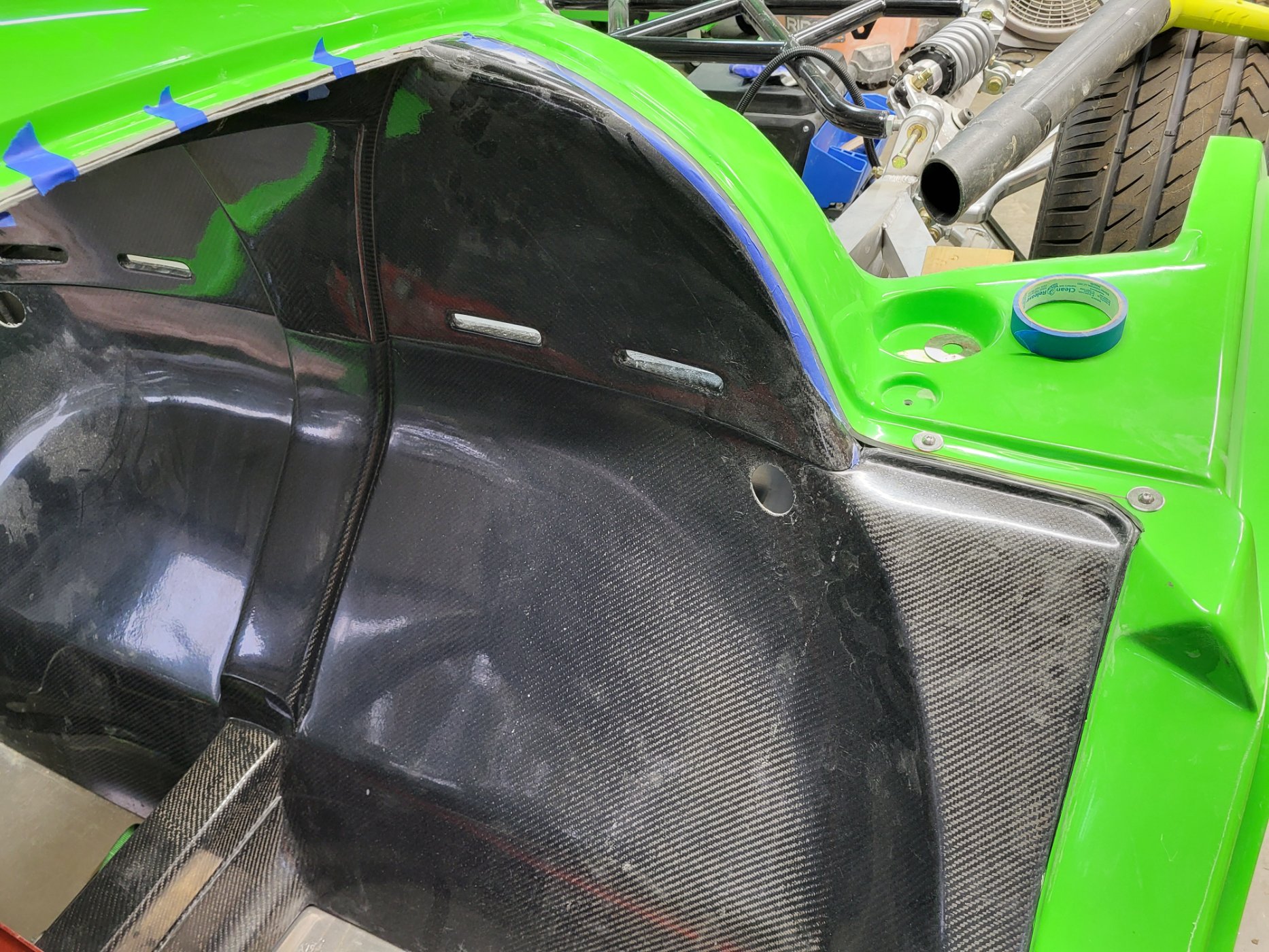

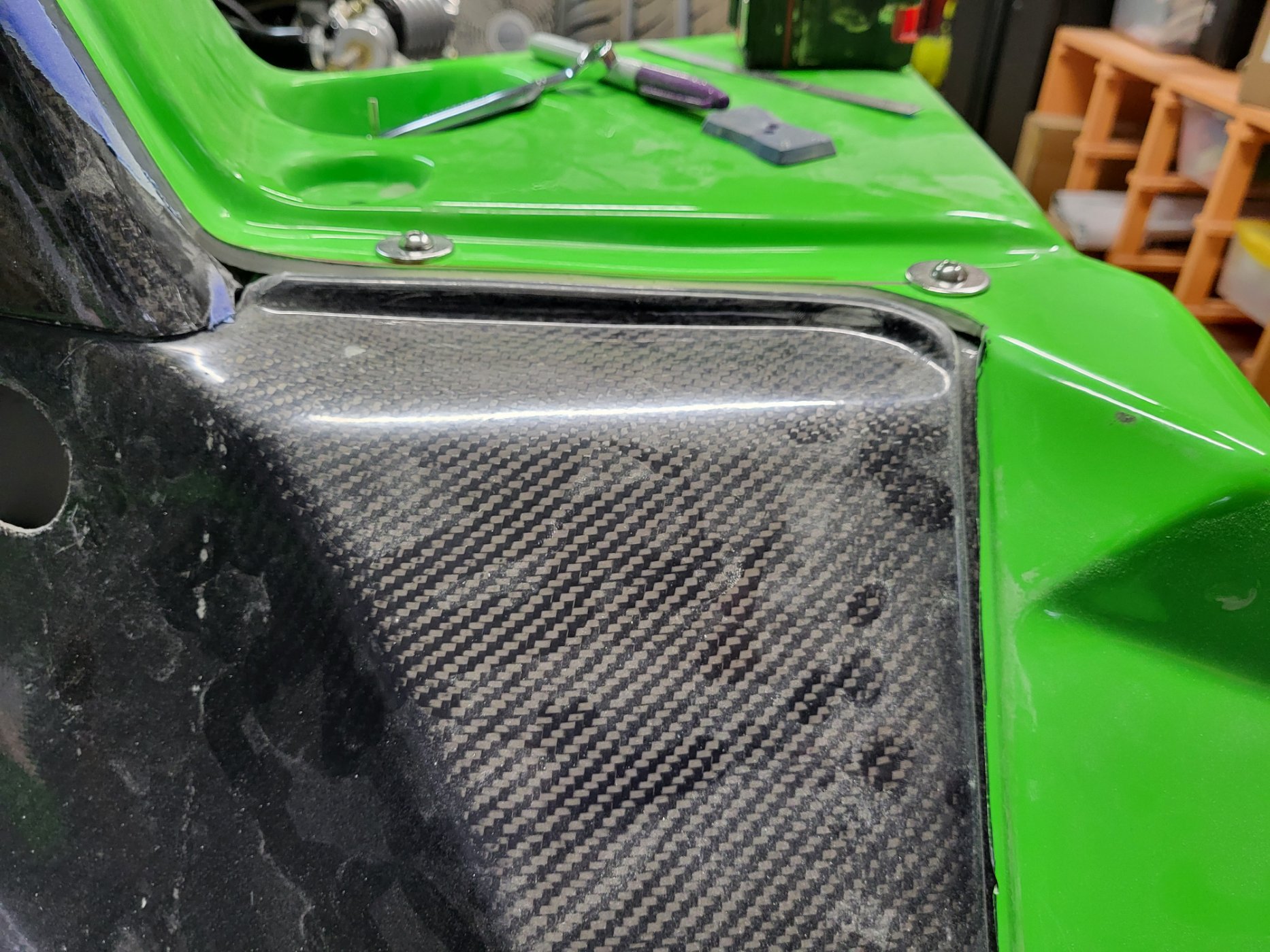

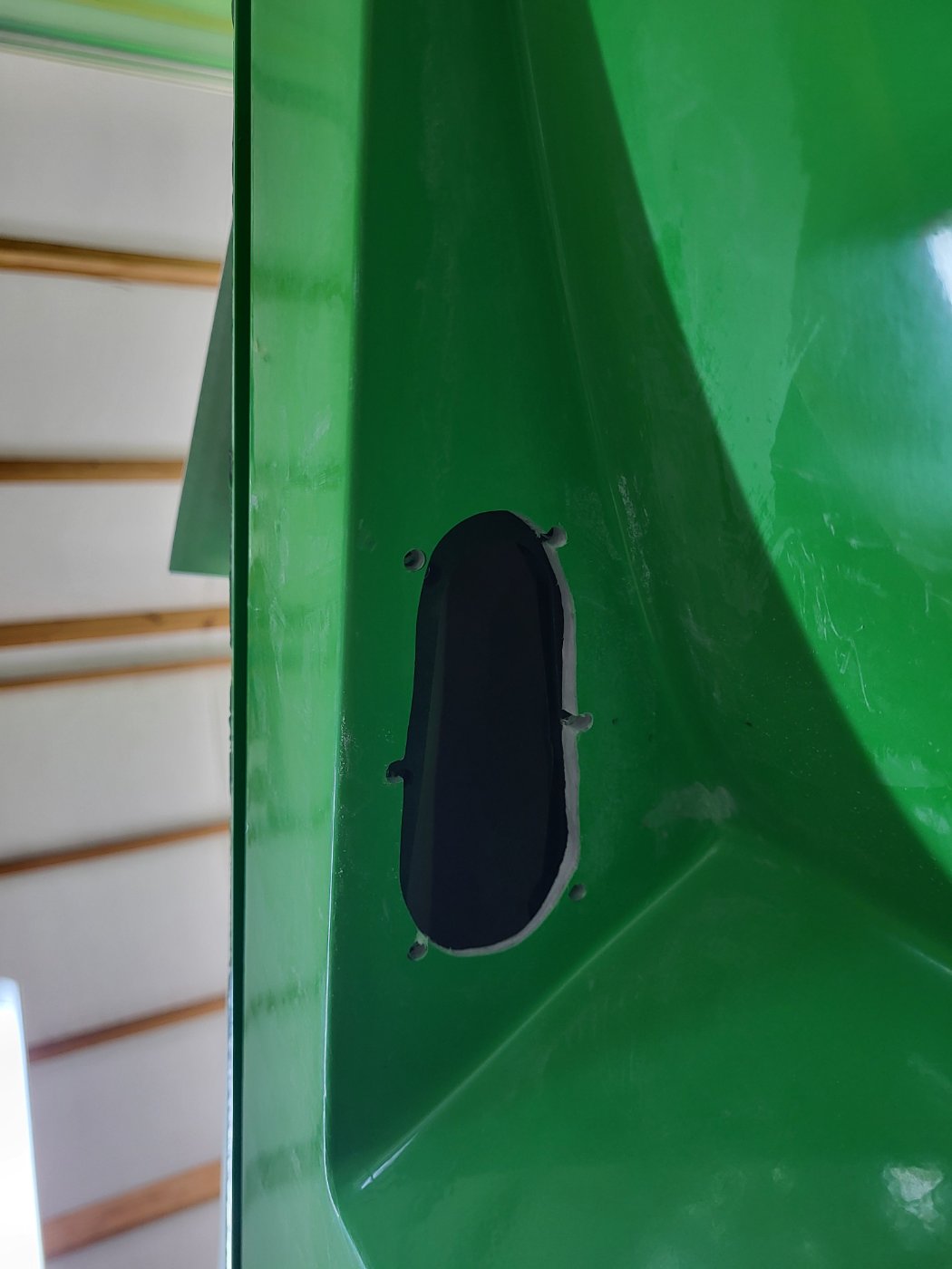

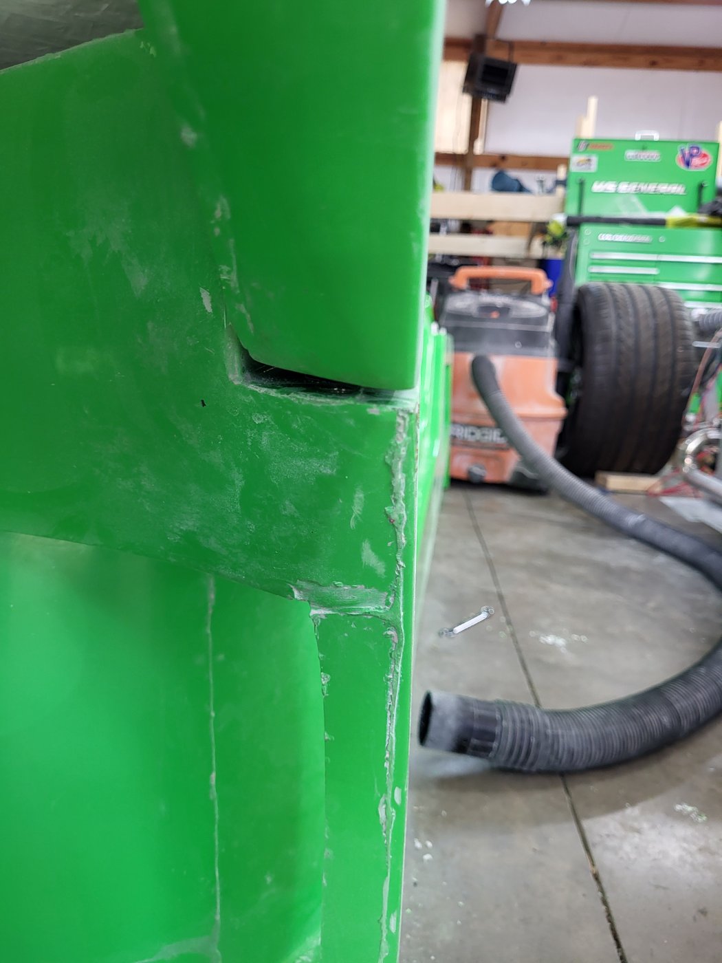

Placed the first one, made a template to install the other side and after drawing it on the other side, something was not right. The 2 vents are not identical and the driver side is bigger that the passenger. Same issue with the front lock. but overall results is nice anyway:
Rear:
Front:

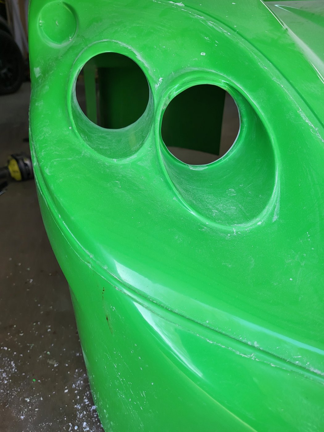

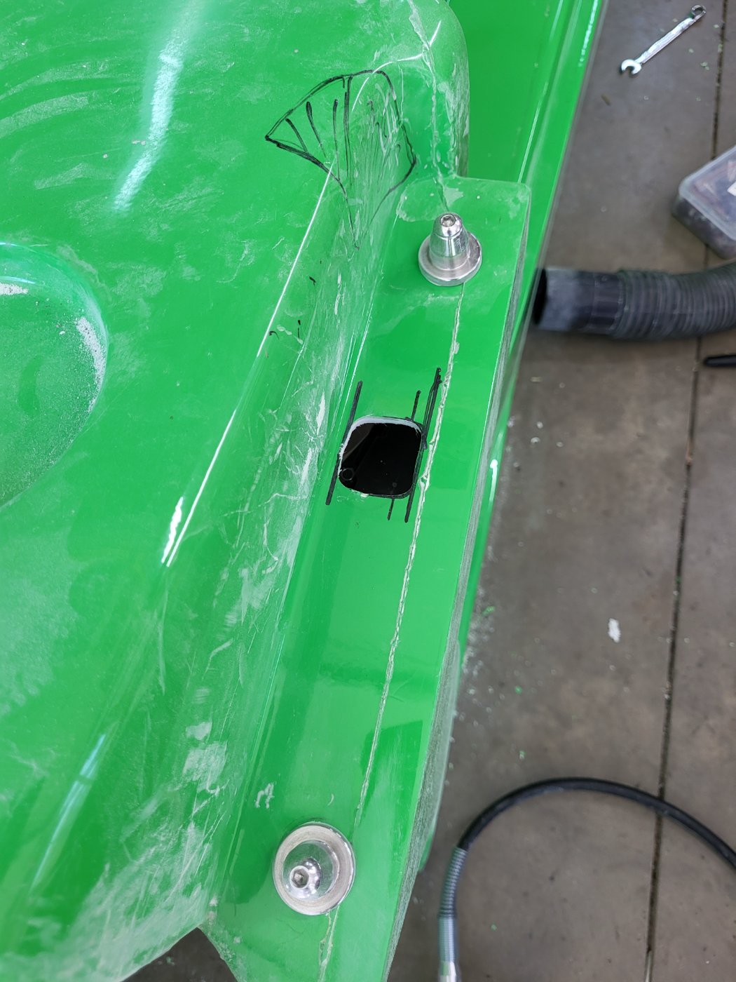

Started the cut out on the headlight. very hard to get a clean circle! (left is done, right is pre drilled and not finished)

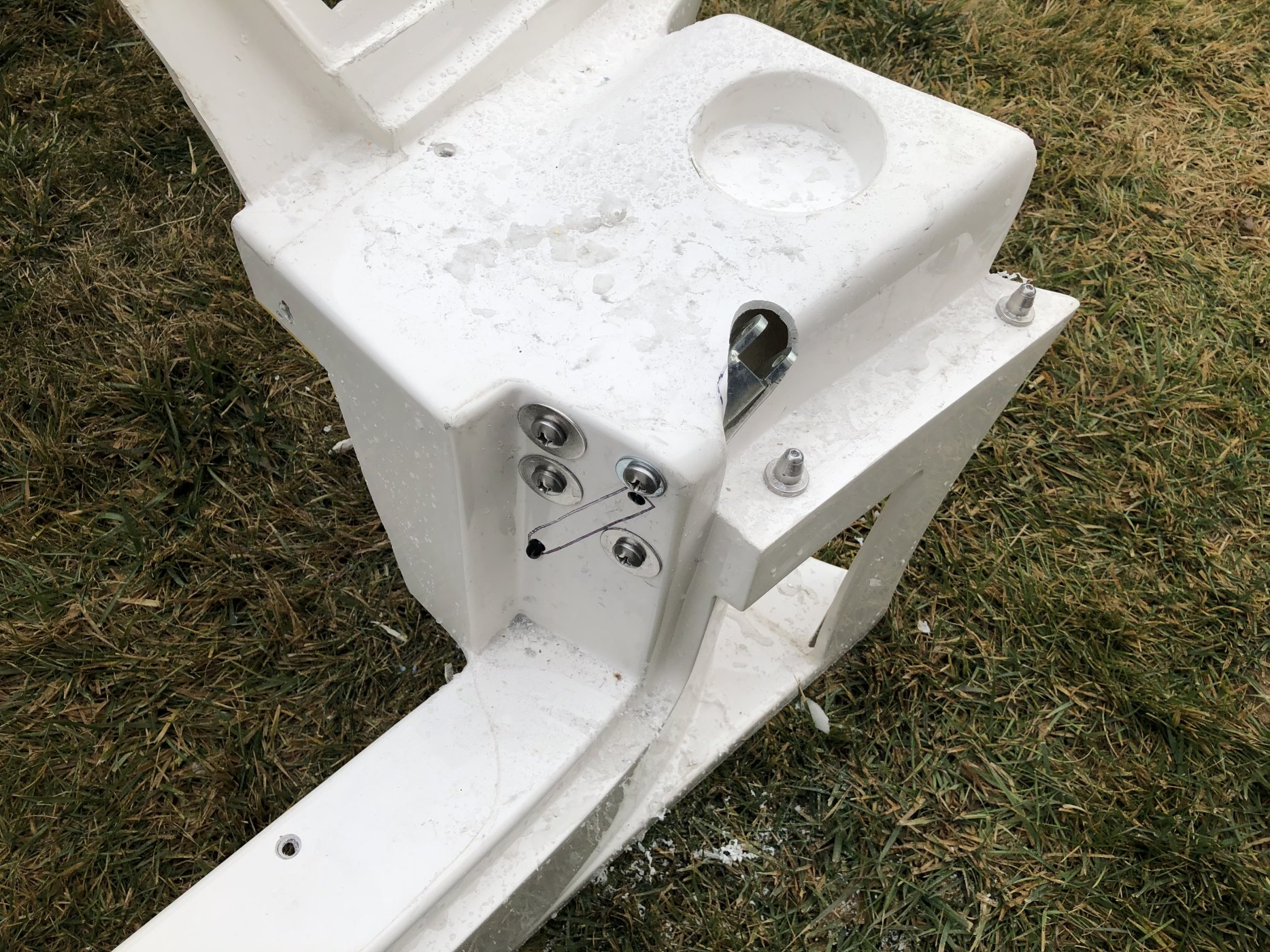

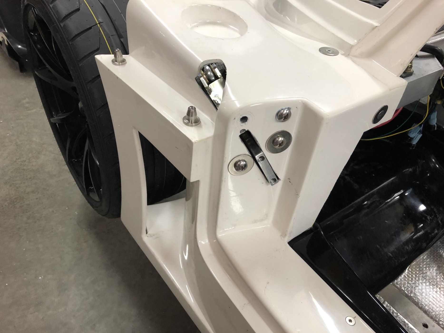

How do you drill and cut the door hinges? just based and the sharpie's marks ? same for the "holes" under the hood?

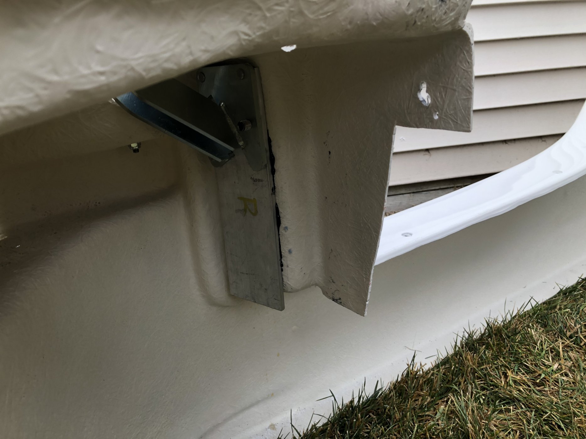

Alex,
I used the sharpie marks placed by RCR on my spider. Here are some pics of how mine turn out.
You are welcome to pull measurements or create a template off of my car if that will help.

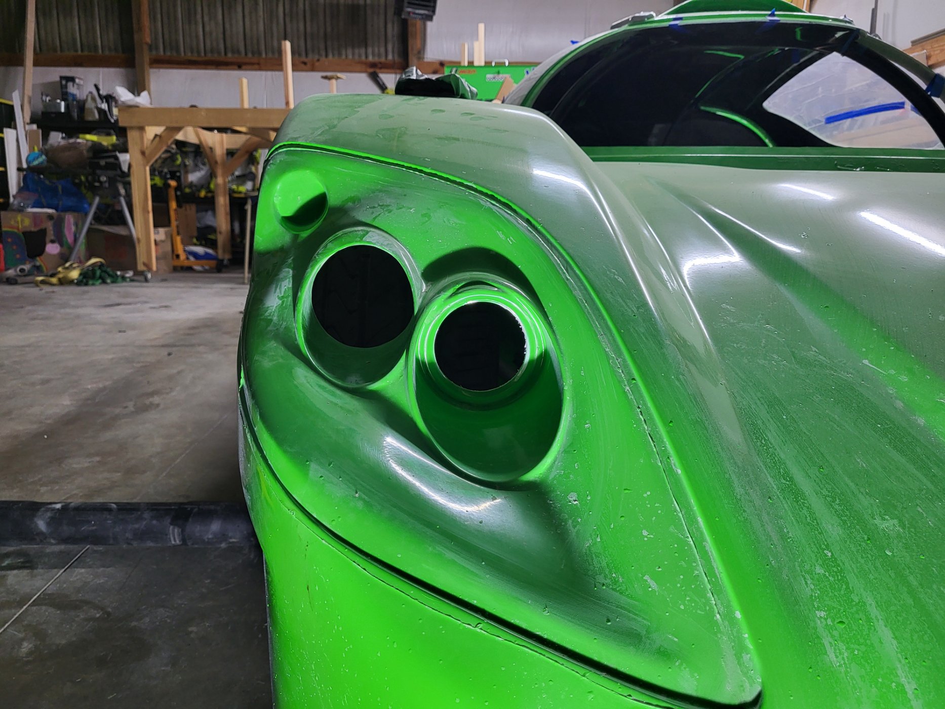

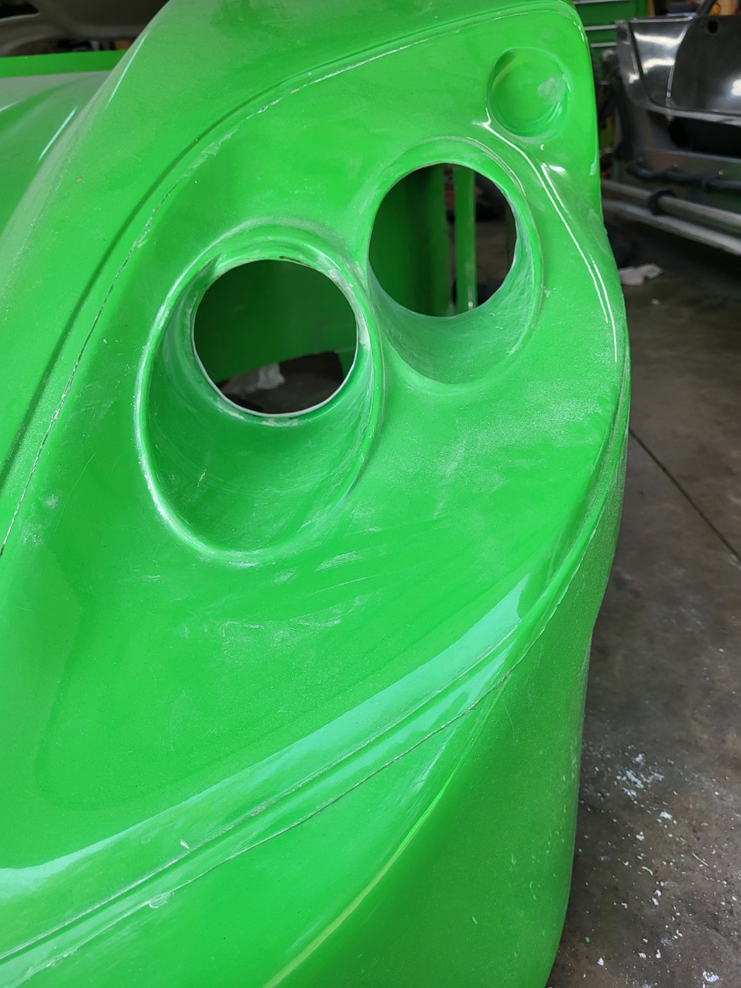

headlight cut out are finished and headlight are modified. I now need to modify the fiberglass brackets and attach them to the body.

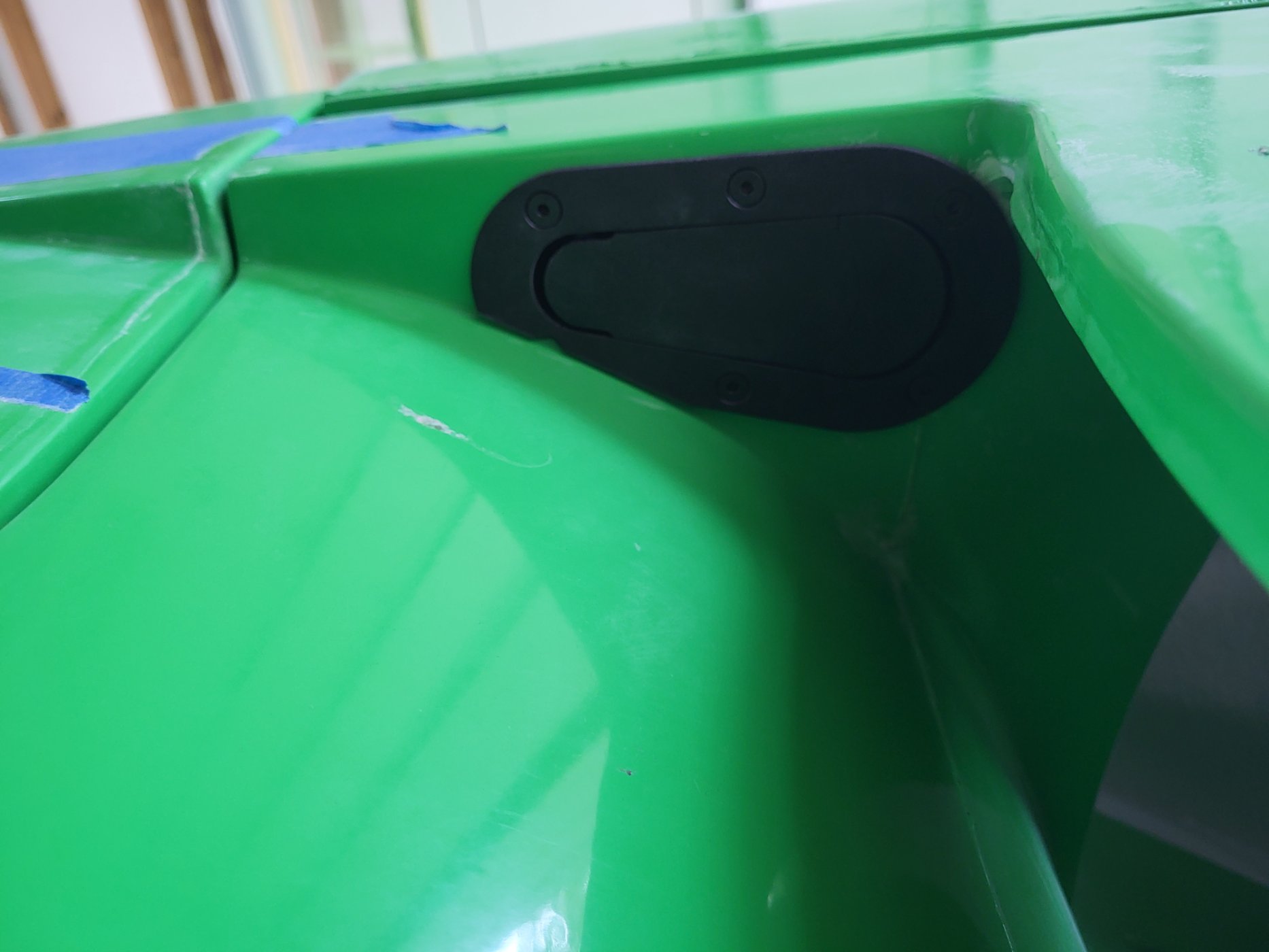

I was wondering if anybody found something to "seal" the hella headlight in the hole to avoid debris to enter the headlight from around the hella light?

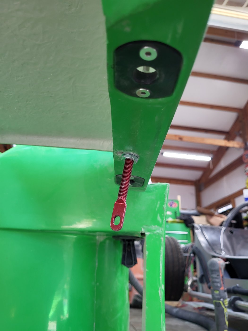

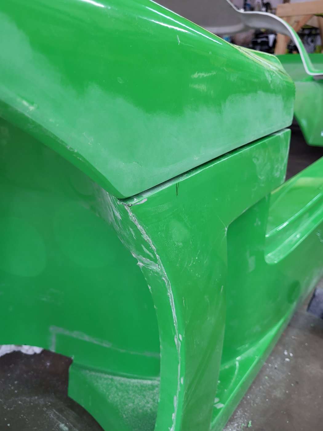

I also installed the locking pins for front are rear clips, but the holes might need to be drilled bigger/longer after I have the hoods hinges figured out and installed as I am missing the right motion to close them.
but the fitting is looking not too bad. Again from right to left the fitting is totally different due to the body shape (on side very flat, one side the areas are "curved"

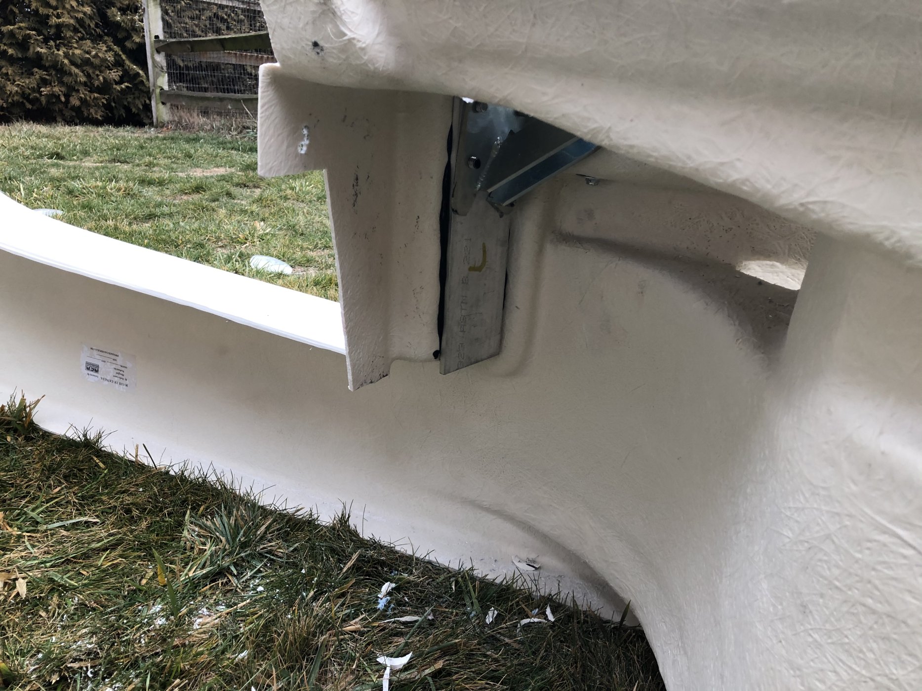

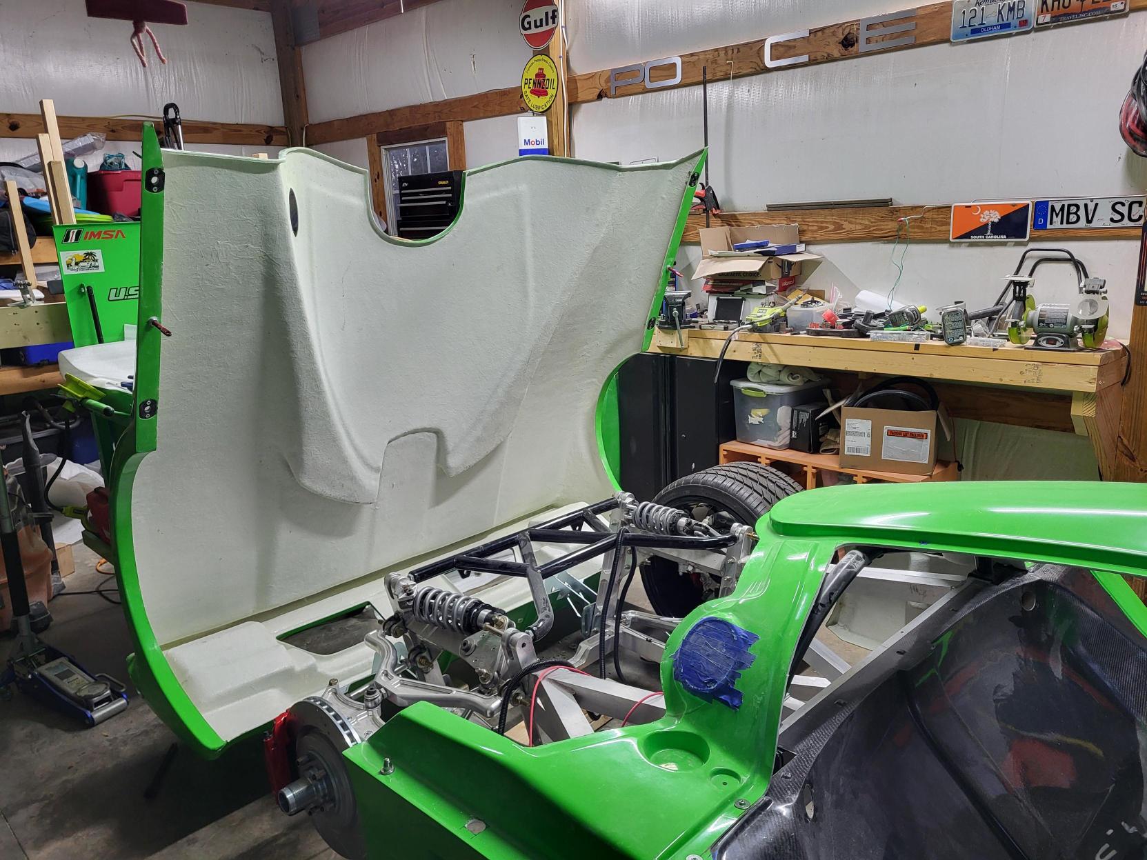

I received the correct rear hinges and decided to tackle that last week end. I am still missing parts (checking with RCR) to be able to install them properly (u shhapes bracket and rods), but at least i could make progress.

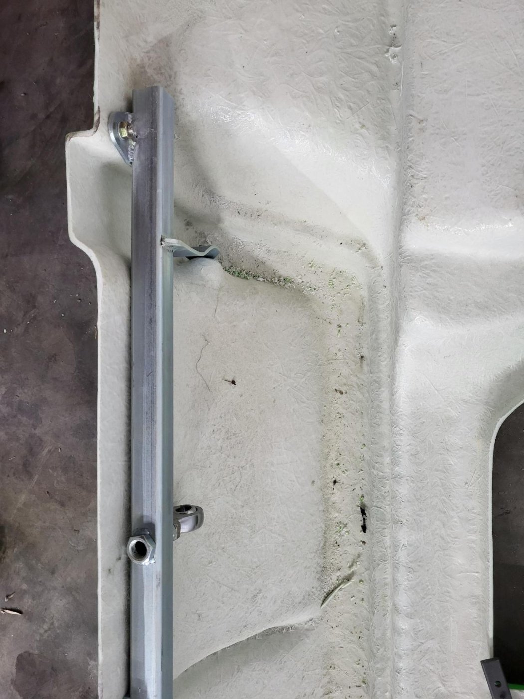

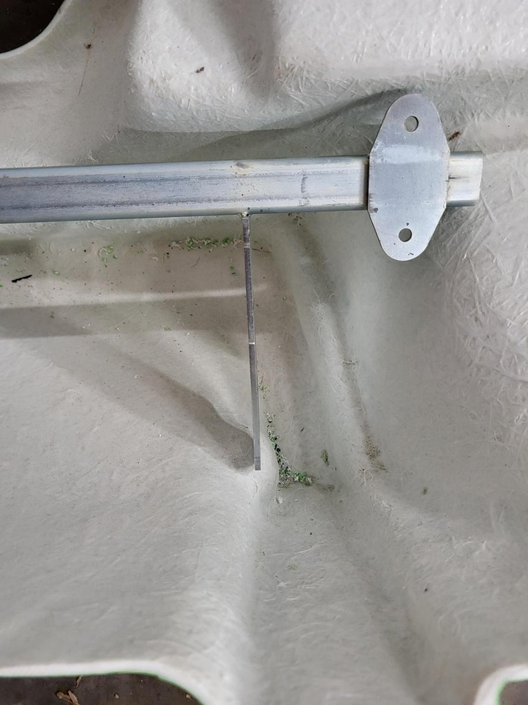

first issue, the mounting bracket going on the hood is off, the spacing between the small plates is 1 inch to narrow compared to the rear clip
instead of cutting and welding, I decided to bend the small plates

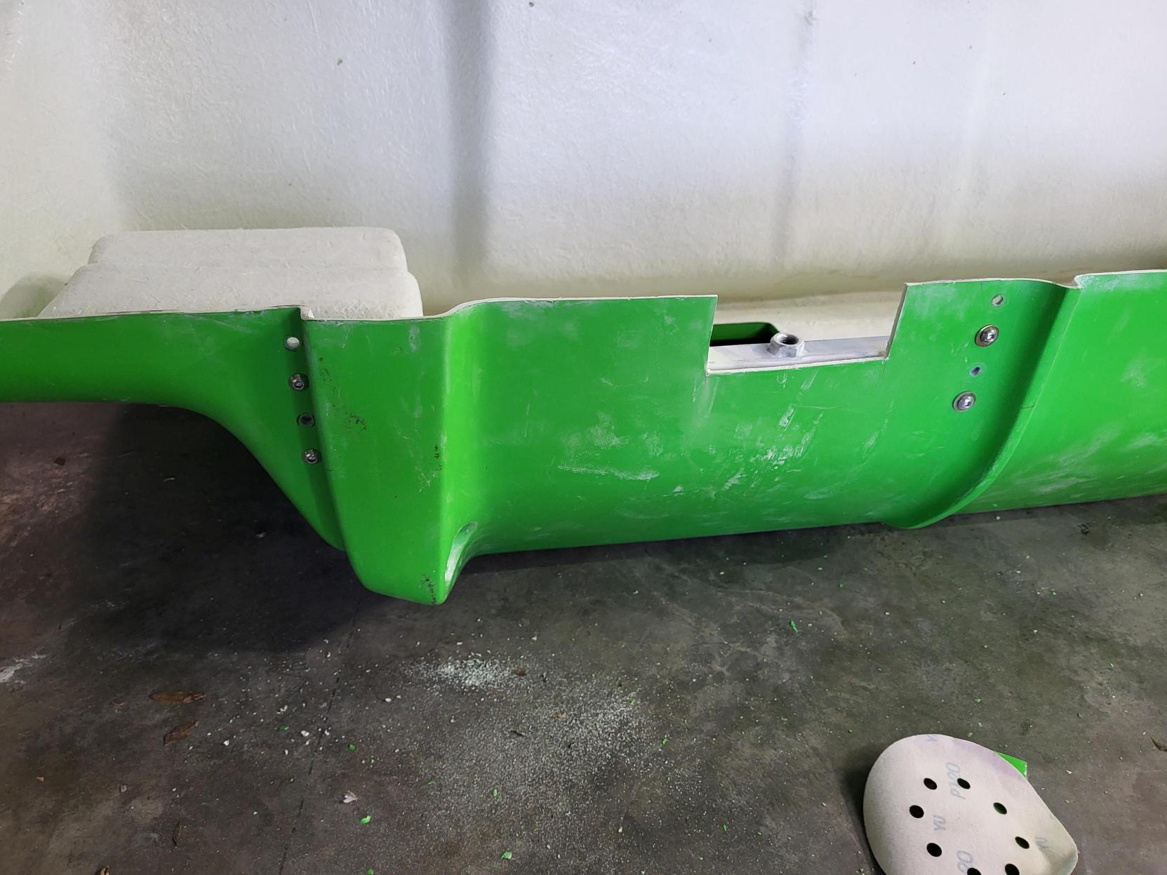

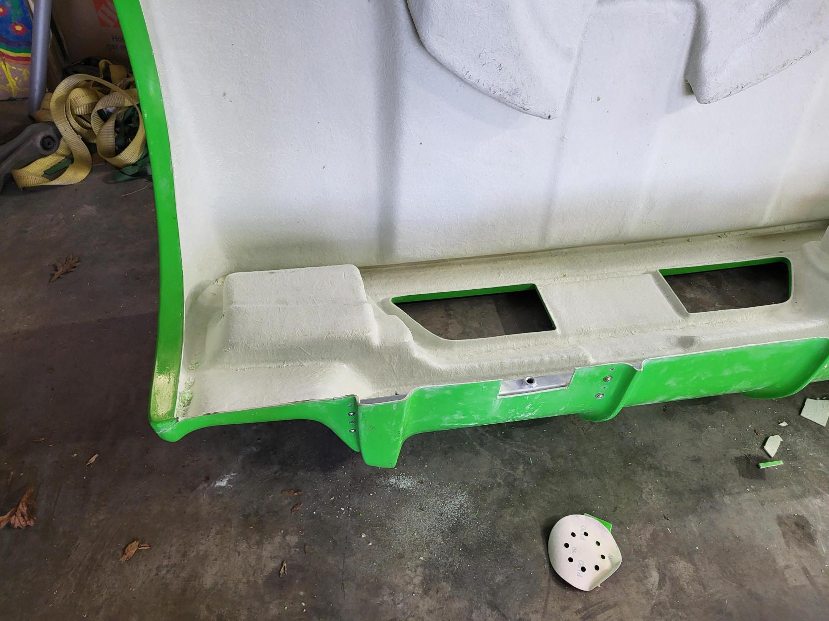

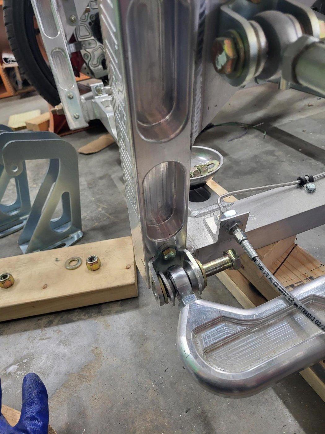

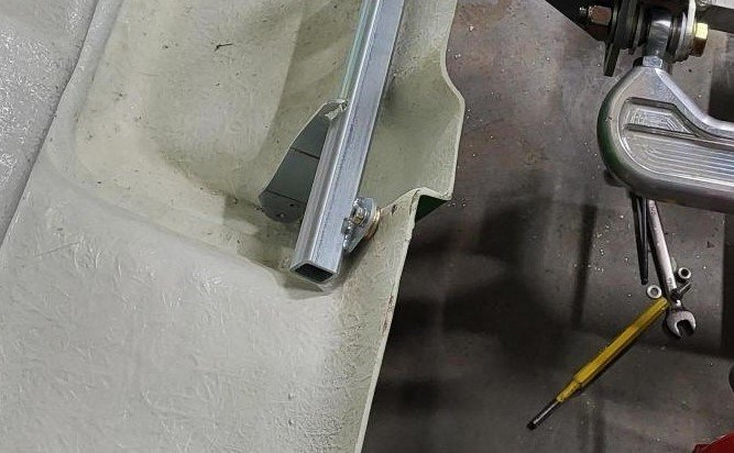

then i mounted the bracket at the as forward as possible on the rear clip, to realize that in this position it is really far from the body bracket and impossible to mount so i had to mount it as much back as possible and cut into the fiberglass of the diffuser (you can see the holes from the first trial....)
now the rod is really pushing against the fiberglass, and the hinges are not able to be aligned at all.

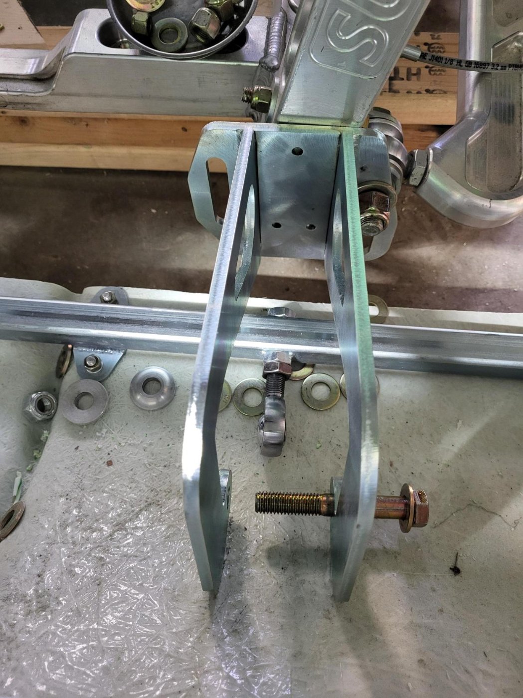

to be able to fit everything, the hinges need to be modified
but even this modification was not enough. I installed washers (I will replaced with spacer later) to push the bracket away from the body
it's in place, will need more adjustment but i am waiting for the missing bracket for proper installation before fine tuning the position

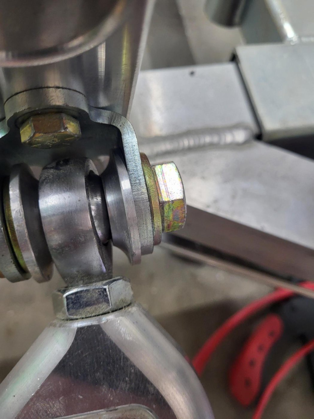

i also discovered that one side of the rear suspension had the wrong spacers, to big, they are floating on the bolts and mounted with to many washers so the bracket were spreading
any idea if these aluminum washer are available somewhere?

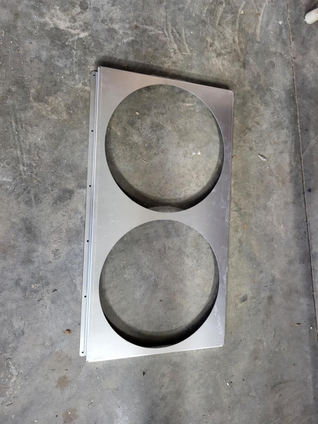

I also received the custom shroud, next week end plan!
