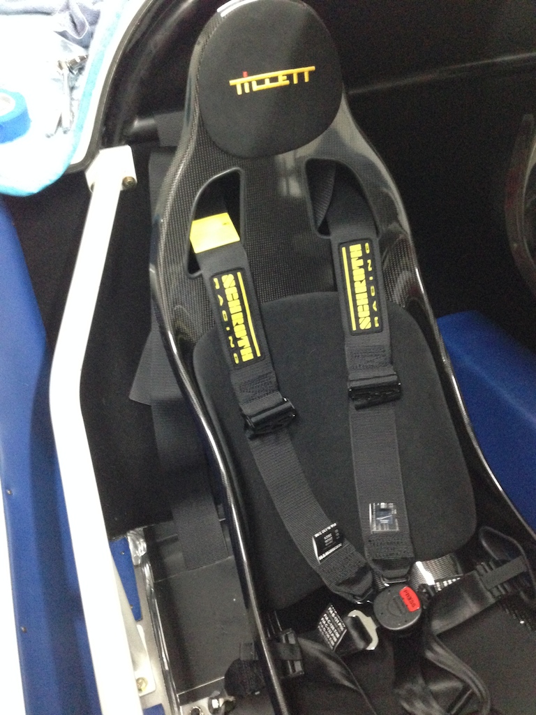

5) Seats: bit the bullet and got Tillett B4's. Love 'em. IMO, they are the best option if you want to make sure a 6' 2" passenger has their head fully inside the roll bar.

10) Seat belts: waiting, but think I found a good cheap supplier at SEMA. I'm doing a 5-pt harness and am still working through the legal issues of getting CHP approval or if it doesn't matter.

CHP doesn't care about the seatbelts during the registration process. Its not what they're looking at. They just care that all your components aren't stolen. However, I'm not aware of any 5-point harness that is road legal. Its all about the latching mechanism.

Interesting, so then who cares about he seat belts? Is it an issue if you get pull over? Is there some other inspection?
My understanding is that the Schroth Profi II ASM FE harness is road legal because it's got the push button release.
I'm still trying to get more details about the road legality aspects and who ultimately regulates the seat belts. In talking to a seat belt manufacturer at SEMA, they said it's actually not the DOT, but another agency whose name I now forget. If anyone has links to where the seat belt laws pertaining to the type of device (vs. need to wear one) are documented, I'd love to see it.

Hi Ruth,
If you get pulled over, urban legend has it that it could be a violation, but I doubt any officer will pay attention and I've read the California motor vehicle code and couldn't find any mention of any requirement other than needing a lap belt and in certain cases a shoulder belt.
You are correct though, the Profi II ASM is road legal based on the spec referenced in the urban legend. Forgot about that one.
FWIW, you WILL get pulled over. We've been pulled over 4 times since July. We didn't have the plates on the car yet but were clearly displaying the temp permit. Officers just like to look at it.
Get the belts you like and don't worry about it. We're more concerned about what to do about a front license plate.
I've taken two cars to the CHP (part of the SB100 process), they've never ever even looked inside the cars. They just want to make sure that none of the major components are stolen.
Been pulled over in my cobra with 6-point harness, didn't hear a word about my seatbelt. I know lots of people running 5-6 point restrains on the street, I'm sure some of them have been pulled over :), but I've never heard of anyone having been hassled about anything other than not wearing them.
I'm sure you'll be fine.
I had 5 point racing harnesses in my SLR and was pulled over multiple times (never for any infractions, they were just curious). Anyways, I never heard anything from the LEOs about my "racing" seat belts. I wouldn't worry about it

Funny thing you ask. The plan is to fire it up this weekend. I still need a firmware update for the ECU and a base map, but otherwise it's ready to fire up and see if it will idle. Seat harnesses went in this past weekend (mostly, waiting for correct crotch straps), so I'll have some protection if the car turns into a soapbox down my street. :shy:

Is it blue, or is that just painter's tape? (I recall it being white gelcoat)
