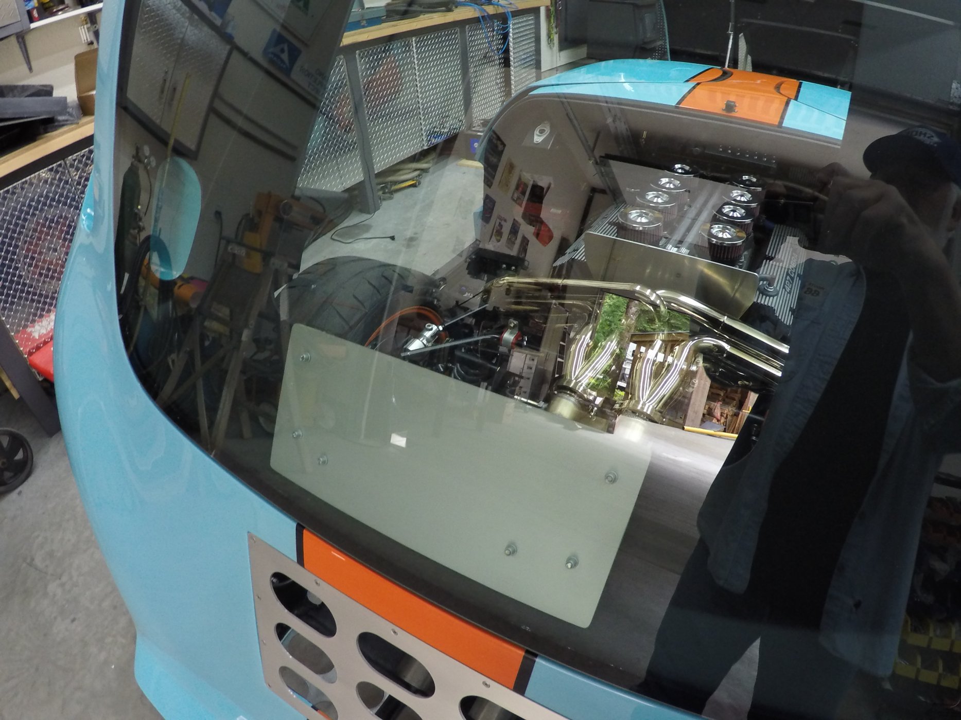

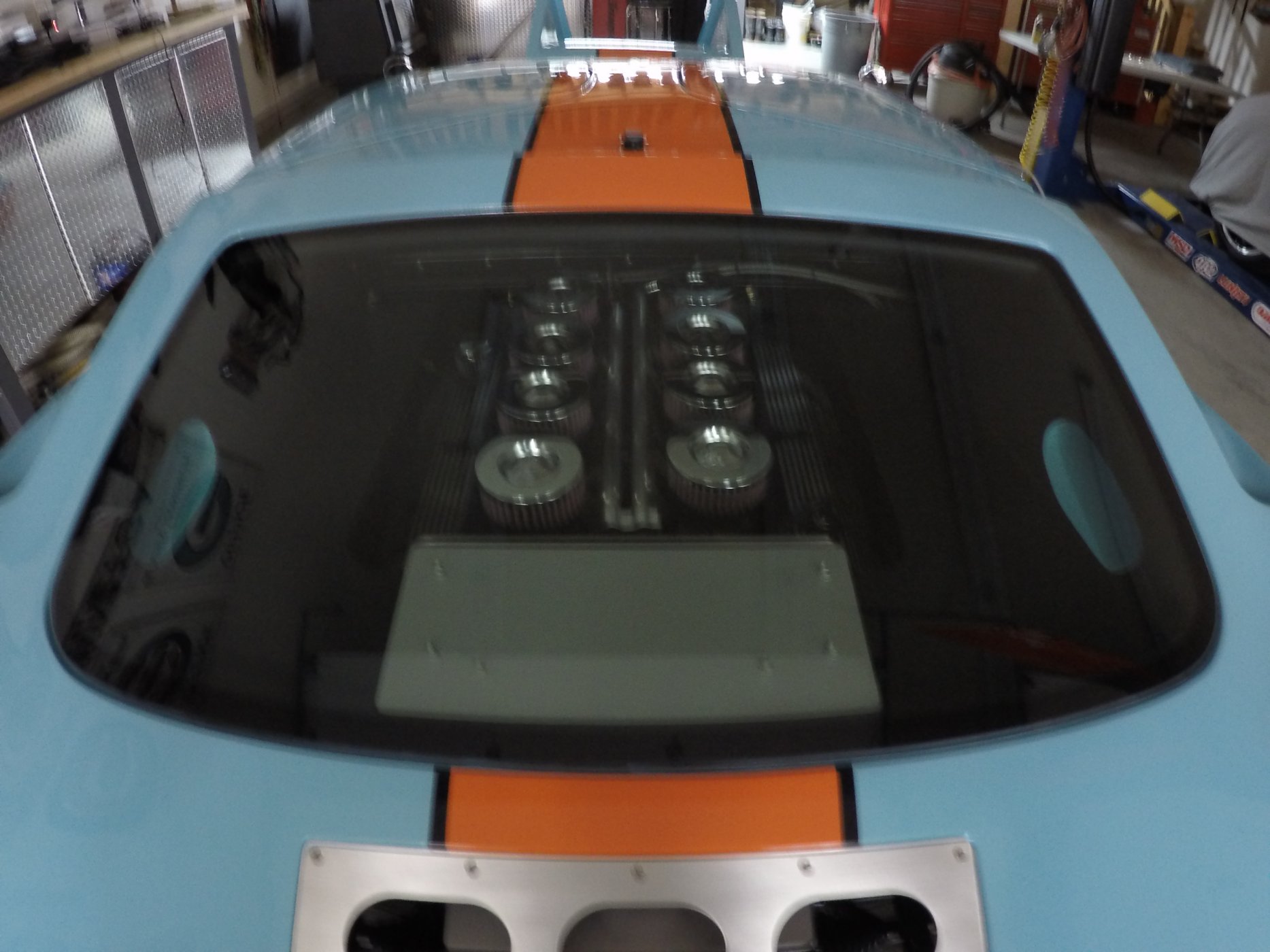

How hot can it get in your area? I ran with this in slow traffic for about two hours at 90 deg. without a problem

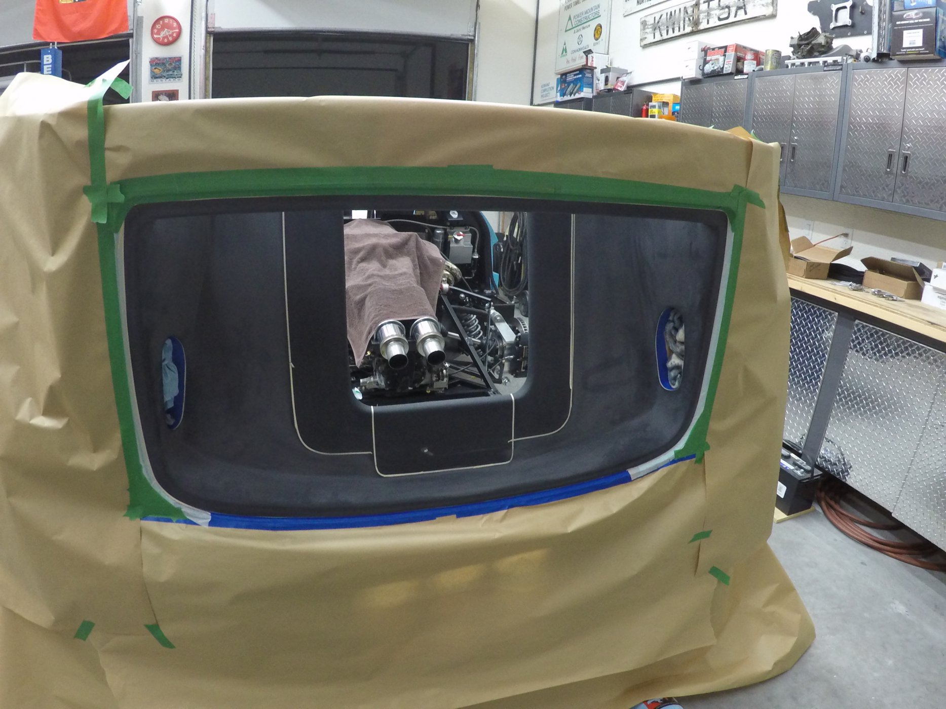

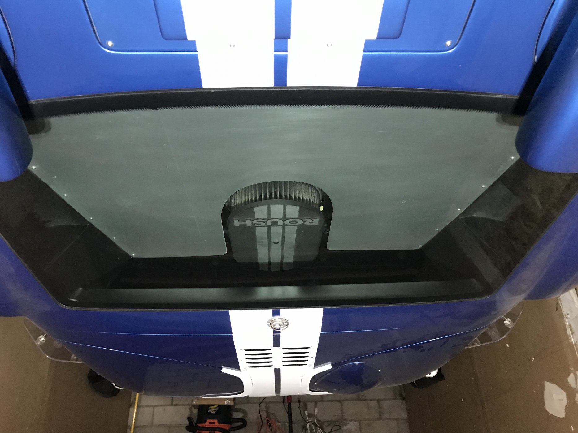

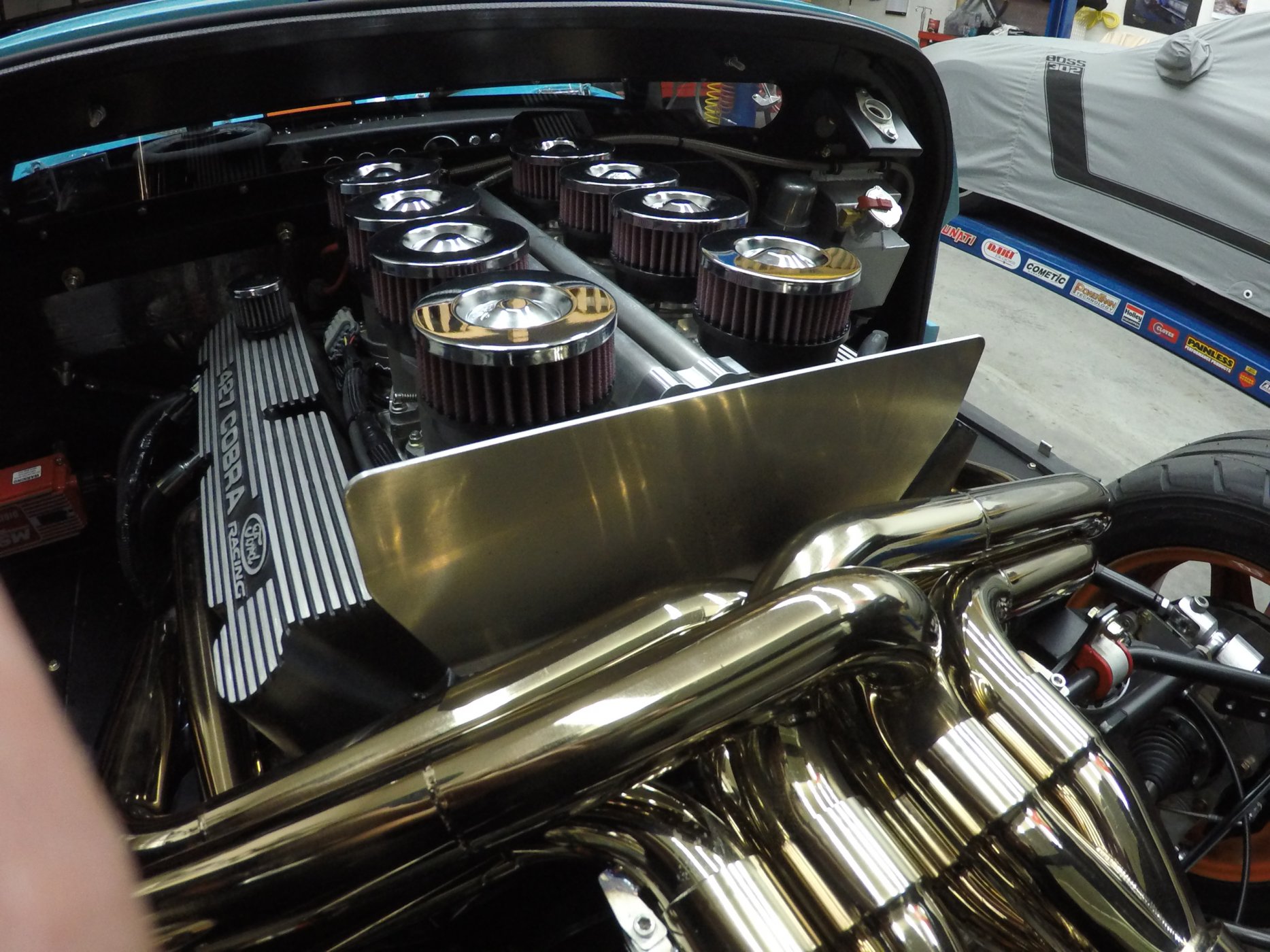

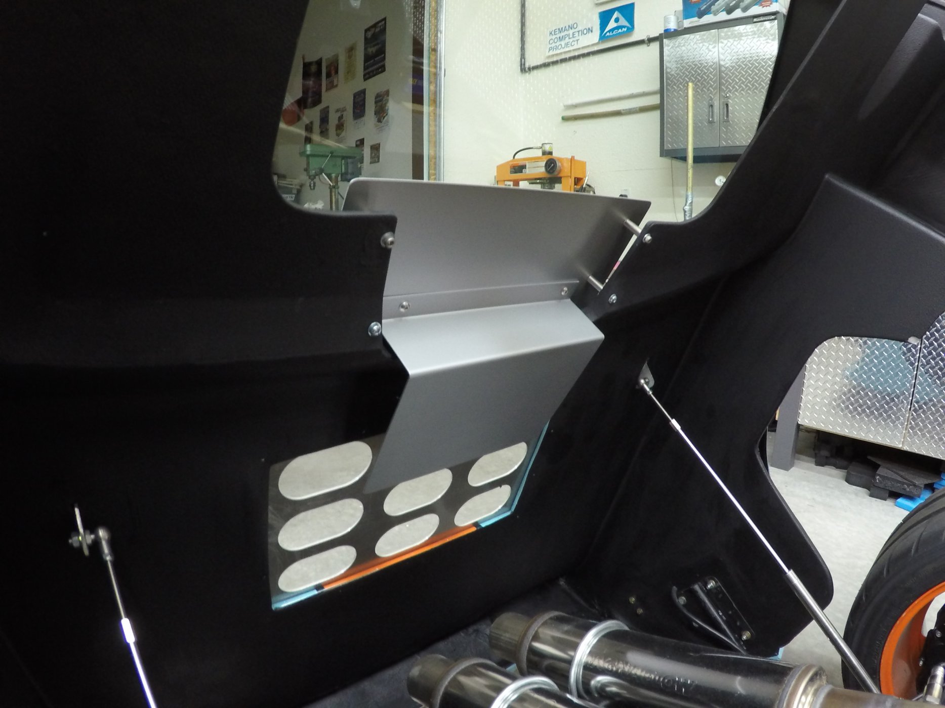

Here are the pictures I promised. The first picture is of the plate looking through the rear window, while the second is of the plate looking up at it with the clamshell open. As far as its purpose being heat protection, one issue there is that the plate basically attaches at the base of the window and does not extend to the rear to actually protect the fiberglass. Also, this is the only Superformance MKII I have seen with this plate, so why aren't there bunches of cars around with burned fiberglass? I suspect Rick Muck is correct that its purpose is to keep air coming in from the upper scoops cooler, but the plate would block this air falling over the engine, unless it is intended to keep the air going into the air cleaner cooler. I appreciate all your thoughts (you may have to rotate these pictures as they may come in upside down).

Chris Kouba
Do you have a Mk II? That's how they were built.
The Mk I's had a piece above the carbs to protect from heat, back-splatter, etc from the carbs. The Mk II's were simply built that way.
I wouldn't replace that with plexi as it's too close to heat sources and would likely sag and then potentially ignite. I think everyone's prior comments assumed you had a Mk I.
