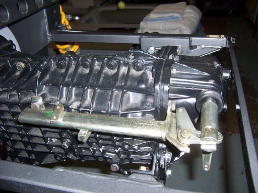

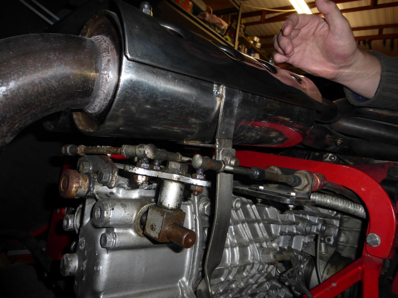

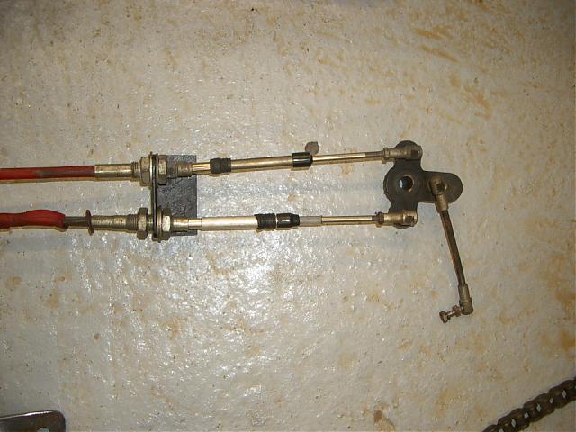

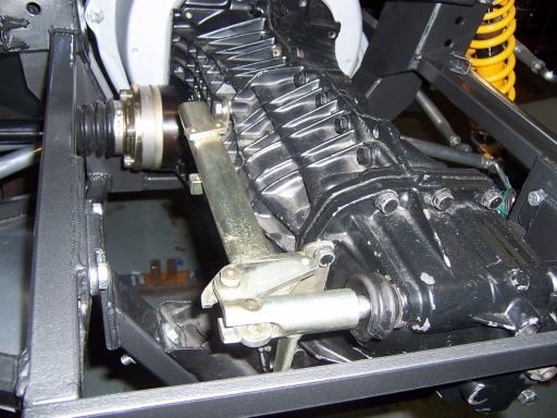

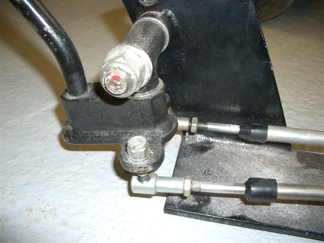

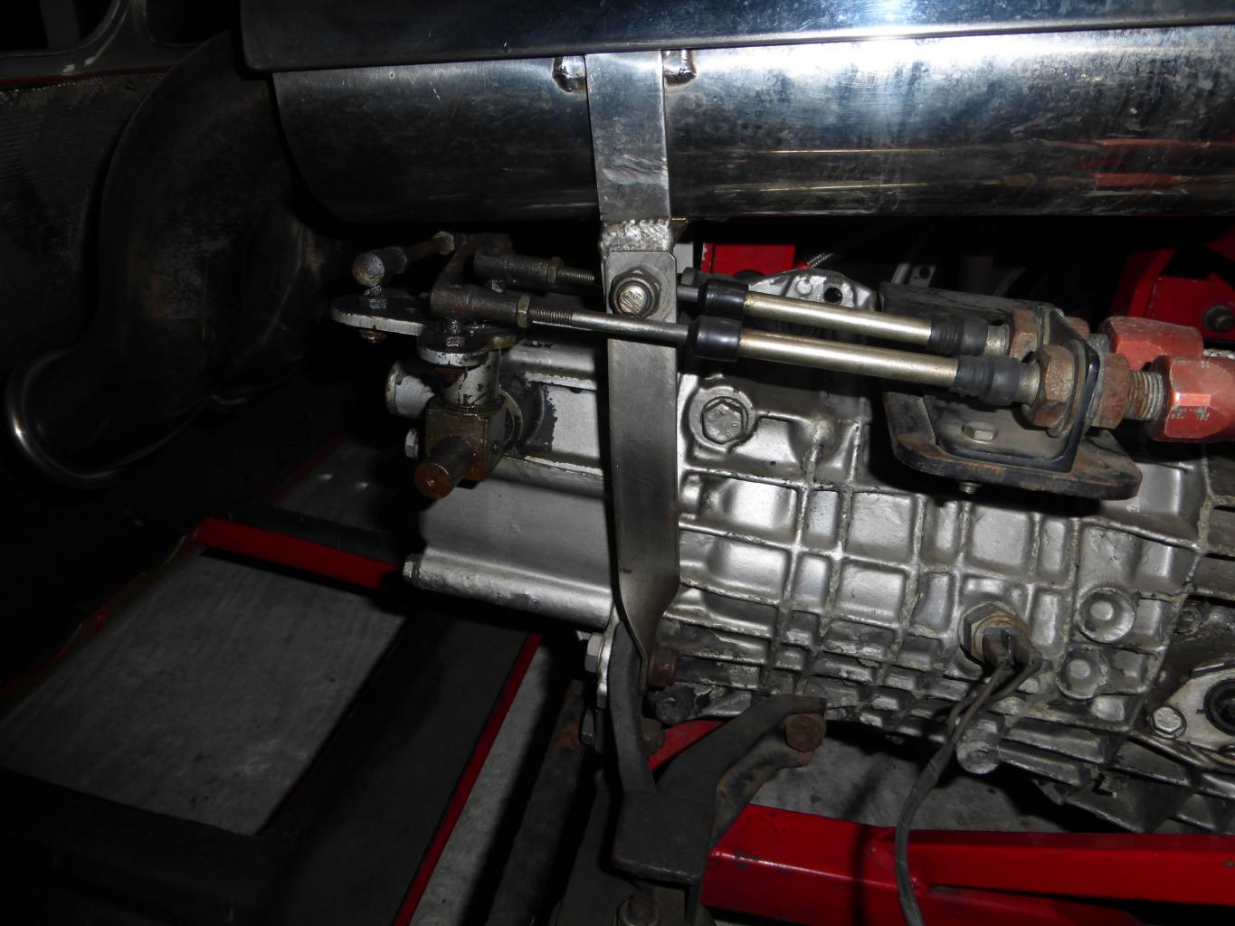

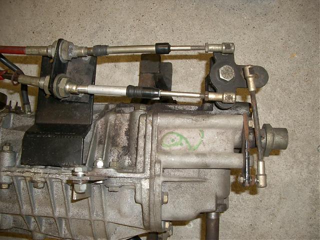

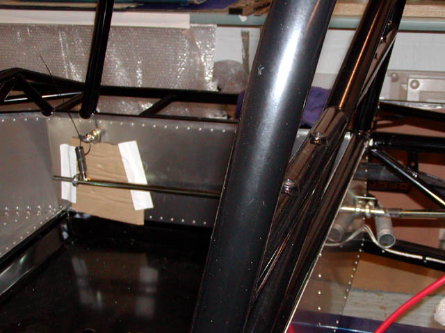

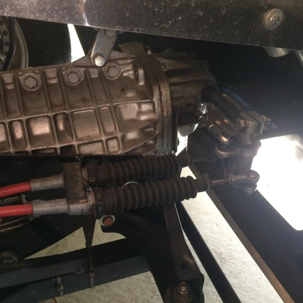

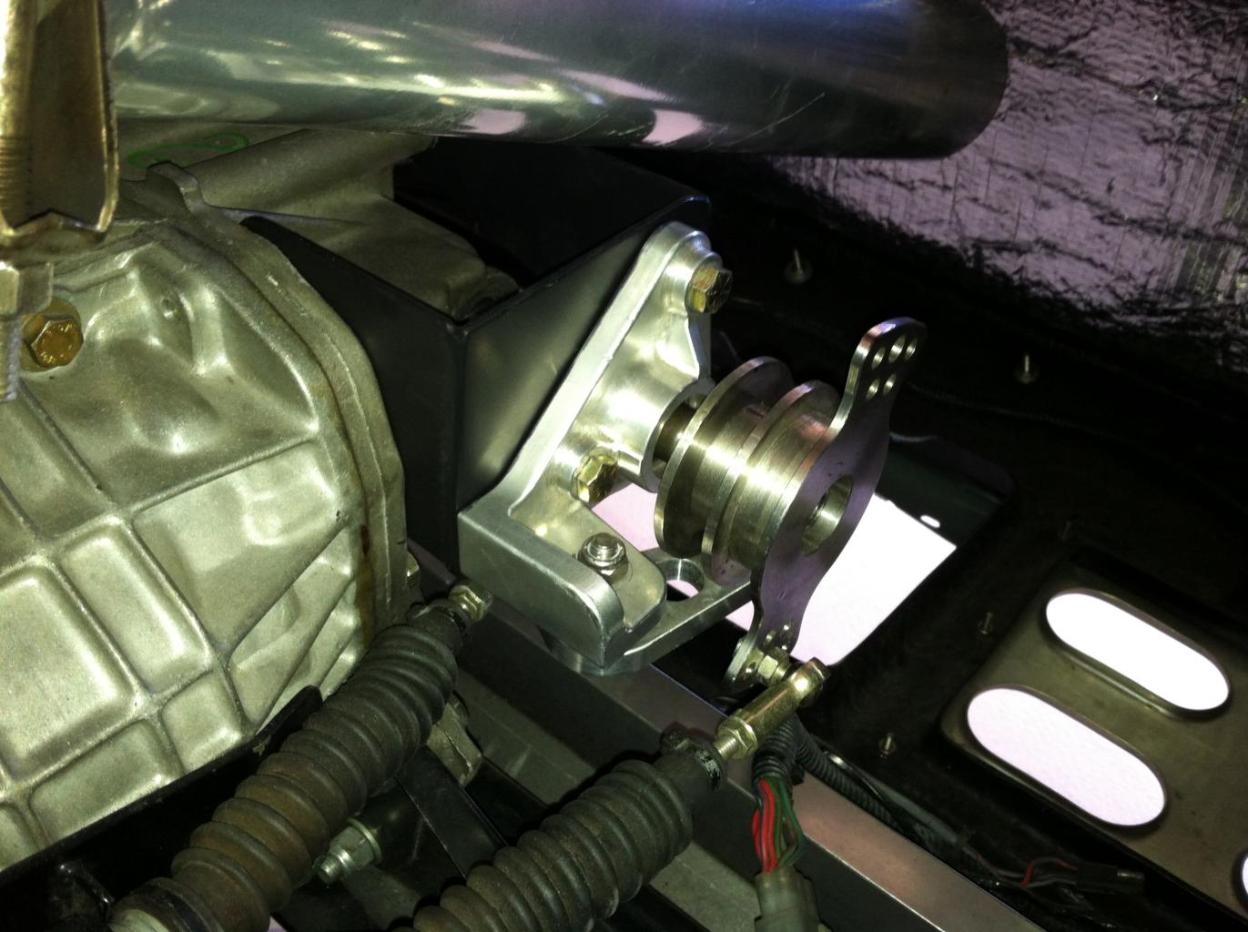

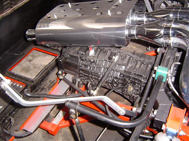

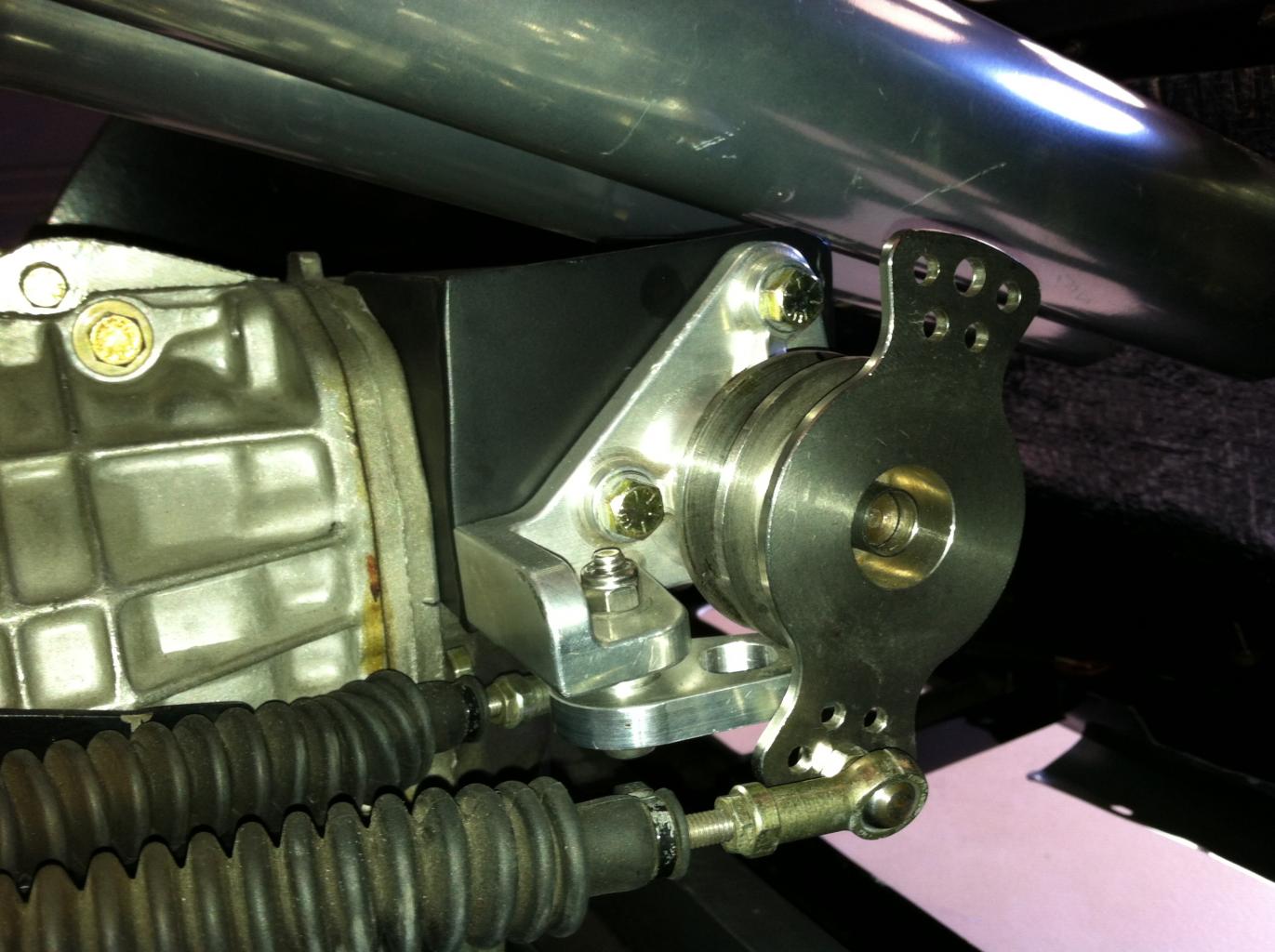

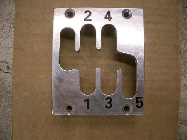

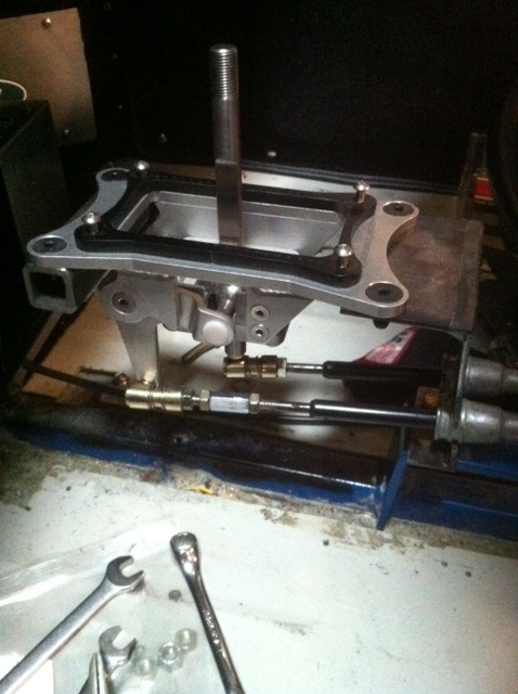

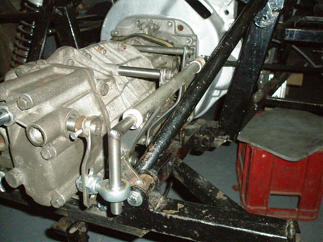

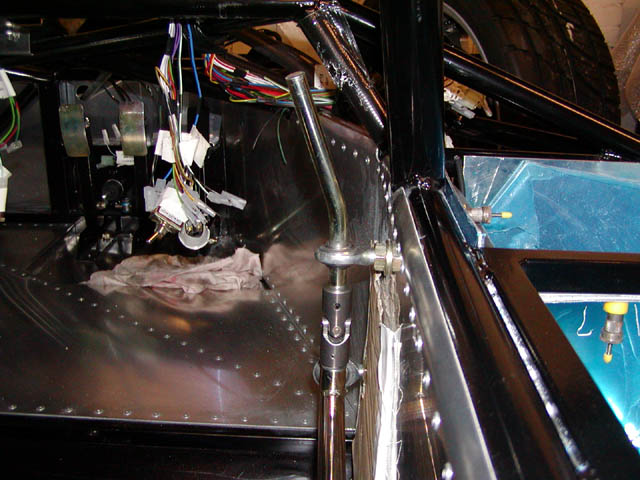

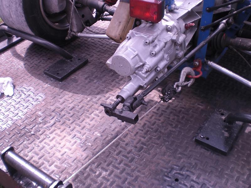

Hi Keith, Maybe one of these is useful, bit of a mixture but bound to see something suitable.
graeme

Graeme, I bought my cables from (from mem) John ketchall, and i looks very similar to yours.

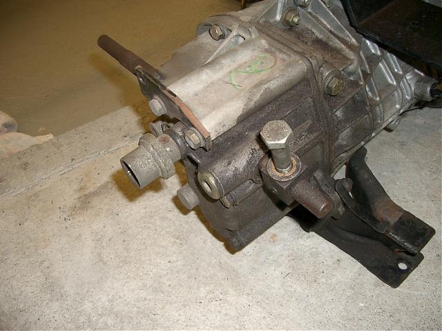

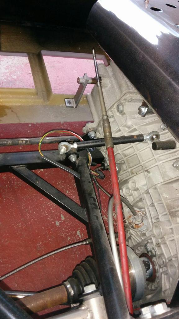

my 013 had the gear shift protruding out the back, can you load a picture of your box so we can be specific on what we are suggesting.

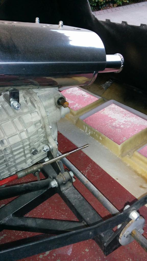

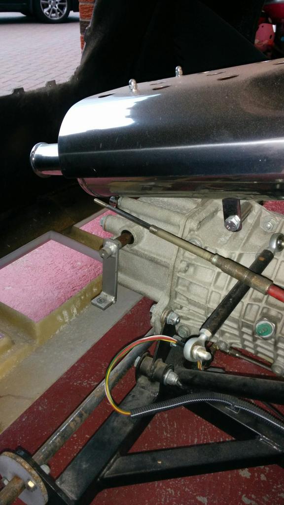

Keith Stafford

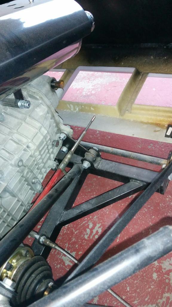

Good idea Russell, see the pix below of the box, the red cables you see are the GTD ones, just set in place to check the lengths. K

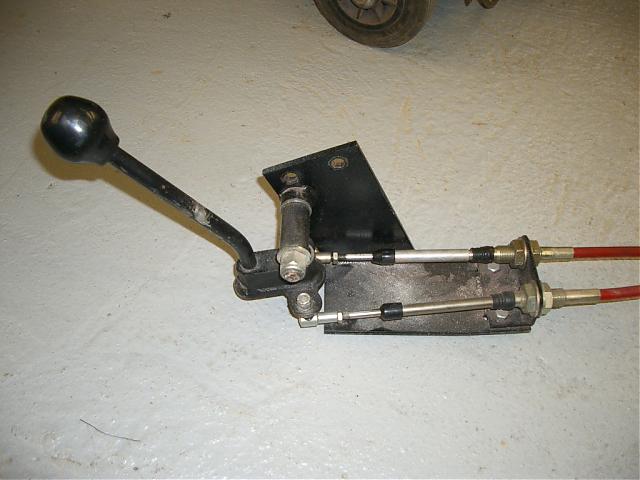

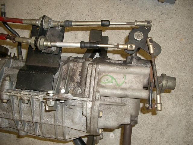

Mike Pass
Here are a couple of pics of the cable setup at the rear of my car which I assume are the standard GTD bits. Sorry I can't get to the front bit as it is hiding in the sill.

Keith Stafford
Paul, the selector bar, that is moved to select the various gears runs through the box and out the other side, I guess whoever did the car simply used the other side. I've seen some where one cable is to the left, the other cable is to the right. K

I'm pretty happy with designing the mechanisms at the rear (box) end of things, the main concern I have is the movement at the gear stick, transferring cross-gate stick movement to a pull push action on the cable going to the box, any advice or direction welcome. K
Use a Mazda MX5 shifter, the mounting plate may need some modifications. You can pick up these shifters on e-bay quite cheaply.
Keith,
I am using an MR2 shifter as it was already set up for a mid engine car.
As for the cable set up in the rear, I saw a photo this weekend of setup that had one cable down the one side controlling the rotation of the shift lever (i.e. 1st to 2nd)while the other cable was run down the opposite side and came in perpendicular to the gearbox controlling the lateral movement of the shift bar. No bell crank was needed in the rear to do the translation. The link is below. I think I may try this approach.
