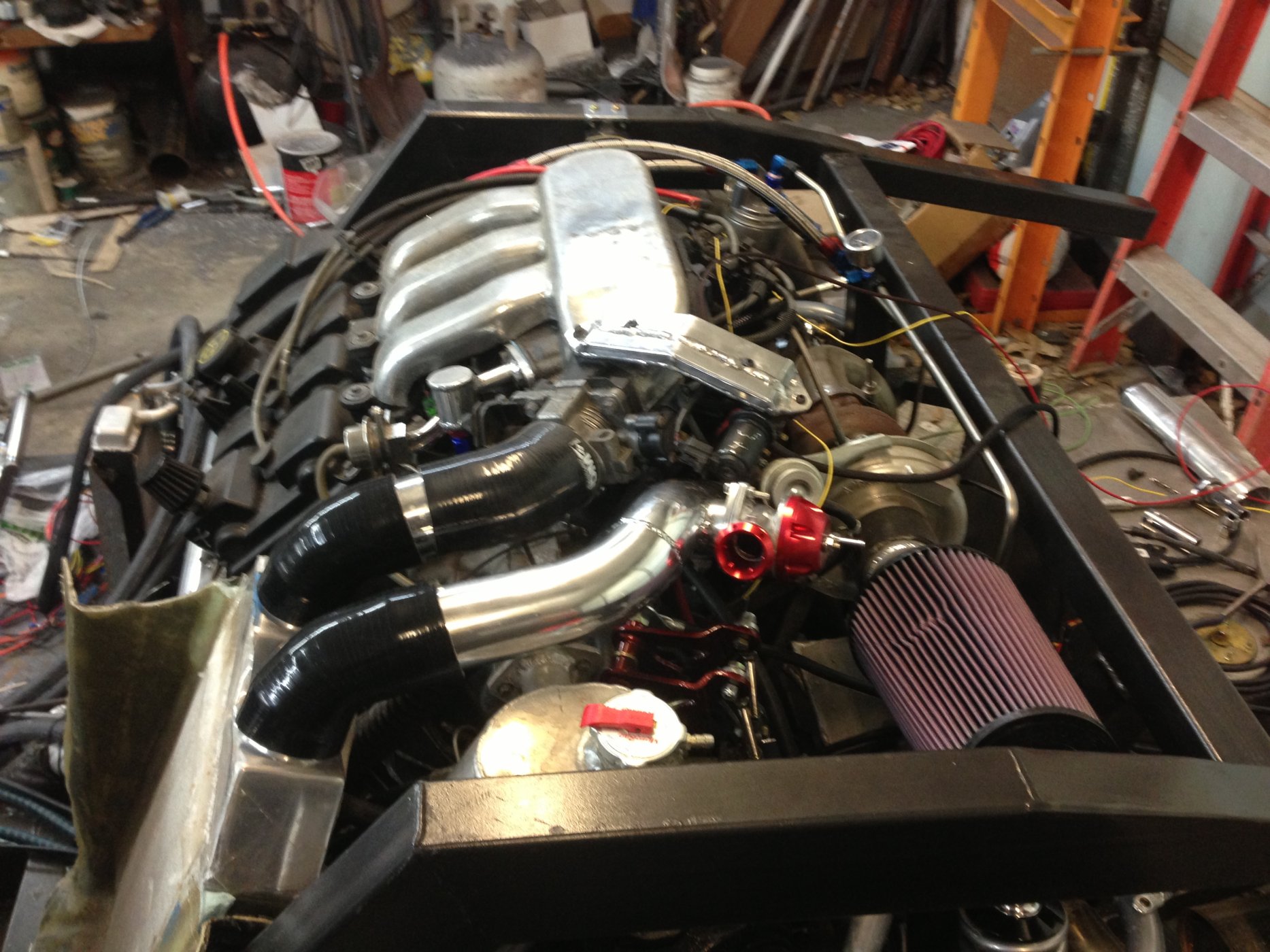

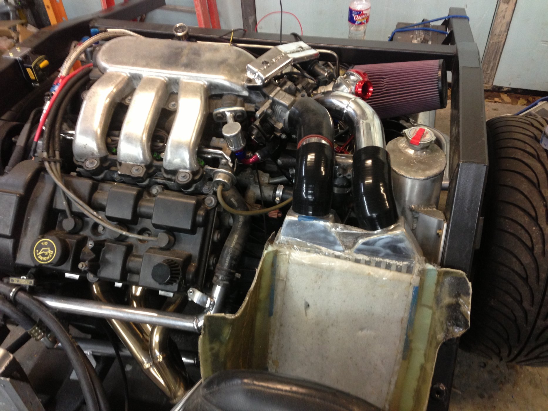

I put a 2000 Taurus 3L duratec with a 2000 Cougar transaxle in the back of a Kelmark

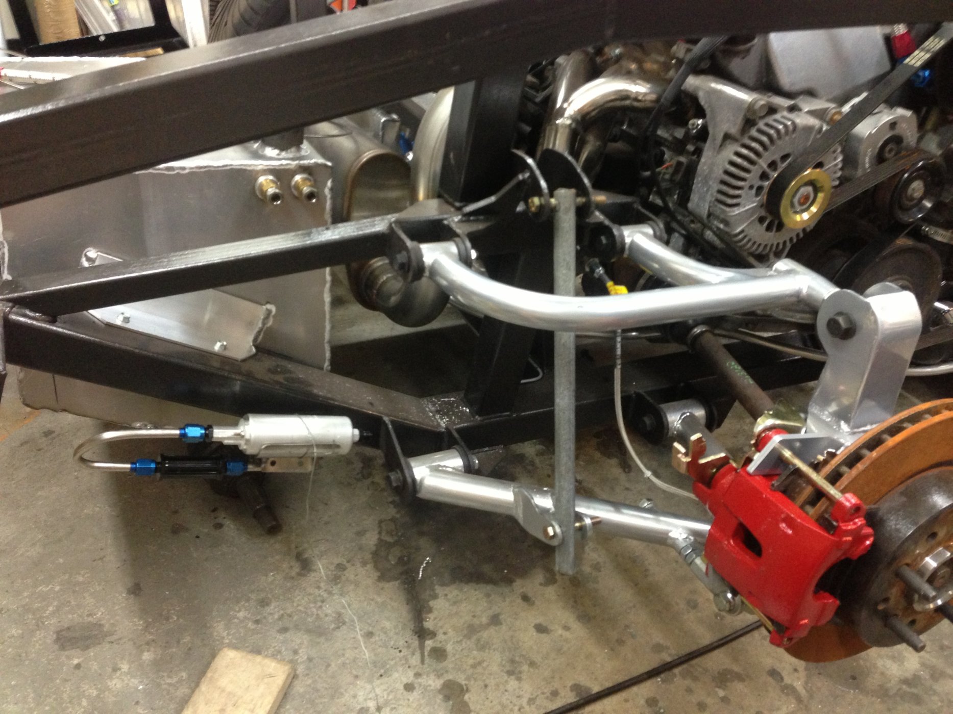

Took some monkey business to make the UCA work...
It's not super obvious in the picture, but the pick up point should be at the front bearing of the alternator

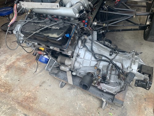

Here's a pic of the mopar 3.5 and 4 speed auto. I wouldn't want to try to figure this thing out, but it has some pics. Looks like it has a custom made intake.
It'll be hard to find a decent one, but you'll want to by a whole running car. Also look at 300M up to 2004.
This was an award winning engine when it came out. Ran mid grade gas and made 250ish HP.

I'll second the 42LE from an intrepid/300M. The late 300M is a better one. They had somewhat of a "reputation" but I found most people/shops topped off with the wrong fluid. I built a mid-engine chassis with a LS mated to the 42LE many years ago. I did not run in auto mode, just paddle shifted manual mode and locked up torque converter in 4th. It's a simple 5v actuated solenoid bank. There were some decent upgrades at one time like heavy duty clutch packs and an LSD for the Prowler which ran the same transaxle but in the rear with a torque tube. Anyway, my customer was looking for a toy and limited use of his left leg so did not want a clutch. I have pics on an old hard drive somewhere. I think I did this when 300m were still being produced so close to 20 years ago. Ouch I'm getting old....
