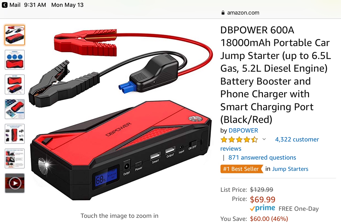

The booster packs I was actually referring to are much smaller and may hold 8 C-Cell batteries and fit in your glove box. Similar to this one. You’ve probably seen dozens of pop-up ads over the past couple of years for these and even smaller “pocket size” booster packs. Cabling is far too small to conduct the current needed to start an engine as was demonstrated in the video.
I own a similar boost pack to the one demonstrated only it was made by Stanley and have had it for 5-6 years now. Impressive in it’s own right and had similar heavy cabling, I don’t think I would try starting an engine without having a battery as a buffer. Mine will only stay energized for 30 seconds at a time - then the timer expires and it disconnects. If the vehicle is running when the timer expires, the alternator could easily go into a voltage overload condition and the resulting spikes can destroy sensitive electronics.
At any rate - it was the smaller units I was speaking of and similar (even smaller) than the one I picture here..
