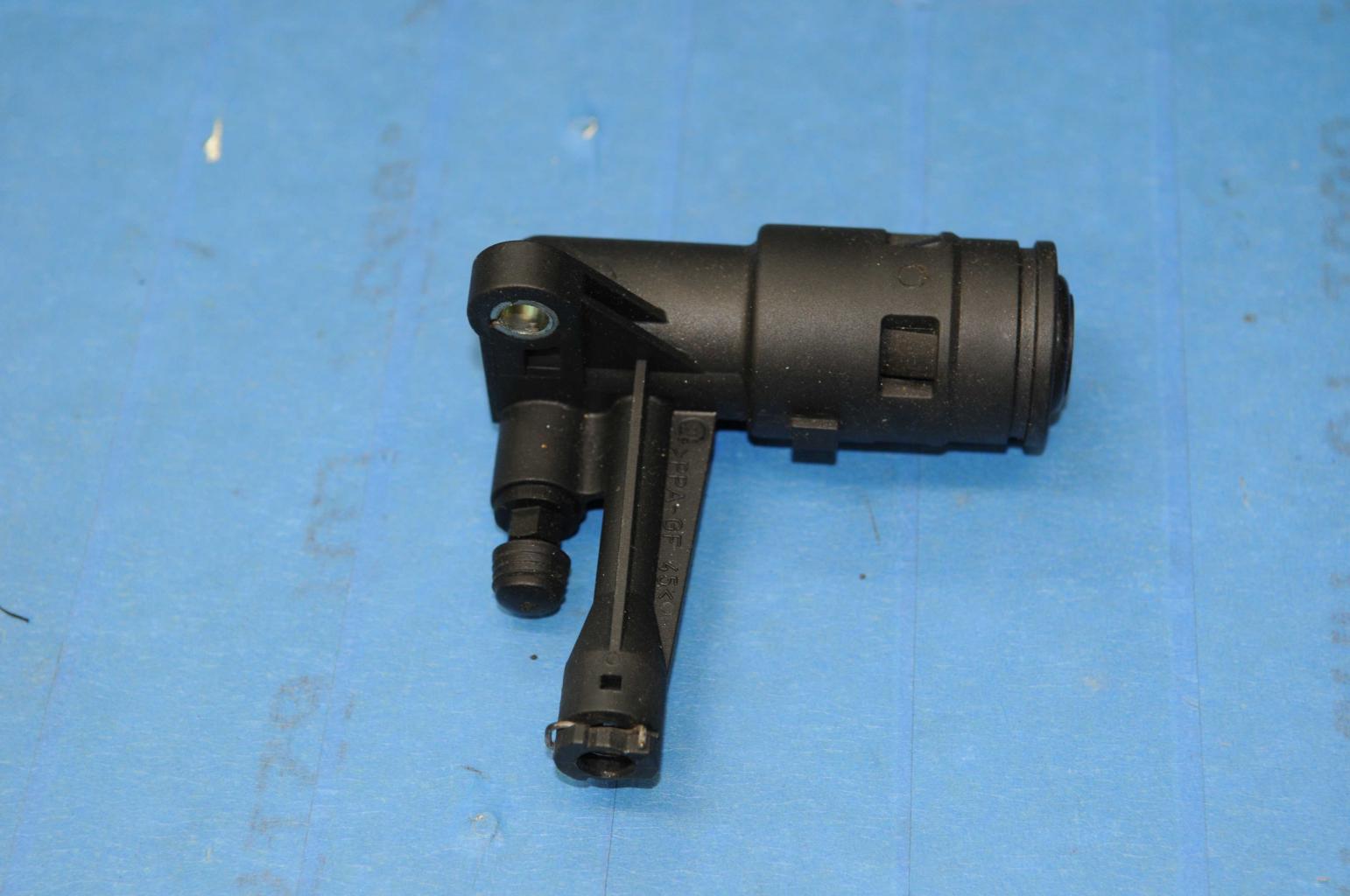

Renato Lifetime Supporter Mar 16, 2016 #1 Anyone knows what type of fitting is on the slave cylinder of 01E and where to get it (US possibly). Thanks, Renato Attachments Renato's GT40 440.jpg 107.8 KB · Views: 304

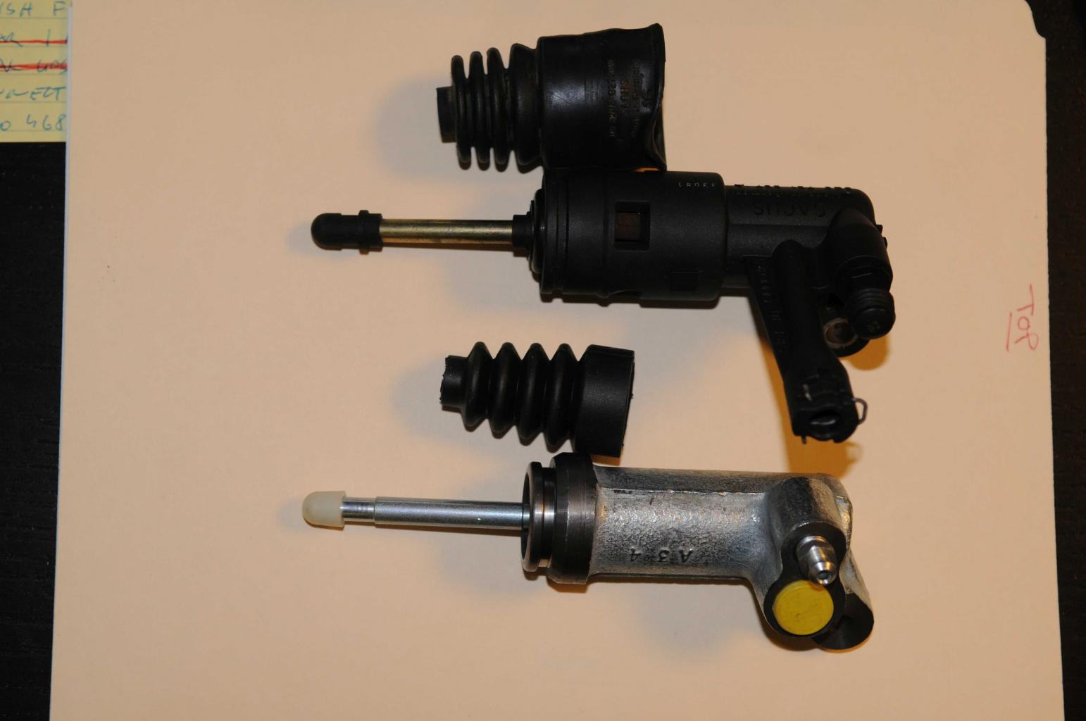

Renato Lifetime Supporter Mar 20, 2016 #8 This is what I came up with: Beck Arnley 072-8874 Readily available at your favorite online store. Tried the fit and it's perfect. The stroke looks the same. Renato Attachments Renato's GT40 449.jpg 83.8 KB · Views: 363

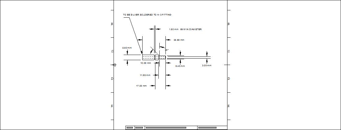

J Jim Cowden Mar 22, 2016 #9 Or you could lathe one of these. Attachments AUDI 6SP SLAVE FITTING.JPG 28 KB · Views: 331
