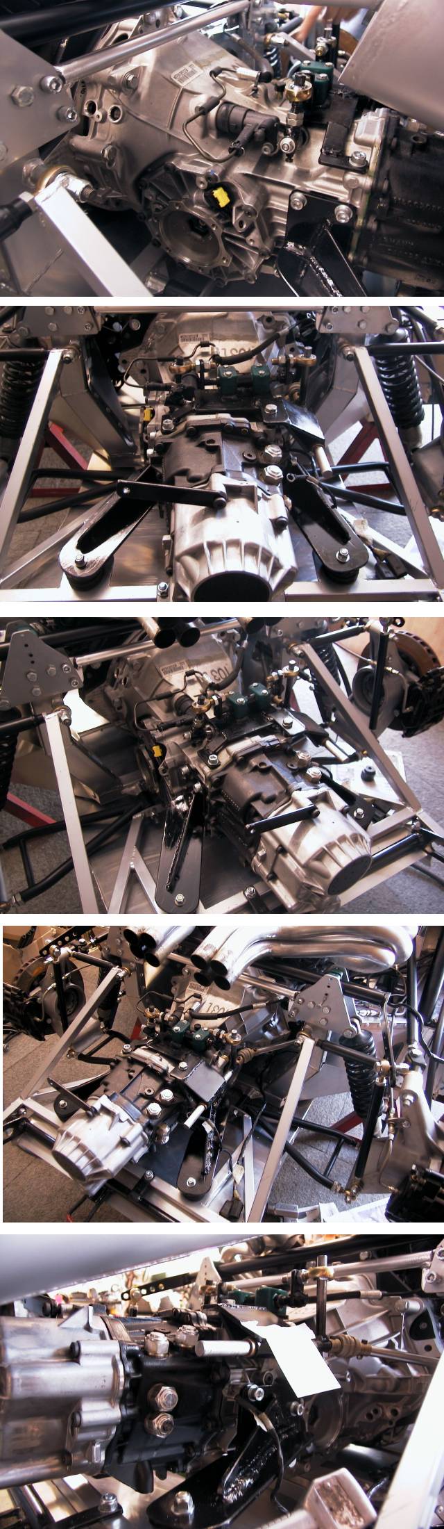

The first version is shown below and was operated by a rod change from the right hand side of the car.

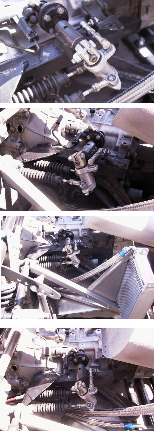

Version 1 above was on the car when he was still building the car, however it had changed to version 2 (below)by the time the car was at the Isle of Man in 2002, which you'll note used the GTD Teleflex Cale system. Not sure why, if Ray let's me know tomorrow I'll spill the beans although with a 'left-hooker', the rod change idea might work better....
Version 2
Hi again
Spoke to Ray again - Version 1 did work, but where there was movement of engine/gearbox, the shift was not accurate, so he went back to the teleflex system which gave fine results regardless of what the motor was doing.
I must confess also that a well set up 'teleflex' cable system does feel very slick providing all joints are set correctly, in good condition and well maintained. /ubbthreads/images/graemlins/smile.gif
