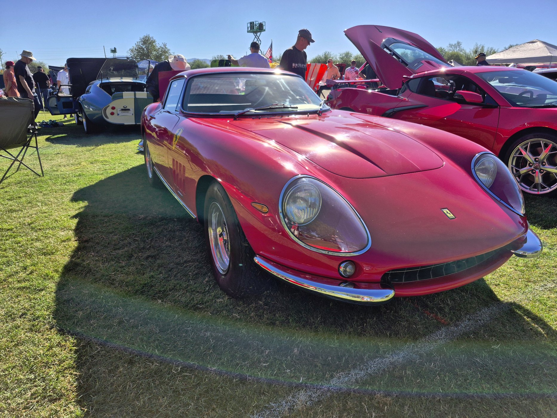

Explosive bolts have been used in aircraft & spacecraft for years. Some are electrically fired, others by a mechanical device.. like a hand grenade. BTW, the Koenigsegg is FAR too complex! This is more in line with my taste...not mine, though.
