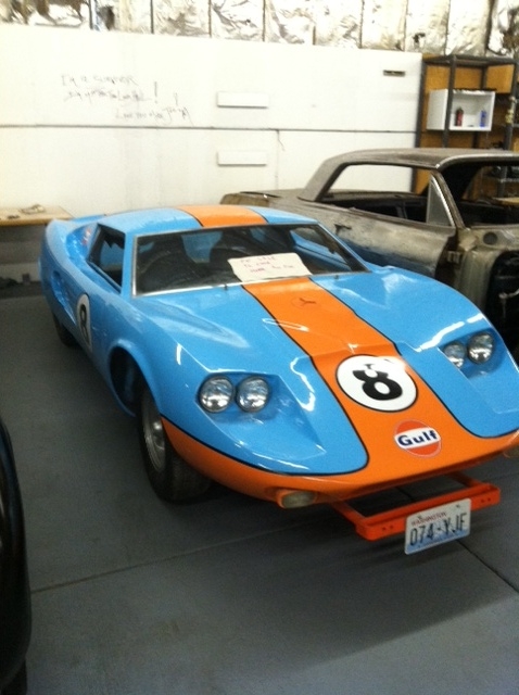

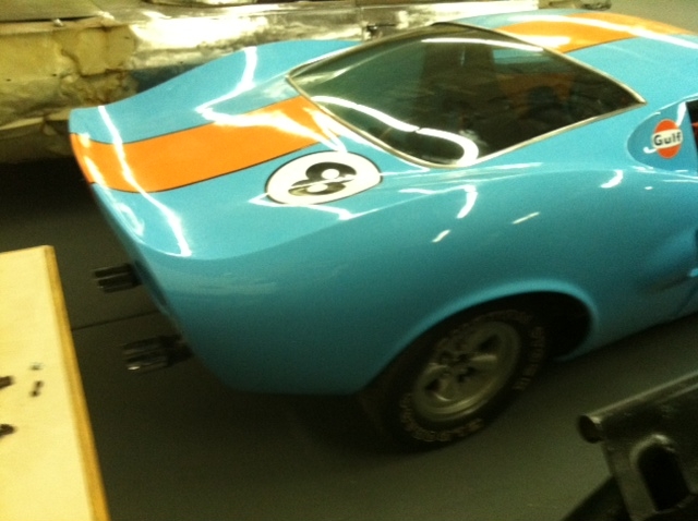

Heres a couple pics of it, Ive already pulled off that huge ass tow bar/bumper setup he had on it, rite now the doors are just siting in the openings, its mostly a complete car but it is missing the mirrors(easy to get) and the head light covers

Tom, I can't tell from the pics where the engine lid/hatch is. Does the rear end have a hinged panel? Appears as though it is a later body with the rocker panels
as one piece, molded with the body. I'd be looking for some Mustang II door hinges
and a way to make them work. Nothing is easy...BTW, good luck trying to find headlight covers. Perhaps there is someone out there on the Avenger forum making them.

The back of the car did have a removable panel to access the engine. The doors do have VW bug regulators in them but only the drivers side actually has glass in it
