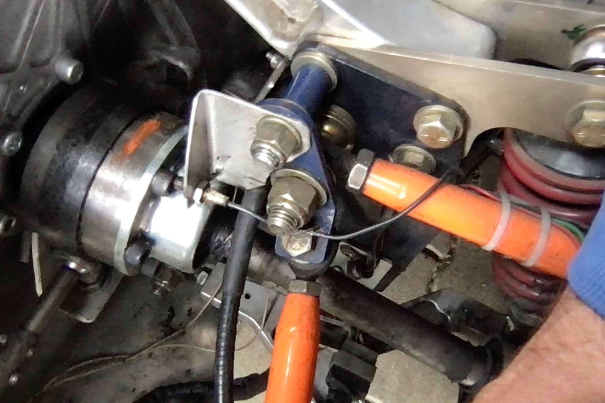

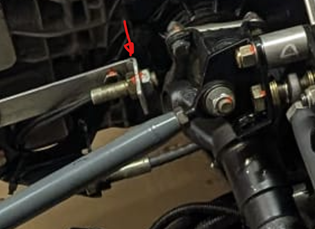

My RCR came with the same sensor, I believe, and it was located near the rhs rear brake rotor into which a small hole had been drilled. It did not work. You can test the sensor itself by measuring the induced voltage when swiftly moving it past an iron bolt (or tip). Finally, I did get a signal from mine. However, I could not get it to work with the gauge - I think the pin hole in the disk gave too small a pulse. Also, the sensor must be very close (~ 2mm) to the disk, which under braking, will get quite hot. Not good for any electronic device! So I ended up putting the sensor to the bolts of the axle at the transmission. In fact, I now use a different sensor "Smiths Speedo Sensor For Smiths Electronic Speedometers Inductive / Hall Effect" which has a diode blinking when in operation. It has 3 wires but is easy to wire with the RCR Classic speedo (I used an unused hot wire behind the fire wall where the shift rod passes - if I remember correctly).
I mounted mine on a bracket facing the backside of the RF wheel hub/brake rotor assembly. Worked great and very accurate once calibrated. Wire run to the gauge is much shorter. Gap is set to about the thickness of a dime ~0.10".
