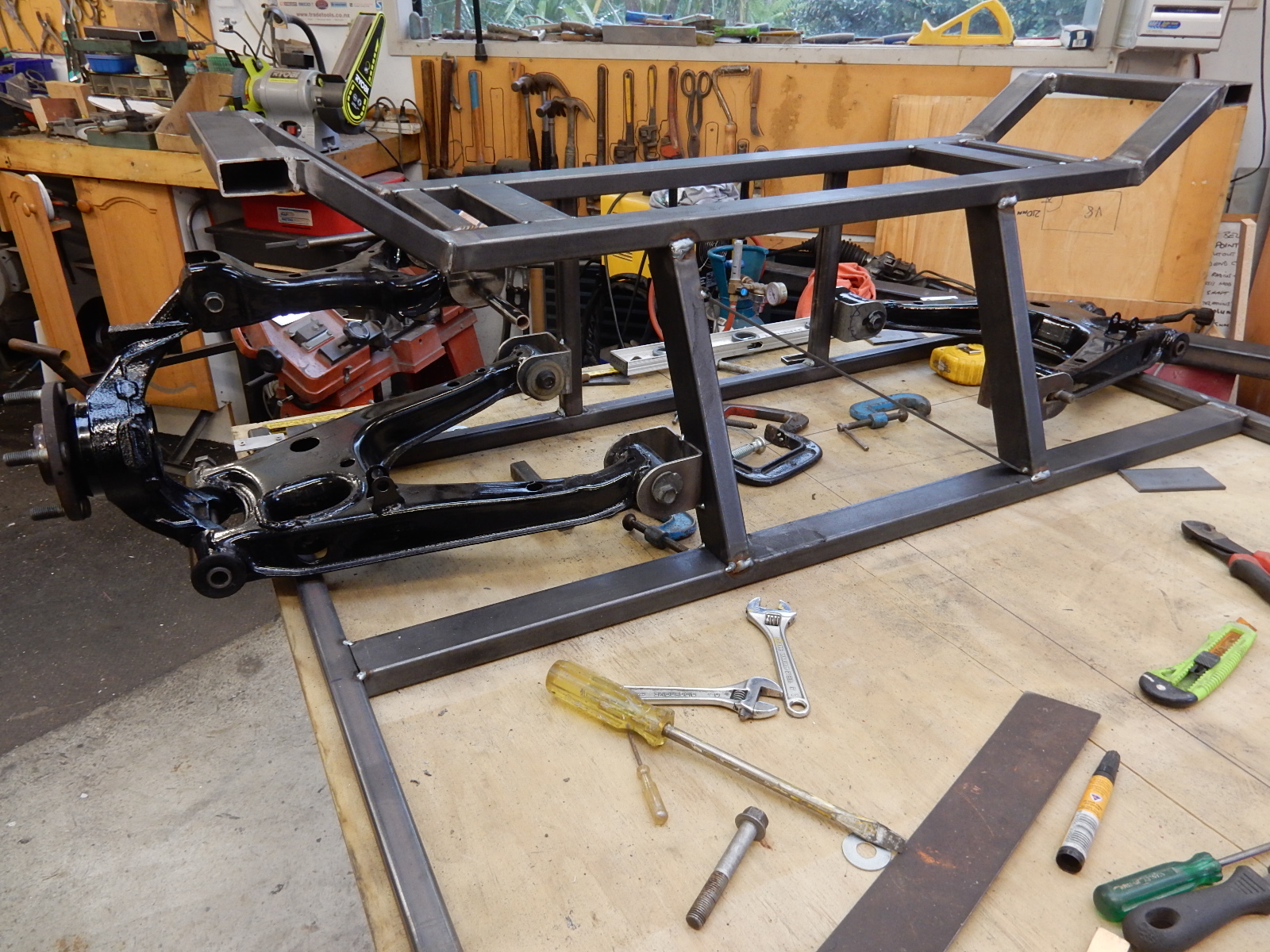

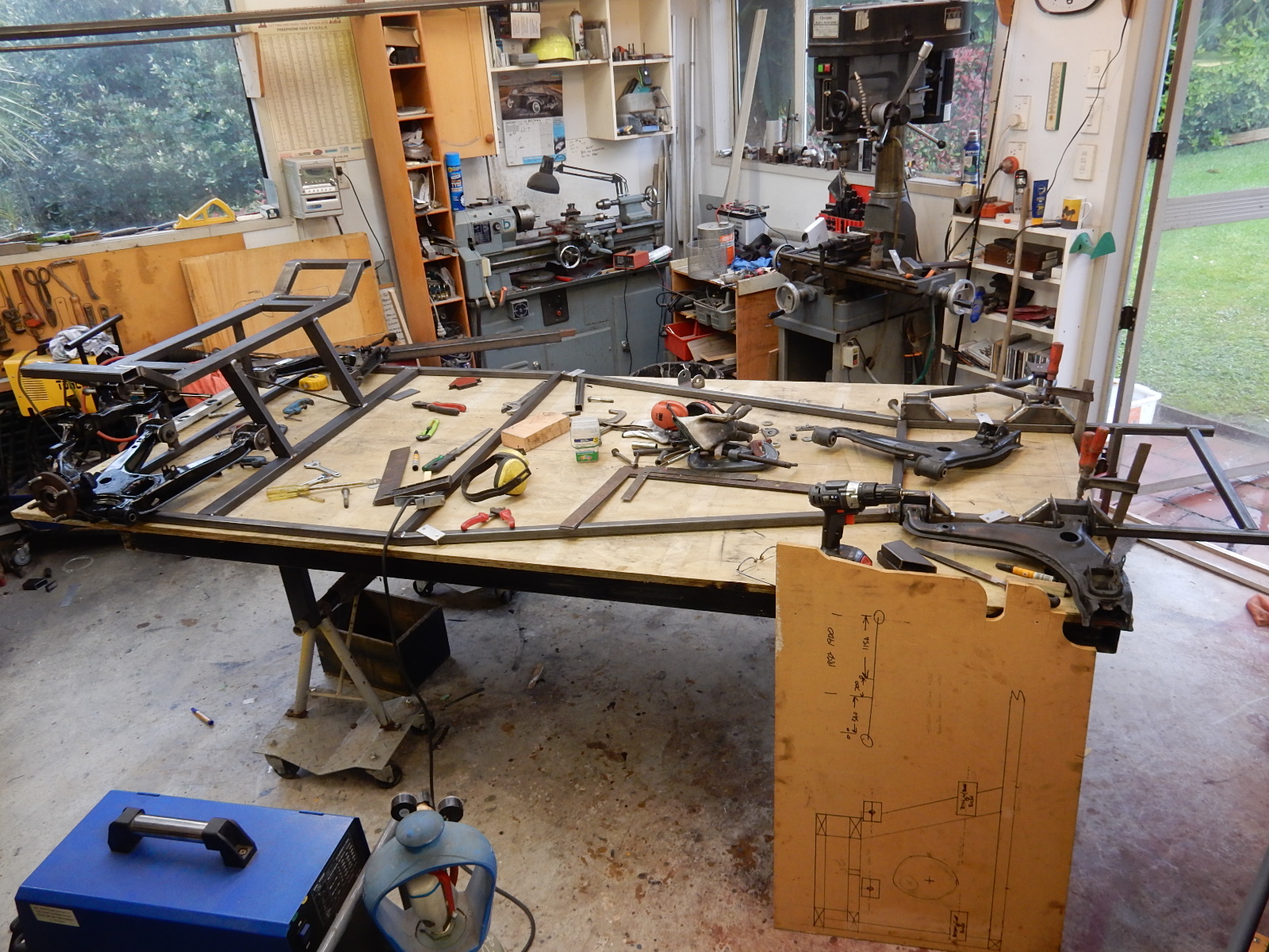

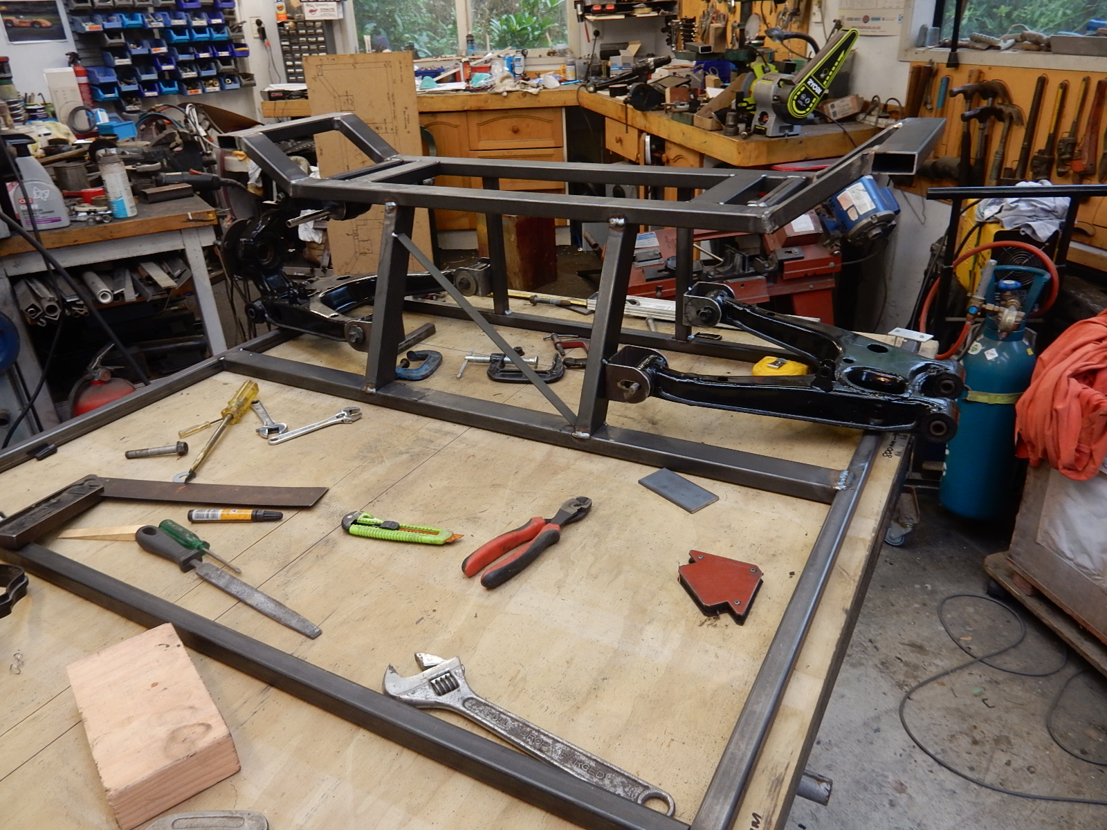

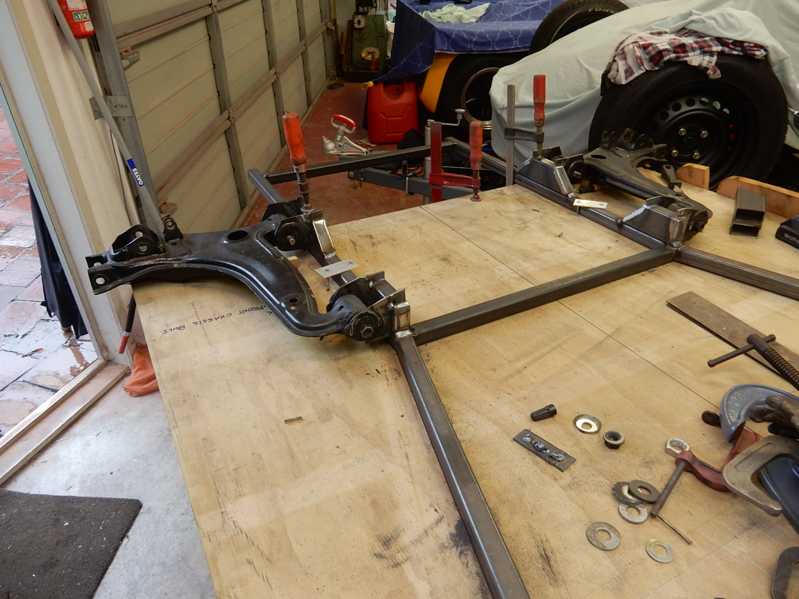

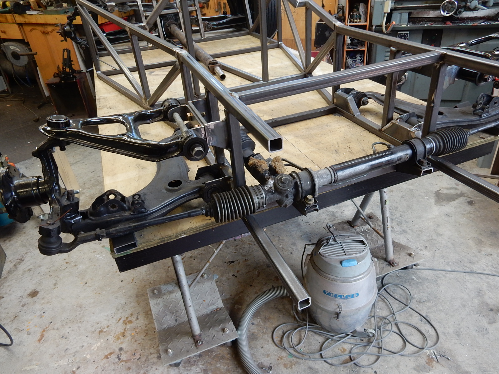

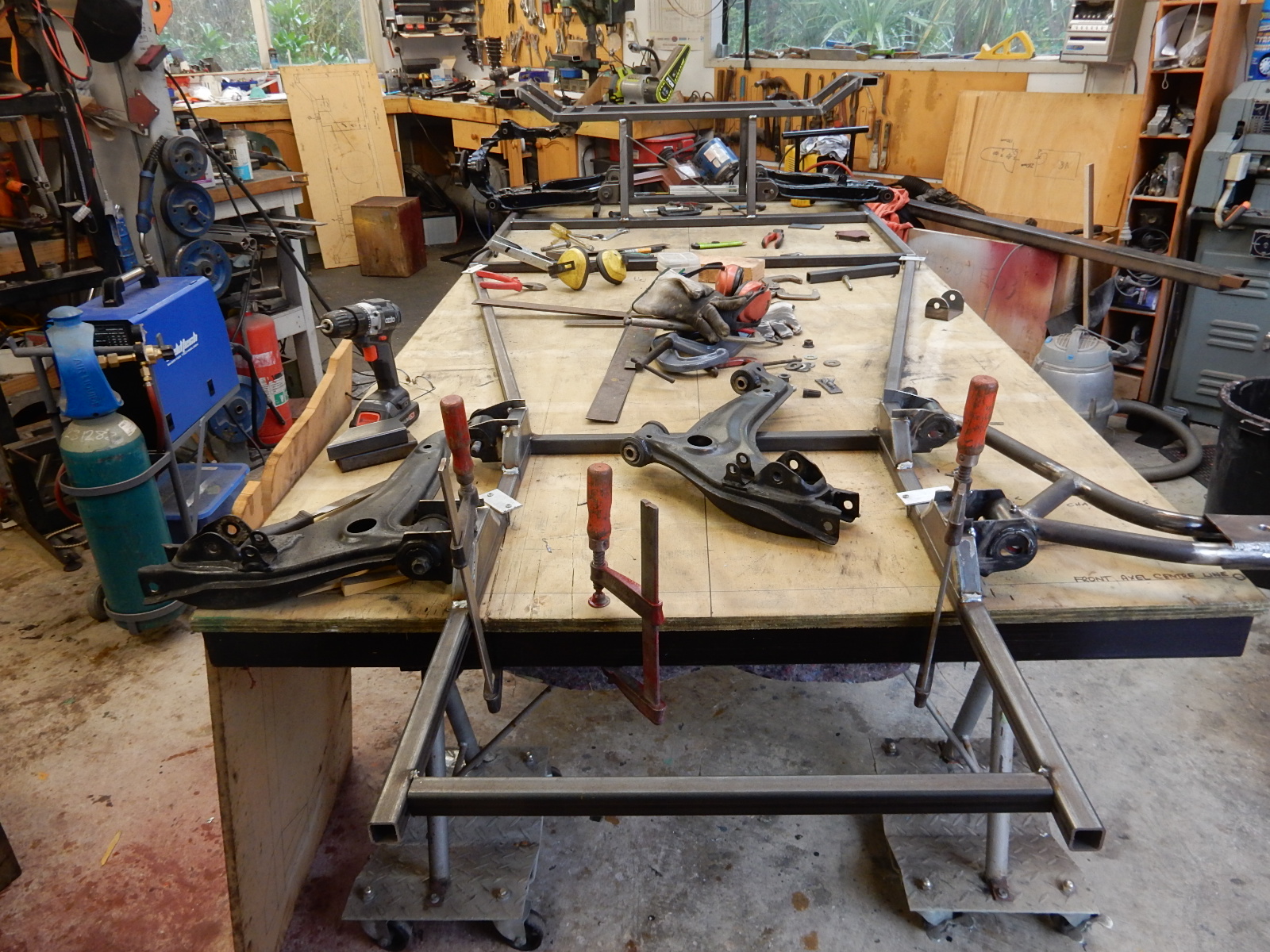

This time it`s an other fun build with very little fibre glass body work, had enough of the scratchies. I managed to buy a rolling chassis Mazda MX5 a little while ago and spent a couple of days stripping out any thing of use. So the basis is full MX5 suspension and a tube frame chassis with said stuff installed. I elected to not use the rear sub frame as I wanted it to look more of a fabricated special. Because I already had an MX5 subframe in the back of the Formula Junior, I was able to draw out the relative dimensions and design the rear of the car in principle. I also cut the adjustable suspension points off the front sub frame and installed them on the new chassis. I have elected to build this chassis with 2mm x 25mm sq box as weight is not an issue.....as it`s going to be V8 powered. I would love it to be old school if i could find a 3.5 ltr Rover and adapt a modern 5 speed gear box as I did in the previous car I built for my late Carol. Trouble is that they are as rare as hens teeth and very expensive to recondition. Next choice is Lexus 4ltr quad cam auto or another manual conversion.

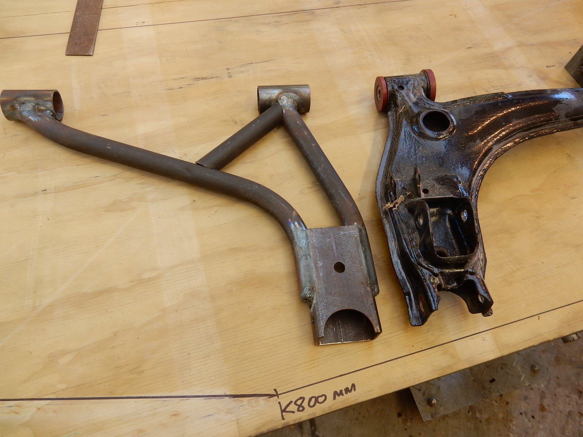

I started 3 days ago and set out the bottom rail layout, front width was governed by the rail space to get the correct lower wishbone spacing. As in the Formula Junior, I remade the lower arms to stock interchangeable dimensions as the origional`s look rubbish. With the help of many tricks, I set up from my plans, the rear chassis/diff carrier and set up the suspension to stock position. It also looks like I may be able to run the standard MX5 rear shock as it fits inside the sub frame...we shall see.

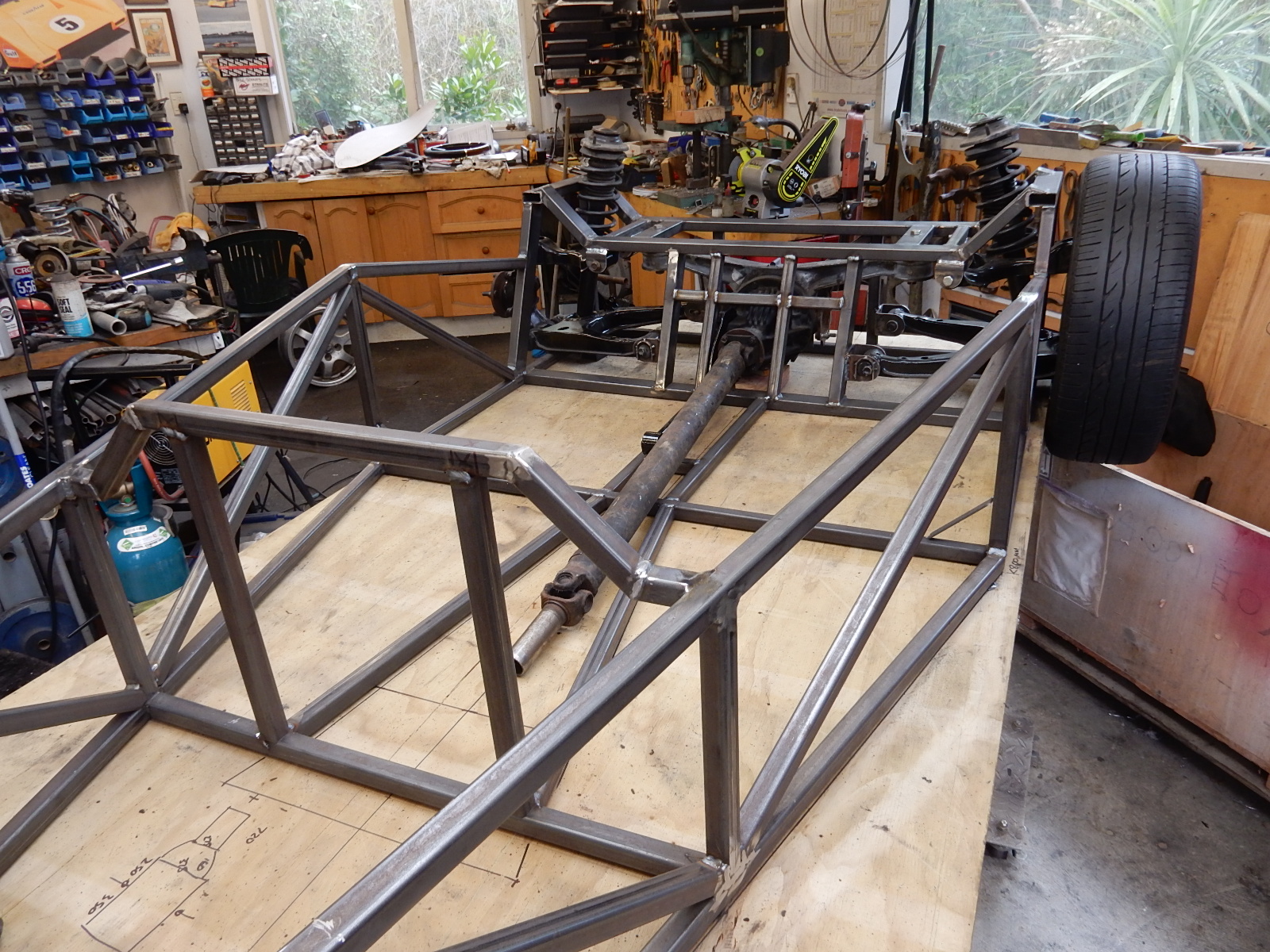

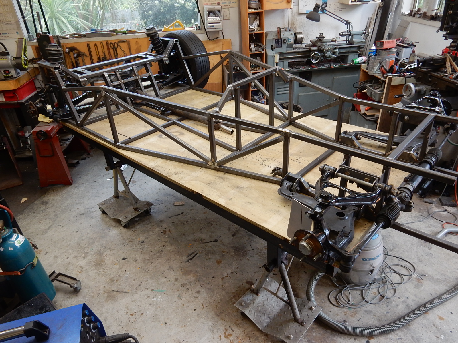

Well a little more progress, had a bit of a rush around just prior to the last lock down gathering Mig / Tig wire, Argon and Arcal 21 gases. Got all i needed so progress unimpeded. The standard rear shocks fit. The fronts will be inboard QA1`s on bell cranks and the standard power steering rack all fits in place via the same dimensions as stock. Stripping it out now to turn over and catch up on all those other welds. Great weather it`s of for a drive tomorrow in the real MX5.

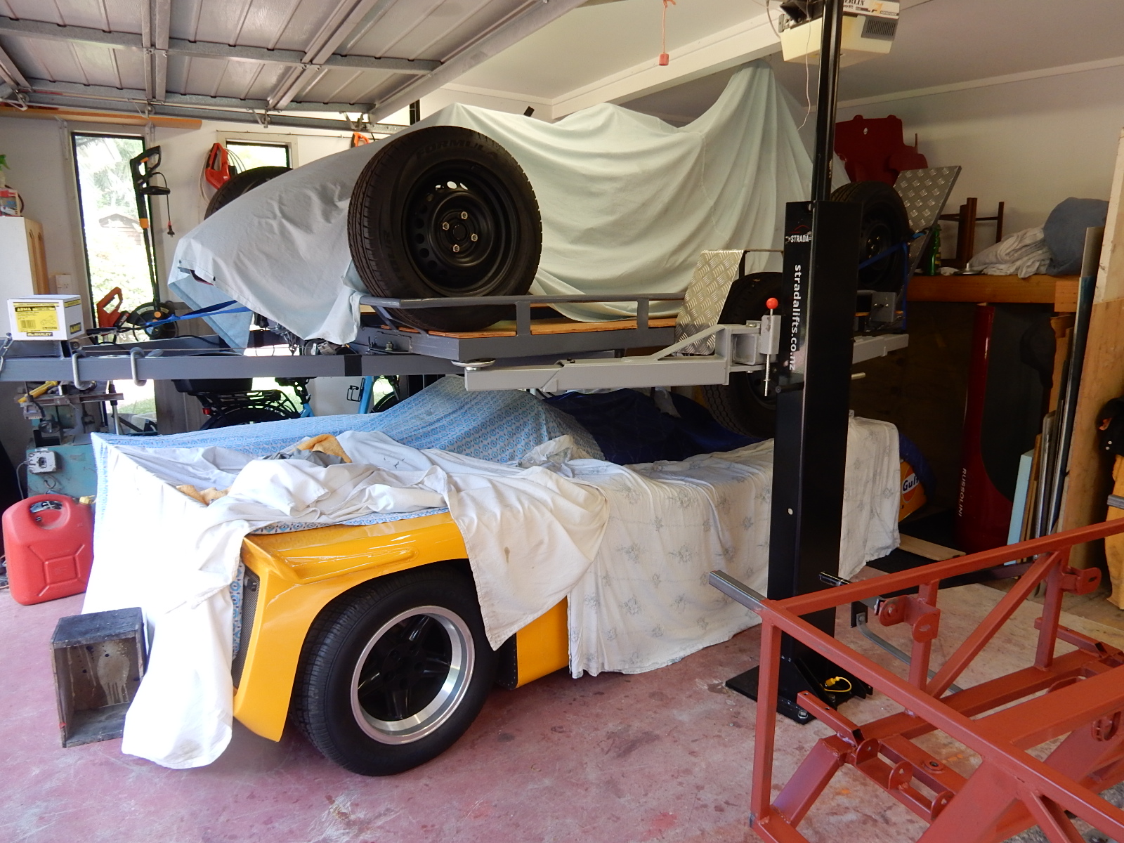

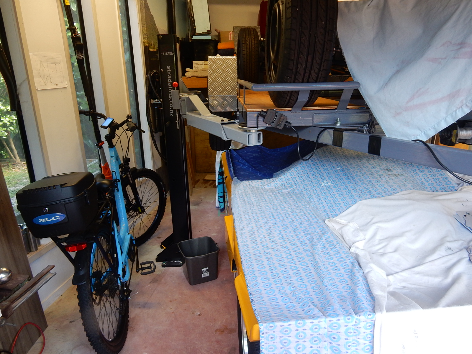

Best self Christmas present ever, been looking at hoists for months now and did not have enough head space 2.8 mtrs to install a normal height hoist. Found this one that easily fits in under 2.4mtrs, lifts clear 1.5 mtrs and nothing on the floor means the Formula Junior on the trailer sits on top and the Mclaren rolls in underneath. It was a bit tight having to work around the door mechanisms and the roll bar,( 25mm clearance to the roof ) and the door clears the carbs by 40mm. Cheapest garage ever at $2700, delivered and self installed. Being hydrolic, you can even unbolt the uprights and store them away to clear the space.

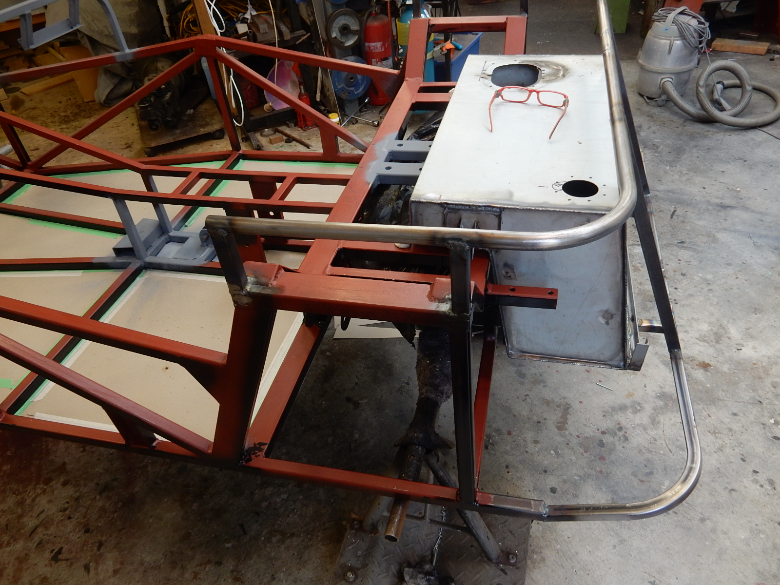

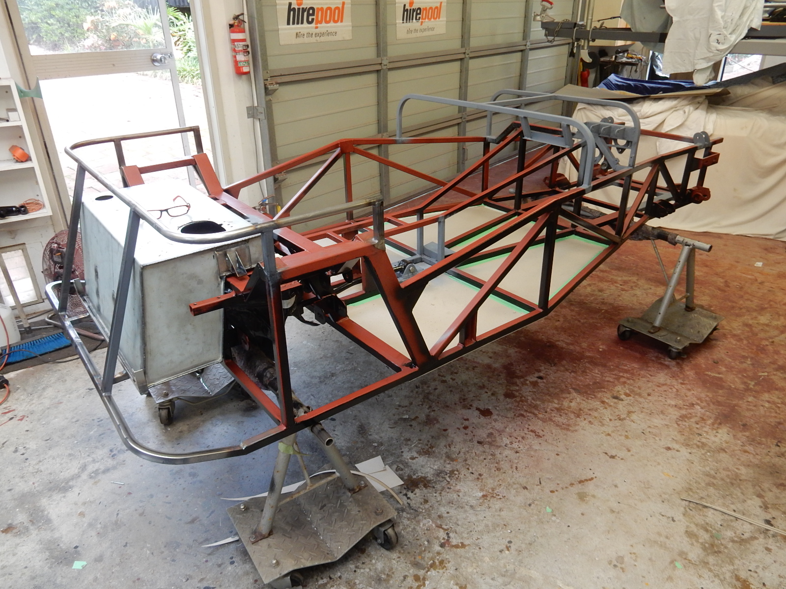

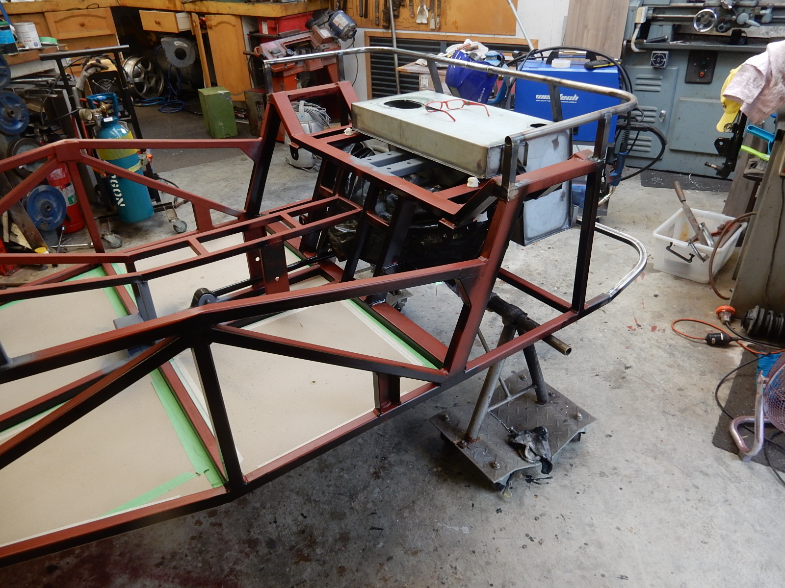

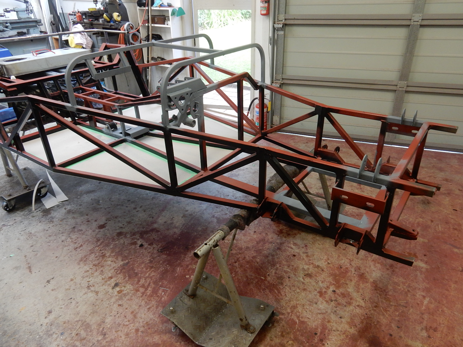

Well getting ready to throw some final colour on the job, just checking that all bits are accounted for. Made the fuel tank up over the last few days, bit of a `shape` due to accessibility. Managed to score an MX5 5 speed gearbox so the drive train direction is now committed. Was chasing a 2ltr 5 speed Sierra motor and gearbox but some bugger wanted it $2600.00 more than me! The floor is all bonded and riveted, just got to do a battery box mount in the engine bay and then do some fibreglass body panels. W
