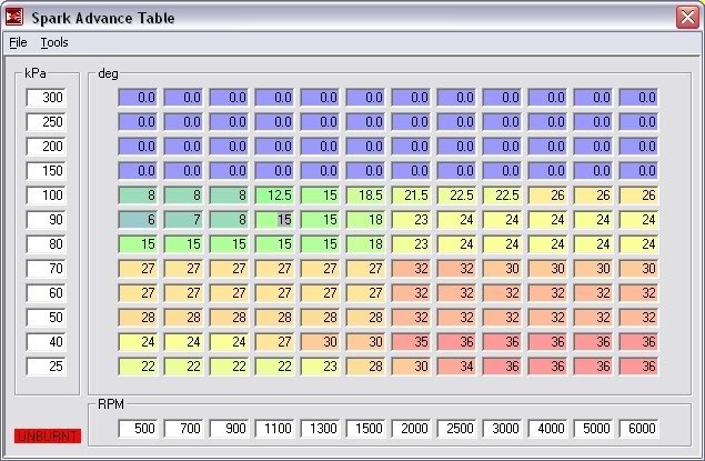

Hi Andy,
Here is the ignition map derived from a 5.0 HO. I use it in mildly ported engine. It can serve as a good starting point for you.
Regards
Henrik
