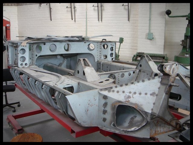

This is what I have...
Internal battery box dimensions 9 1/2" long, 7 1/2" wide and 7 1/2" deep.
The depth is actually 7" to the top of the chassis but there is a 1/2" lip around the box.
Old photo but shows the lip.......
