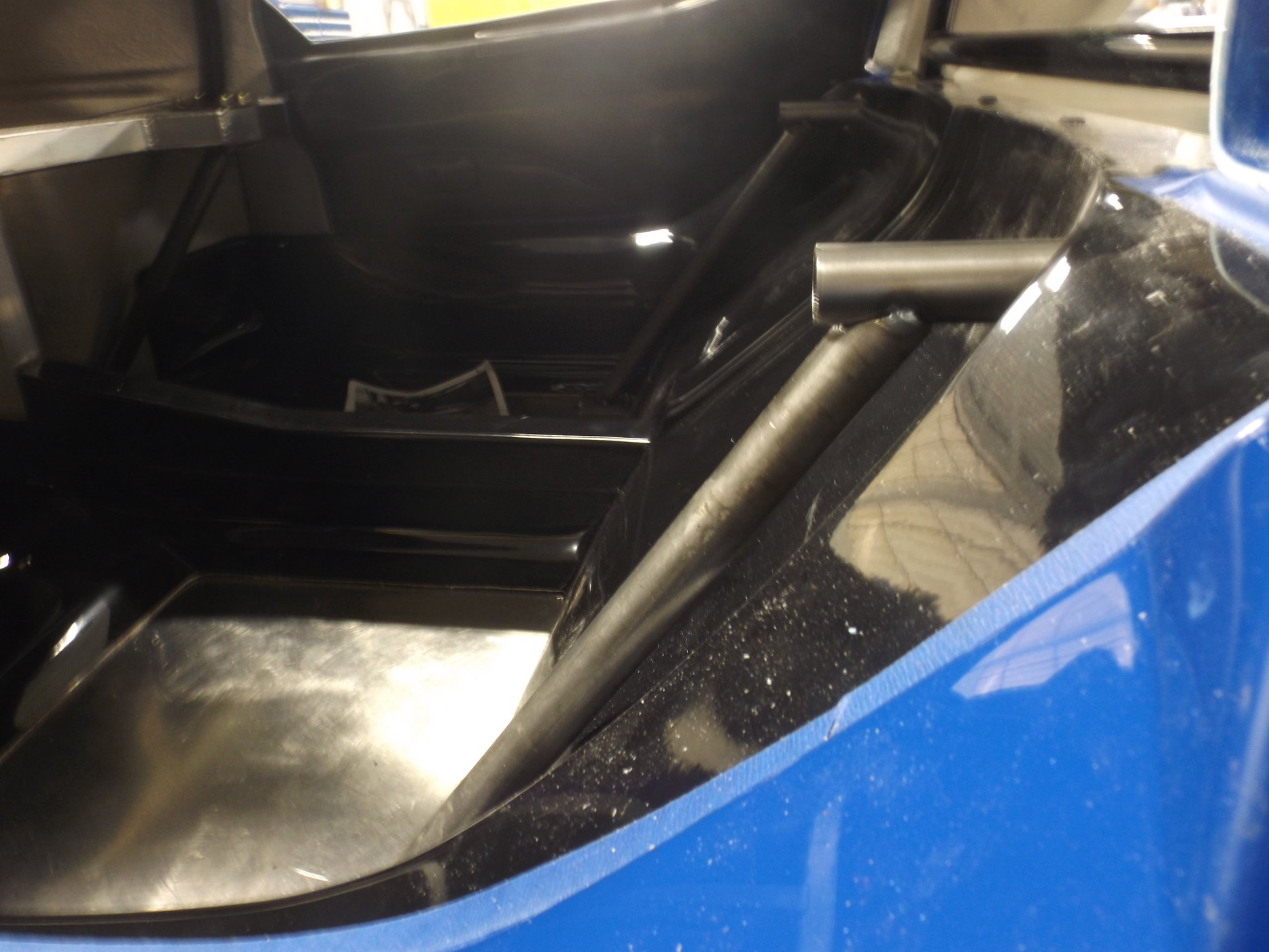

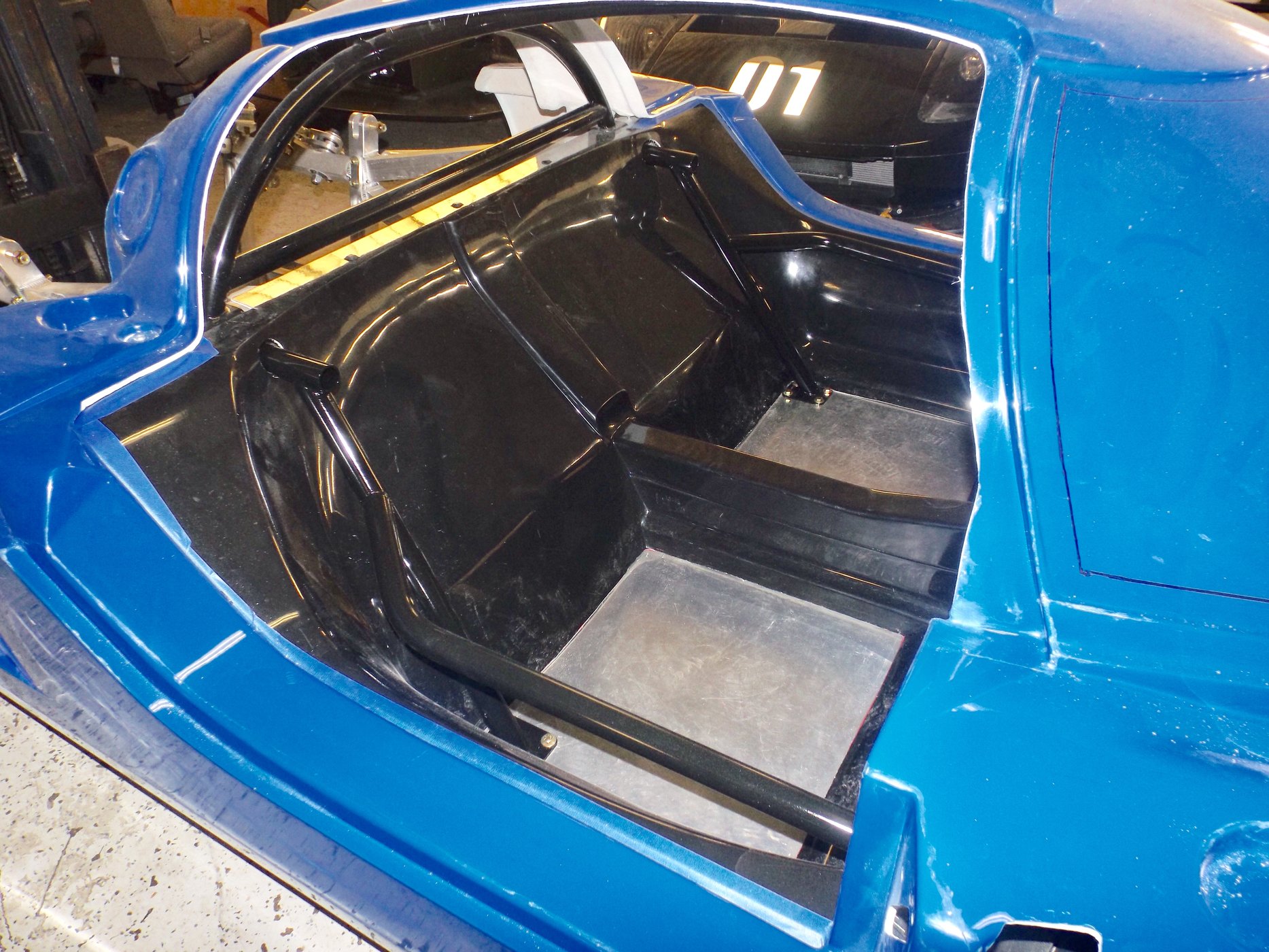

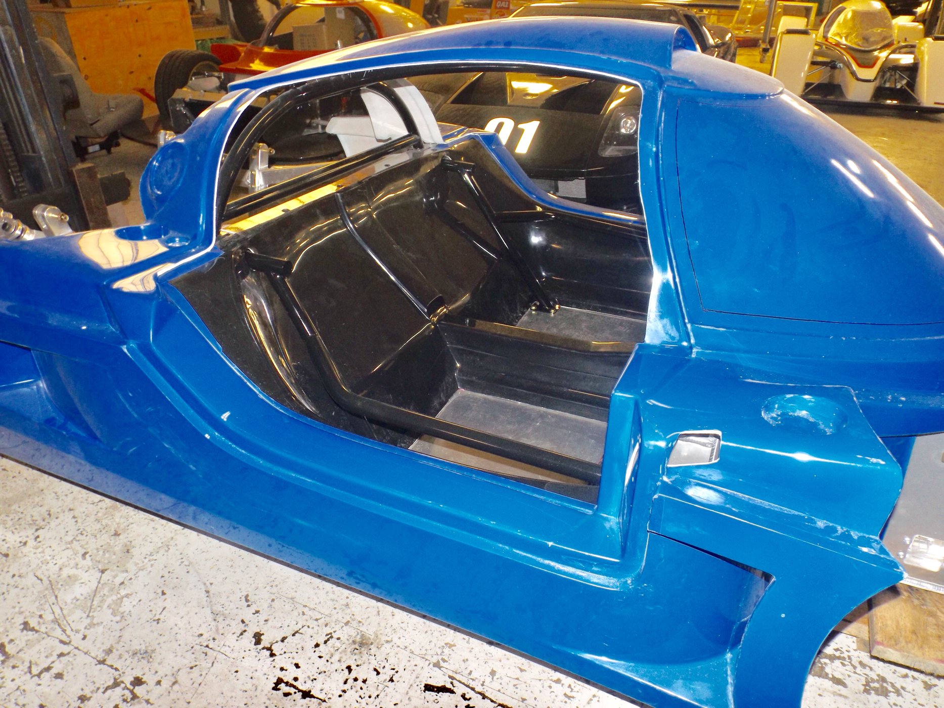

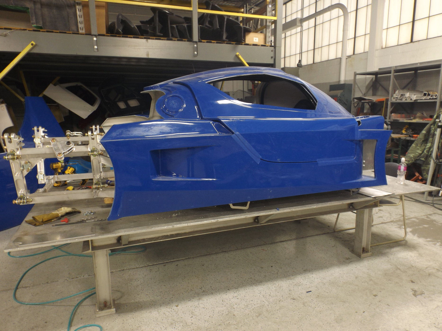

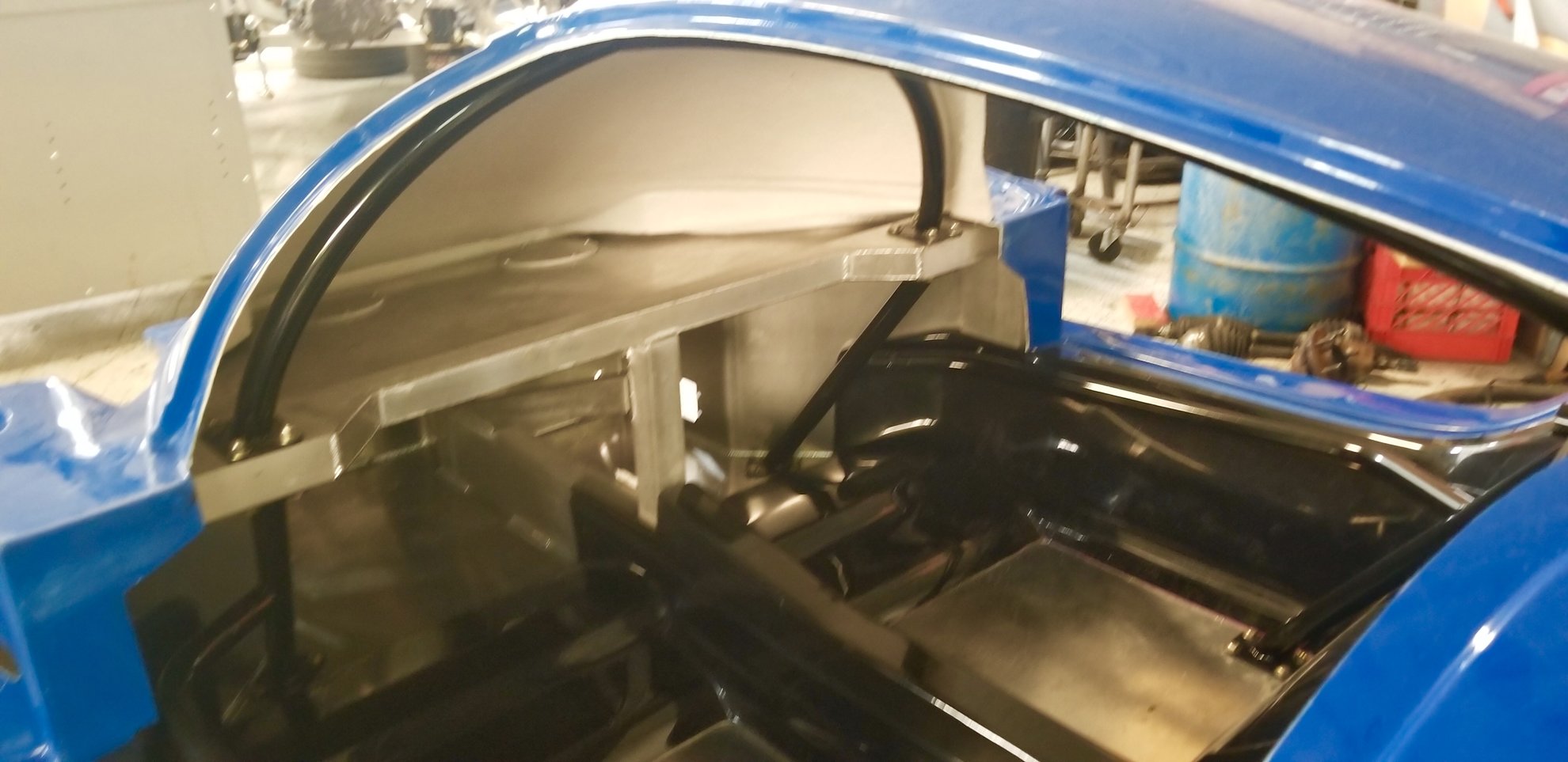

First couple pics of my SL-C getting finished up at RCR. I am looking forward to getting started and sharing the build experience. This is gonna be so much fun!
Deep blue gelcoat:
Low profile removable side impact bars in process:

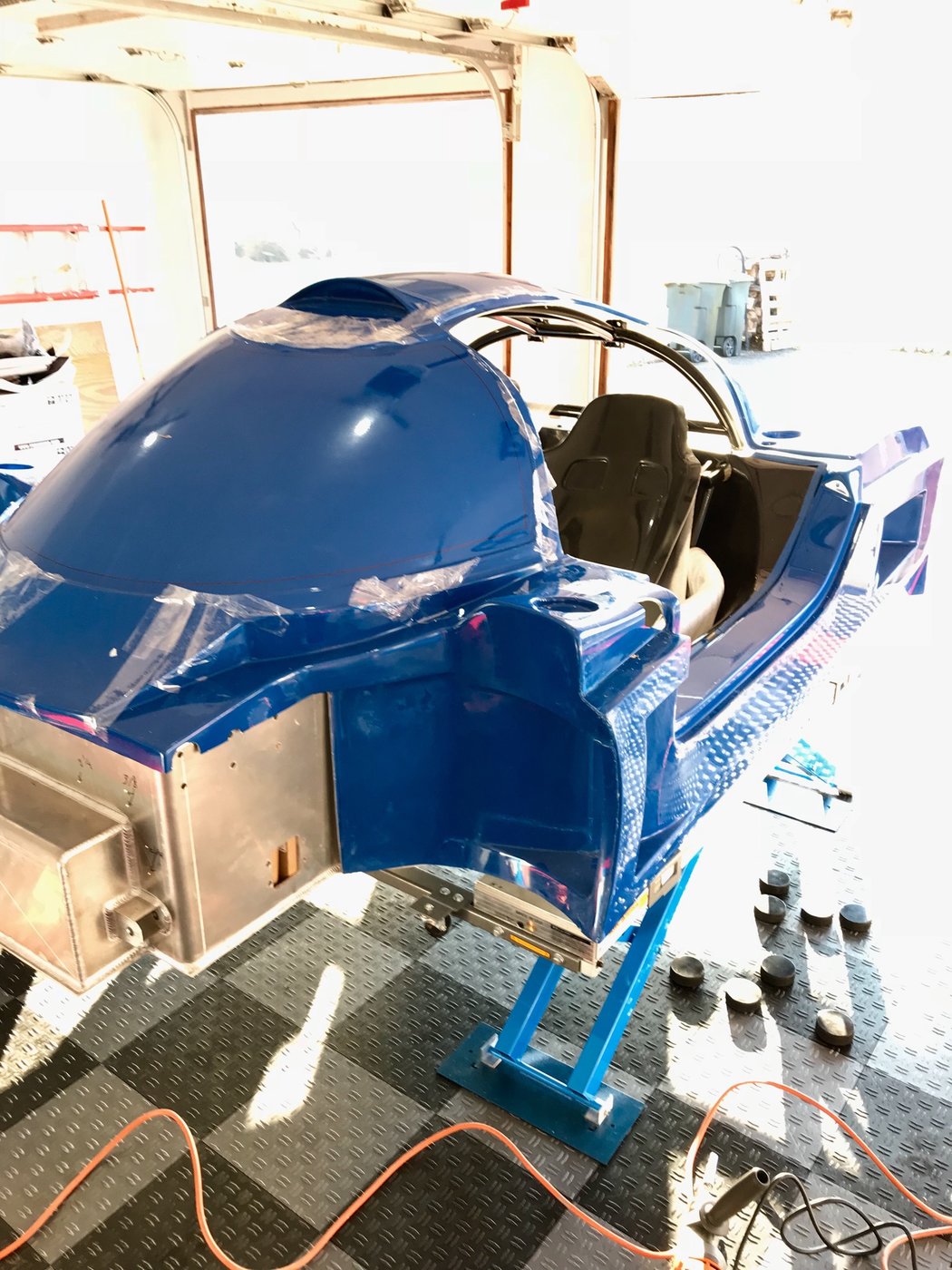

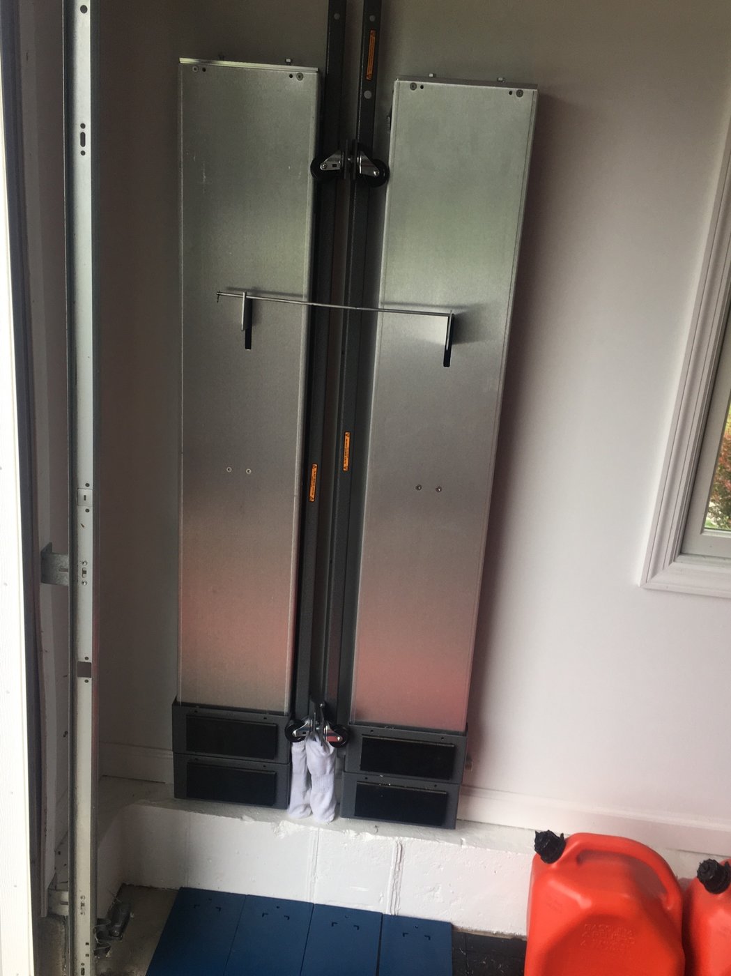

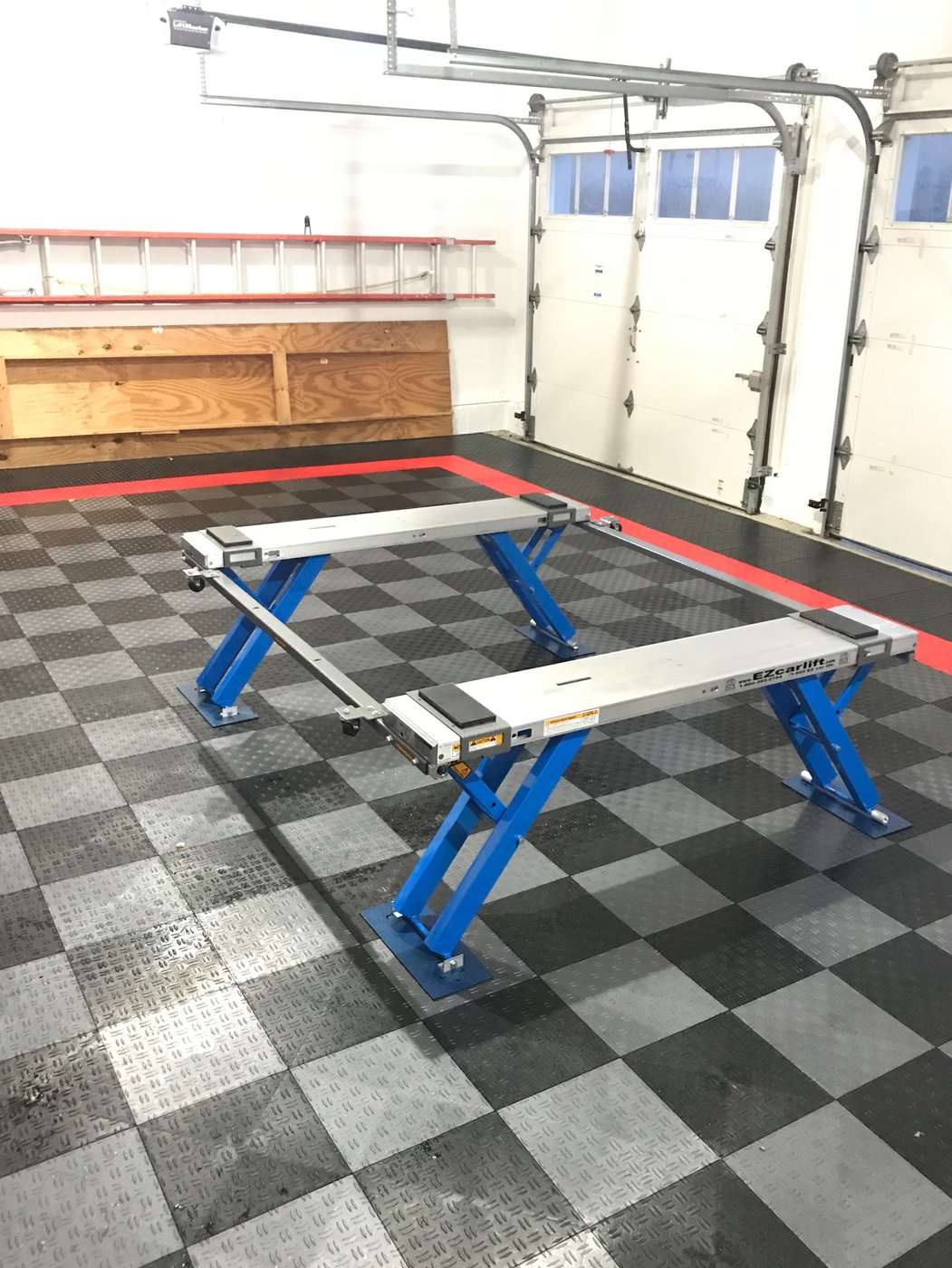

The SL-C is crated up and ready to ship. Delivery should be sometime this week. I have the scissor jack lift ready to go. I sized it so the dropped floor pan will sit between the lift’s side rails. Knowing the car is rear weight biased I may need a jack stand under the engine mount or some other place in the rear of the chassis. I bought the lift to raise the car up to a decent height to work on. This lift can raise to 26” and is easily storable in a small area.

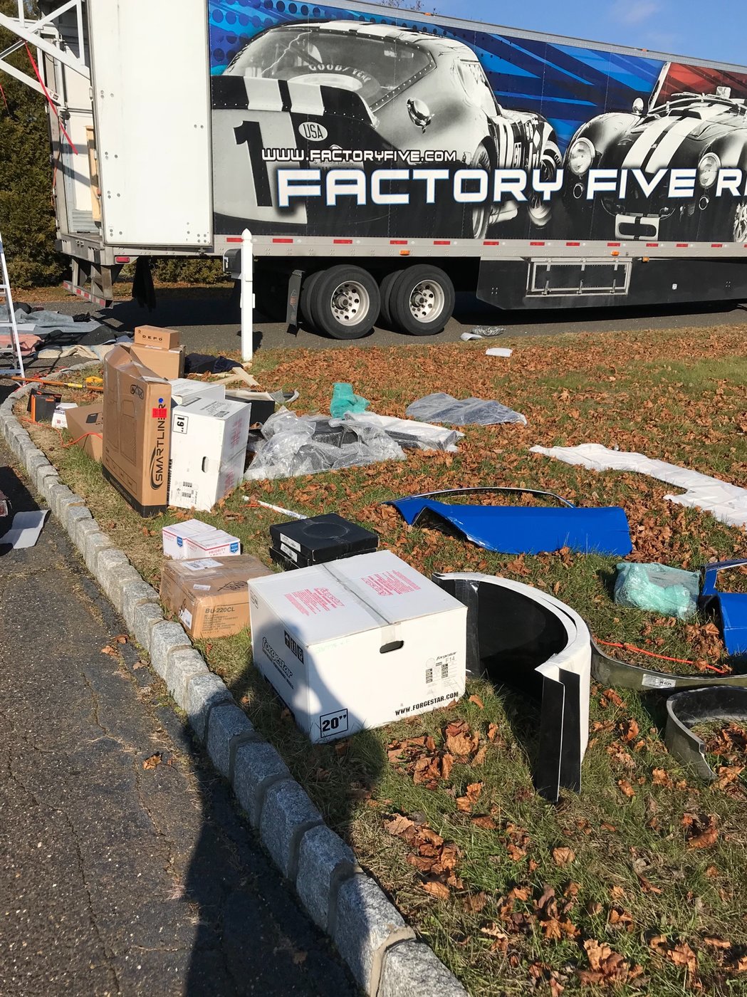

Well, the day finally came. Thanks to Vicki, Kristen, and Fran for bringing products like the SL-C to market. In short, the kit is amazing. Building this car is going to be so much fun.

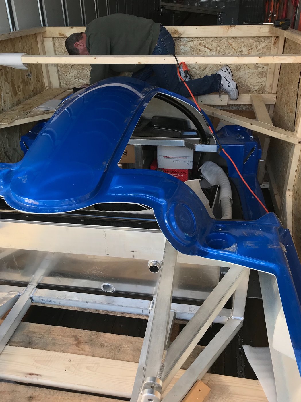

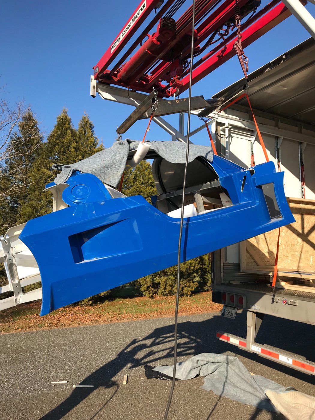

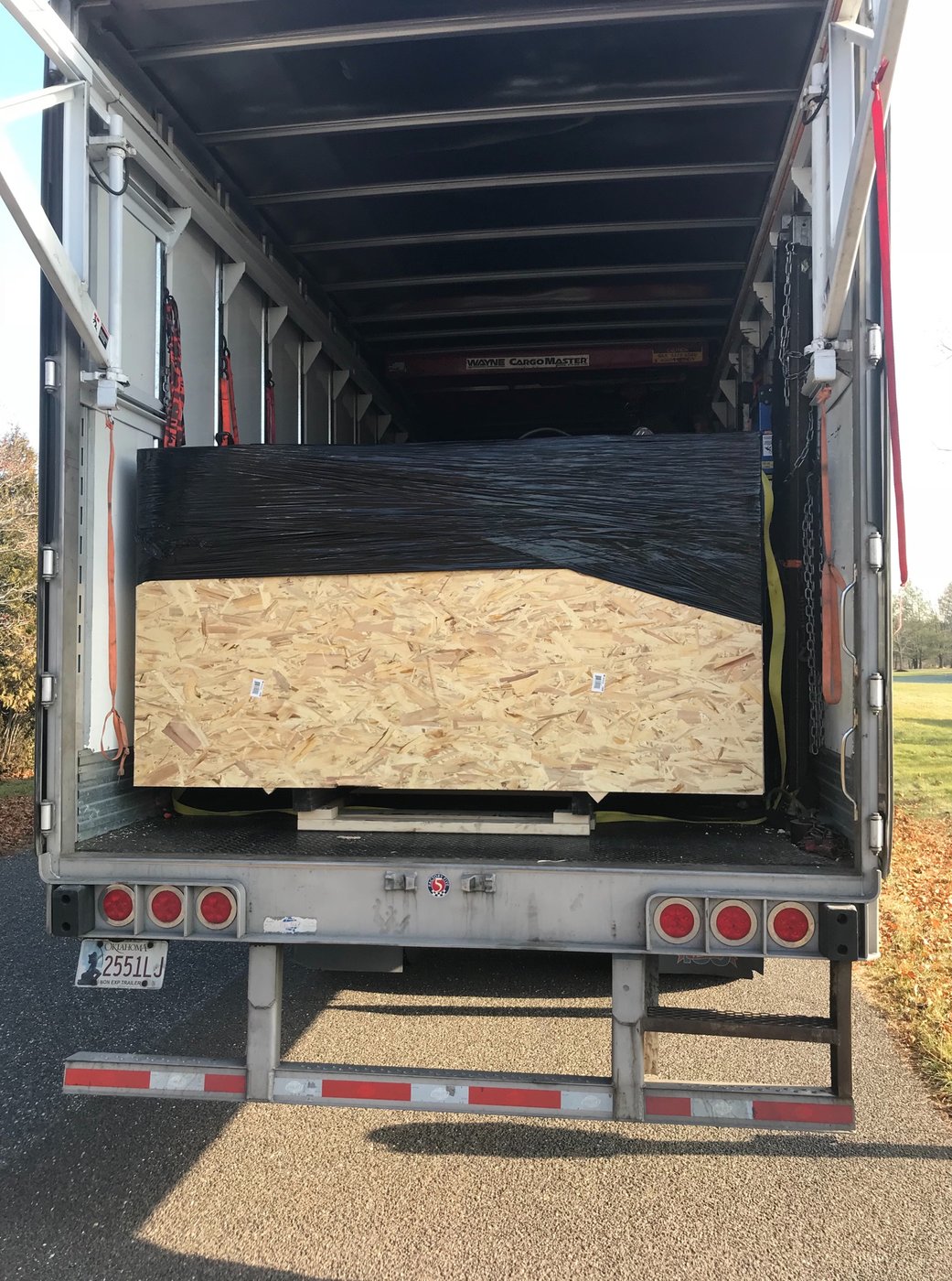

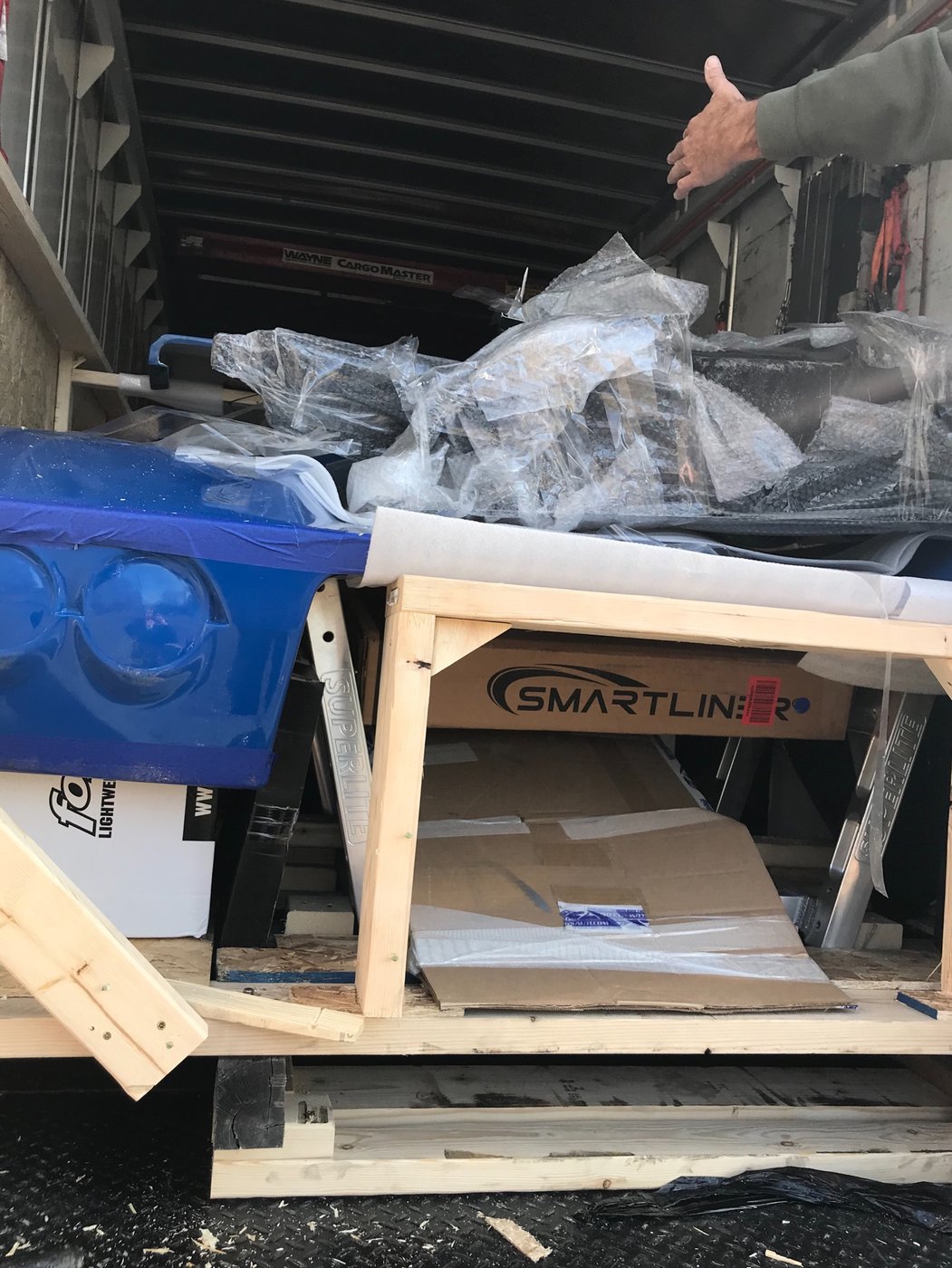

Stewart Transport arrived at my house at around 10AM. Because I had a crated shipment it was a very interesting task of unloading the car. Due to the size of the crate it was not possible for the driver to use the on board crane to simply lower the crate onto my driveway. Instead we opened the crate in the trailer. Took out the front and rear clams, doors, windows and windsheild. Many many boxes and then finally we used the crane to pick up the chassis with the spider attached. Very similar how they deliver factory five kits.

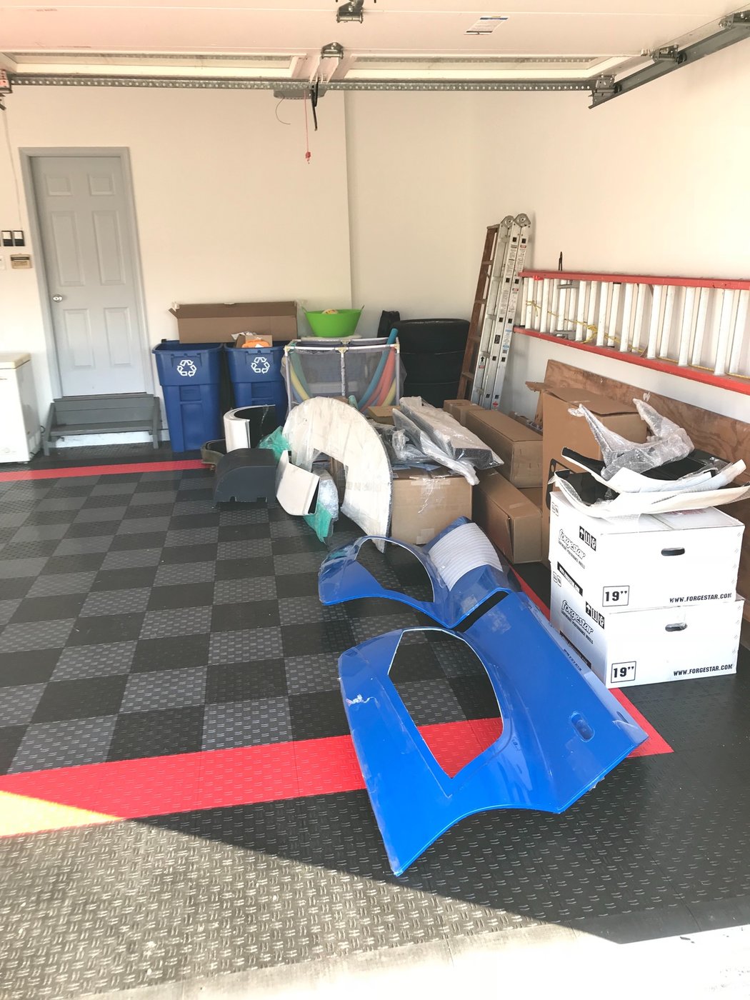

Warren the driver was awesome and we worked together for over 4 hours and got everything into the garage. Next step is inventory. My first impression of the kit is that I am really impressed. From the quality of the body, the carbon fiber optional parts, to the workmanship on the chassis itself. Just very satisfied with the kit.
Next step is inventory and building a body buck. Here are a few pics...
Stewart Transport in Factory Five Livery delivering a Superlite. They picked the car up on Monday and brought it straight to NJ, great people to do business with and highly recommended....
This was a daunting task...
Once the back of the crate was off we started taking as many components and boxes out, All the Carbon Fiber parts were wrapped well in bubble wrap and arrived in perfect condition ....
Amazing how many boxes of parts there are....

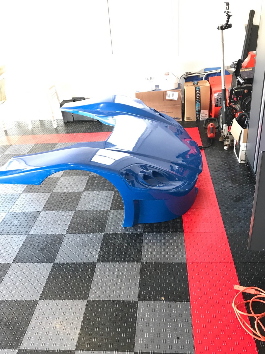

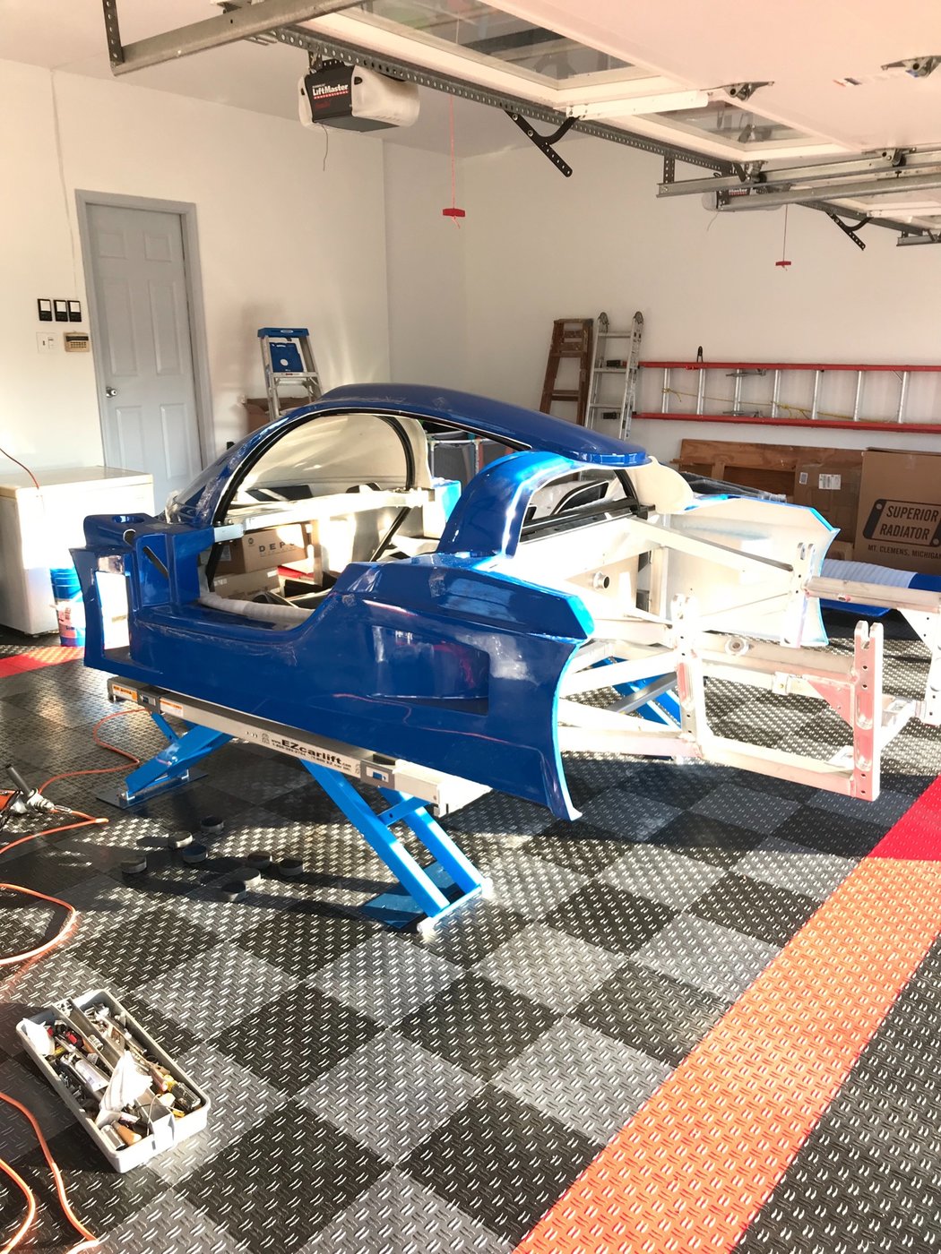

Front nose extracted from the trailer, the quality of the body is very good....
Now getting a little more organized....
Warren hooking up the straps to the side bars and front suspension mount points..
Finally out of the trailer...
We dropped the chassis onto the dolly. Good thing I had a box of hockey pucks around, I was able to lower the chassis on 8 hockey pucks and avoid resting the chassis on the drop floors. Worked out great and we rolled the dolly over the scissor jack then easily lifted the chassis up so the dolly could be removed. The EZCarlift works very well.....
And now on to inventory and body buck!
