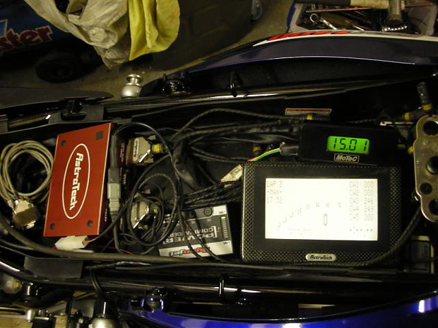

As some of you are aware I purchased a GSX1400 last May, my first bike for some 25 yrs and having done the running in, I've added a couple of bits. Firstly, I've fitted a PowerCommander III USB to enable the fuelling to be tweeked and have just fitted an 8-channel data logger under the seat. This records RPM, Speed, Throttle posn and G forces.

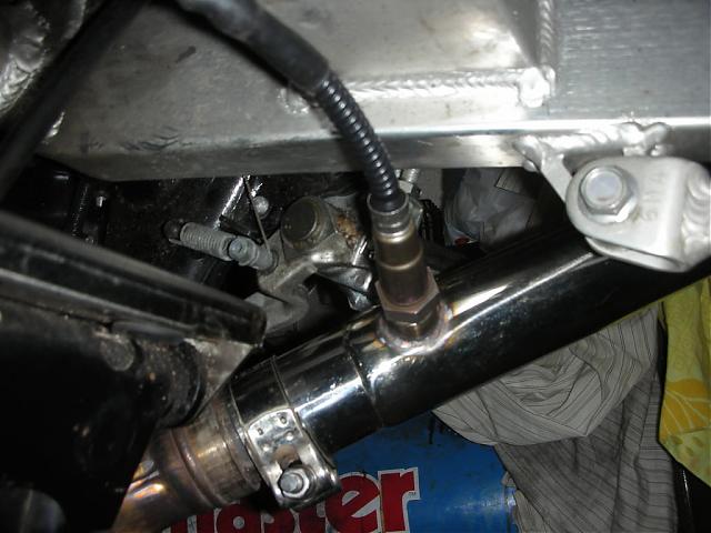

Now I know that the standard link pipe to the exhaust can (Yoshimura) is restrictive, so I've fitted a derestricted link pipe that a friend made and have had a lambda boss tigged to it's side.
This enables me to log the mixture of the motor via the output of a Motec PLM.

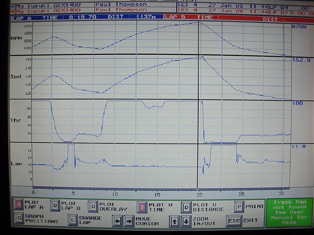

The image below was logged recently and had the throttle mostly wide open for about 11 seconds. It gives a steady AFR of 12.1:1 - too rich in my opinion.. Any knowledged comments / thoughts would be most welcome.

On the bikes I've tuned / worked on - Around 12.5:1 is good - maybe up to 12.7:1
Only problem is that the only way you're going to get a good and true reading is with a Wideband (heated) sensor.. The other sensors just don't get hot enough to give a good and true reading that is repeatable..
That's my $.02 worth on it...
I've fiddled with the Power Commander on EFI systems where I did not have access to altering the programming directly in the ECU. The PC is not a bad system when it's the only tool you have to use..
Thanks Randy - the Motec meter is wideband and heated, so gives accurate readings between about AFR 10:1 and AFR 480:1
I'll lean it a little I think for the moment and get it on a dyno in the near future too.
I think 13.8:1 - 14.5:1 will be ok for light throttle cruising too, so will target that area too.
