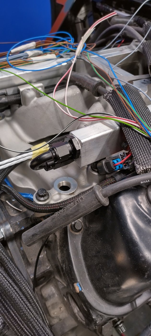

CTS placement (coolant temp sensor) is tight for me since i use fuel rails that collide with the predrilled 3/8 bungs in the rear coolant locations on the intake.
How wrong would the reading be if installed in a 90 degree elbow to connect the sensor?
I understand that the flow in the elbow will be limited, but the sensor would still be in the vicinity of the main coolant flow.
See picture to maybe understand the dilemma

My experience is that you'll get a much lower coolant temp reading at the rear of the engine versus the front. On a 5.0L engine in my Cobra, I tried locating the temp sensor for coolant fan in the hole at rear of intake. The engine temp as measured by gauge sensor at the front of the engine would be well over 200 degrees and cooling fans were not activated by the 190 degree sensor. I relocated the cooling fan sensor to upper radiator hose and cooling fan would activate at the temp it should. In addition, I don't think you'll get an accurate reading by putting the sensor in a tee or 90 fitting as it will be removed from the coolant flow.
It was a pain to locate the additional sensor in the radiator hose (didn't have any available ports at engine front) but it's where the coolant is at its maximum temp. You should also consider the thermostat when positioning the sensor. Until the thermostat opens, the temps upstream will be different than in the engine itself. If you locate an ECT sensor beyond the thermostat, the ECU will likely get a delayed reading during engine warmup. If you have limited ports in the engine front, you might want to prioritize the ECT sensor placement over a gauge sensor placement.

Daniel, the temp sensor probe has to be immersed in coolant flow path at all times to read accurately. Adding an elbow could end up holding the probe in a static air/steam pocket.
You may want to modify the fuel rail with a flush AN plug and then re-drill and tap another hole location for the fitting.
